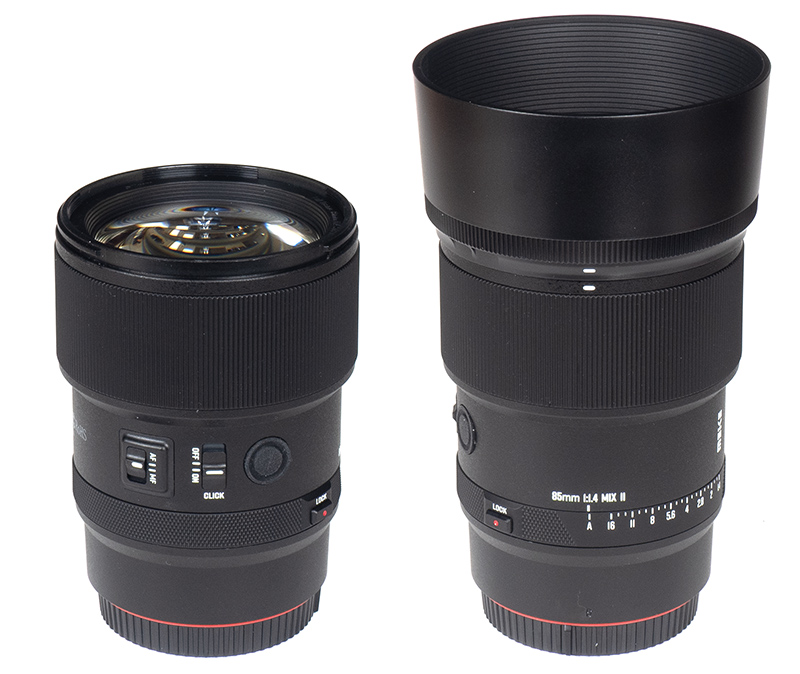

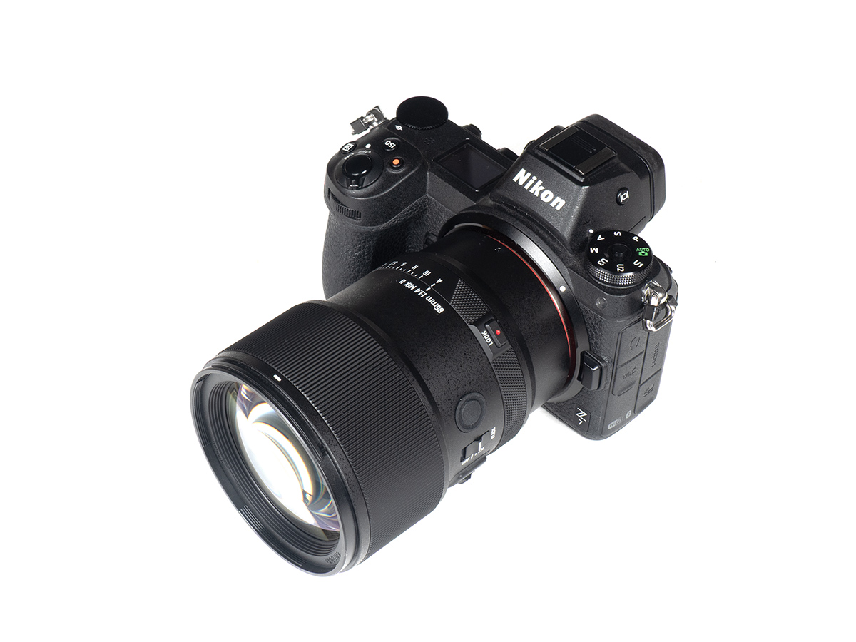

    The Meike lens is somewhat large yet lightweight at just over 650g. The low weight is achieved via good-quality engineering plastics based on a metal mount. The broad plastic focus ring turns smoothly. There is, of course, a dedicated aperture ring that can be “de-clicked” and locked. It doesn’t have to most luxurious feel to it but it does the job. There’s also a customizable Fn-button and an AF/MF switch. Weather-sealing is a bit basic with just a mount gasket to prevent water/dust-ingress at the rear. However, the internal focusing provides some protection as well. A barrel-shaped lens hood if provided.
    The 85mm f/1.4 MIX II uses a “hyper STM” (stepping motor) for autofocusing. It’s reasonably quick but not aligned to sports photography.

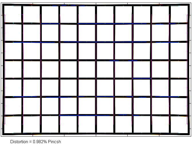

    The Meike AF 85mm f/1.4 MIX II produces a slight pincushion distortion of ~1%. This is usually not disturbing. There is, however, no built-in correction profile for this.

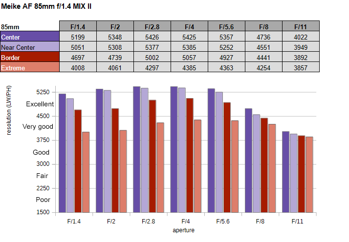

    This is where the Meike AF 85mm f/1.4 MIX II really baffled us. The broader center is bruttally sharp at f/1.4 and even the borders are excellent here. The corners are still very good at this setting. Stopping down lifts the quality a bit further but given how sharp the lens is already at f/1.4, this has a marginal effect. Diffraction effects set in at f/8. The quality is still very good (just) at f/11, and f/16 should be avoided as usual
    The centering quality of the tested sample was good. Field curvature is low.

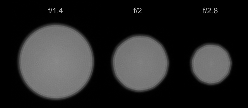

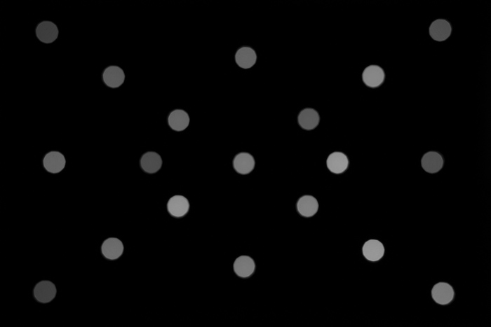

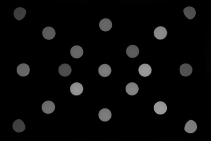

    Out-of-focus highlights are very clean at f/1.4 with just a hint of a substructure in the inner zone of the discs. There is a slight outlining effect and a “stepped” edge.

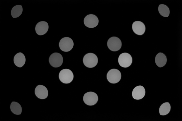

    When looking at the whole image, the circular highlight shape is maintained in the broader center but there is the usual deterioration to “cat eyes” towards the corners. The “perfect” zone is broadening the more you stop down and the corner discs are restored from f/2.8.
    f/1.4f2f/2.8

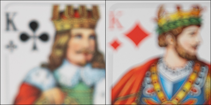

    The general blur in the focus transition zone is very smooth in the image background (shown to the left below) . The foreground blur (to the right) is more busy (double-edged).

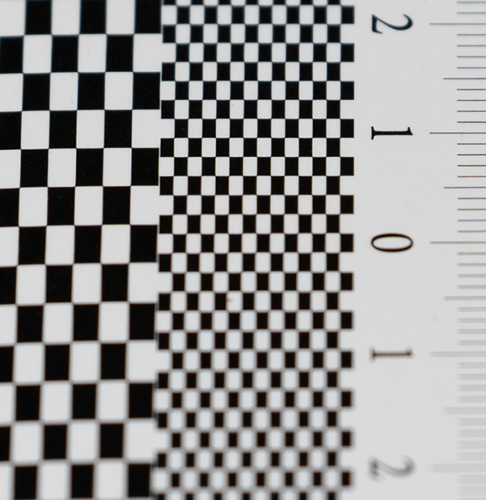

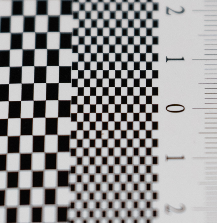

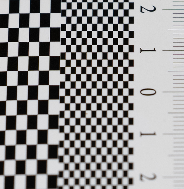

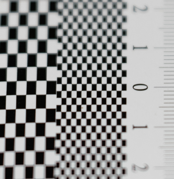

    If you look closely, you may observe that the focus point shifts to the rear. These are “residual spherical aberrations” or RSAs. It does render the initial focus point out of focus. However, keep in mind that this is only relevant at close focus distances. You may also notice that the rendering is a bit soft at f/1.4 so there’s no close-focus correction (e.g. via floating focusing system).
    f/1.4f/2f/2.8f/4

    The Meike AF 85mm f/1.4 MIX II delivers surprisingly high results. In terms of resulution, it is tack-sharp up to the borders and that's straight from f/1.4. The corners are still very good at this setting. Stopping down to medium apertures results only in a marginal improvement simply because there isn't really much to improve on anyway. Lateral CAs are negligible, and axial CAs, while present, are fairly low for this type of lens. The bokeh is mostly smooth. A weakness is the focus shift when stopping down although that's only relevant at close focus distances. The flare resistance is typical for a medium-tele lens. The build quality is fine although professional users may desire a bit more here. The lens feels a bit plasticy and weather sealing is rather basic. On the positive side the extensive use of plastics also translates to a low weight. The AF is quite quick and virtually silent but don't expect it to be a speed demon. Overall, we've been quite impressed by the Meike AF 85mm f/1.4 MIX II and it is a value recommendation.
