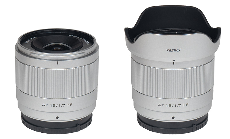

    The 15mm f/1.7 is a member of the “Air” lineup which is about delivering affordable lenses with a small form factor. Despite the lightweight, the build quality is pretty decent, with the lens body made of good-quality engineering plastics based on a metal mount. The broad (plastic) focus ring turns smoothly. A petal-shaped lens hood is supplied. There are no buttons on the lens. Thus, you have to switch the AF on/off via the camera menu. Weather-sealing is not provided which is not overly surprising given the price point.

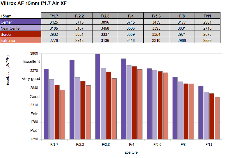

    The centering quality of this 2nd sample was slightly better compared to our review of the black version of the lens. The Viltrox AF 15mm f/1.7 Air XF produced very good results for such a wide and fast prime lens. At f/1.7, the center is already sharp. The border/quality isn’t quite as high but still on a good to very good level. Stopping down to f/2.8 boosts the border center as well as the corners, which now reach very good quality. The technically best results are achieved around the f/4 mark, where the outer image field reaches excellent levels across the image field. Diffraction effects set in beyond, and you shouldn’t use f/11 unless you really need the depth-of-field.

    Lateral CAs are low, with a peak CA pixel width of around ~0.4px at the image borders.
