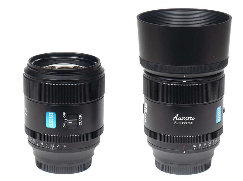

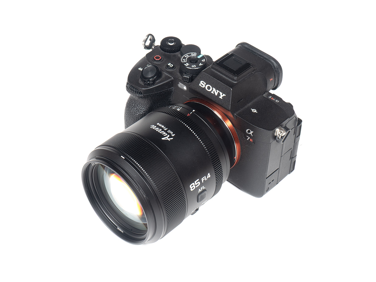

    Upon first contact, you are surprised by the compact dimensions and low weight. It’s actually the most lightweight 85mm f/1.4 that we’ve tested so far. This is actually a little surprising because the build quality is impressively high. It feels very substantial with an outer shell made of metal. The broad focus ring turns smoothly. Sirui claims that the lens is dust- and waterproof (probably more like “resistant”). The lockable aperture ring can be de-clicked, and there’s an AF lock button. A deep, barrel-shaped lens hood is provided. Firmware updates are possible via a USB-C port on the mount.
    The lens uses a STM (stepping motor) for autofocusing. It’s noiseless and quite snappy, although not super fast. EXIF data is provided, of course.

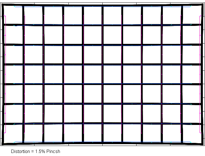

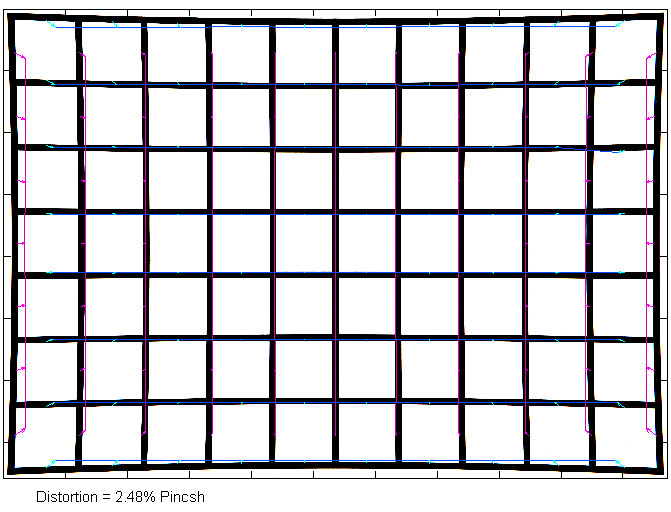

    The Sirui Aurora 85mm f/1.4 produces a medium degree of pincushion distortion (2.5%) in RAW images. This is a little higher than average in this class. There is no built-in correction profile. However, Sirui provides a downloadable profile for Photoshop ACR. This reduces the distortion by 1%.
    DxO PureRaw/Photolabs has a custom profile, which reduces the distortion down to almost zero.

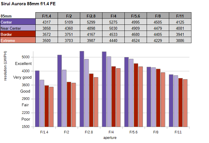

    The Sirui Aurora 85mm f/1.4 produced very decent resolution results in the lab. The center resolution is very good to excellent at f/1.4. The outer image field still reaches a good to very good quality here. If you want a tack sharp center, you should stop down to f/2. The overall quality improves gradually until reaching its peak between f/4 and f/5.6. Even corners reach excellent quality at these settings. Diffraction has an impact from f/8, although f/11 remains very usable. f/16 should be avoided as usual.
    The field curvature is negligible. The centering quality of the tested sample was good.

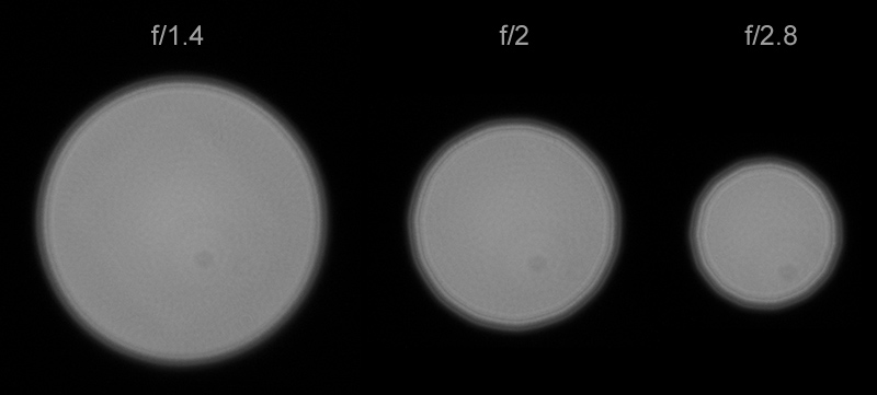

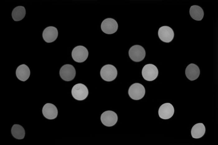

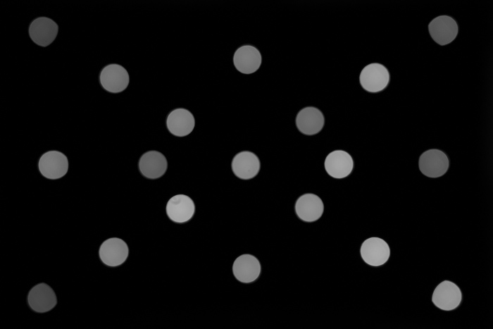

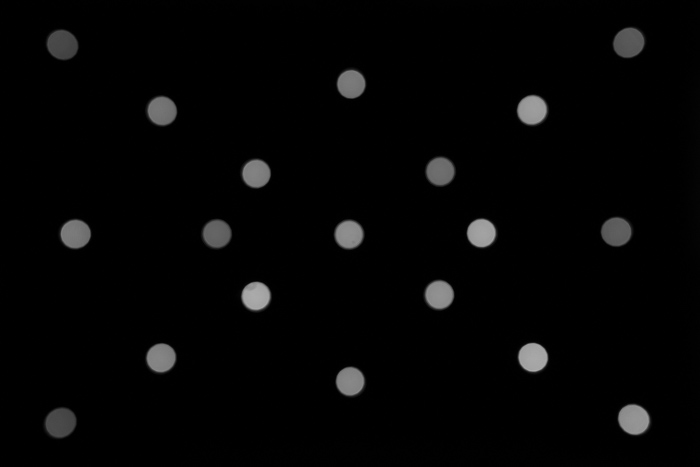

    The inner zone of out-of-focus highlights is very clean in the center of the image (apart from a dust spot). There’s a very slight outlining as well as a soft halo. The disc is perfectly circular at f/1.4 and mostly so at f/2 and f/2.8. It’s worth noting that the aperture mechanism uses no less than 15 (!) blades to achieve this.

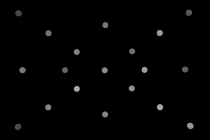

    When looking at the highlight rendering across the whole image field, the circular shape of the discs remains intact up to the mid-field. Beyond, the discs deteriorate to comparatively mild “cat eyes”. The circular shape of the border discs is restored at f/2, and the corner discs follow at f/2.8.

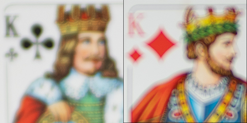

    The rendering quality in the focus transition zone is smooth in the image background, although you can already see it greenish axial CAs here. The foreground blur shows double edges, which we’ve seen from many other lenses.

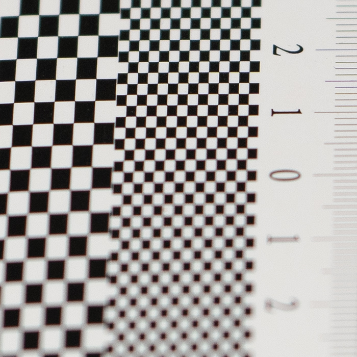

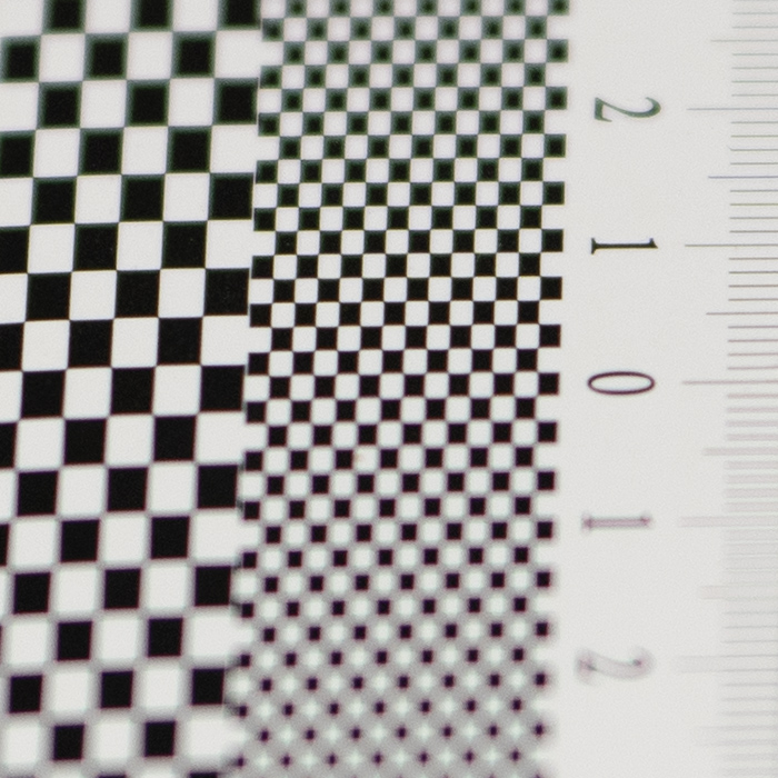

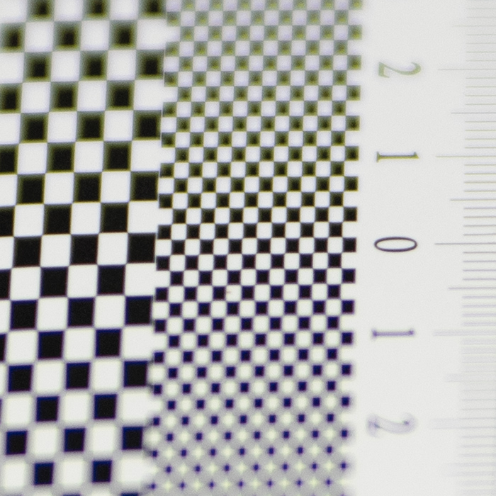

    The Sirui Aurora 85mm f/1.4 struggles more than most in this respect. The fringing is clearly visible at f/1.4. It’s much better at f/2. Traces remain at f/2.8, and the issue is mostly gone at f/4. When scrolling through the aperture range, you may also notice that the focus point shifts to the rear. We’ve seen these “residual spherical aberrations” from a number of ultra-fast lenses. Please note that this isn’t overly relevant with autofocus (on Sony cameras) because the focus is obtained at working aperture.

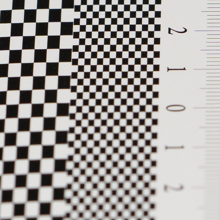

    The test is performed at a close focus distance to emphasize the effect. However, you may notice that the focus point isn’t very sharp at f/1.4. So in real-world close-up scenes, you should stop down to at least f/2.8.
    f/1.4f/2f/2.8f/4
