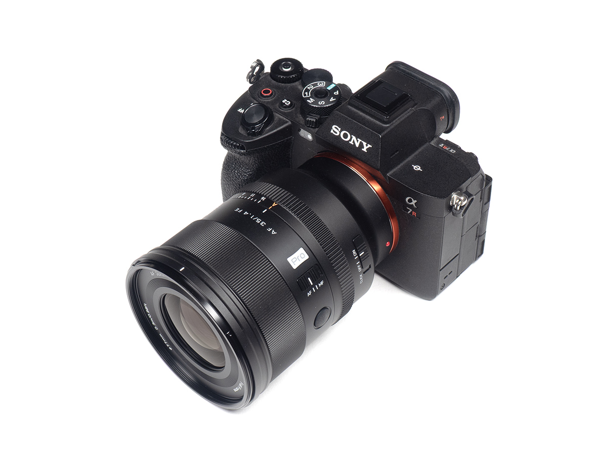

    A while ago, Viltrox released the AF 35mm f/1.2 LAB – an impressive lens, but also very big and heavy. It appears that the folks at Viltrox also recognized this so let’s welcome the new Viltrox AF 35mm f/1.4 PRO FE. It’s barely slower yet more compact and somewhat more affordable at $829 USD (859 EUR, 739 GBP, 1159 CAD, 157800 yen) although their pricing starts creeping up compared to previous years. Let’s see if its performance matches up.

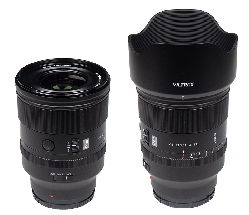

    It may not be a “LAB” lens but the build quality of Viltrox PRO lenses is still as good. The metal lens body is tightly assembled and weather-sealed. The metal focus ring is silky smooth and the de-clickable aperture ring has a nice action to it. We also appreciate that Viltrox opted for a marked metal aperture ring rather than an unmarked, freely rotating version with the info LCD. In terms of controls, there’s also a Fn-button. A deep, petal-shaped lens hood is also part of the package.
    The AF system is based on a “Voice-Coil-Motor” (VCM) making focusing both fast and silent. Unlike with STM (stepping motors) the VCM group is free floating meaning that you can feel it moving when shaking the lens once it’s off the camera. We’ve seen this with lenses from other manufacturers that use the same system.

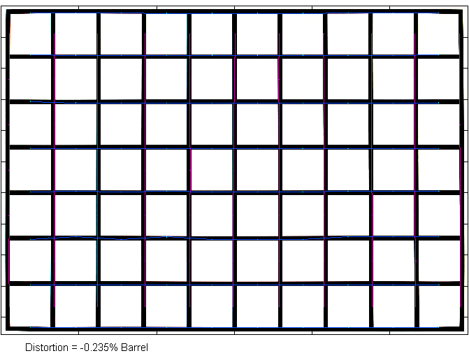

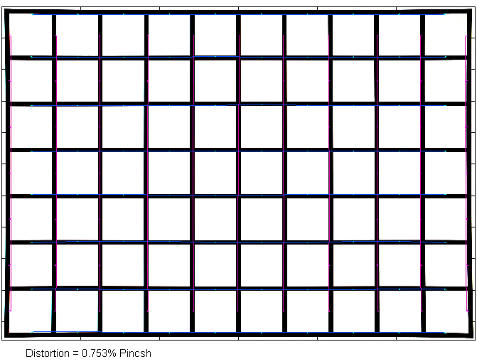

    The Viltrox AF 35mm f/1.4 PRO produces a slight pincushion distortion in RAW files. At 0.75% this is usually not disturbing. Autocorrection reduces this to a very mild barrel distortion of just 0.2%.

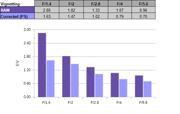

    Ultra-large aperture wide-angle lenses tend to produce high native vignetting and that’s no different here. A vignetting of 2.8 EV (f-stops) at f/1.4 is very visible in RAW files. Stopped down to f/2, this is reduced to 1.8 EV and the vignetting settles around 1 EV at medium aperture settings.
    Thus using autocorrection makes sense here. It reduces the vignetting at wide-open aperture down to 1.6 EV. (f-stops). This can still be visible in some scenes. It’s only slightly reduced at f/2 and it gradually decreases further down to 0.7 EV from f/5.6 onward. The latter is usually not disturbing anymore.

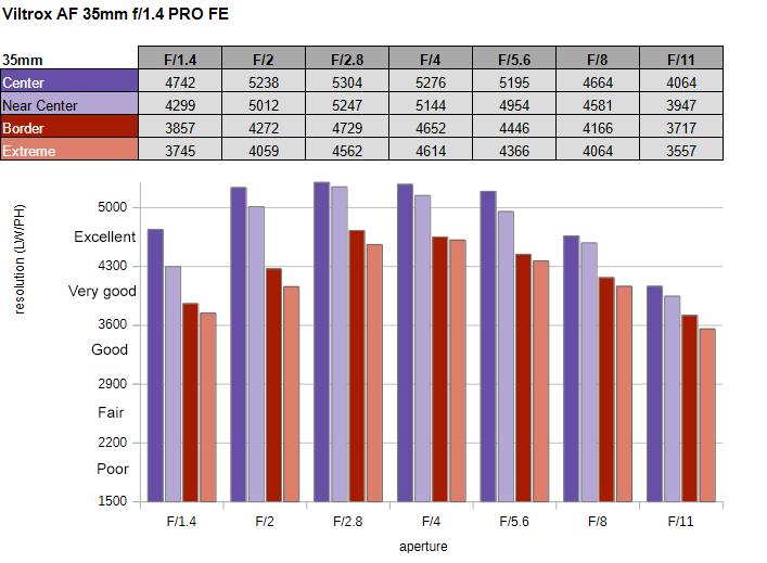

    Most Viltrox lenses produced more than just impressive results in the resolution tests – and this is no different here. The center resolution is already excellent at f/1.4. And while there is a drop in quality beyond, even the corners reach very good results here. At f/2, the broader center is absolutely superb and exceeding the sensor potential. The outer image field creeps up in quality as well. The peak performance is already reached at f/2.8 with the borders/corners now also reaching excellent levels. This is maintained at f/4 and mostly at f/5.6 before diffraction effects set in at f/8. The sharpness remains very high here and f/11 is still pretty good.

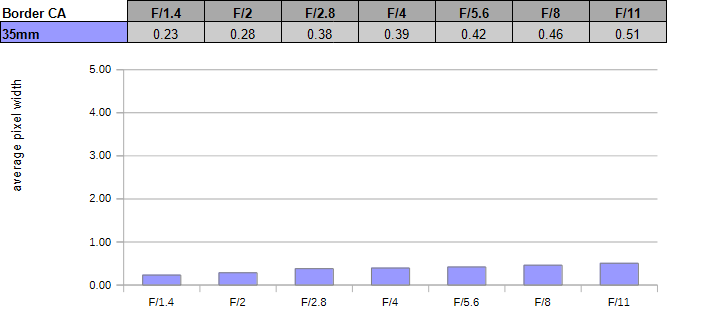

    Lateral CAs are very well controlled. At f/1.4 they are almost undetectable but increase slightly the more you stop down. However, an average CA pixel width at the borders of just 0.5px at f/11 is still nothing to really worry about.

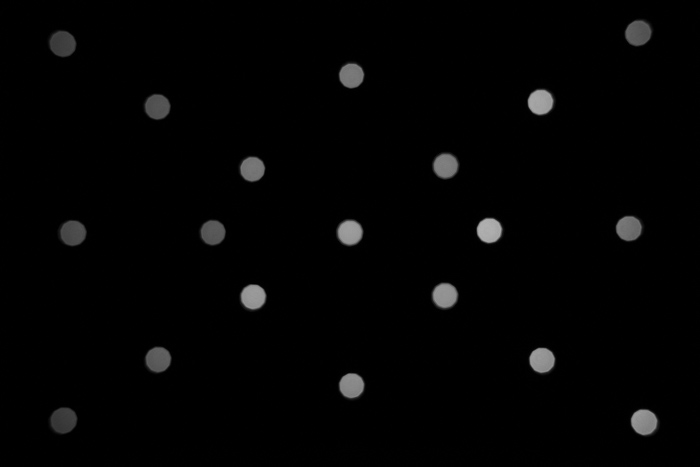

    Out-of-focus highlights in the image center are nicely rendered. The inner zone of the discs is quite clean and the edges of the discs end with a slight halo. Stopped down to f/2 reveals the a slightly more edgy shape of the aperture already, though.
    The above applies to the image center. The circular shape of discs deteriorates from the midfield at f/1.4. If you look closely below you may also notice that there’s some one-sided outlining of the discs developing. The outlining disappears when stopping down a little and the (near-)circular shape of the corner discs is also restored at f/2 already.

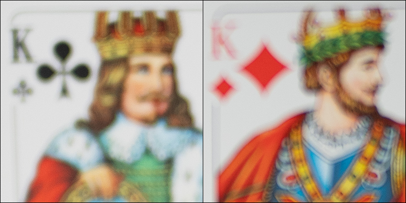

    The rendering quality in the focus transition zone is smooth in the image background – shown to the left below. As so often, the less important foreground blur (to the right) is harsher.

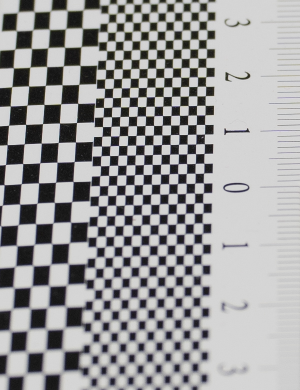

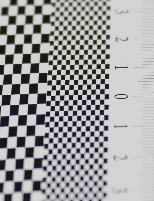

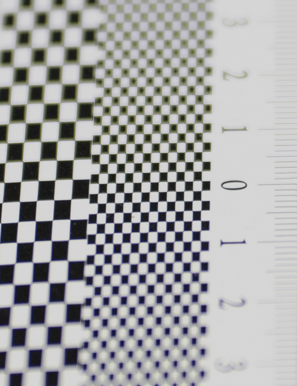

    The Viltrox AF 35mm f/1.4 PRO produces some very obvious fringing at f/1.4 as you can see below. It improves a bit at f/2 and there’s a substantial reduction of the fringing at f/2.8. The LoCAs are mostly gone from f/4.
    You may also notice that the focus point shifts towards the rear when stopping down (RSAs). However, the original focus point remains in focus due to the increased depth-of-field, so that’s not an issue in real-world conditions.
    f/1.4f/2f/2.8f/4
