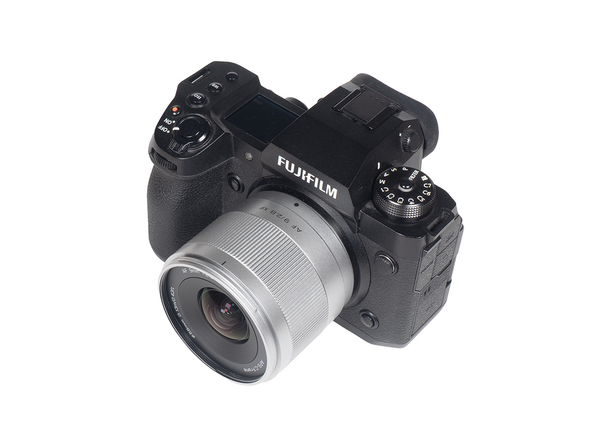

    The 9mm f/2.8 Air XF is an APS-C format lens equivalent to about 14mm in full-format terms. The lens stays, of course, true to the cause of their “Air” lineup. Thus, it’s both very compact and very affordable at just $199 USD / 229 EUR / 190 GBP. The lens is available in E- , Z-, and X-mount. As you can see, this review covers the silver version that is exclusively available in X-mount – probably to match the silver-top cameras that are available from Fujifilm.

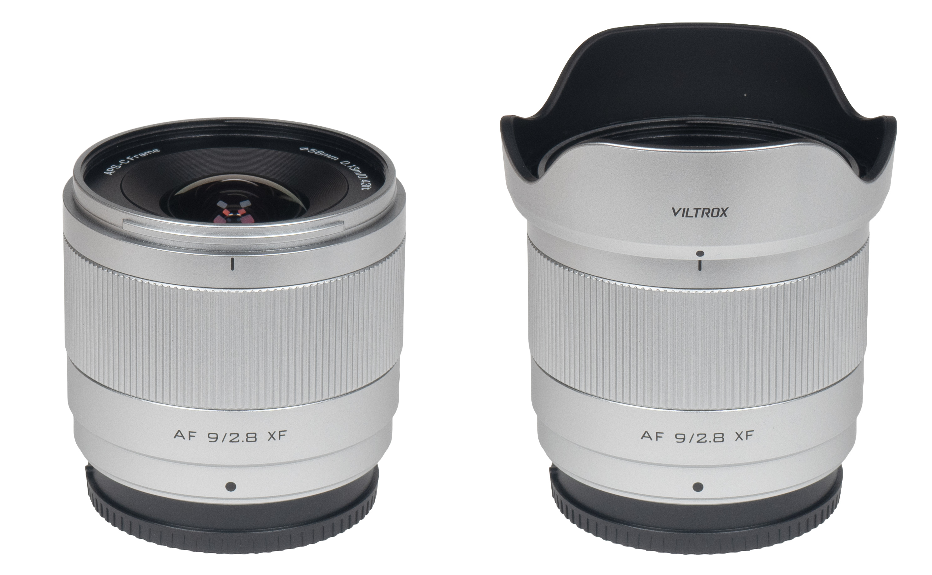

    The build quality remains in line with what we’ve seen of the “Air” lineup. Thus, it’s using good-quality, consumer-grade engineered plastics based on a metal mount. The focus ring turns smoothly. And a small petal-shaped lens hood is supplied. A USB-C port on the lens mount can be used for firmware updates.
    The AF uses a conventional STM (stepping motor), which is well sufficient for moving the small lens elements in a fast and silent manner. Manual focusing is very precise.

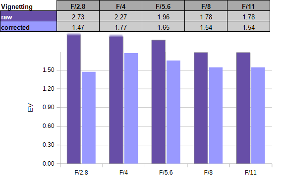

    The Viltrox AF 9mm f/2.8 Air XF has one clear weakness – vignetting. A light falloff of almost 3 EV (f-stops) wouldn’t be unusual for similar lenses on full-format cameras. However, it’s a bit much in the APS-C scope, where the figures are exceeding our usual scale substantially here.
    Auto-correction doesn’t help too much, unfortunately. It cuts off ~1.3 EV at f/2.8. Strangely, the vignetting increases a bit at f/4 before return to a 1.5 EV light falloff from f/8.

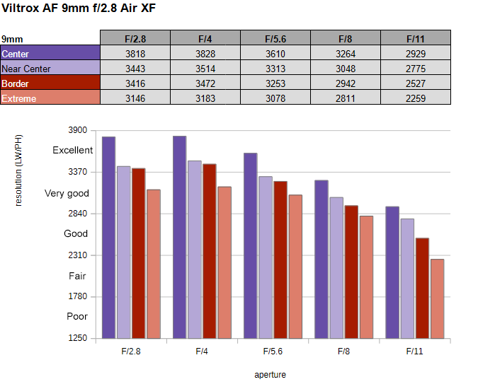

    The resolution characteristic of the Viltrox left us quite baffled. We can only describe it as tack sharp straight from f/2.8. Even the corners are easily very good. Stopping down to f/4 lifts the quality marginally, but the lens is basically diffraction-limited. Don’t stop down beyond f/8 unless needed.
    The centering quality of the tested sample was Okay (slightly softer on the right side). The field curvature is fairly low.
