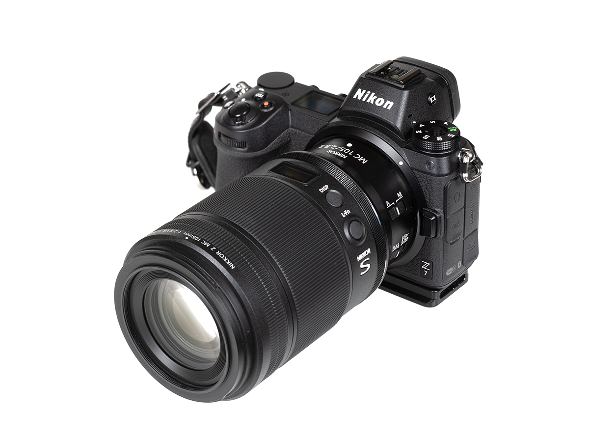

    A system is incomplete without some macro lenses and Nikon does have two in its lineup. One of them is the Nikkor Z MC 105mm f/2.8 VR S. As a member of the “S”-class family it promises professional-grade performance. This may sound scary in terms of pricing but it’s not too bad at just over $1000 USD.

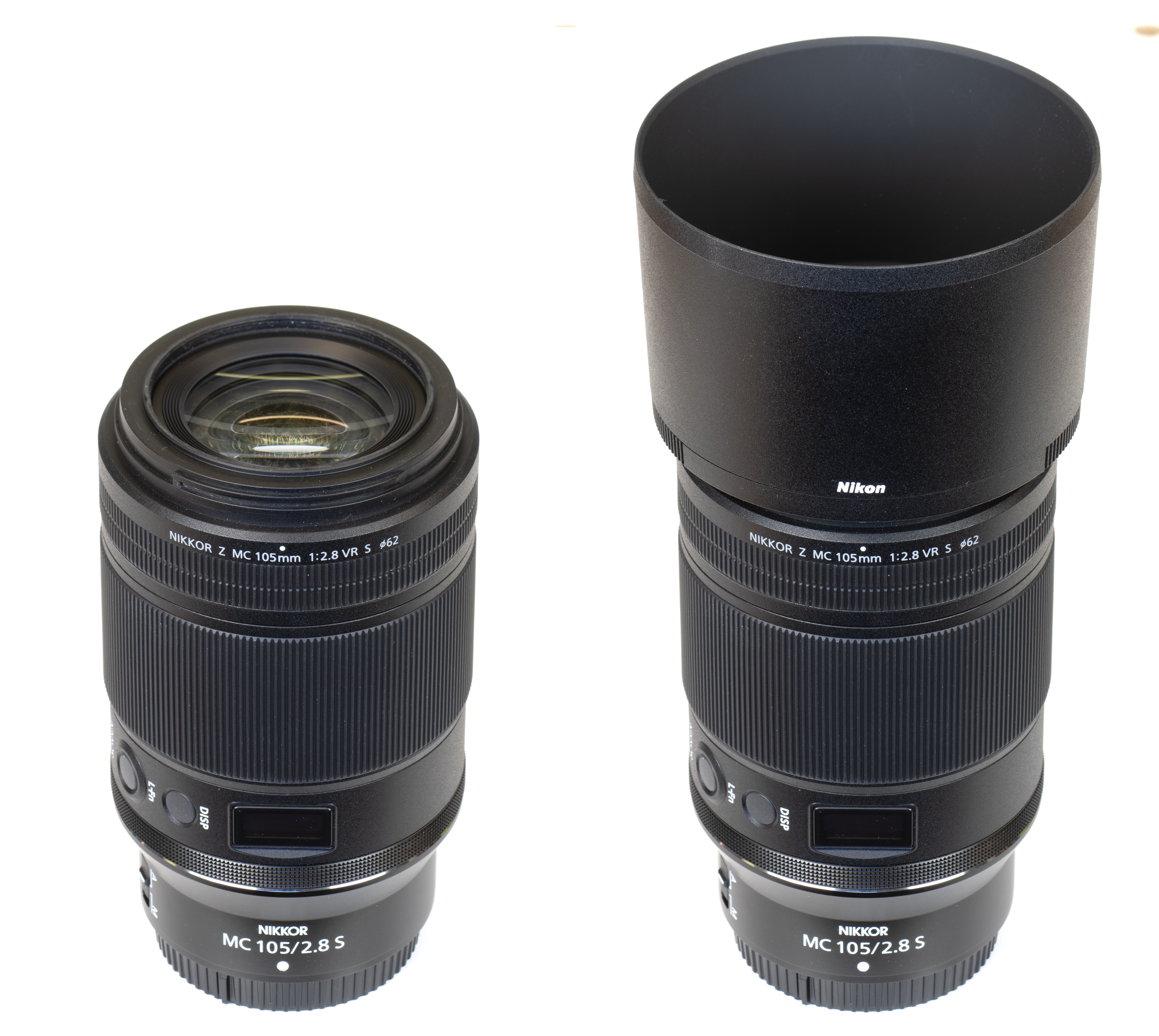

    The lens body is mostly made of high-quality engineering plastics except for the metal rear portion and the mount. This results in a comparatively low weight of 630g. The control rings turn smoothly. It combines internal focusing with extensive weather sealing and a water-repellent coasting on the front element so you should be good to go outdoors. There’s also an OLED info display, a customizable function button and the important 2-step focus-limiter. A barrel-shaped lens hood is part of the package.

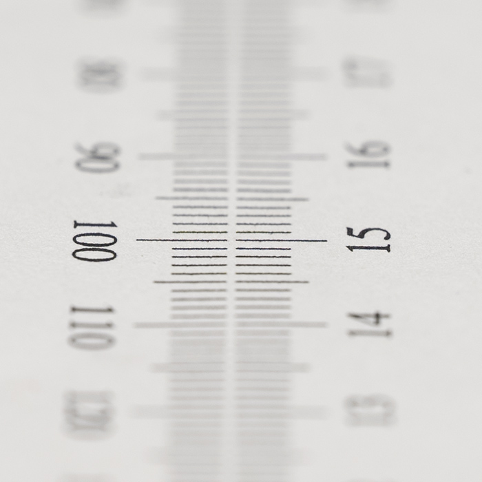

    For autofocusing the Nikkor uses a dual-motor multi-focus STM (stepping motor) system. It is quiet and pretty fast at conventional focus distances. However, you should take advantage of the focus limiter when shooting macro images to avoid focus hunting – unless you prefer to focus manually which is often a better idea for macros anyway. Focus breathing is minimal, so that’s good news for videographers. Please note that the effective aperture drops to f/4.5 at high magnification. This is normal for most macro lenses. At 1:1, the working distance is about 13cm from the front element to your subject. That’s not much but again in line with other lenses of this class.
    Nikon also implemented an optical image stabilizer with a potential gain of 4.5 f-stops.
    Optical construction16 elements in 11 groups (3x ED, 1x aspherical)
    Nano Crystal Coat
    ARNEO Coat
    Fluorine-coated front lens element
    Floating system
    min. focus distance0.29m (max. magnification: 1x)
    Dimensions85 x 140mm
    Weight630g
    Filter size62mm
    Hoodbarrel-shaped, bayonet mount, supplied
    Other featuresfocus limiter
    control ring
    dust- and drip-resistant
    Fn button
    OLED Display
    Image stabilizer w/ up to 4.5 stops gain

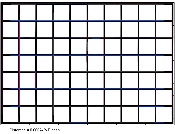

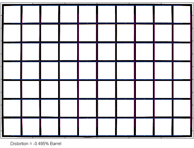

    The Nikkor Z MC 105mm f/2.8 VR S produces a slight barrel distortion in RAW images. Auto-correction handles this nicely if needed.

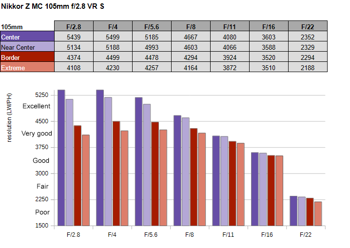

    Macro lenses tend to be excellent optically and the Nikkor is no exception here. Images are brutally sharp in the broader center straight from f/2.8. The outer image field is easily on a very good level here. There’s a minor improvement when stopping down to f/4. Diffraction sets in from about f/8. f/11 is still very usable. f/16 is softer still, and forget about f/22 unless you aren’t after high-megapixel images. Diffraction is a physical limitation so it is what it is here.
    Please note that the resolution figures were obtained at “normal” focus distances. We can’t realistically perform MTF checks at 1:1 object magnification. However, the Nikkor does have a floating focusing system so it should be able to maintain the quality at macro distances.

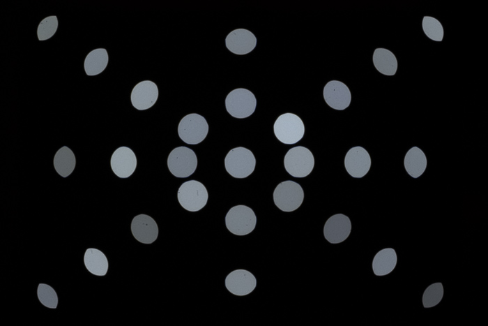

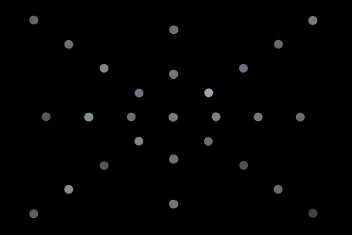

    Out-of-focus highlights are just slightly grainy in the inner zone (apart from the dust spot there) and there’s only a mild outlining. Surprisingly, the center discs aren’t totally circular at f/2.8, but it’ll be difficult to notice in real-world images. f/4 even appears to be slightly more circular than f/2.8. The discs remain mostly circular at f/5.6.
    When looking at the whole image, the circular highlight shape is maintained in the broader center but there is the usual deterioration to “cat eyes” towards the corners – more so than usual – which probably relates to the smallish front opening of the lens which causes mechanical vignetting. The “perfect” zone is broadening at f/4. However, the corner discs aren’t fully restored until f/8.
    f/2.8f/4f/5.6f/8
