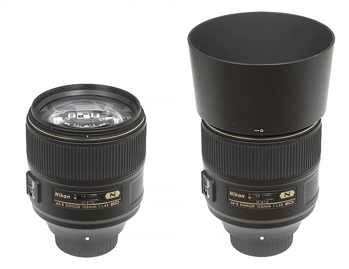

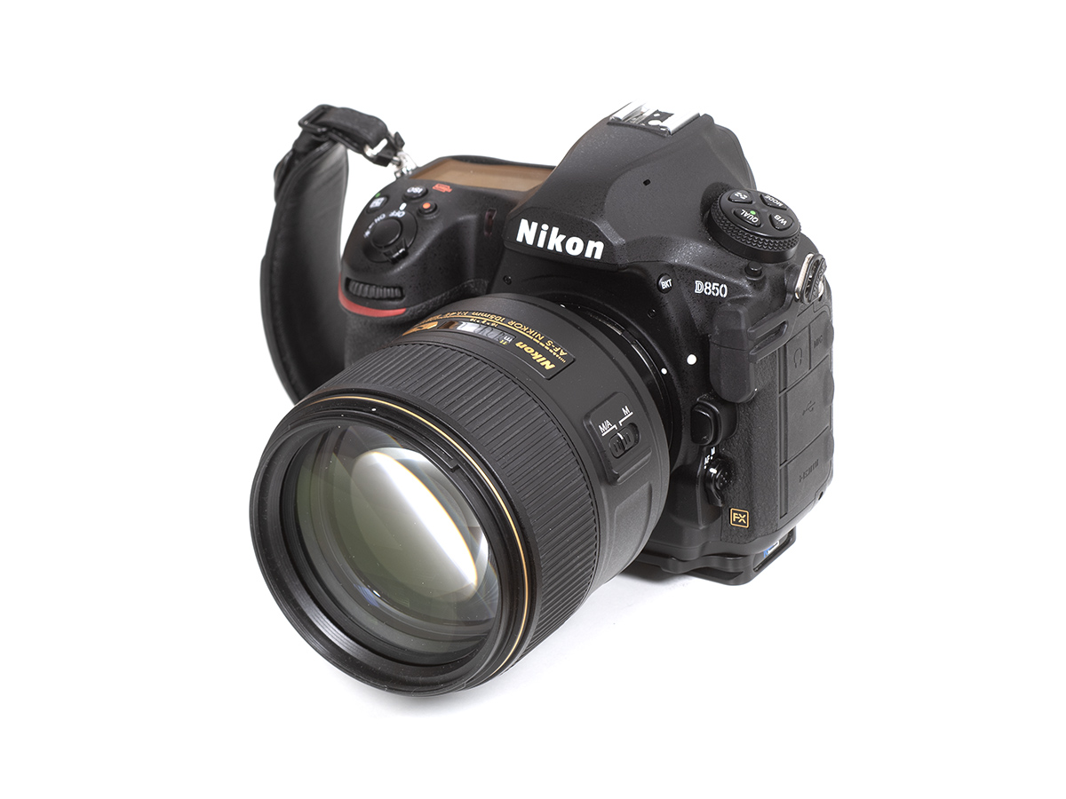

    Let’s start with the less exciting stuff and discuss some specs and build quality first. If you’ve ever handled any of the latest Nikon F-mount f/1.4 primes, especially the AF-S 58mm f/1.4 or the AF-S 85mm f/1.4, the 105mm lens will look very familiar at first. However, that doesn’t prepare you well for the weight of it coming in at just below 1kg. However, while it is certainly a “fat” lens, it’s comparatively short at just over 10cm. Apart from size and weight, it is indeed very similar to its closest siblings, which means it comes with an outer barrel that might be either high-end plastic or a magnesium alloy (which still feels like plastic). Nikon claims the lens is sealed to resist dust and moisture. There is one feature that sets it apart from the other “gold ring” f/1.4 primes: it is the first lens of that group to feature an electronically controlled aperture (thus the ‘E’ designation in its name). The broad, rubberized focus ring operates smoothly. It’s worth mentioning that the lens’ focus mechanism follows the focus ring movement immediately and without any delay.
    The AF is very fast and near noiseless on the Nikon D850. The physical length of the lens remains constant during focus operation, and the huge front element does not rotate. As is the case for all new Nikkors for many years now, the AF-S 105mm f/1.4E is a G-type lens and thus does not offer an aperture ring.

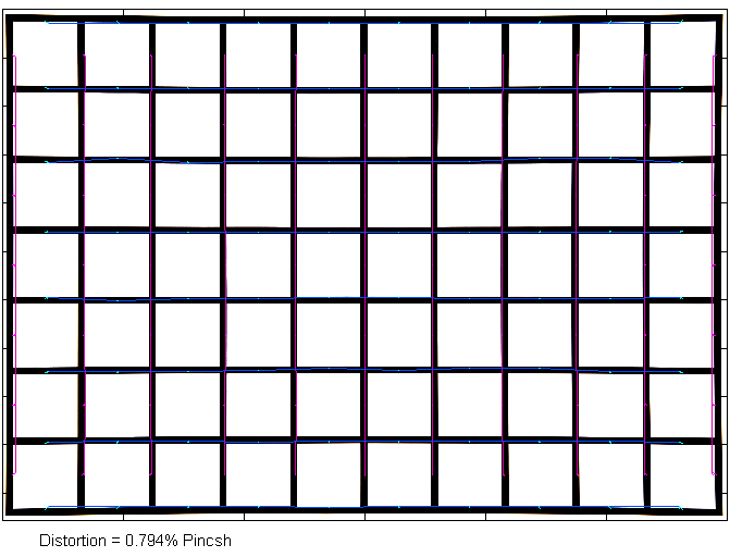

    The lens produces a small amount of pincushion distortion. This can be visible in subjects with straight lines near the image border. However, this is likely not the case in the majority of shots this lens is designed and used for.

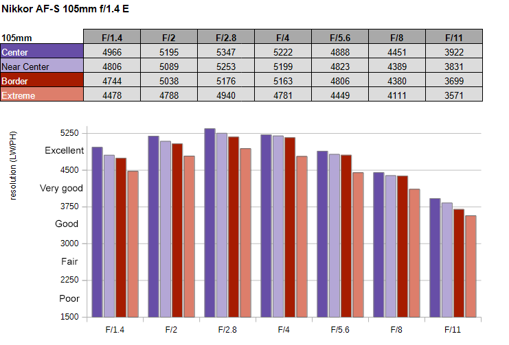

    The Nikkor produced absolutely superb resolution figures in the lab – and that’s straight from f/1.4. It reaches and probably surpasses the limits of the 45 megapixel sensor of the D850. The peak performance is reached at f/2.8 although you will be hard pressed to see the difference from f/1.4 in the real world. Diffraction effects slowly creep in thereafter, with slightly visible effects at f/8 and f/11 should be avoided unless required for your scene.

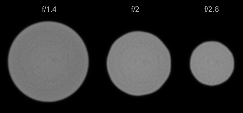

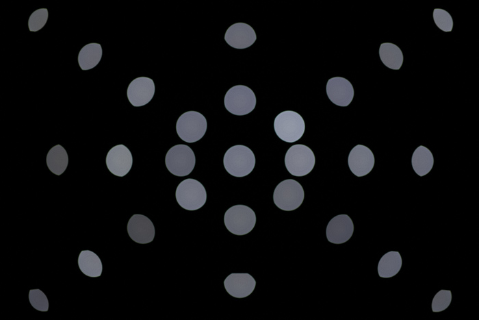

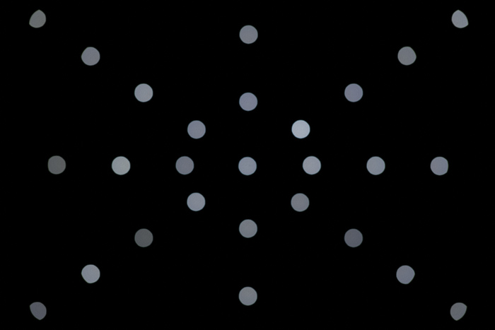

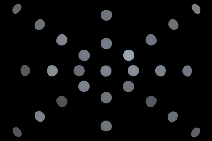

    Out-of-focus highlights are mostly clean with some minor “grain” in the inner zone. The center discs are circular at f/1.4 with no visible outlining. Stopping down to f/2 introduces a tiny bit of edginess. Surprisingly, it doesn’t increase at f/2.8.

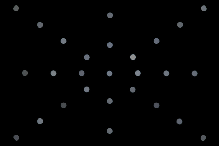

    Despite the rather large front element, the Nikkor can’t sustain the circular disc shape across the image field, so there’s some mechanical vignetting going on there. The discs are only circular very near the center at f/1.4. They deteriorate to “cat eyes” from the midfield, and these are very obvious in the image corners. Stopping down starts the restoration, but the corner discs aren’t fully back to their natural shape until after f/4.
    f/1.4f/2f/2.8f/4

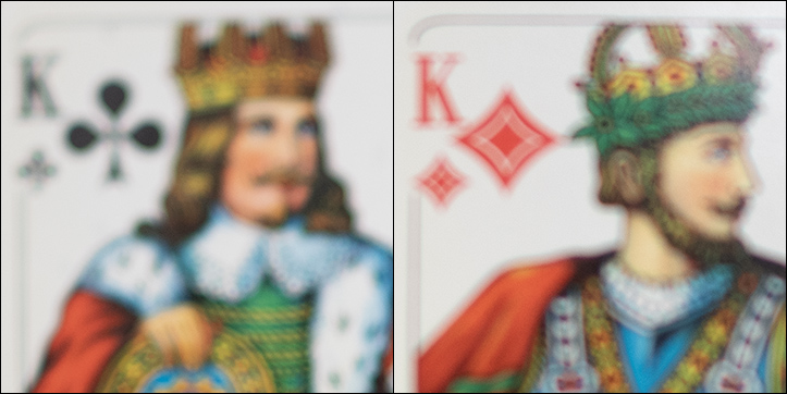

    The general out-of-focus rendition is very smooth in the image background (shown to the left below), but more nervous with double edges in the foreground (to the right below).

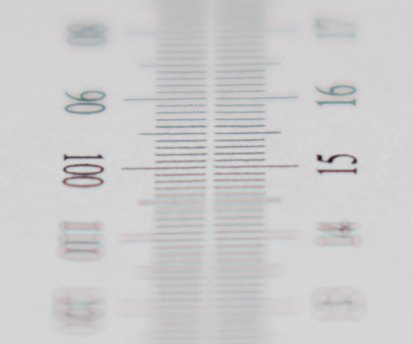

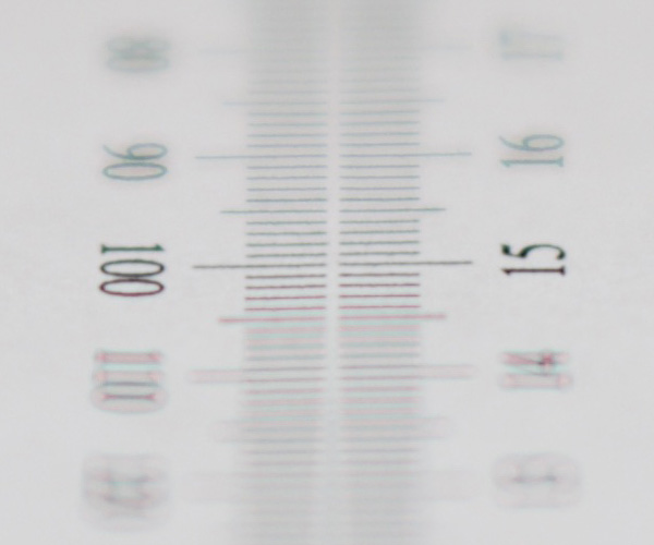

    Bokeh fringing (non-coinciding focal planes of the various colors) is a common issue with relatively fast glass. As you can notice below, the halos have different colors – magenta (red + blue) in front of the focus point and green beyond. Unlike lateral CAs, bokeh fringing cannot easily be fixed in post processing.

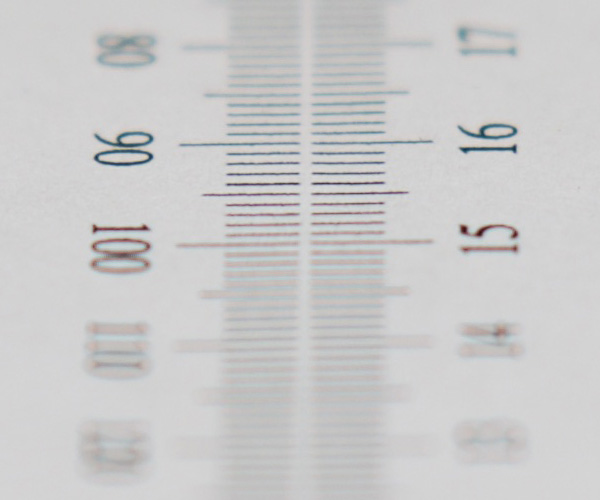

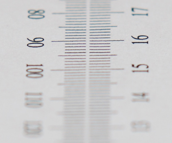

    Typical for most fast primes, especially ultra fast ones, the Nikkor shows a heavy amount of bokeh fringing at large aperture settings (you may also spot the rough foreground rendering). The sharpness is not ideal at f/1.4 – probably because the lens doesn’t feature a floating focusing system for close focus correction. The color fringing is reduced when stopping down but isn’t fully resolved by f/4 – which is “late”.
    In addition, these shots also illustrate the focus shift when stopping down. The effect is emphasized in these images, which were shot near the lens’ minimum focus distance. At more field-relevant distances, the issue won’t really be noticeable.
    f/1.4f/2f/2.8f/4
