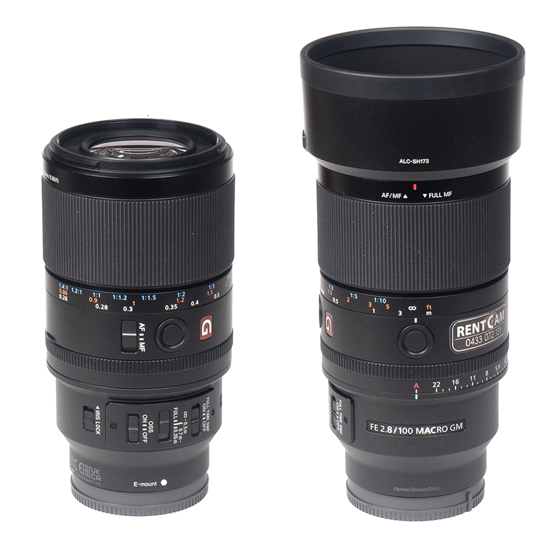

    The FE 100mm f/2.8 macro GM OSS is Sony’s 2nd generation macro lens for the E-mount system. It supersedes the FE 90mm f/2.8 macro G OSS, which has been with us since 2015. Sony is convinced that they created something special here because they lifted the designation from G to GM class for the new lens. And alongside, the price has also been raised by 50% to now $1500 USD. So let’s check how much substance they added to the recipe.

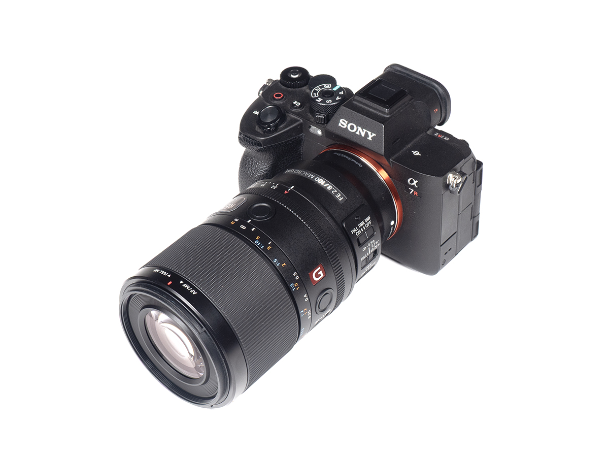

    The 100mm f/2.8 uses a combination of tough engineering plastics and magnesium alloy with extensive weather sealing. That’s not all that different from the 90mm f/2.8, although the quality has been lifted a bit. Another similarity is the clutch mechanism to switch between AF and MF. Unlike on conventional Sony FE lenses, the distance- and magnification scales are printed directly onto the lens barrel. Then there’s a whole phalanx of controls, including a de-clickable and lockable aperture ring, two configurable Fn buttons (configured to AF stop as default), a focus limiter, an AF/MF switch, a switch for the optical image stabilizer, and, of course, the broad rubberized focus ring. A novelty is the compatibility with Sony’s teleconverters. Natively, the FE 100mm f/2.8 macro GM OSS offers a max. magnification of 1.4x (increased from the 1x on the 90mm f/2.8). The working distance is 9cm in this case. When mounting the lens to the 2x converter, this increases to a whopping magnification of 2.8x then. This also increases the working distance, which can be important when shooting live critters. A deep, petal-shaped lens hood is part of the package.
    The FE 100mm f/2.8 macro GM OSS uses no less than 4 (!) XD (“eXtreme Dynamic”) linear motors, providing both snappy as well as silent autofocusing. Even so, you should take advantage of the focus limiter to avoid focus hunting when doing close-ups, unless you prefer using manual focusing here anyway (which many will do). The image stabilizer can give you a gain of about 4 f-stops, although this decreases at macro distances due to the extreme angular movements. If the camera has a sensor-based image stabilizer, the two systems are coordinated.

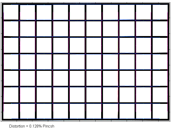

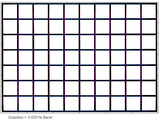

    The Sony FE 100mm f/2.8 macro GM OSS produces negligible pincushion distortion in RAW files – as it should be with a true macro lens, which is also intended for repo work. Autocorrection produces a perfect result here.
    CorrectedRAW

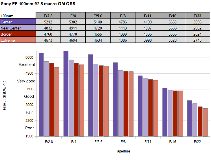

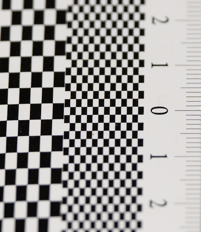

    The Sony FE 100mm f/2.8 macro GM OSS produced outstanding resolution figures in the lab. The quality is basically perfect at f/2.8 already. There’s still a tiny increase in quality at f/4. Diffraction starts to have a marginal effect at f/8. The quality is still very good at f/11. Diffraction effects are more noticeable at f/16, and f/22 should be avoided.
    The field curvature is negligible. The centering quality of the tested sample was very good.

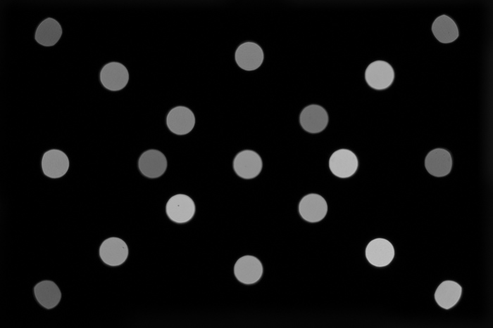

    The inner zone of out-of-focus highlights is very clean in the center of the image. There is a bit of outlining, though, and it stays the same when stopping down. The shape of the aperture remains circular until f/5.6 thanks to no less than 11 rounded aperture blades.

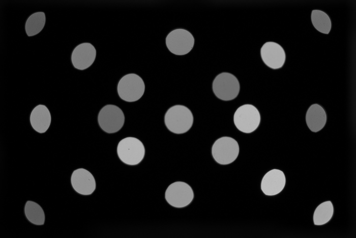

    When looking at the highlight rendering across the whole image field, the circular shape of the discs remains intact up to the mid-field. Beyond, the discs deteriorate to “cat eyes” which are, of course, most pronounced in the corners. The zone of “perfect” discs increases when stopping down to f/4. The corner discs are fully restored from f/5.6.

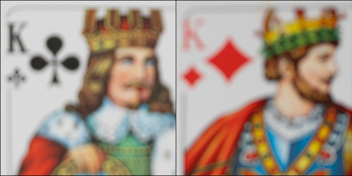

    The rendering quality in the focus transition zone is silky smooth, both in the image background and foreground.
