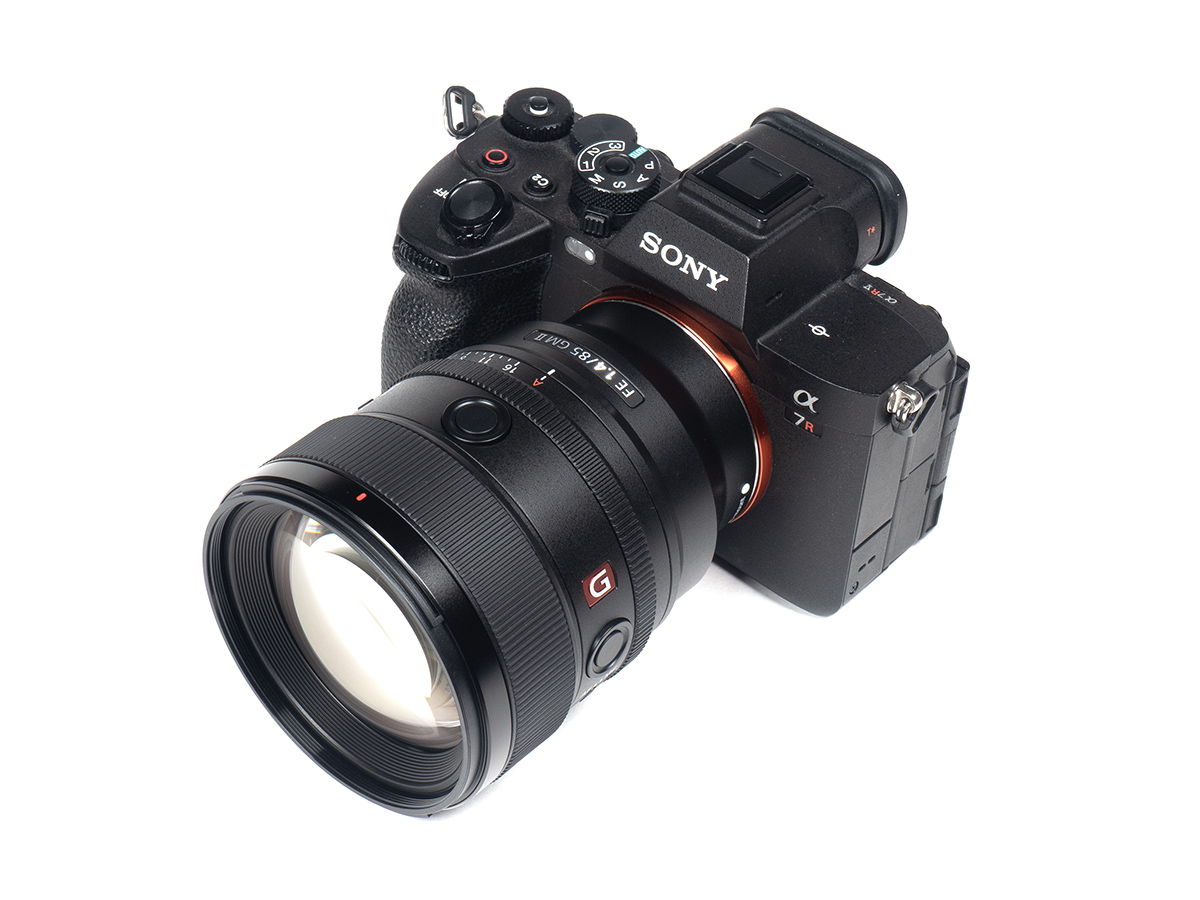

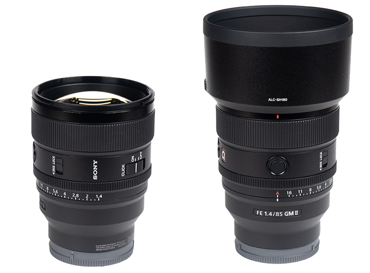

    You may be in for a surprise upon first contact. Historically, 85mm f/1.4 lenses tend to be bricks, but the Sony lens is comparatively compact and lightweight at just 642g. The build quality is still excellent. The used engineering plastics feel very solid. Sony incorporated extensive weather-sealing, but that’s, of course, normal for a professional-grade lens. The focus ring turns smoothly, as you might expect. It also features a de-clickable aperture ring and two customizable focus-stop buttons. A floating system helps to maintain high optical quality at close focus distances. The Sony lens is compatible with in-camera focus breathing compensation. A deep barrel-shaped lens hood is part of the package.
    The AF system uses an exceptionally fast dual front and rear XD linear motor.

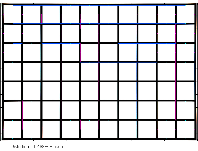

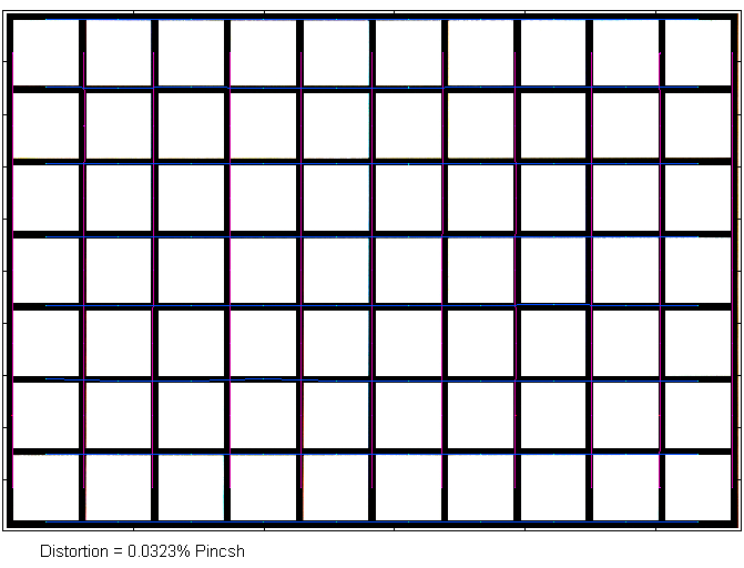

    The Sony FE 85mm f/1.4 GM II produces a marginal pincushion distortion in RAW files. The remaining traces are removed via auto-correction if activated.
    CorrectedRAW

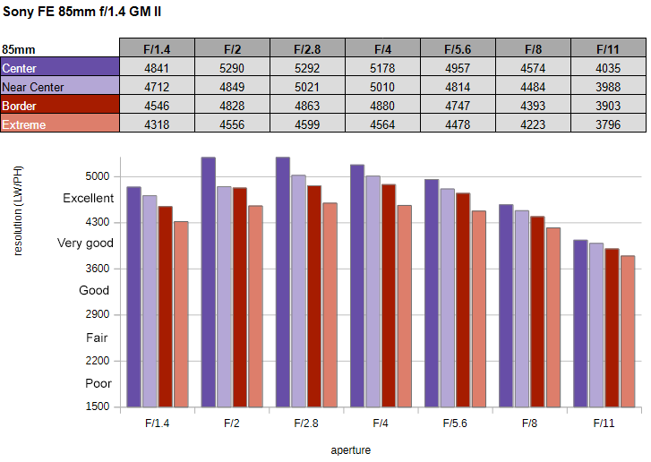

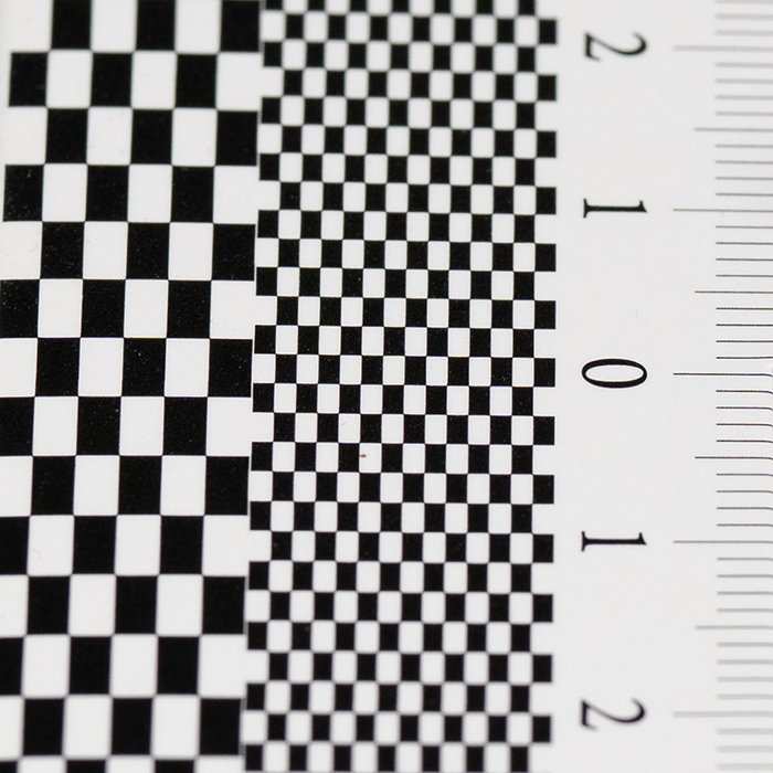

    The Sony FE 85mm f/1.4 GM II delivers impeccable resolution results straight from f/1.4. It doesn’t really get any better than this.
    The field curvature is negligible. The centering quality of the tested sample was very good.

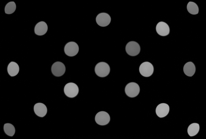

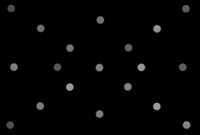

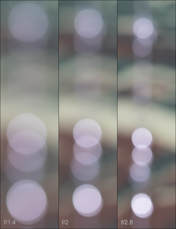

    Sony mentioned that the two XA elements in the design suppress the onion rings that we can often see in out-of-focus highlights and we can confirm this as you can see below. The center highlights remain circular at f/2.8. The edgier aperture starts to show up beyond. You may notice that a tiny bit of outlining is starting to show up from f/2, though.
    When looking at the highlight rendering across the whole image field, we can spot a “cat-eye” deterioration from the circular shape from roughly the mid-field into the corners. As usual, stopping down will broaden the zone showing circular discs, and the corner discs are restored at f/4.
    f/1.4f/2f/2.8

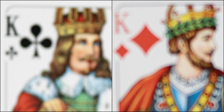

    The rendering quality in the focus transition zone is very smooth in the image background – shown to the left below. The foreground blur (to the right) is busier with more distinctive halos at harsh contrasts.

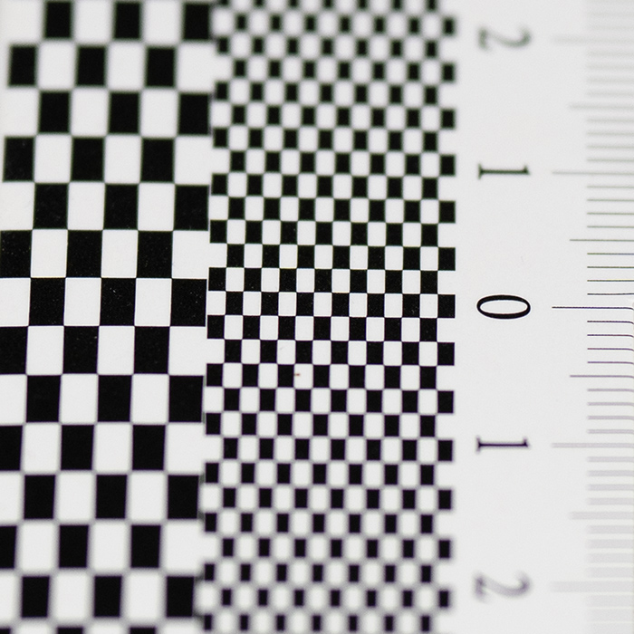

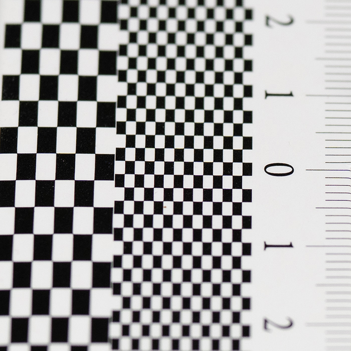

    If the FE 85mm f/1.4 GM II has a weakness, it’s this one. At f/1.4, you can spot some fringing. This is much reduced at f/2. Traces of LoCAs are visible still at f/2.8.
    You may also notice that the focus point remains spot-on when stopping down (= no relevant RSAs). The focus point is also tack-sharp thanks to the floating focusing system.
    f/1.4f/2f/2.8f/4
