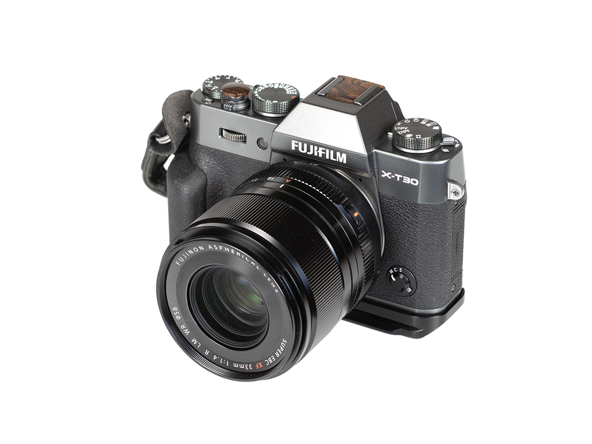

    The Fujinon XF 35mm f/1.4 R is beloved for its smooth rendering characteristics among many Fujifilm users – despite being ancient by now. However, it’s not really a high-performance standard prime lens. For this purpose Fujifilm has another lens up its sleeve – the Fujinon XF 33mm f/1.4 R LM WR. High performance comes at a price – literally – so you will have to invest $950 for the privilege.

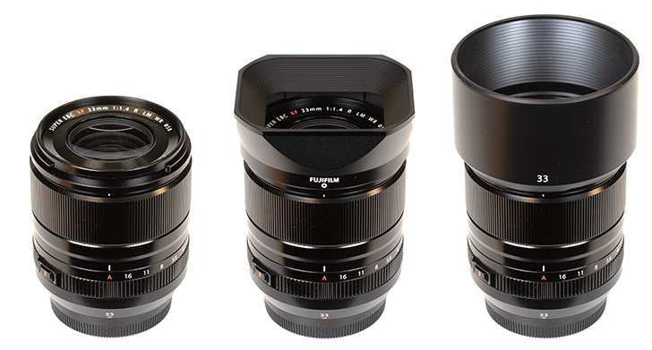

    However, the build quality matches the price tag. It’s an all-metal lens body with weather-sealing, hence the “WR” (weather-resistant) in the name, and it’s even freeze-proof down to -10C. The broad focus ring turns silky smooth. The Fujinon uses an internal focusing mechanism so the physical length doesn’t change. There is, of course, also a dedicated aperture ring (“R”) that can be locked in “A” position. It can’t be “de-clicked”, though. A barrel-shaped lens hood is supplied. However, it is also compatible with the optional square-shaped LH-XF23-2 lens hood which looks quite posh as you can see below.
    The XF 33mm f/1.4 R LM WR uses a linear AF motor (“LM”) which is a magnitude faster and virtually silent than the dated AF motor of the XF 35mm f/1.4 R.

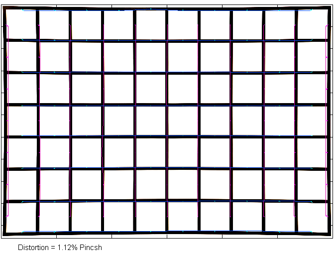

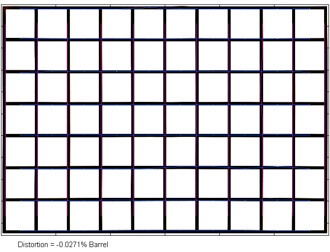

    The XF 33mm f/1.4 R LM WR produces a mild pincushion distortion of ~1.1% in RAW files. Even so, autocorrection restores distortion-free images.

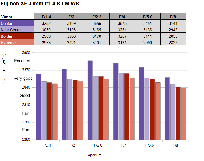

    The XF 33mm f/1.4 R LM WR produces consistently high results across the relevant aperture range. The center quality is very good at f/1.4 and even the outer image field makes it across this mark. Stopping down to f/2 improves primarily in the center. The overall peak is reached between f/2.8 and f/4. Beyond that, diffraction is the limiting factor, as usual.

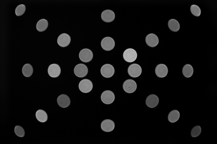

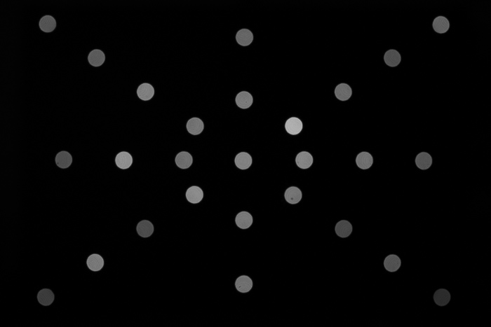

    Out-of-focus highlights reveal a subtle inner substructure, most likely caused by the aspherical elements. However, the discs have no outlining and they are perfectly circular at f/1.4 and f/2. The more edgy aperture shape creeps in from f/2.8 here.
    The above applies to the broader center. However, the highlights deteriorate to “cat eyes” the more they are positioned towards the borders/corners. If you look closely below, you may spot that the peripheral discs do have a one-sided outlining at f/1.4. This disappears when stopping down so for a nicer overall rendering, you may wish to go for f/1.6 instead of f/1.4. The discs are fully restored to their circular shape from f/2.8.
    f/1.4f/2f/2.8

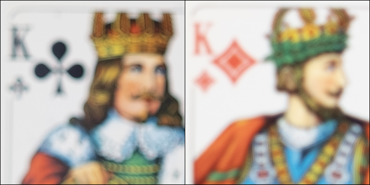

    The general rendering of the out-of-focus blur is good in the background (shown to the left below) although sharp contrasts are a tad too harsh. The foreground blur (to the right) is very smooth which is quite unusual.

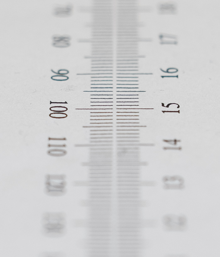

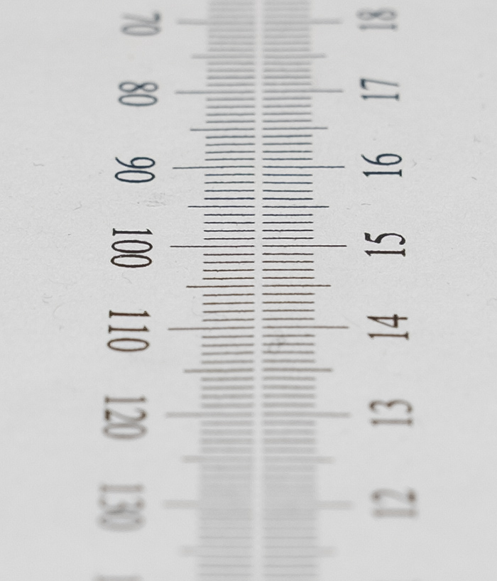

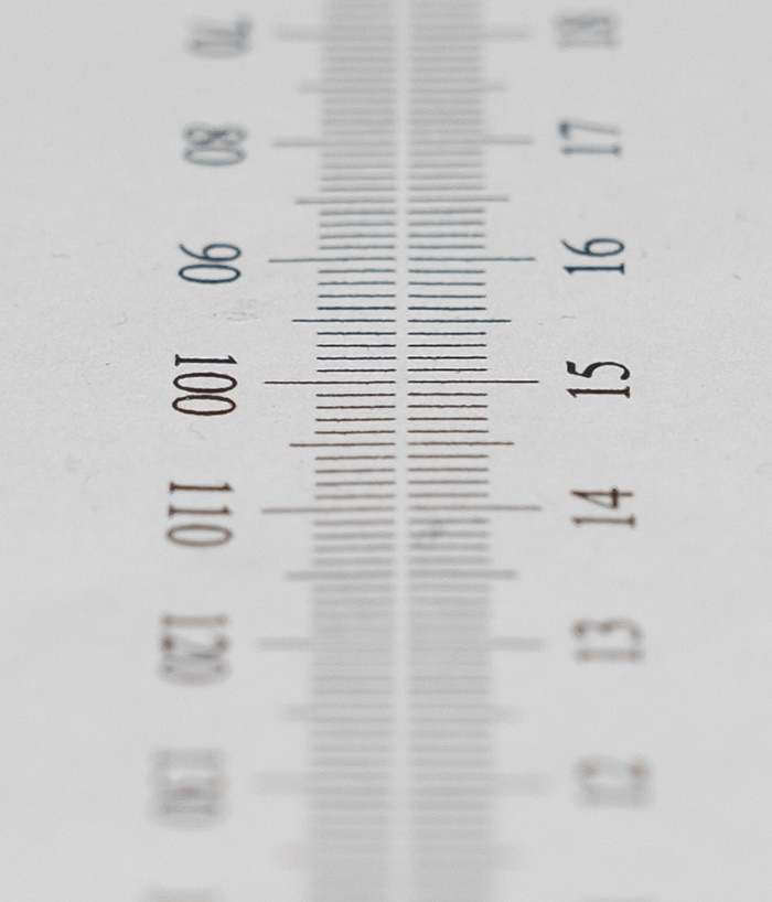

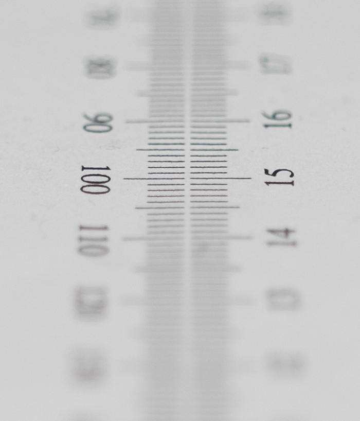

    The Fujinon produces some LoCAs at f/1.4 and f/2. This fades at f/2.8 and the issue is mostly gone from f/4. Overall, this is nothing out of the ordinary for such a lens.
    f/1.4f/2f/2.8f/4
