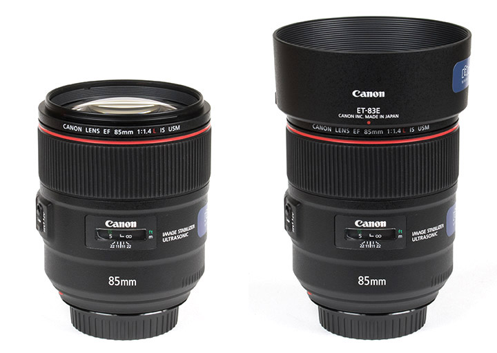

    The build quality of the Canon EF 85mm f/1.4 USM L IS is superb as you can expect from a Canon L class lens. The lens body doesn’t seem to be made of metal but Canon’s high-quality plastic based on a metal mount. That size of the lens remains constant throughout the focus range and it does, of course, feature weather-sealing. The focus ring operates smoothly. The supplied lens hood is a bit disappointing – it is barrel-shaped but comparatively short.

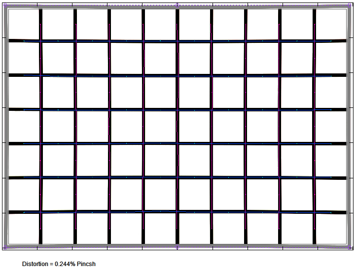

    The Canon EF 85mm f/1.4 USM L IS produces a very slight pincushion-type distortion as you can see below.
    85mm
    The vignetting characteristic is typical for such a lens. Thus there’s some substantial light falloff at fully open aperture (1.8EV). Stopping down to f/2 reduces the issue and the vignetting is pretty much gone from f/2.8 onward.

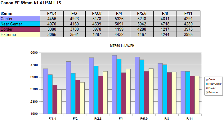

    MTF (resolution at 50 megapixels)
    50 megapixels are quite a hammer for most lenses but the Canon EF 85mm f/1.4 USM L IS managed nicely. The center and near-center quality are very good at f/1.4 and the outer image region is at least decent. Stopping down to f/2.8 increases the quality substantially and it’s best around the f/4 to f/5.6 mark with a bitingly sharp center and very good borders/corners. Diffraction effects are getting somewhat more obvious from f/11 onward.
    The centering quality of the tested lens was good. The field curvature is low.

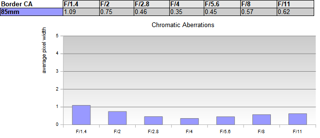

    Lateral CAs are low across the aperture range. They peak at f/1.4 with an average pixel width of 1.1px at the image borders. From there on they are decreasing towards medium aperture settings.

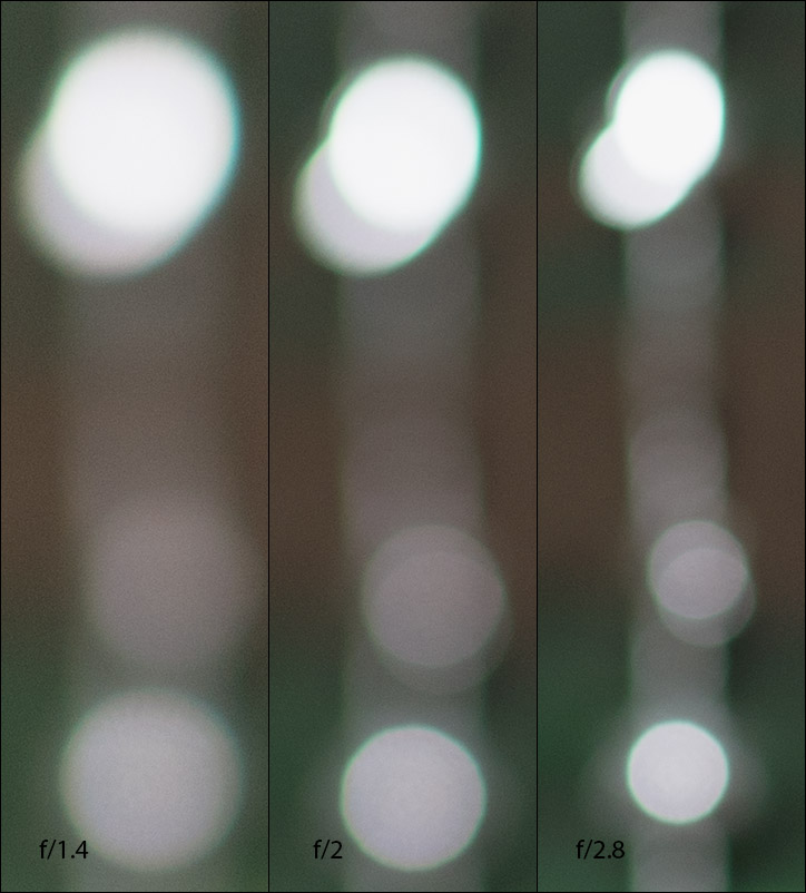

    Let’s take a look at the quality of out-of-focus highlights first. In the image center they are nicely rendered with a smooth inner disc and a perfectly circular shape until about f/2.8. This is about as good as it gets on a conventional lens at least.

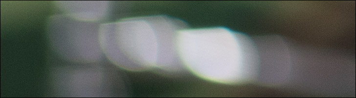

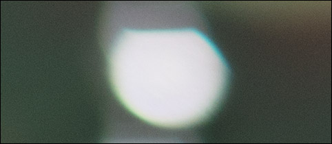

    That being said, the discs deteriorate quickly. Below is a sample crop that was taken mid field at f/1.4. You can easily spot that the disc has been “cut” there – a vignetting effect that can be reduced by stopping down.
    The effect is emphasized the further you look into the image corners – see below. Please note that this is not unusual although it’s somewhat more pronounced on the Canon lens possibly because the front element of the lens is relatively small. The Sigma 85mm f/1.4 DG HSM ART is showing more pleasing highlights in the image corners and it has a much bigger front element.
    As far as the general blur is concerned, it’s smooth in the image foreground (to the right below) and even more silky in the image background (to the left).

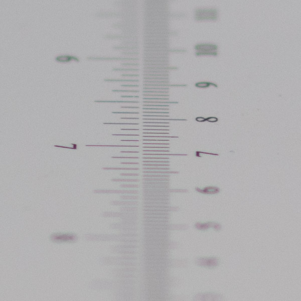

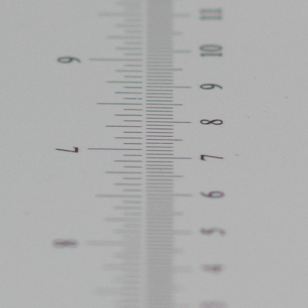

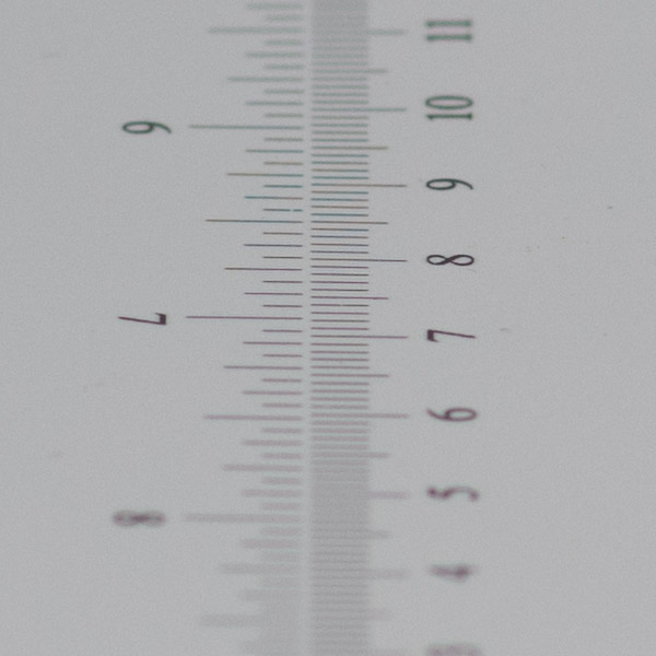

    In a perfect world scenario, you won’t see any axial CAs thus color fringing on the Z-axis. However, only a handful of fast lenses are correcting the issue effectively and the Canon EF 85mm f/1.4 USM L IS is not among them. When scrolling through the provided sample crops below, you should be able to spot the usual purplish color fringing in front of the focus point and a greenish halo beyond. The fringing is most pronounced at f/1.4 and decreases from there. However, you can still spot traces at f/4.
    You should also be able to notice that the focus point does NOT shift when stopping down. Many high-speed lenses have difficulties keeping the focus point spot on – focus-shifts or so-called Residual Spherical Aberrations (RSA).

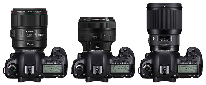

    Most users will decide between three different lenses in this class – the Canon EF 85mm f/1.4 USM L IS (to the left below), the EF 85mm f/1.2 USM L II (center) and the Sigma 85mm f/1.4 DG HSM ART (right). There are further fast 85mm f/1.4 lenses from e.g. Zeiss and Samyang but these are manual focus lenses and therefore usually in the exotics realm. In terms of sheer optical qualities, the EF 85mm f/1.2 USM L II is certainly inferior but it is faster still and the bokeh is also a tad better. Interestingly the old lens is much shorter. The Sigma 85mm f/1.4 DG HSM ART gives the Canon lenses a run for the money and it is the sharpest of the gang. On the downside, it struggles a bit in terms of focus accuracy and it’s an even bigger brick to carry.
