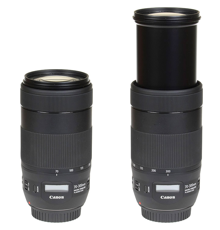

    The build quality of the lens is pretty good for a consumer-grade lens. It follows the same new (outer) design philosophy that we have seen in the EF-S 18-135mm f/4.5-5.6 USM IS. It doesn’t look overly exciting in our opinion but your mileage may vary. Anyway, the lens body is made of good quality plastic based on a metal mount. The zoom and focus rings are rubberized and offer quite smooth action. The lens extends when zooming towards the long end of the range. However, unlike its predecessor, the inner tube does not rotate during focusing. A transport lock is provided. A curious little new feature is an LCD on the lens. First seen on Zeiss Batis lenses (albeit in OLED variant here), it provides information about focal length, focus-distance or depth of field. Whether this is useful on this specific lens … well … it doesn’t hurt anyway.
    Another very obvious difference compared to the mk I is the focusing speed. It is BLISTERINGLY fast and easily as fast as the fastest Canon lenses that we have tested to date (yes, believe it or not). The AF motor changed from a slow micro-USM to Canon’s brand new Nano-USM. Nano-USM is also dead-silent. Nano-USM has one side-effect though – in manual focusing mode there’s no mechanical coupling anymore thus you are driving the AF motor when turning the focus ring. However, we don’t consider this to be a drawback. A further improvement relates to the image stabilizer. The new one has an efficiency of up to 4 f-stops. Whether you can reach that depends on your coffee saturation which is costing me one stop at least.

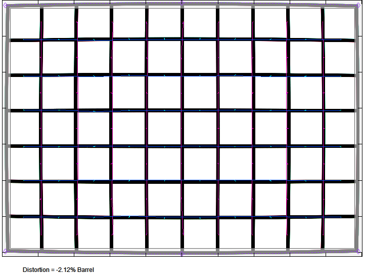

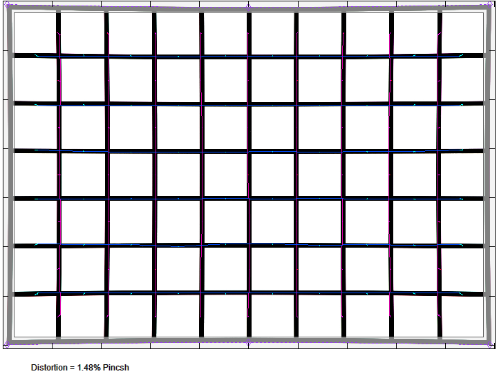

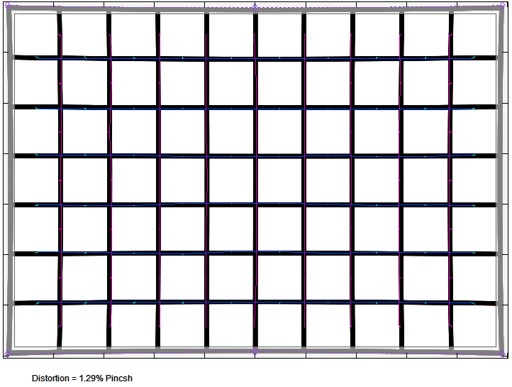

    The Canon EF 70-300mm f/4-5.6 USM IS II produces a fairly high amount of image distortions for a tele lens. At 70mm you will have to live with a medium barrel distortion (2.1%) switching to medium pincushion distortion at 200mm to 300mm. This is nothing extreme but it’s visible in scenes with straight lines (i.e. architecture).

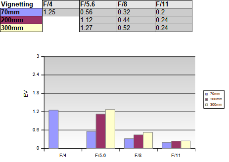

    The vignetting characteristic is about typical for a lens in this class. At fully-open aperture, the light falloff varies between 1EV (70mm) and 1.6EV (200mm). Stopping down by 1 f-stop reduces the issue to an almost negligible degree at the wide end whereas you may prefer to stop down a little more at the 135mm and 200mm marks.

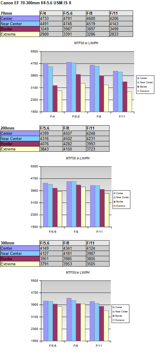

    In the introduction, we mentioned that the mk I lens produces stunning sharpness but that was back in the day. So how does the mk II perform at 50 megapixels? Well, we are more than impressed for sure. At 70mm the center reaches excellent levels at f/4 and f/5.6 although there’s still a bit of headroom here. The borders/corners are very good. Stopping down improves the quality only slightly. Diffraction effects limiting the resolution are getting more obvious at f/11. The sweet spot is in the middle range where the center zone is pushed to superb quality and the borders/corners improve a little as well. The center sharpness is maintained at 200mm whereas the quality of the outer image region is slightly reduced albeit it remains on a very high level.
    The centering quality of the tested sample was very good. There’s minimal field curvature at 70mm.

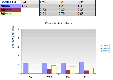

    Lateral chromatic aberrations (color shadows at the image borders) are very low. At 70mm, they vary around the 1.1px mark at the image borders. CAs are at their lowest (negligible) level in the middle range and increase just slightly again towards the 200mm end.

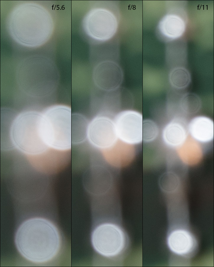

    Due to its max aperture of f/4-5.6, the Canon lens is hardly a bokeh monster but you can easily produce shallow depth-of-field images when shooting at short to medium focus distances. We didn’t do our full analysis this time but let’s at least have a look at the characteristic of out-of-focus highlights.
    Thanks to the 9 aperture blades the (near-center) highlights are nicely circular at f/5.6 and even at f/11. However, they show a bit of outlining as well as an onion-like sub-structure, which is emphasized the more you stop down. The circular highlights deteriorate to the usual “cat eyes” the more you move to the image corners. As usual stopping down helps with this albeit from a real-life perspective you won’t really do so due to the small max aperture anyway.

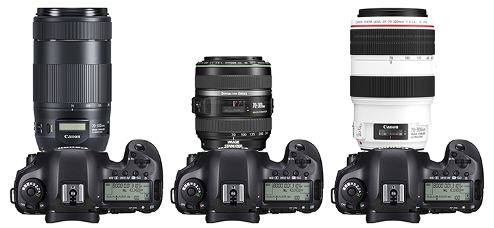

    In the 70-300mm class, you have various options. If you’d like to stick to Canon, there’s the EF 70-300mm f/4.5-5.6 DO IS (center) as well as the EF 70-300mm f/4-5.6 USM L IS (right). The “DO” lens is obviously much shorter thanks to its diffractive optics element. However, in mechanical and optical terms it isn’t really any better and it’s a much more expensive lens. The EF 70-300mm f/4-5.6 USM L IS has, of course, a superior build quality. Optically it has an evener performance characteristic across the range and it is a tad better in the image center. That being said, its price tag is at 1350USD/EUR vs 450USD/550EUR for the EF 70-300mm f/4-5.6 USM IS II (to the left below). A more realistic competitor is the Tamron SP AF 70-300mm f/4-5.6 USD VC Di. However, the Canon lens is superior in most respects and it costs only a little more.
