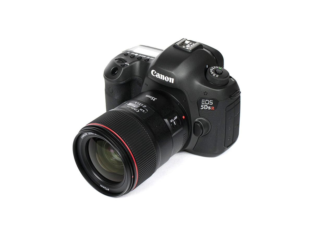

    Eventually all good things must go and this time it has hit the Canon EF 35mm f/1.4 USM L. Released back in late 1998, it has been along for the ride for quite some time. However, lately Canon was starting the feel the heat namely from the Sigma 35mm f/1.4 DG HSM Art and the Tamron 35mm f/1.8 Di VC so here we go again with a refreshed version … let’s welcome the new Canon EF 35mm f/1.4 USM L II. Obviously a member of the “Luxury” (L) league, it is primarily targeting professionals. Canon seems to think that money is no issue in this case because the pricing has been lifted to new heights as well. At 1800US$/2000EUR, it is probably beyond a price point where the fun ends for most mortals nowadays.
    The most significant new feature in this lens is Canon’s new BR or “Blue Spectrum Refractive” element. To cite Canon: “The optical element offers characteristics that significantly refract blue light to achieve what the developer is calling “impressive levels of (axial) chromatic aberration correction”. Canon also applied its new fluorine coating to repel dust and smearing on the front and rear elements. The new SWC (sub-wavelength coating) on the rear surfaces of the first two highly curved elements is meant to reduce flare. We’ll see whether all this can make a difference… and justify the price tag.

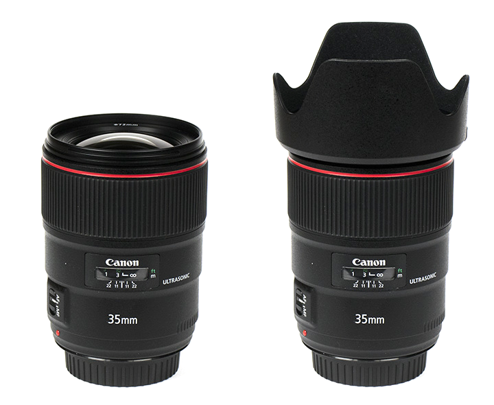

    If you know the old lens, you will notice that the mk II is quite a bit longer (2cm) and also heavier (180g). This is promising to some degree – bigger tends to be better after all. Whether you appreciate this in your lens bag may be a different story though. Typical for such professional grade lenses it is beautifully crafted based on a metal body and high quality plastics. Canon also claims to have improved the weather sealing compared to the mk I version. The very broad, rubberized focus ring has a smooth action. The size of the lens remains constant regardless of the focus setting. A deep petal-shaped hood is included.
    As usual Canon used its Ring-type USM AF in this lens. While it is certainly near-silent, we think that the AF speed is slightly reduced albeit still fast. Full-time manual (FTM) focusing is, of course, always possible in One-Shot AF mode.
    Optical construction14 elements in 11 groups (1xBR, 2x aspherical, 1xED)
    SWC coating
    fluorine coating
    min. focus distance0.28m (max. magnification ratio 1:4.75)
    Dimensions80 x 106mm
    Weight760g
    Filter size72mm
    Other featuresweather sealing
    MountsCanon EF

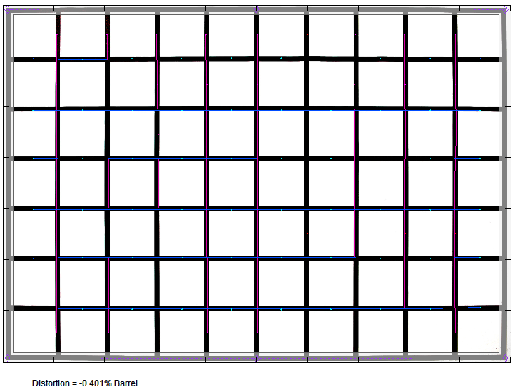

    Let’s start with the simple things – distortions. No issues here really. A barrel distortion of just 0.4% is pretty much irrelevant in most situations.

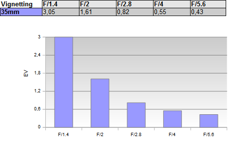

    Very fast lenses usually suffer from pronounced vignetting at large apertures, and the new Canon lens is no exception to this rule here. Wide open, there is a hefty amount of light fall-off (3EV) towards the corners. As usual, stopping down reduces the amount of vignetting considerably. At f/2.8, vignetting is down to moderate levels and from f/4 onward it should no longer be an issue for most subjects. Still the lens isn’t that special here.

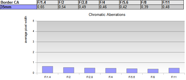

    Chromatic aberrations (color shadows at harsh contrast transitions) are very well controlled showing readings below an average pixel width of 0.5px at the image borders.

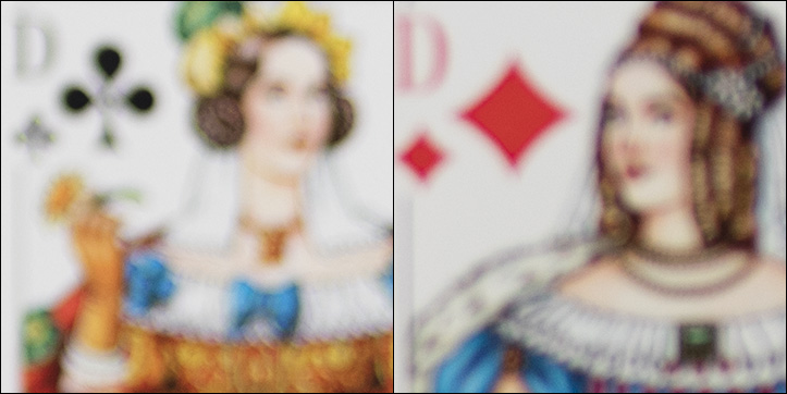

    One of the primary usage scenarios for a large aperture lens is to separate the main subject from the background. In such an image the quality of the bokeh (out-of-focus blur) is of major significance. The Canon lens delivers a quite smooth bokeh for a wide-angle prime but like most wide-angle lenses it is not perfect here.

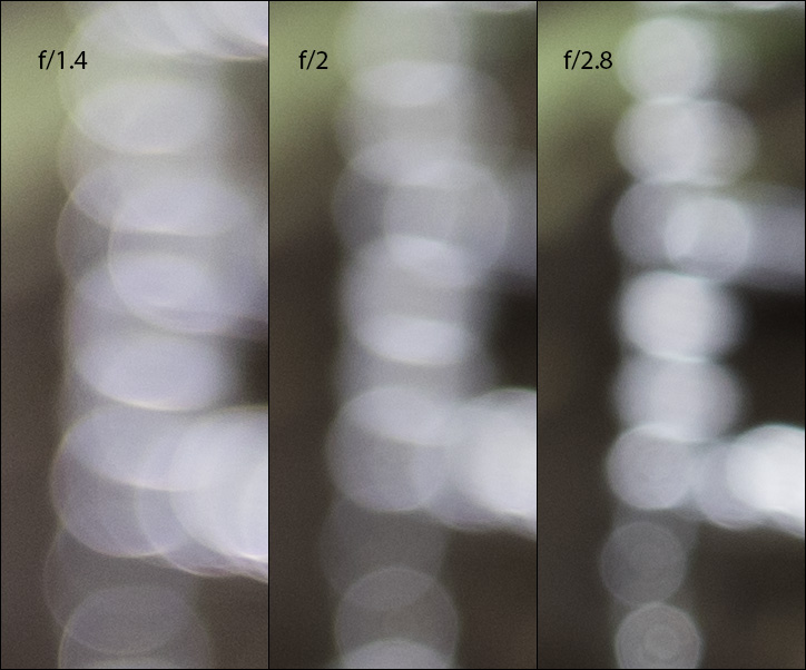

    Out-of-focus highlights are nicely rendered in the center zone. They show a slight outlining effect at f/1.4 but this effect is gone when stopping down to f/2 already. The inner zone of the highlight disc is smooth with only marginal traces of sub-structures.

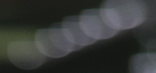

    However, even this mighty Canon lens isn’t capable of delivering circular highlight discs at the image borders. Below is an example of “cat’s eyes” taken at the bottom of the image (middle section). This is a vignetting effect that dissolves the more you stop down.
    The foreground is quite buttery whereas the more critical image background is somewhat more harsh when it comes to contrast transitions.

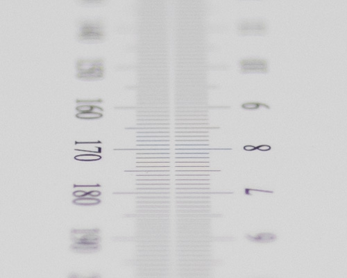

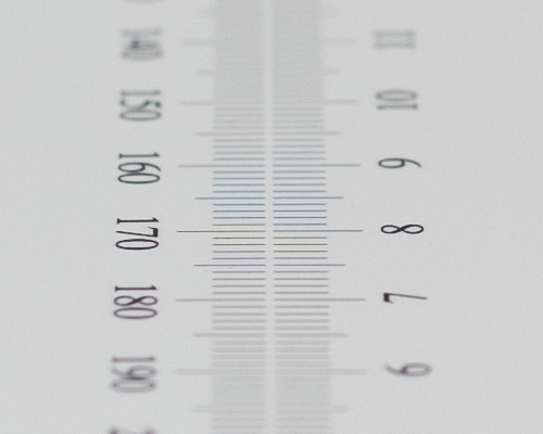

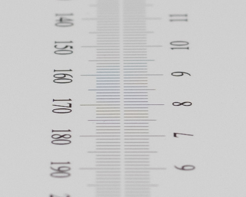

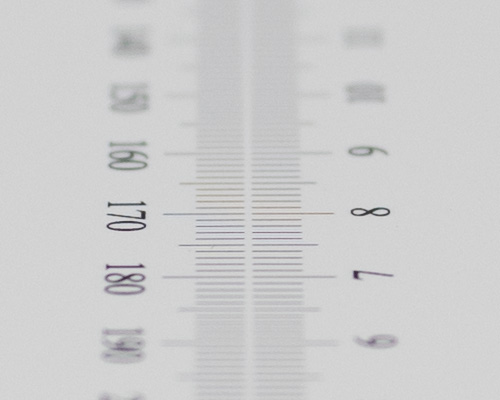

    As mentioned in the introduction, Canon uses a “BR” element to reduce axial chromatic aberrations in the EF 35mm f/1.4 USM L II. Bokeh fringing effects are normally a largely unresolved issue – also because they are very difficult to remove during post processing. The good news is that this BR element does make a difference here. You can still spot some purple halos in the front of the focus point and green ones beyond but they are certainly reduced significantly.
    In addition, these shots illustrate a focus shift towards the rear the more you stop down. Since the focus point doesn’t really lose its focus, it’s not really significant enough to show up in most images though.
