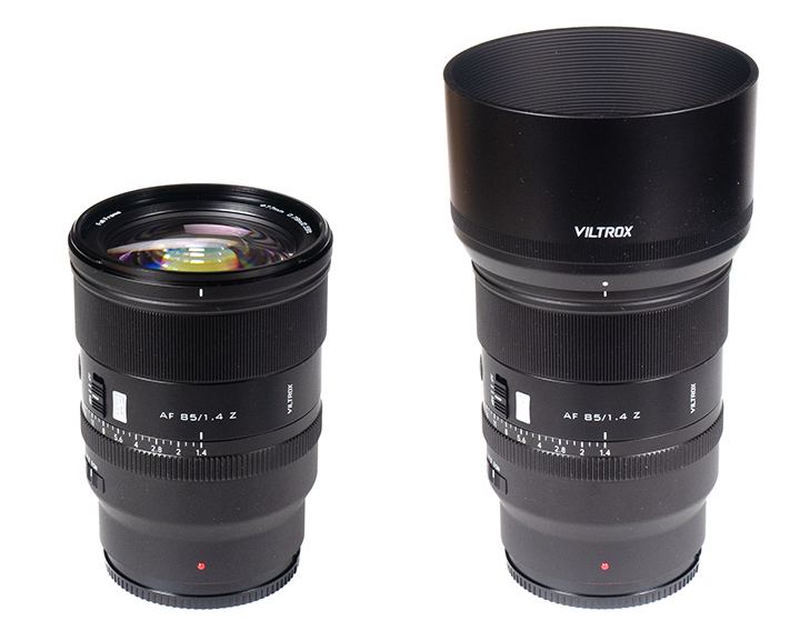

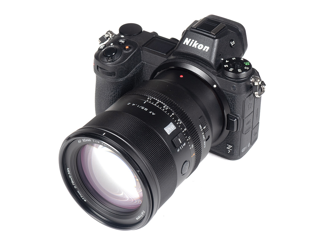

    The build quality of the Viltrox AF 85mm f/1.4 PRO Z is excellent thanks to a tightly assembled all-metal design. At 800g, it is on the heavy side, though. Weather sealing is provided, and combined with the inner focusing system, it should be able to provide some protection against the elements. The focus ring turns smoothly. In terms of controls, there is also a de-clickable aperture ring. There is also a custom button and the usual AF/MF switch. A petal-shaped lens hood is included.
    The lens uses a “VCM” (Voice-coil Motor) for autofocusing. It’s a linear motor instead of the simpler stepping variant. The AF is fairly snappy, although not “sporty” (on our old Z7 anyway). Firmware updates are possible via the Viltrox app (also desktop now) and USB-C connection. The app can also be used to configure the custom Fn button. Manual focusing works by wire – as usual. This works well.

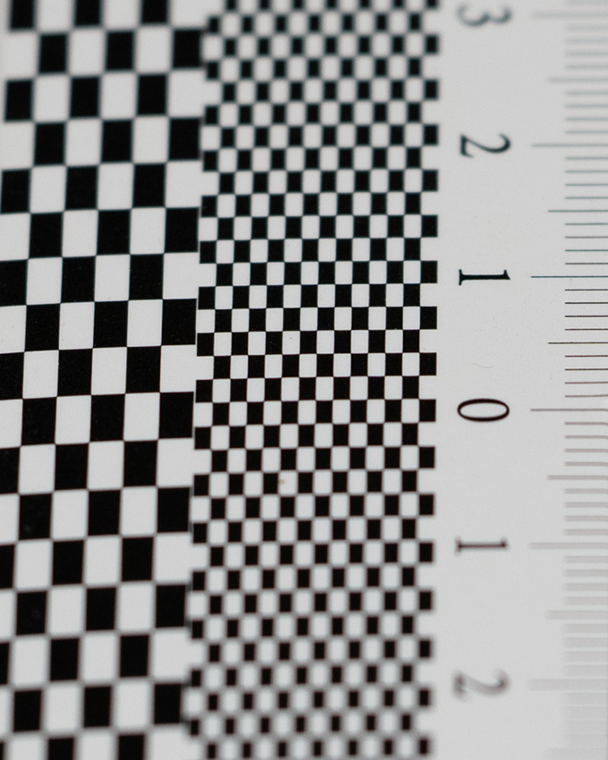

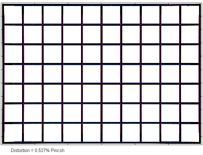

    The lens produces a native image distortion of ~0.5% pincushion-style. This is better than usual in this age of mirrorless cameras. Viltrox does not provide a correction profile (at the time of this writing). However, the level is low enough to be irrelevant in most scenes anyway.
    The difference from the Sony version is within the expected margin of error in this category.

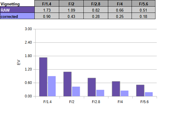

    The raw vignetting is typical for an ultra-fast medium tele lens. At f/1.4, the light falloff exceeds 1.7 EV (f-stops). Stopping down to f/2 cuts this down by 2/3 EV. And it’s acceptable from f/2.8. Unlike in the Sony version, the Nikon version can take advantage of autocorrection here. When activated in “high” mode on the camera, the vignetting is reduced to less than 1 EV (f-stop) at max aperture, and it’s mostly irrelevant beyond.
    Please note, that the vignetting tests are heavily influenced by the tonal curve, which is different between Sony and Nikon, so the results differ slightly in this category.

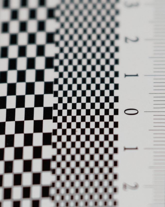

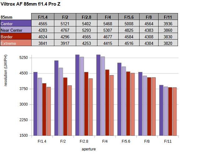

    The Viltrox AF 85mm f/1.4 PRO Z is very sharp at all mainstream aperture settings. The center quality is very good to excellent at f/1.4, and the outer image field is easily on a very good level. Stopping down to f/2 provides a boost in the broader center – and more so at f/2.8. The outstanding peak quality is reached at f/4. Diffraction is the limiting factor beyond. You won’t really notice this at f/5.6, but f/11 and aperture settings beyond should be avoided unless you require the depth-of-field.
    The centering quality of the tested sample was good. The field curvature is flat. The MTF result is consistent with the Sony test. Subtle differences are due to the different sensors and parameter settings.

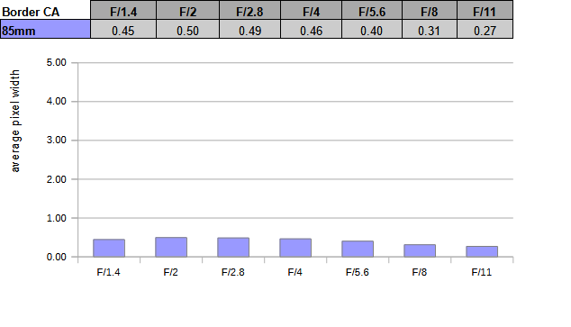

    Lateral CAs are low at large aperture settings and even decrease somewhat from f/4 onward.

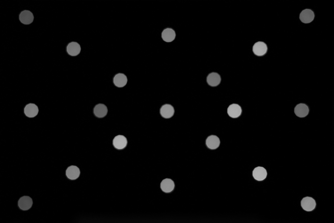

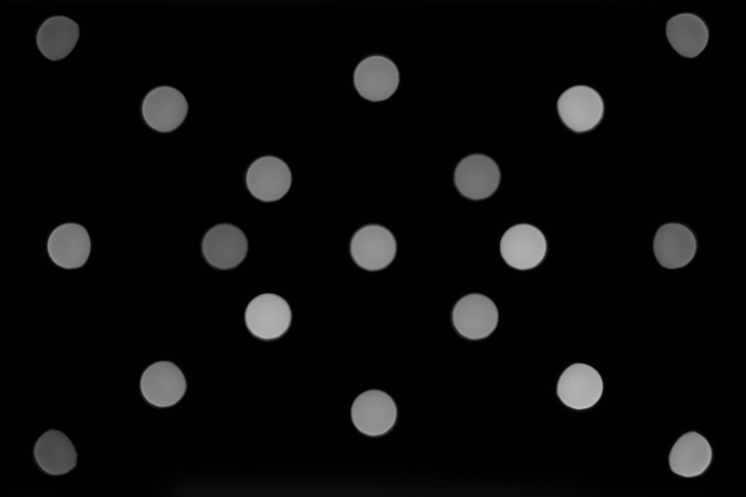

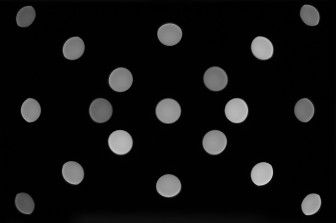

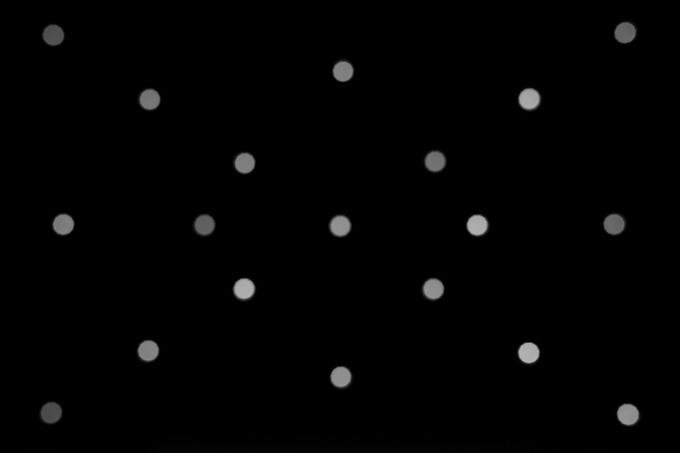

    Out-of-focus highlights are nicely rendered near the image center. The inner zone of the discs is very smooth despite two aspherical elements in the design. There is an outlining at the edges, which is more visible in highlights beyond the center (more obvious in a bigger scene). The circular shape remains intact at f/2. A slight edginess creeps in at f/2.8.
    When looking at the highlight rendering across the image field, we can see a shape deterioration from the midfield onward at f/1.4. The corner highlights have a slight cat eye effect, but it’s comparatively subdued (e.g., compared to the Sigma 85mm f/1.4 DG DN). As usual, stopping down increases the “perfect” zone, although the corner shapes aren’t fully restored until f/2.8.

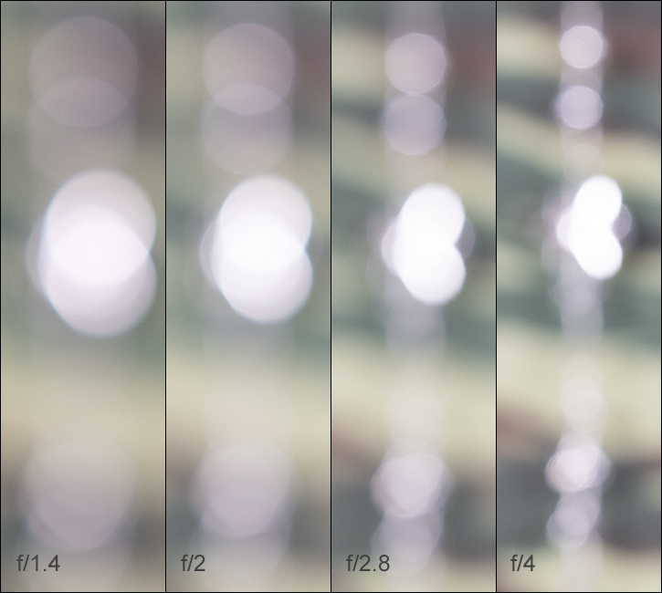

    f/1.4f/2f/2.8f/4

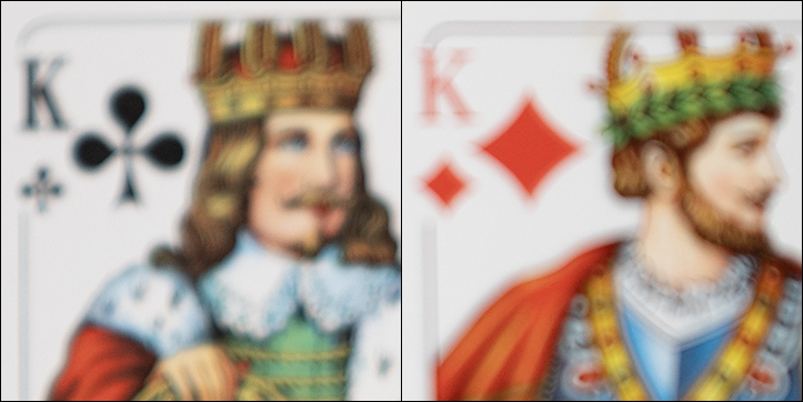

    The blur in the focus transition zone is quite smooth in the image background (shown to the left below), but a bit “shadowy” in the less important foreground (to the right).
    As you can see below, the Viltrox lens shows some color fringing at f/1.4 – with the background being quite “hazy” here. Stopping down to f/2 reduces it substantially, and the issue is mostly gone from f/2.8.

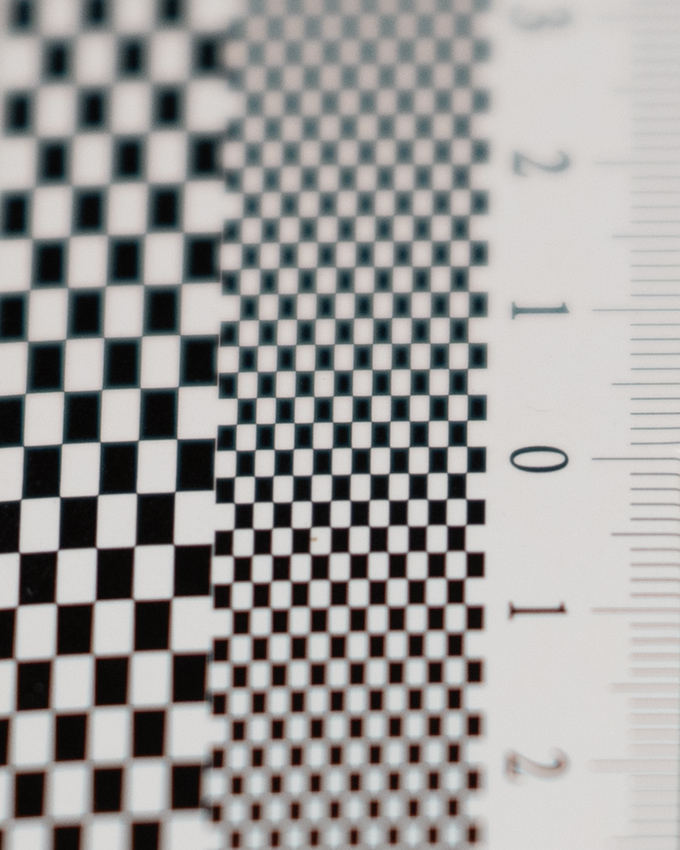

    There is, however, a noticeable focus shift (RSA – “Residual spherical aberrations”) towards the rear here. The camera’s AF should be able to handle this, though. Keep it in mind with manual focusing at very close distances – probably an exotic use case with such a lens anyway.
