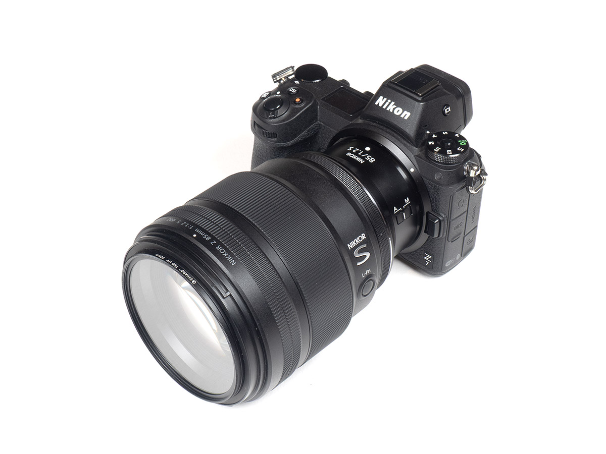

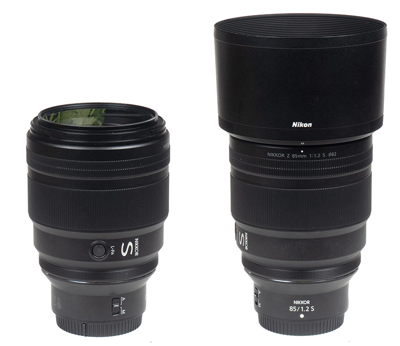

    In terms of build quality the lens follows the usual recipe for high-end Nikkors. It is made of a high-grade polycarbonate outer barrel built over a metal chassis. The plastic shell doesn’t help much with its weight which sits at a whopping 1.16 kg. The massive glass elements simply take their toll here. Typical for S-class lenses, there’s extensive weather sealing. It features a wide, smoothly turning focus ring. Unfortunately, the focus action feels mechanically “detached” which is something that we’ve noticed with other Nikkors as well. There’s also the configurable control ring which defaults to aperture control but it can be configured to ISO or exposure compensation as well. Nikon also implemented a L-Fn button as well as an AF/MF switch. A deep barrel-shaped lens hood is part of the package.
    The AF is based on a multi-focus system utilizing dual stepping motors (STM). AF actions are not as fast as on the Z 85mm f/1.8 but still pretty quick and good enough for tracking at typical working distances. The noise level during operation is very low. Focus breathing is low but detectable with long focus pulls.

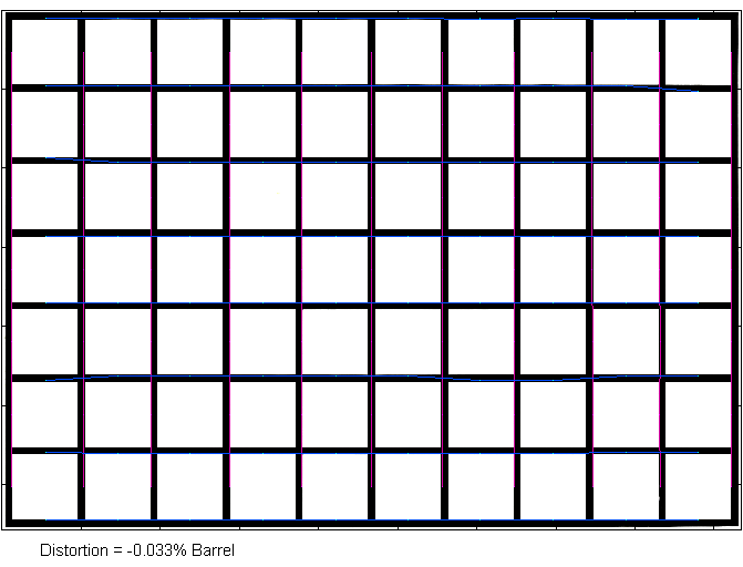

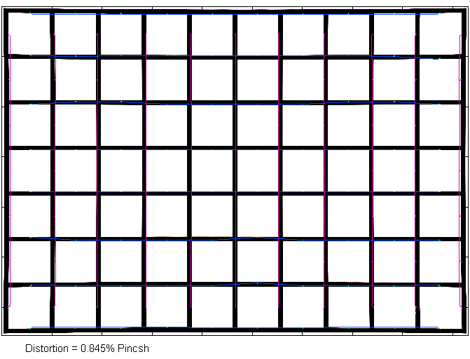

    The Nikkor Z 85mm f/1.2 S produces a fairly mild pincushion distortion of ~0.8% at normal working distances. Autocorrection can take advantage of the built-in profile to eliminate the rest.

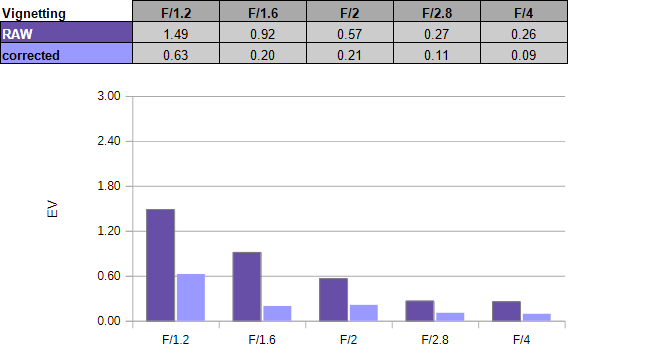

    The Nikkor Z 85mm f/1.2 S is very well corrected in terms of vignetting. The RAW vignetting is still visible at f/1.2 but at just 1.5 EV (f-stops) it is lower than average in this lens class. This is reduced to just under 1 EV at f/1.6 and the issue is mostly irrelevant from f/2 already. If needed, autocorrection reduces the issue by almost 1 EV at f/1.2 and it’s negligible beyond this setting then.

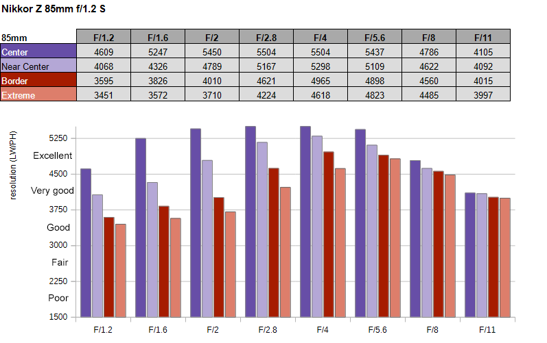

    Such ultra-fast lenses are primarily optimized to deliver reasonable quality at maximum aperture already – which is very difficult because the optical problems rise dramatically with the speed. Keeping this in mind, the Nikkor Z 85mm f/1.2 S delivers an impressive job here. The dead center resolution is excellent at f/1.2 already. The quality then drops to a very good near-center and a good outer image field. Stopping down to f/1.6 boosts the center to outstanding levels although the rest of the image field improves only marginally. The center exceeds the potential of the 45mp sensor at f/2 and the near-center quality reaches excellent results here. The outer image field sees a major uplift from f/2.8. A truly stunning quality across the image field is achieved between f/4 and f/5.6. f/8 is affected by diffraction. f/11 is still usable and f/16 (not shown) should be avoided as usual.
    The centering quality of the tested sample was good. Field curvature is minimal.

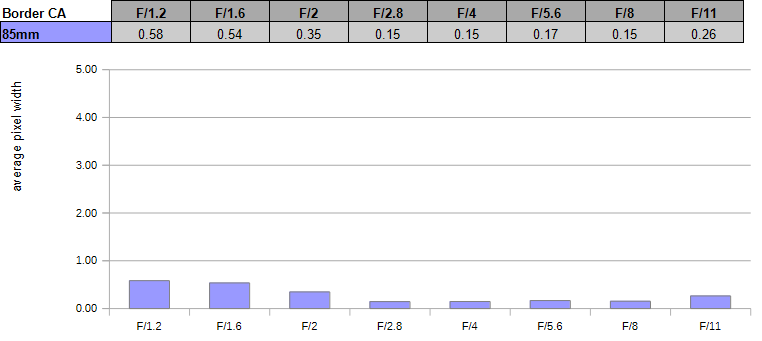

    Lateral CAs are very low overall. At large aperture settings the border CAs reach a width of just ~0.5px and it’s even lower at medium apertures. Autocorrection can handle this with ease.

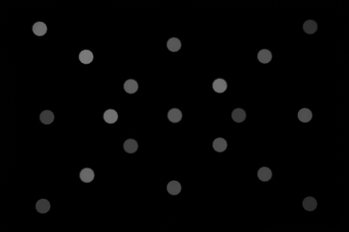

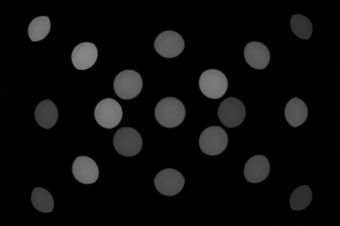

    Out-of-focus center highlights are very clean at f/1.2. The disc edges are slightly feathered which is exactly what you want here for smoothness. If you look closely, you may spot some “stripes” in the inner zone. Possibly a polishing issue on one of the lens elements? Stopping down to f/1.6 or f/2 maintains the circular shape although the edge of the discs sharpens up a little here. The more edgy aperture setting starts to get a bit more pronounced from f/2.8.
    When looking at the whole image, the circular highlight shape is maintained in the broader center but there is the usual deterioration to “cat eyes” towards the corners. The “perfect” zone is broadening the more you stop down and the corner discs are restored from f/2.
    f/1.2f/1.6f2f/2.8

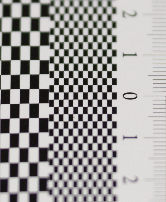

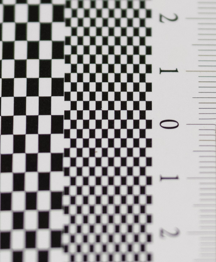

    LoCAs are a color-fringing effect on the Z-axis.  They show up as purplish/yellowish halos in front of the in-focus zone and greenish/bluish beyond.  The fringing is very obvious at f/1.2 and f/1.6 . It’s still present at f/2 and gone from f/2.8.
    If you scroll through the aperture range, you may also notice a slight focus point shift to the rear (residual-spherical aberrations or RSA). The initial focus point remains within the depth-of-field, though, so it’s not relevant in real-life.
    f/1.2f/1.6f/2f/2.8
