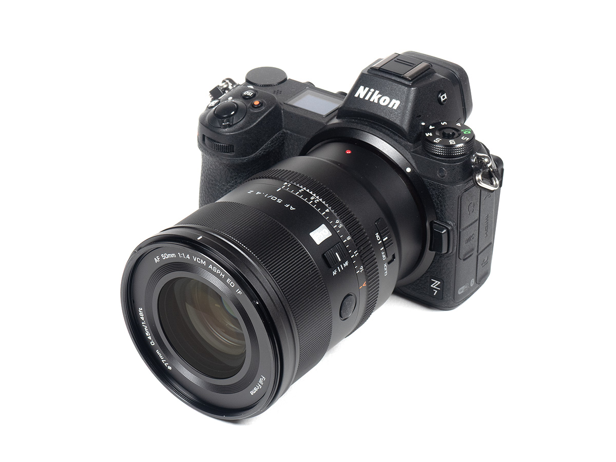

    This is another look at the Viltrox AF 50mm f/1.4 Pro, but this time in Nikon Z mount. Most of the findings are similar, if not identical, to our Sony E-mount review, so we’ll reuse some of the article here. The Z-mount version has a retail price of $549 USD (619EUR / 525GBP / 799CAD / 90400JPY), That’s just slightly more than the slower Nikkor Z 50mm f/1.8 S.

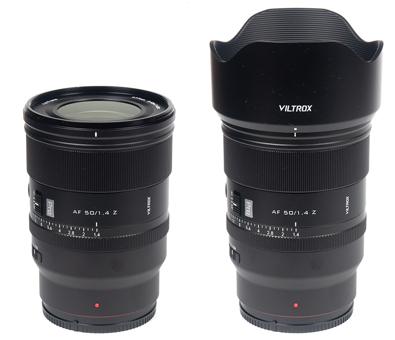

    The lens body is made of metal down to the mount. It’s not a small lens, and combined with the tough construction, it is on the heavy side at 800g. Viltrox has also implemented some degree of weather-sealing. The focus ring operates smoothly. It exhibited a rubbery squeak in our sample, though. It also features a de-clickable aperture ring with a nice click action. As you can see below, a deep, petal-shaped lens hood is part of the package.
    The lens uses a quick Dual HyperVCM Motor for silent and pretty fast autofocusing. Manual focusing works “by-wire”, as usual. Firmware updates are possible via a USB-C port on the lens mount with the Viltrox app for mobile phones.

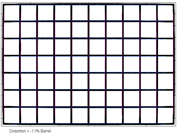

    The lens produces a mild barrel distortion of ~1.1%. While this isn’t negligible, it is usually not disturbing. There is no profile built-in for distortion correction.

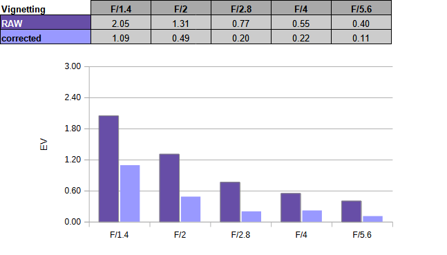

    The RAW vignetting is typical for a lens in this class. At f/1.4, there’s a quite heavy light falloff of 2 EV (f-stops). As usual, stopping down improves the issue, and it’s down by ~0.8EV (f-stops) at f/2 already. Moderate vignetting is reached at f/2.8, and beyond it, shouldn’t be visible anymore in most scenarios.
    Unlike the E-mount version, the 50mm f/1.4 Z does have a correction profile for vignetting. It reduces the light falloff by about 1 f-stop at f/1.4. The vignetting is still visible, but it’s not dramatic. The issue is negligible from f/2 onward in this case already.
    Note: The tone curve differs between Nikon and Sony, so the RAW vignetting figures are slightly different.

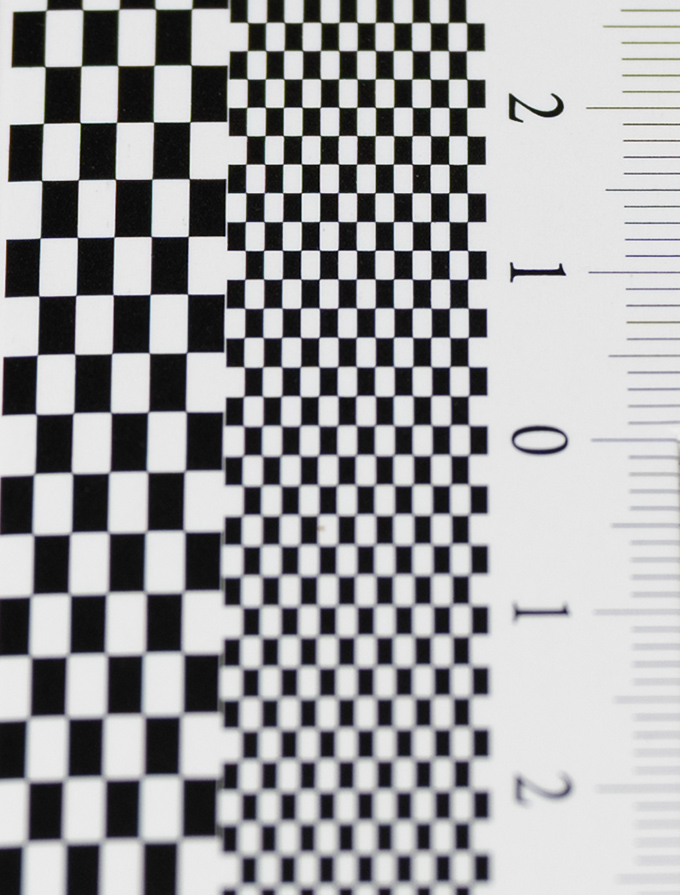

    The Viltrox AF 50mm f/1.4 Z Pro produced quite impressive resolution results in our lab. The image center is already excellent at wide-open aperture. The quality in the outer image field isn’t quite as high, but you can still expect good to very good quality here. Stopping down to f/2 doesn’t make a really noticeable difference, but there’s a boost at f/2.8, and more so at f/4. The center is downright outstanding here, and the border quality is excellent. The corners are very good at this setting. The corners still improve a little at f/5.6. Diffraction has a slight impact from f/8. f/11 remains perfectly usable, but you should avoid f/16, as usual.

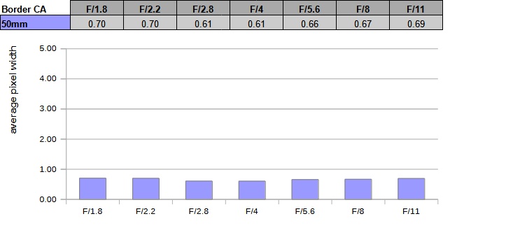

    Lateral CAs are slight at all aperture settings, even without corrective measures. The border CAs hover around an average CA pixel width of 0.7px.

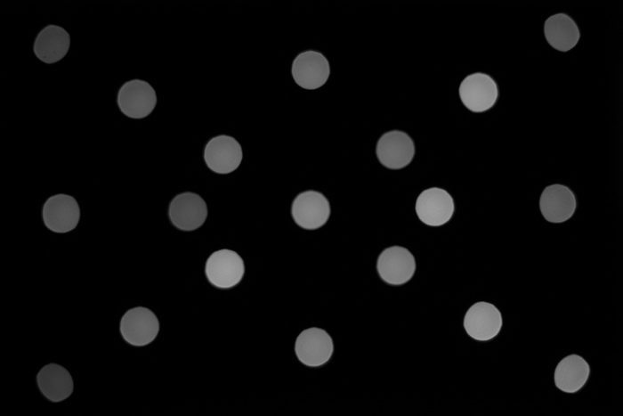

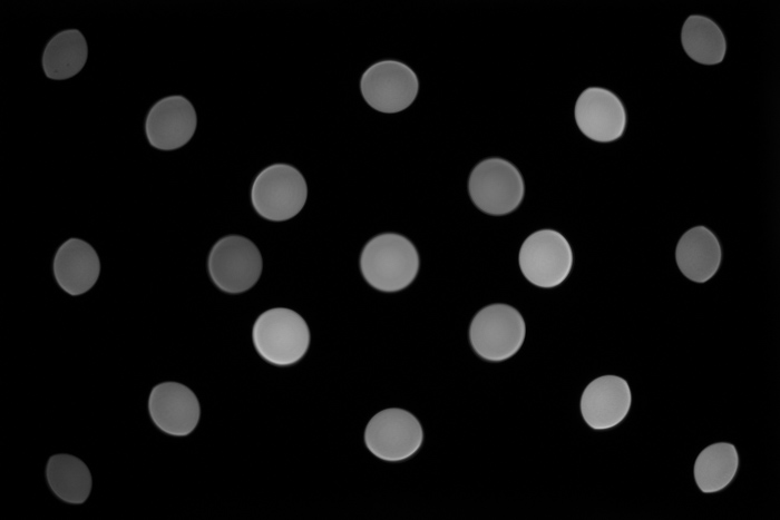

    In the image center, the lens produces clean out-of-focus highlights with a smooth inner disc zone and only slight outlining. It’s worth noting that there is some outlining visible beyond the broader center, though. The lens has 11 aperture blades, which helps with maintaining the circular shape (near the center) up to f/2. The slightly more edgy aperture shape creeps in at f/2.8.
    When looking at the rendering of the highlight discs across the image field, we can see a moderate deterioration to a more cat-eye-like shape in the corners. From the midfield, there is also some stronger outlining – this is also visible in the sample gallery. Stopping down to f/2 restores most of the border/corner highlight discs already, and the disc outlining is also mostly gone. The discs are fully restored from f/2.8, which is comparatively “early”.

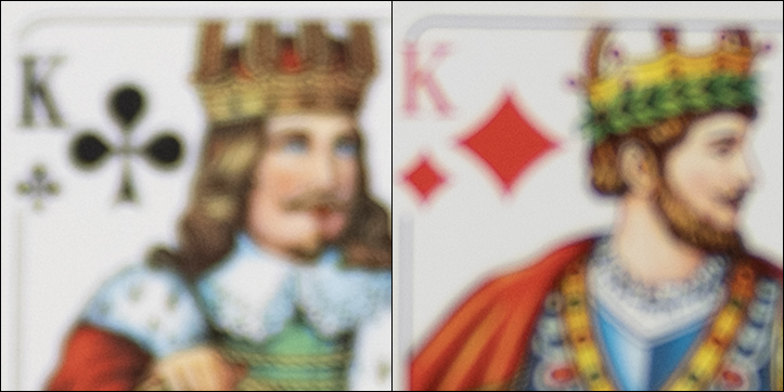

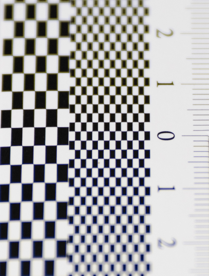

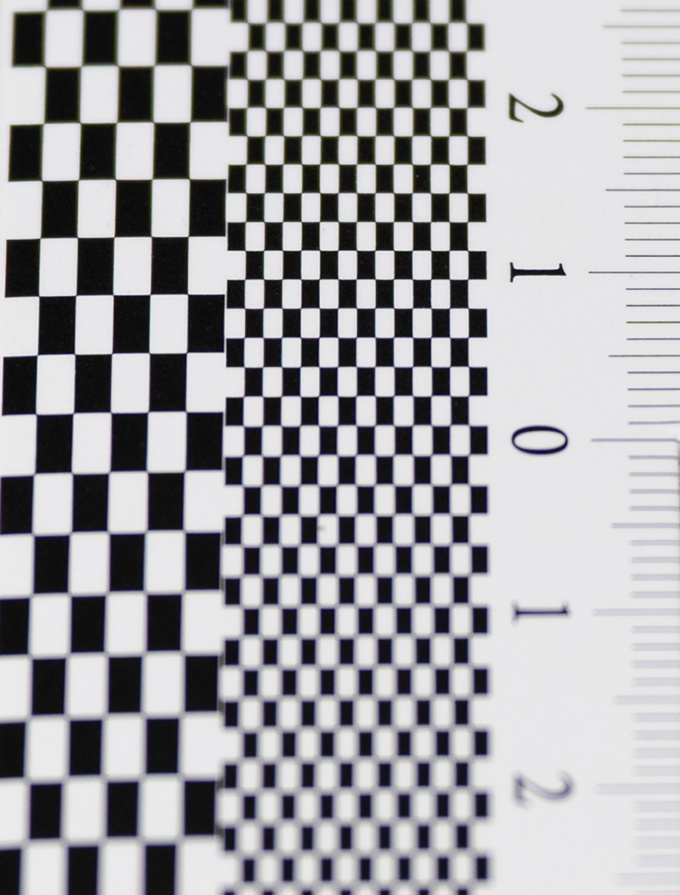

    As you can see below, the Viltrox lens shows significant color fringing at f/1.4, and it’s still very noticeable at f/2. The fringing is significantly improved at f/2.8 and gone from f/4 onward.
    What you may also notice when scrolling through the different aperture settings: the focus shifts towards the rear when stopping down. These shifts are caused by RSA (residual spherical aberrations). While this isn’t unusual for fast lenses, you should check your images at very close focus distances (unless you used f/1.4 or a small aperture).
