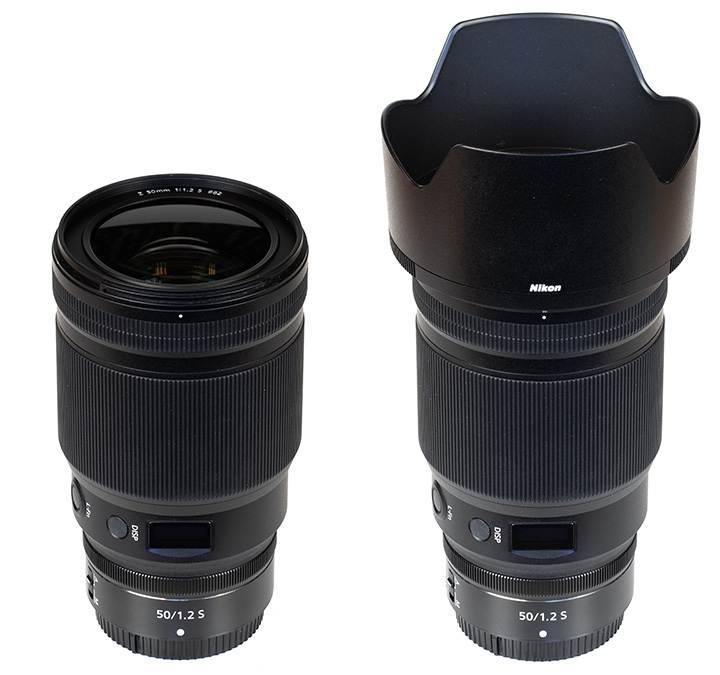

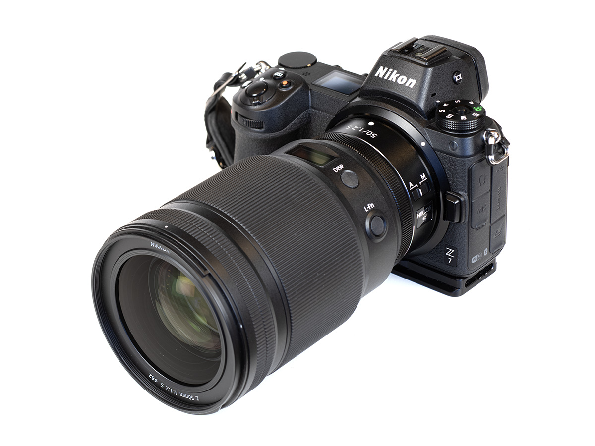

    Upon first contact, you will notice that Z 50mm f/1.2 S is a brick of a lens. It weighs over 1 kg and it’s also quite long for what it is. As far as the mechanical design is concerned, it uses Nikon’s common recipe for high-end lenses. The outer shell is made of high-grade engineering plastics over a metal core. It is, of course, weather sealed. Besides the rubberized focus ring, there’s also a customizable control ring at the rear. The latter can be programmed to adjust your aperture, ISO, or exposure compensation. The top OLED information panel can be used to verify aperture, focus distance, and depth of field. As you can see below, a petal-shaped lens hood is part of the package.

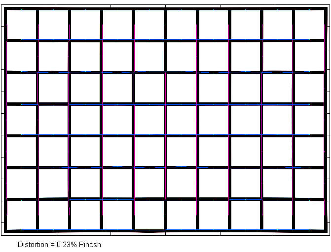

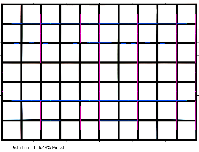

    The Nikkor Z 50mm f/1.2 S is already very well corrected in RAW files with a pincushion distortion of just 0.2%. Autocorrection eliminates the rest, as usual.

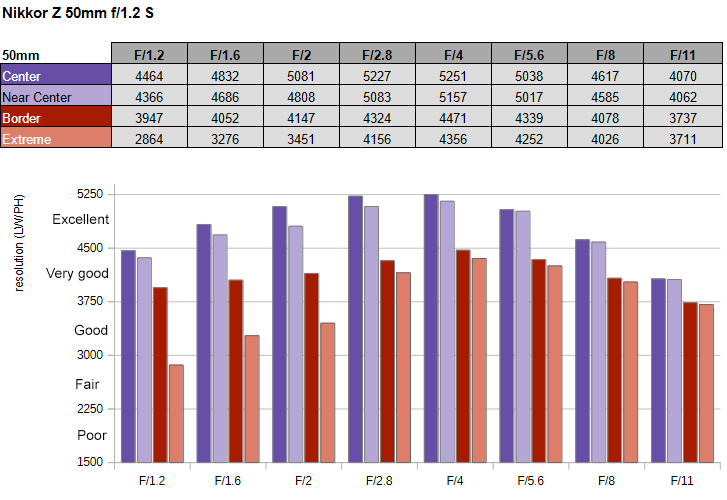

    The optical design problems increase exponentially towards very high speeds. A perfect 50mm f/1.2 is basically impossible. Nikon did a good job here nontheless. At f/1.2, the broader center and even the border region reach very good quality. However, the corners are a bit soft. Whether this matters in real life is a different question, of course. The performance is lifted at f/1.6 with the center now achieving excellent quality and the corners being good at least. The quality increases further until reaching the peak at f/4. The broader center is superb here and the outer image field easily achieves a very good quality level. Diffraction effects impact the quality from here and you shouldn’t stop down beyond f/16, as usual.

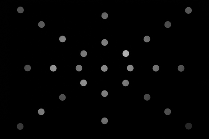

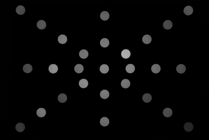

    The discussion about the sharpness is important, but when shooting at high speeds you tend to be as interested in the bokeh. So let’s check it out.
    Out-of-focus highlights are very clean at f/1.2 (well, apart from the dust spots there) with only a negligible onion-ring substructure. The edges of the discs show no outlining whatsoever. The shape of the center discs is perfectly circular at f/1.2 and mostly so at f/1.6. The more edgy aperture shape creeps in at f/2 which is a little “early”.
    When looking at the whole image, the circular highlight shape is maintained in the broader center but there is the usual deterioration to “cat eyes” towards the corners. The “perfect” zone is broadening the more you stop down and the corner discs are restored from f/2.
