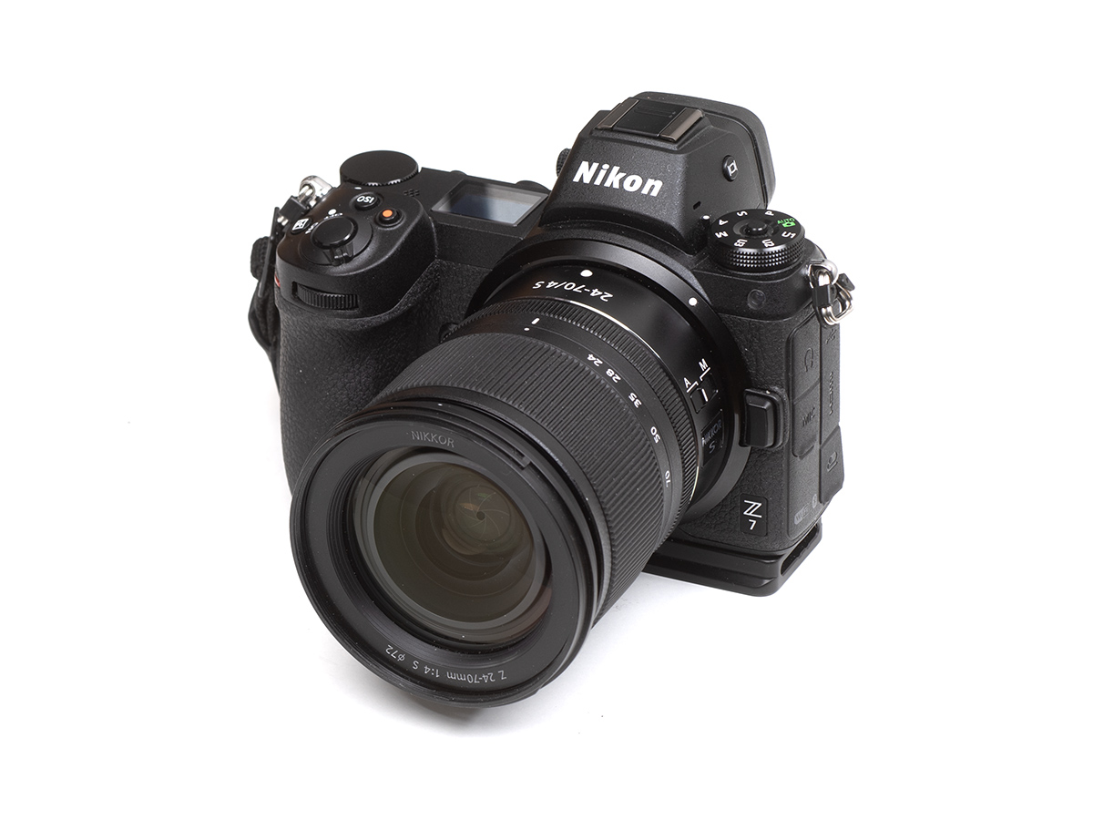

    Our review of the Nikkor Z 24-70mm f/4 S feels almost like doing time travel. It was the first Nikkor released in Z-mount back in 2018. And yes, we are late with this one. A colleague had the test data in storage for years actually, but life got in the way as it sometimes happens. This review is actually part of a longer series based on such accumulated test data that we’ll release in the coming weeks.
    A bit of a surprising aspect of the Nikkor Z 24-70mm f/4 S is that it’s both a kit lens as well as a member of the “S” series of lenses. The latter marks Nikon’s high-performance lineup. That’s certainly reflected in its rather high price tag of $1000 USD. If you are interested in this lens, you should rather look into a camera kit where the lens is heavily discounted. And it’s usually available for bargain prices on the used market.

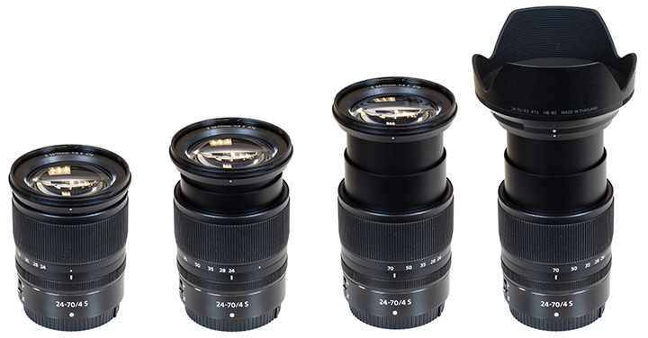

    One of the first aspects that you will notice upon picking up the lens is its retractable design. Thus you have to “twist-to-extend” it to its actual working position. This allows for a very compact dimension for transport but it’s cumbersome nonetheless. The outer shell is made of high-grade engineering plastics based on a metal mount. It uses a duo-cam mechanism that extends the lens when zooming out. We aren’t huge fans of this approach because it’s quite an air (& dust) pump. However, Nikon has implemented dust- and weather-sealing. A customizable control ring is used for manual focusing but it can be configured to handle the aperture, ISO, or exposure compensation.
    The Nikkor uses a STM (stepping motor) for auto-focusing. It is both snappy and near silent. Focus breathing is minimal. The lens can focus down to 0.3m or a maximum object magnification of just 1:3, which is pretty good and approaches macro lenses.

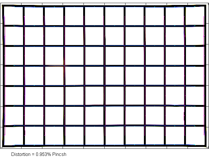

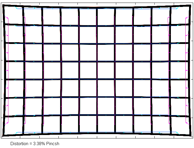

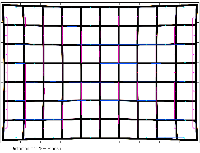

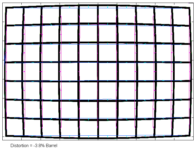

    Modern zoom lenses often produce massive image distortions in RAW files, and the Z 24-70mm f/4 S has its share of problems here. At 24mm there is a heavy barrel distortion (3.8%) which switches to pincushion still beyond the 28mm setting already. They are quite heavy at 50mm and increase further towards the 70mm (~3.4%).
    24mm35mm50mm70mm

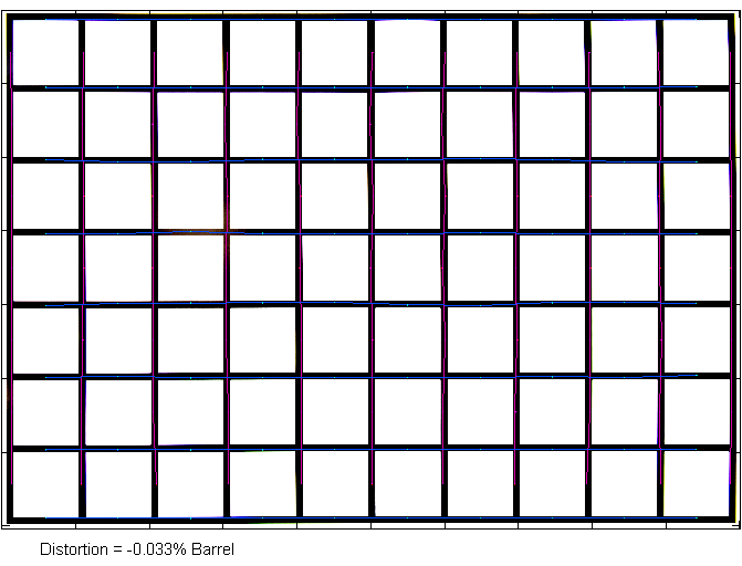

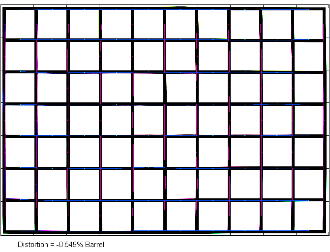

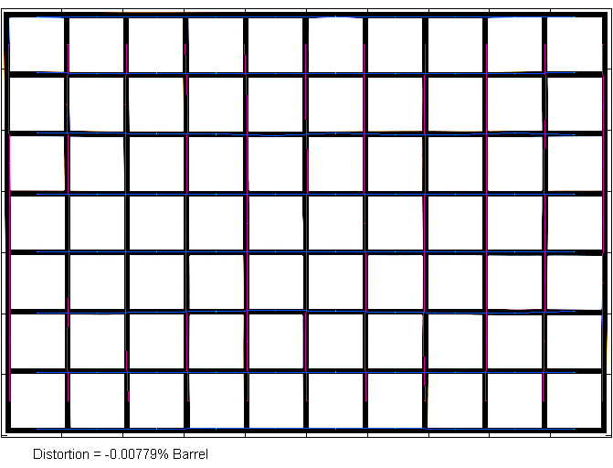

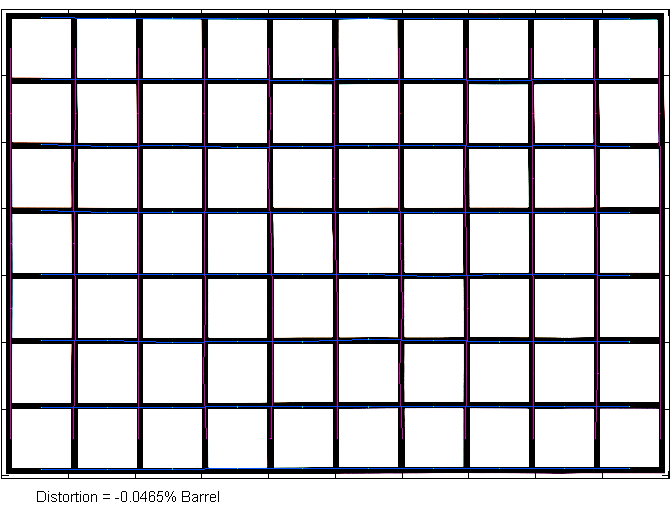

    Image auto-correction has to come to the rescue then and it works perfectly as you can see below.
    24mm35mm50mm70mm

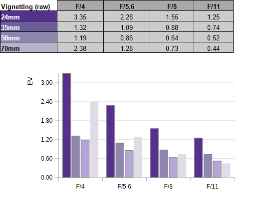

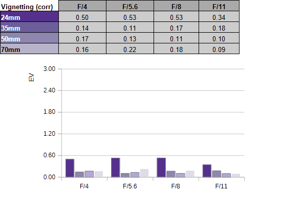

    It’s a similar story regarding vignetting. At the extreme ends of the zoom range, the light falloff is very heavy at more than 3EV (f-stops) at 24mm and 2.4EV at 70mm. Stopping down helps, as usual, but the vignetting remains noticeable at the wide end even at f/11.
    Once again, autocorrection saves the day. However, keep in mind that this comes at the cost of increased corner noise due to the signal boosting.

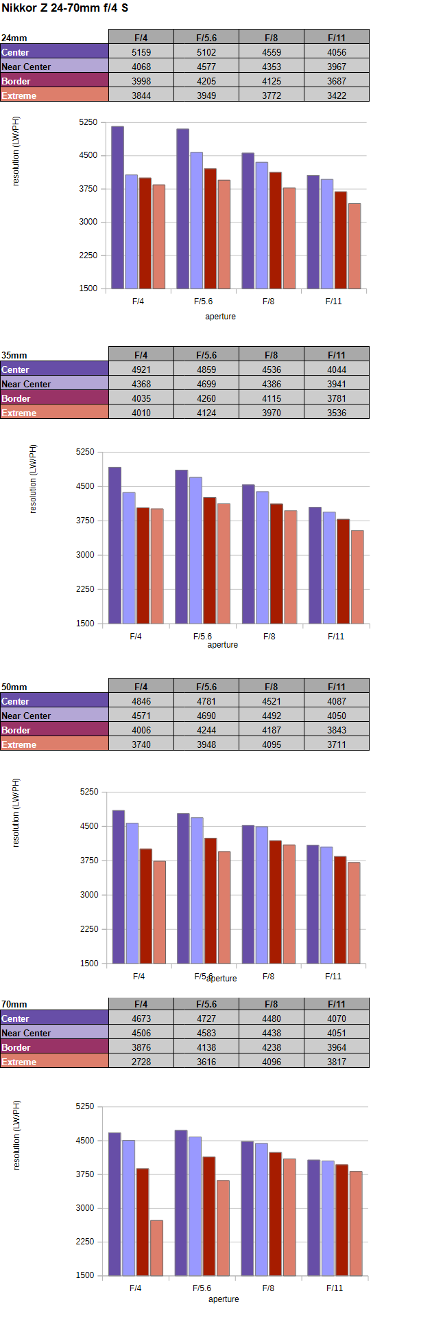

    The Nikkor Z 24-70mm f/4 S produced decent resolution figures in the lab. At 24mm the dead center quality is great straight from f/4 although it drops soon thereafter. There is a bit of field curvature at this setting, though. The overall quality improves a bit at f/5.6 before the usual diffraction effects set in. The quality is maintained throughout the middle range. At 70mm f/4, the broader center is sharp but the corners are very soft. They do recover nicely when stopping down reaching very good quality at f/8.

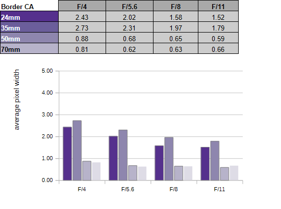

    Lateral CAs are the most obvious aspect where the age of the lens is showing up. At more than 2px on average at the image borders, they are on the heavy side in the lower part of the zoom range. And this increases further in the corners. Stopping down helps but it’s still not a glorious aspect. It’s a lesser issue from 50 to 70mm, though.
    Keep in mind that lateral CAs are losslessly compensated in JPEGs and via most RAW converters so it’s not a big deal in real life.

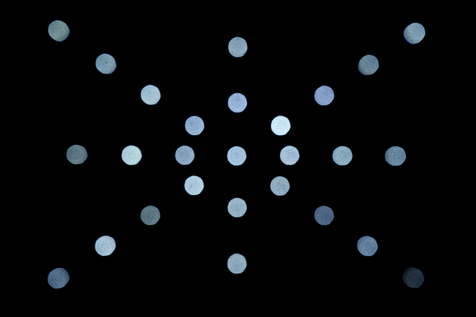

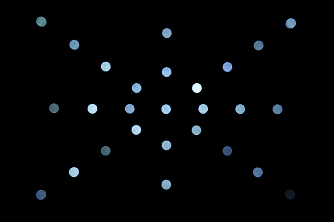

    The Z 24-70mm f/4 S isn’t really aligned to produce a shallow depth-of-field, but let’s check out the bokeh rendering.

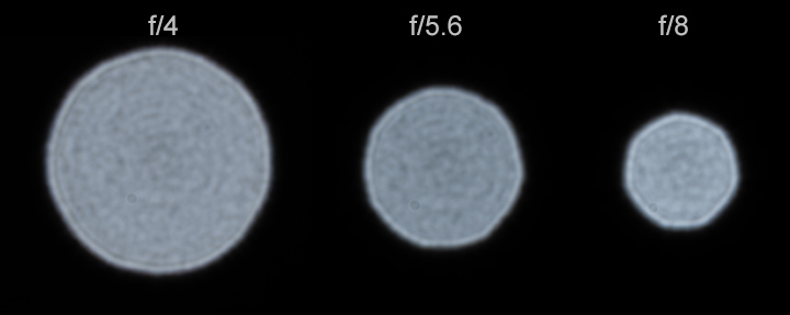

    Out-of-focus highlights are nicely circular in the image center. However, the discs show a very busy inner structure typical of lenses that use aspherical elements. There’s only a slight outlining at f/4. It’s getting more obvious at f/8, though.

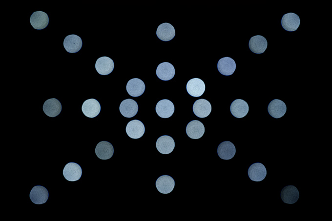

    When looking at the whole image at 70mm f/4, the circular highlight shape is mostly maintained across the image which is rather surprising. This is a rare characteristic.
    f/4f/5.6f/8

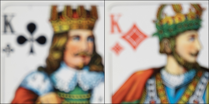

    The general blur in the focus transition zone is quite smooth in the image background (shown to the left below). The foreground blur is busier and a bit shadowy.
