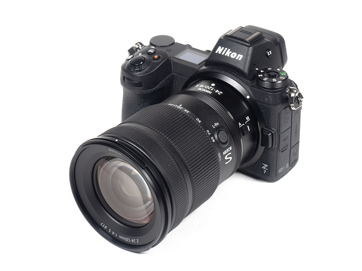

    While not intimidatingly large upon first contact, it’s not a small lens. However, it uses a duo-cam zoom design, so it extends quite a bit when zooming toward the long end of the range, and with an attached hood, it essentially doubles in length. We are not a huge fan of the duo-cam design for long-term durability – a single extending tube should be enough, really. However, the tested sample showed no wobbling whatsoever, even at the 120mm setting. In terms of materials, Nikon used engineering plastics based on a metal mount. They also implemented some sealing against the elements. The zoom action is pretty smooth, and turning the focus ring feels silky. A somewhat cheap-feeling petal-shaped lens hood is part of the package.
    The Z 24-120mm f/4 S uses an STM (stepping motor) for autofocusing. This is a slightly dated approach in theory, but the AF is both snappy and silent, so there’s nothing wrong with this here.
    You may have already concluded from the lens name that, unlike the old DSLR lens, there is no optical image stabilizer. Some may raise an eyebrow because of this, but we actually like this design choice – the mechanical construction is already complex enough as is.

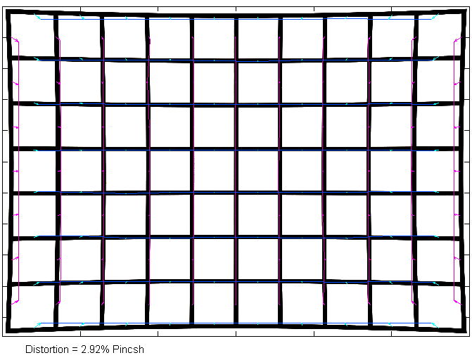

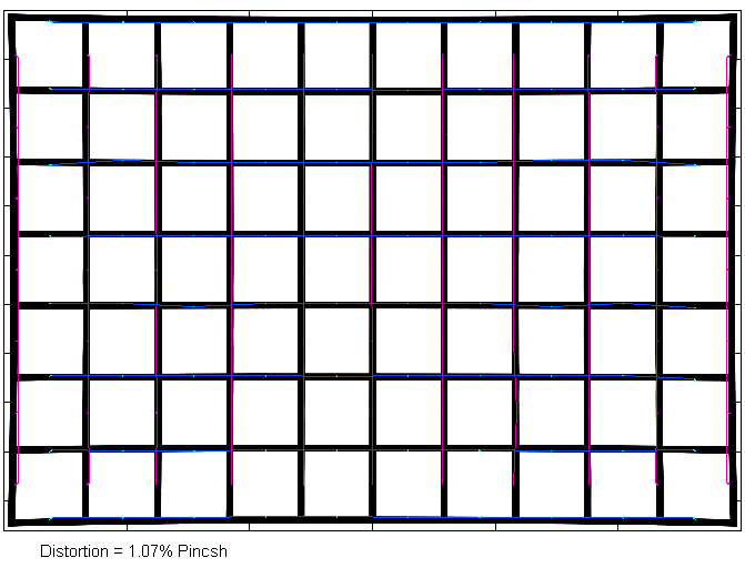

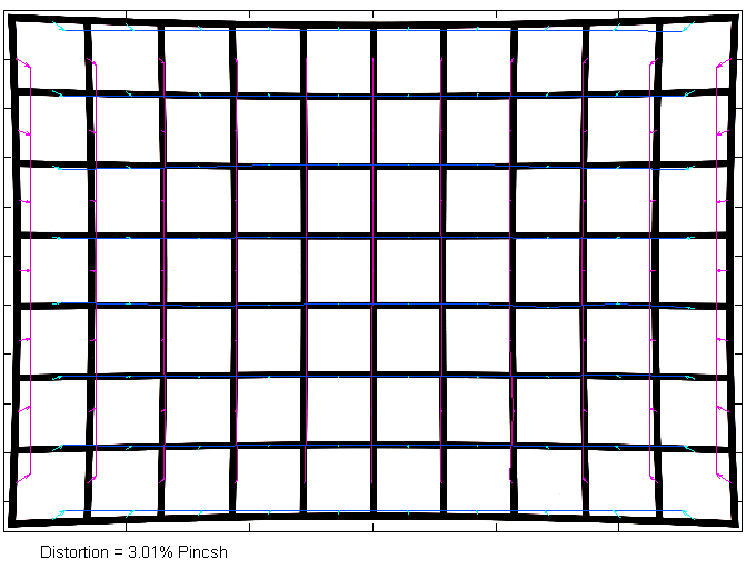

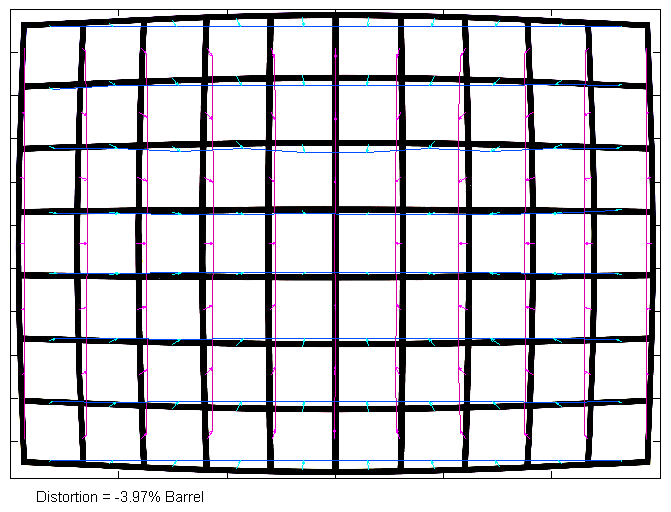

    Let’s check out the native image distortion characteristic first. The lens produces a heavy barrel distortion (4%) at 24mm. This eases in the lower zoom range and switches to pincushion style from ~35mm onward. The pincushion distortions are quite heavy again from the midrange, with a peak of 3% at 120mm. This isn’t glorious, but not truly excessive either.
    24mm40mm70mm120mm

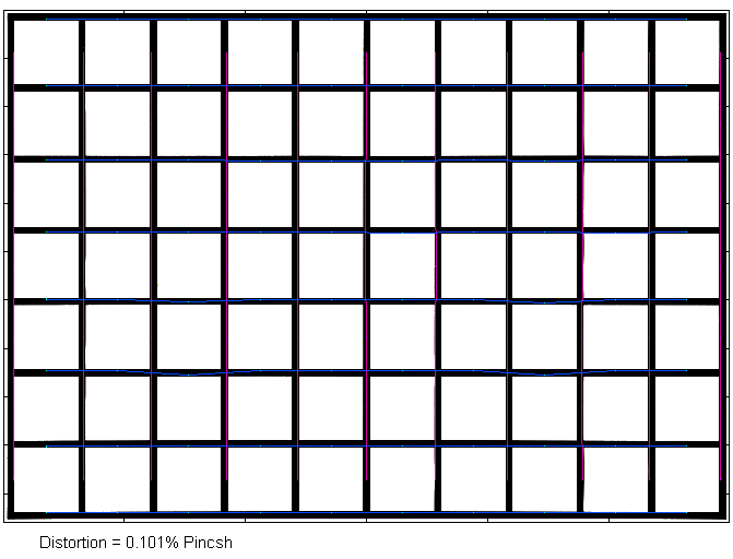

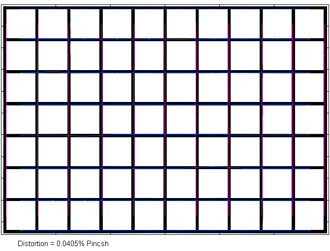

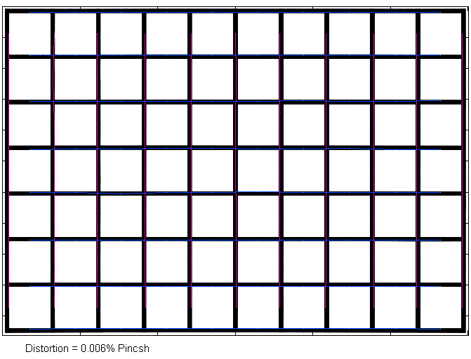

    From a user perspective, the above isn’t all that relevant, and digital autocorrection handles image distortions almost perfectly, as you can see below.
    24mm40mm70mm120mm

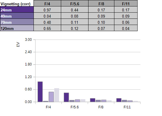

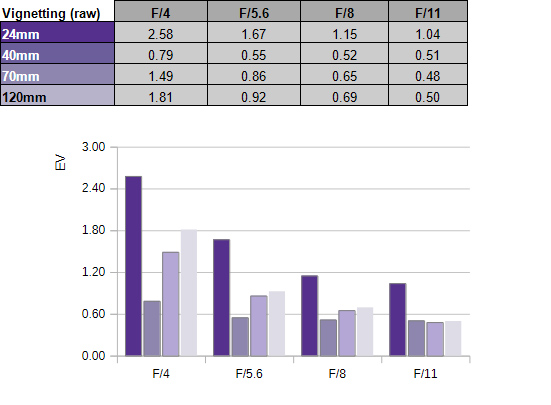

    The RAW vignetting of the Nikkor is good for such a zoom lens. Unsurprisingly, the light falloff is most pronounced with ~2.6 EV (f-stops) at 24mm f/4. Stopping down helps, as usual, and the vignetting is quite well controlled from f/8. The other weak spot is at 120mm f/4, where the vignetting approaches 2 EV (f-stops).
    Autocorrection (in high mode) doesn’t remove all the vignetting, but other than at 24mm f/4, it’s negligible.

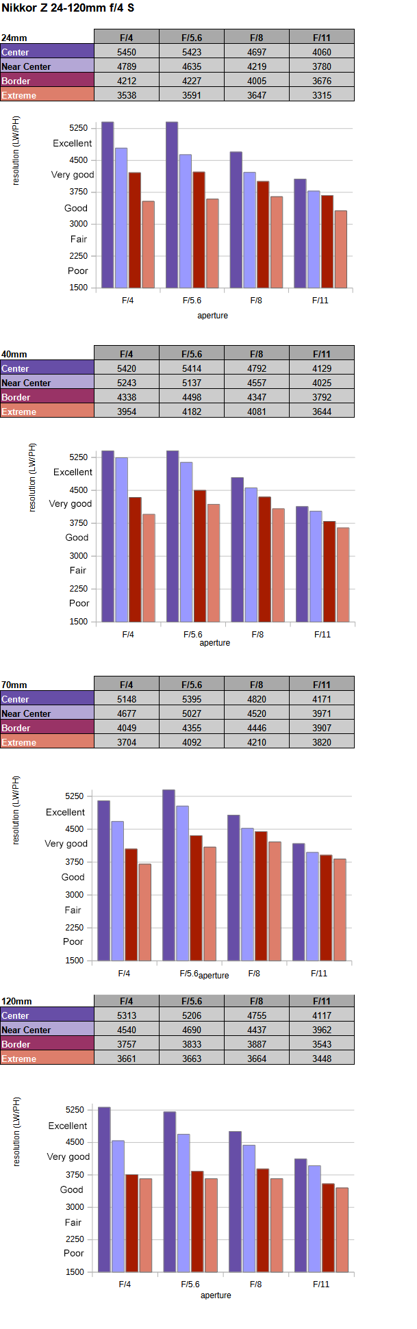

    The resolution figures of the Nikkor Z 24-120mm f/4 S are pretty good for such a high zoom ratio lens. This is especially true for the image center, which is downright outstanding throughout the zoom range and that’s straight from f/4. The near-center quality remains very high, and the border quality is pretty snappy as well. The corners are good at 24mm. However, the corners suffer from rather strong field curvature at this setting.
    As is to be expected, the sweet spot is in the middle of the zoom range, where the corners reach very good quality. The corner quality drops again at the very long end, but it remains good to very good. Diffraction effects are becoming more dominant beyond f/8 – this is a physical limitation.
    The centering quality of the tested sample was good.

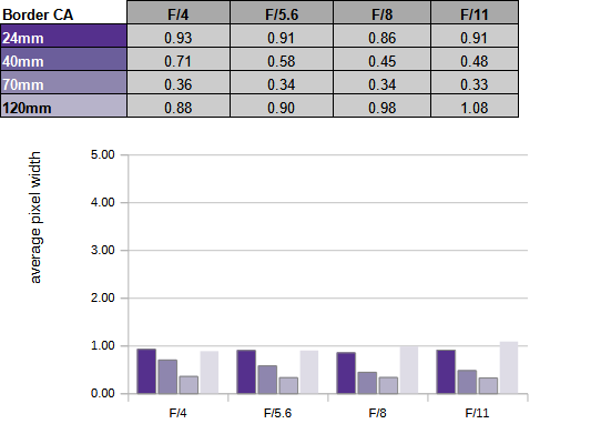

    Lateral CAs are generally very well controlled, with an average CA pixel width around 1px at the image borders at 24mm and 120mm and lower CAs in the middle range.

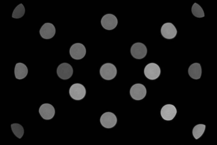

    An f/4 standard zoom lens can’t be a bokeh monster, but a reasonably shallow depth-of-field is possible in many scenes.

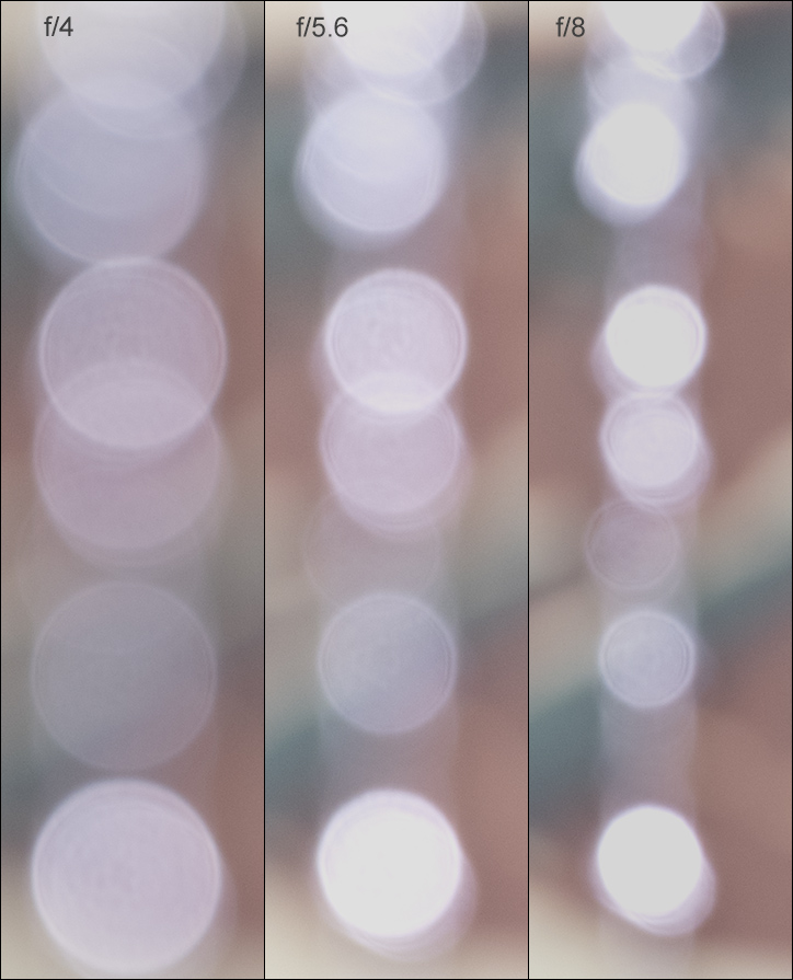

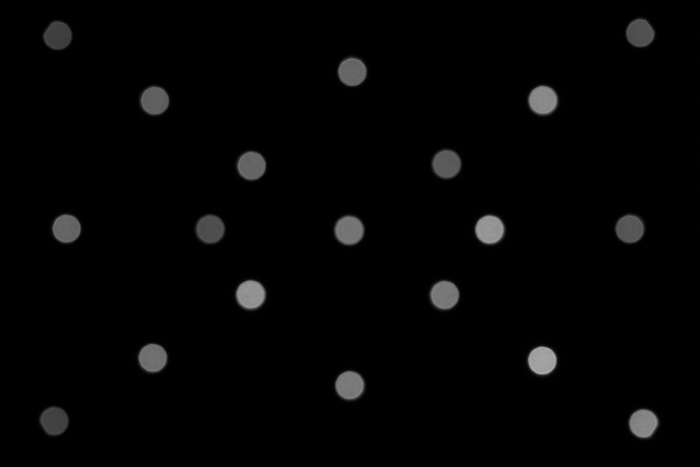

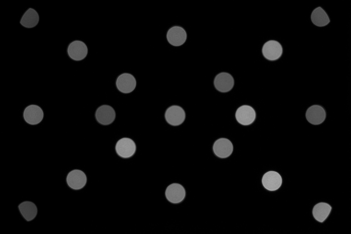

    Out-of-focus highlights are reasonably well rendered for a zoom lens. The inner zone of the highlight discs is slightly “grainy” – probably due to the use of aspherical elements in the design. The disc edges show some outlining, which doesn’t disappear when stopping down. The circular shape of the discs (near the image center) remains intact at f/5.6, with only a hint of edginess creeping in at f/8.
    When looking at the whole image at f/4, the circular highlight shape is maintained up to the mid-field of the image. Beyond, the discs are “cut off” due to mechanical vignetting. As usual, stopping down slowly restores the discs, although the corner discs are still not circular again at f/8.
    f/4f/5.6f/8

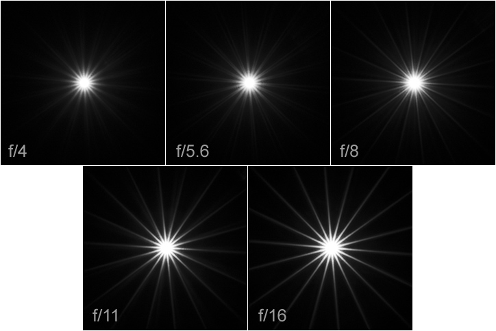

    Sunstars
    Sunstars (diffraction spikes) are an aperture effect that occurs at strong light sources – such as streetlamps in nighttime city scenes.
    The Nikkor produces some minor rays at f/4 already (samples taken at 24mm) which is fairly unusual because the aperture “should” be perfectly circular here. The effect increases the more you stop down, and a pleasing rendering is available from f/11, with the best results at f/16.
