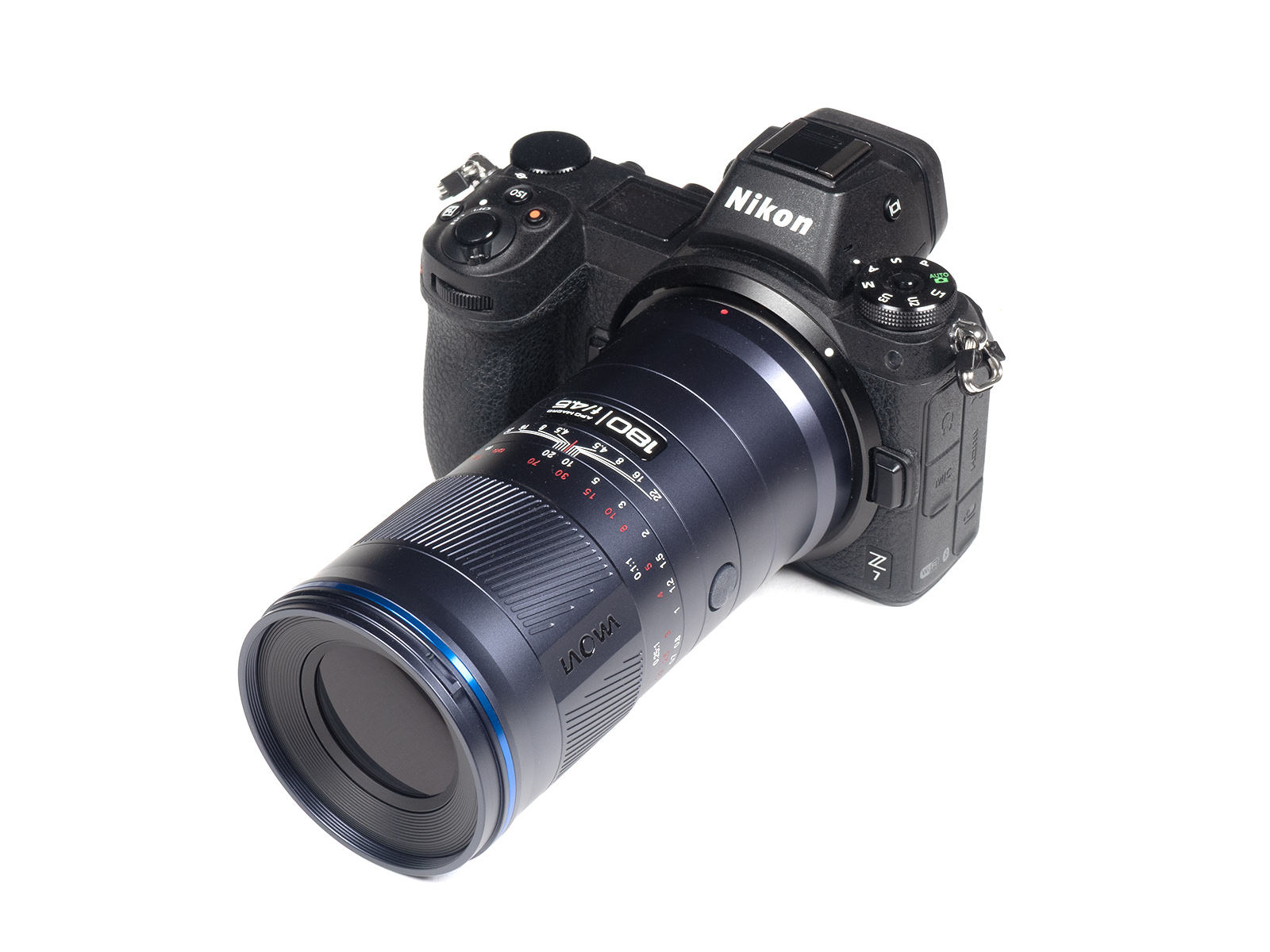

    There are many macro lenses out there, but somehow the OEMs forgot the 180mm class. Such lenses were readily available during the DSLR era. It seems that Laowa was the first one to notice this, so let’s welcome the Laowa AF 180mm f/4.5 APO Ultra macro. The AF version of the lens is available in E-, Z-, and Canon EF mounts. L- and Canon RF are only supported with fully manual versions. Now, you may have immediately noticed “Canon EF” in this list, so yes, this is a dual DSLR/mirrorless lens. This may not be ideal in terms of lens size (length, to be precise) for mirrorless mounts, but this is probably a compromise related to the market size for such a lens. Laowa decided to go for a comparatively slow speed of f/4.5. While this isn’t an issue for a macro lens, some users may have wished for a little bit more speed flexibility for generic use cases. Having said that, the pricing is very competitive at just $499 USD ($939 AUD).

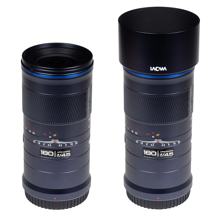

    The build quality is quite excellent, really. The lens body is made of metal with a gunmetal-ish color. This includes the silky smooth focus ring. Apropos focus ring – it has a rather curious implementation. Normal lenses have a dedicated AF/MF switch. Not so on the Laowa lens. Here you actually turn the focus ring “past” infinity into AF mode. This has its pros and cons. On the upside, it’s trivial to switch between modes – you don’t have to “search” for a usually very clicky AF switch somewhere on the lens but just turn the broad focus ring. On the downside, you can’t prefocus using AF and then continue in MF mode. However, for macro scenes, you tend to use manual focusing anyway, and most users tend to use AF for all conventional scenes anyway. Also note that the AF works only from 1.5m to infinity, thus not at macro distances. It is surprisingly fast and accurate, though. A barrel-shaped lens hood is provided, as you can see below.
    In terms of macro capabilities, the lens supports a maximum object magnification of 1.5:1 and a working distance of just 14.7cm.

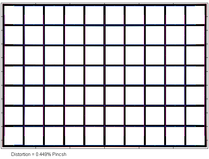

    The Nikon Z-mount version doesn’t support distortion auto-correction. However, the image distortion is low at less than 0.5%, so this shouldn’t be an issue for most applications.

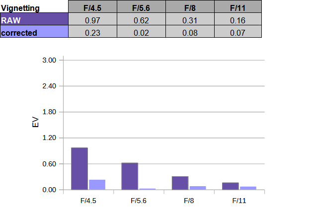

    RAW images show a moderate light falloff at f/4.5 at just 1 EV (f-stop). Stopping down by a stop reduces this to a negligible degree already. Auto-correct IS available for vignetting, and this will solve the issue at f/4.5 already.

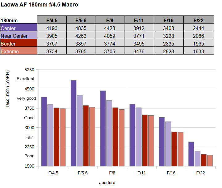

    MTF (resolution) at 45 megapixels (infinity)
    The Laowa AF 180mm f/4.5 APO Ultra macro delivered solid resolution results in the lab. The quality isn’t tack sharp at f/4.5, but the center quality is very good, with slightly worse results in the outer image field. The contrast is also slightly reduced at this setting. However, the sweet spot is already reached at f/5.6 – including decent contrast. The center quality is excellent here, and the near-center is also boosted. The borders/corners remain good to very good. Diffraction sets in at f/8 which is mostly impacting the image center. f/11 remains pretty good, whereas image quality takes a more noticeable hit at f/16, and, of course, f/22.
    The centering quality of the tested sample was good. There was no relevant field curvature.

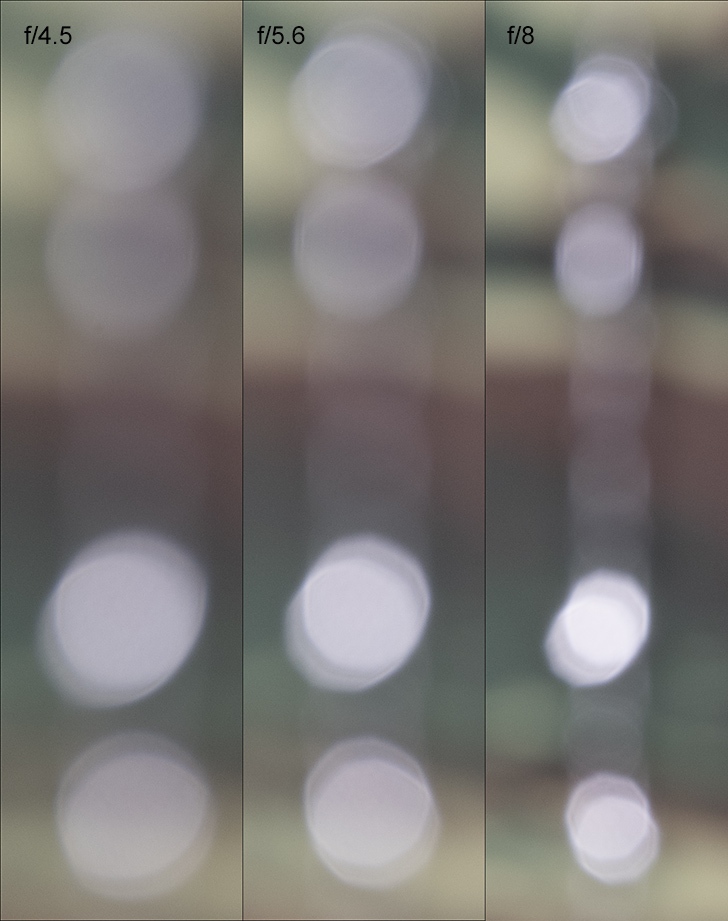

    Image sharpness is one thing, but you always operate with shallow depth-of-field in macro scenes. And an 180mm f/4.5 is still good enough for some decent background blur in many conventional scenes as well. So let’s check out the bokeh.

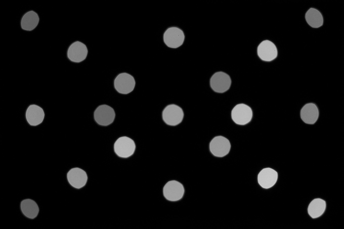

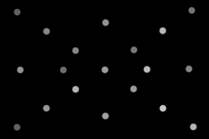

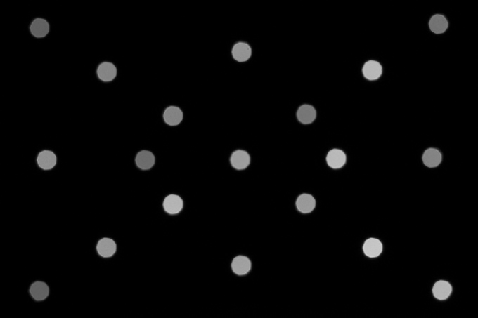

    Out-of-focus highlights are beautifully rendered with a smooth inner zone and “feathered” edges. This is very rare. It almost feels like an apodization lens here. Stopping down maintains the nice blur. A more edgy aperture shape creeps in at f/8.
    When looking at the rendering across the whole image frame, we can spot the usual deterioration to “cat eyes” beyond the midfield. They are mostly gone by f/8.
    f/4.5f/5.6f/8f/11
    The background bokeh (shown to the left below) is exceptionally silky in the focus transition zone. The less important foreground blur isn’t quite as superb with a somewhat “shadowy” character.
