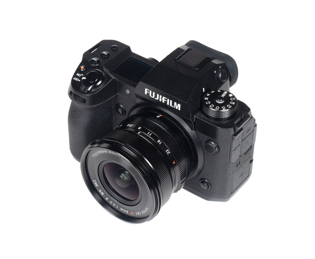

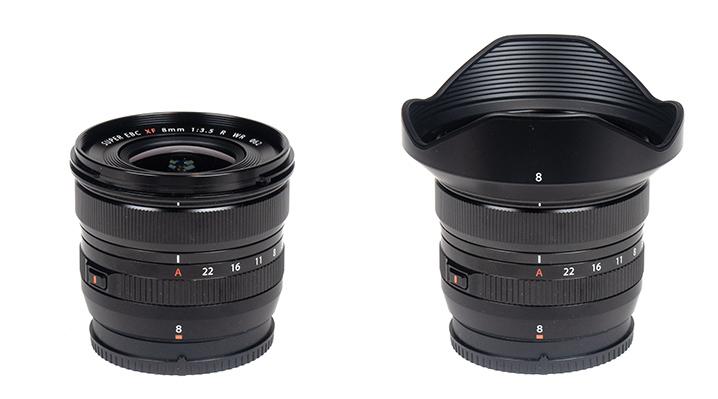

    One of the most appealing aspects of the XF 8mm f/3.5 R WR is its size and low weight. Most will agree that such a focal length is a bit on the exotic side, thus carrying it around with the rest of your gear shouldn’t be a burden – and the XF 8mm fits the bill. This also makes it ideal for video use on gimbals, for instance. The build quality is excellent, following the tradition of the XF 16mm f/2.8 R WR and the likes. It’s also water-resistant, as the “WR” in the name implies. The lens body is made of metal down to the mount. The focus ring action is silky smooth, and the dedicated aperture ring has distinctive clicks plus an aperture lock.  The AF is quick and silent. Manual focusing works “by-wire”, as usual.
    Optical construction12 elements in 9 groups (3x aspherical, 2x ED)
    min. focus distance0.18m  (max magnification: 0.07x)
    Dimensionsφ 68mm×52.8mm
    Weight215g
    Filter sizeφ 62mm
    Hoodpetal-shaped, bayonet mount, included
    Other featuresaperture-ring w/ aperture lock
