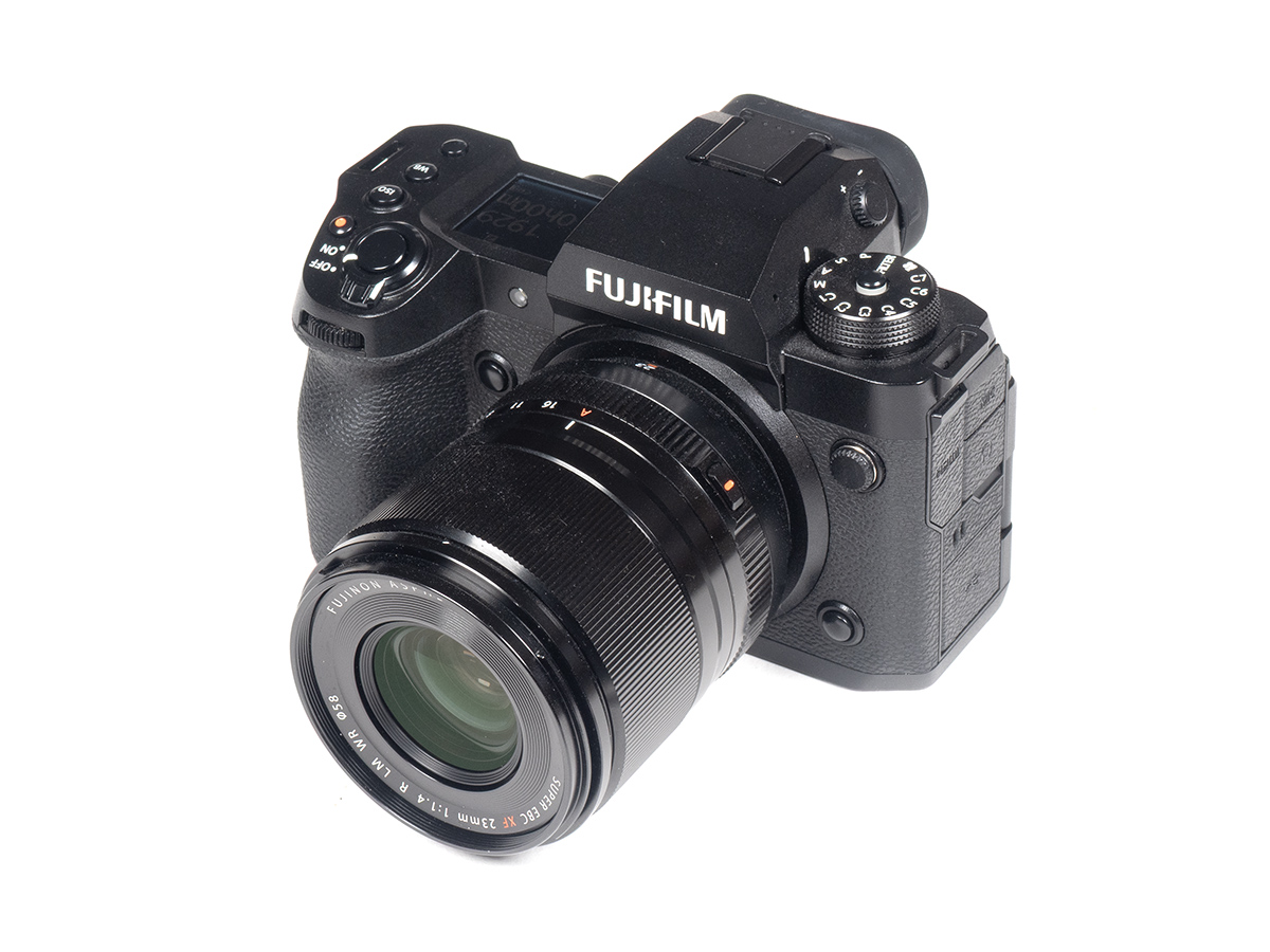

    The Fujinon XF 23mm f/1.4 R LM WR is a wide-angle prime lens designed for Fujifilm’s X-Mount cameras. With a 23 mm focal length (equivalent to roughly 35 mm on full-frame systems) and a maximum f/1.4 aperture, it sits in a classic focal range often used for street, documentary, landscape, and general-purpose photography. Unsurprisingly, the Fujinon isn’t cheap at around $1000 USD but that’s unsurprising given the large aperture.

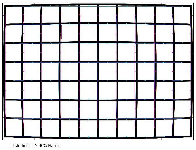

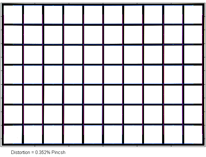

    The Fujinon produces a native barrel distortion of ~2.7%. In the grand scheme of things, this is comparatively moderate. Surprisingly, auto-corrected images are somewhat over-corrected with a pincushion distortion of 0.4% – at least at the tested focus distance.

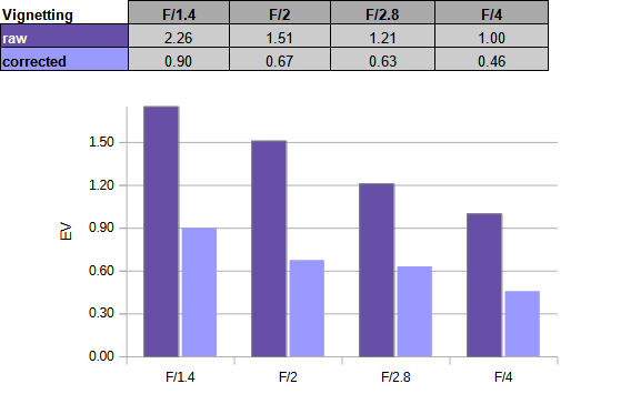

    The light falloff in RAW mode is very heavy at f/1.4. A vignetting of ~2.3 EV (f-stops) may be normal on full-format cameras, but it’s beyond our usual scale for APS-C cameras. It’s still very high at f/2 and f/2.8, and 1 EV (f-stop) at f/4 is still not overly well corrected.
    Digital auto-correction shaves off ~1.4 EV at max. aperture, and the vignetting is acceptable from f/2 and low from f/4.
    Please note that vignetting compensation is lossy – it comes at the cost of higher sensor noise in the image corners due to the required “amplification”.

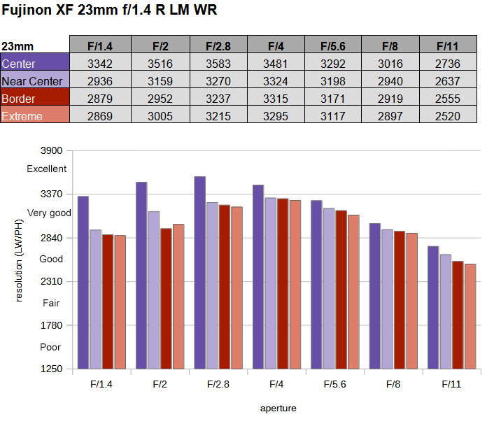

    The Fujinon XF 23mm f/1.4 R LM WR produced an interesting resolution characteristic in the lab. Generally, the lens doesn’t show any weakness, but for whatever reason, the center quality doesn’t set the world on fire (for a prime lens). However, this doesn’t mean that the lens is bad in this respect in any way or form. The center quality is very good to excellent at f/1.4. There’s a fairly strong drop just beyond the dead center, with good to very good quality across the rest of the image field. Stopping down to f/4 improves this slightly. The peak performance is reached between f/2.8 and f/4. The center quality is excellent, with the outer image field following in the high very-good range. Diffraction sets in at f/5.6. Good results are still possible at f/8, but f/11 should be avoided.
    The centering quality of tested sample was good. The field curvature is slightly uneven.
    Below is a simplified summary of the formal findings. The chart shows line widths per picture height (LW/PH) which can be taken as a measure for sharpness. If you are keen to know more about the MTF50 figures, you may check out the corresponding Imatest Explanations

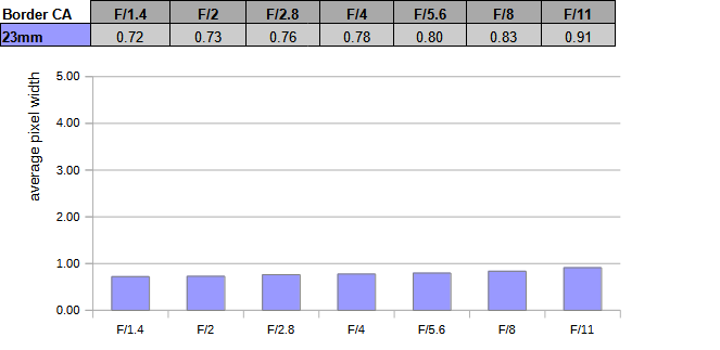

    The lateral CAs (color shadows at hard contrast transitions) are already quite low with an average pixel width of around 0.8px at the image borders.
    The camera (JPEGs) or your favorite RAW converter should be able to correct this anyway.

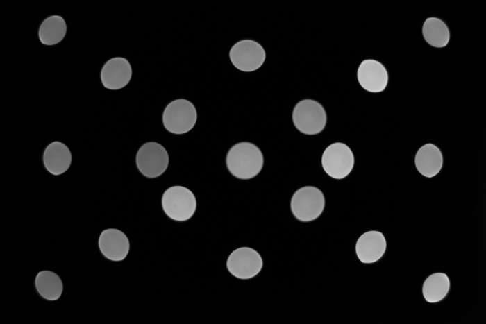

    Fast lenses aren’t just about their sharpness but also about how they can render out-of-focus areas in your images. Wide-angle lenses are usually not overly good at this, but let’s see what the Fujinon can do for us here.
    Out-of-focus highlights are nicely rendered with a smooth inner zone and only a slight outlining of the disc’s rim. The discs are perfectly circular at f/1.4 and f/2. A minor edginess creeps in at f/2.8.
    When looking at the whole image field instead of just the center, we can spot a moderate deterioration of the circular discs to “cat eye” in the image corners. If you look closely, the outlining of the rim increases a bit as well. The rim outlining vanishes at f/2, and most of the discs are back to their circular shape. At f/2.8, they are fully restored.
