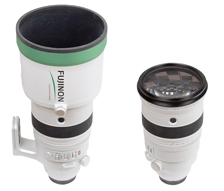

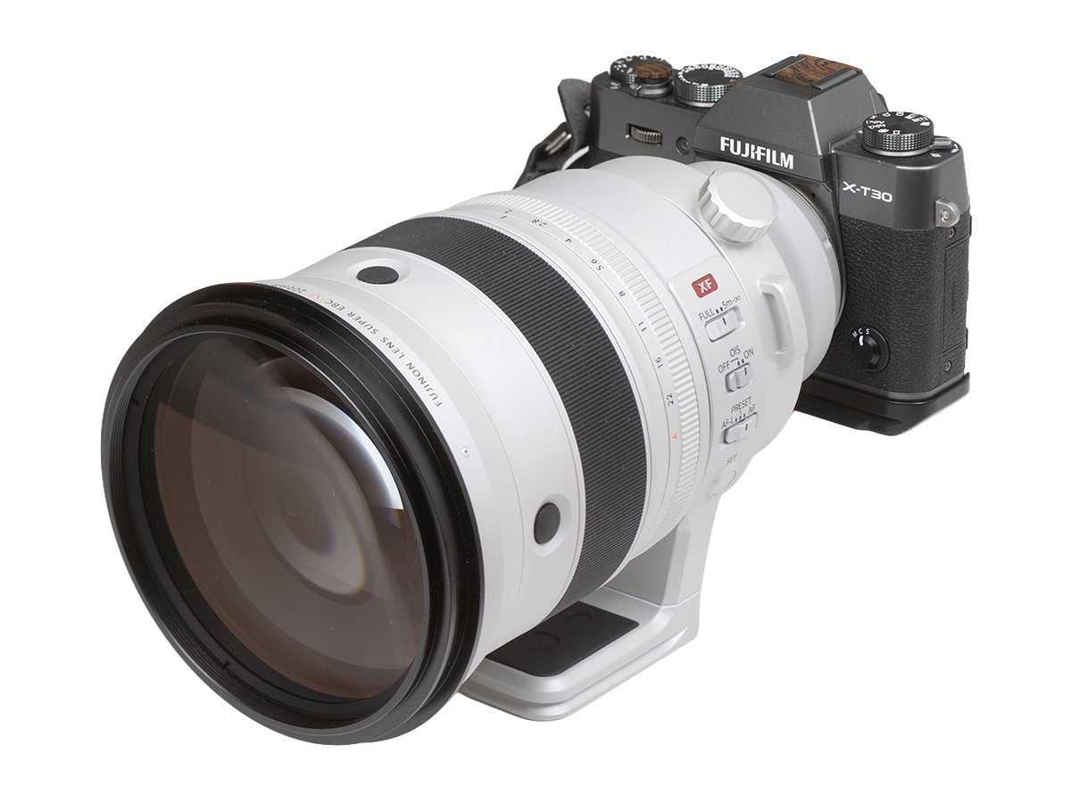

    Needless to say but a lens of this caliber excels regarding its build quality. It uses a weather-sealed full-metal magnesium-alloy body. It’s also freeze-proof up to -10C. The XF 200mm f/2 is still surprisingly lightweight at just 2265g. Some may not like the silver-white coating but it’s there for a reason — managing thermal effects. After all such lenses are almost always used in outdoor conditions. Of course, it has the usual phalanx of switches and buttons such as a focus range limiter, AF control buttons, focus preset button and IS config. As you can see below, there’s also a dedicated tripod mount (Arca-Swiss compatible). As far as filters are concerned: it only takes huge 105mm front filters. There is no rear-filter slot. A deep, barrel-shaped lens hood is also part of the package.
    The Fujinon uses a twin linear motor (hence the “LM” in the name) for fast and silent autofocusing. The optical image stabilizer is rated at 5 f-stops.

    Aperture ring
    Image stabilizer up to 5 f-stop efficiency
    Focus preset button
    4x focus stop buttons
    Focus range selector
    Extensive weather sealing inc. freeze proof
    Rotating tripod collar (Arca-type compatible)

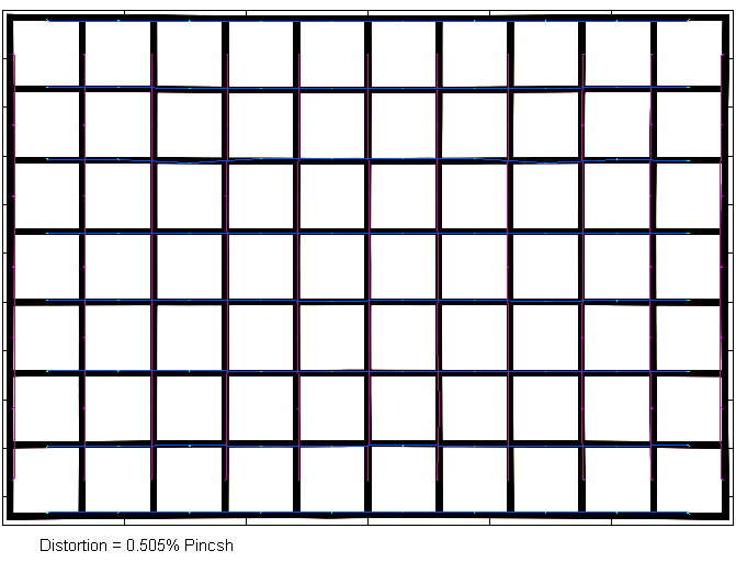

    The Fujinon XF 200mm f/2 R LM OIS WR produces only a mild pincushion distortion of 0.5%. This is usually negligible although autocorrection reduces this further.

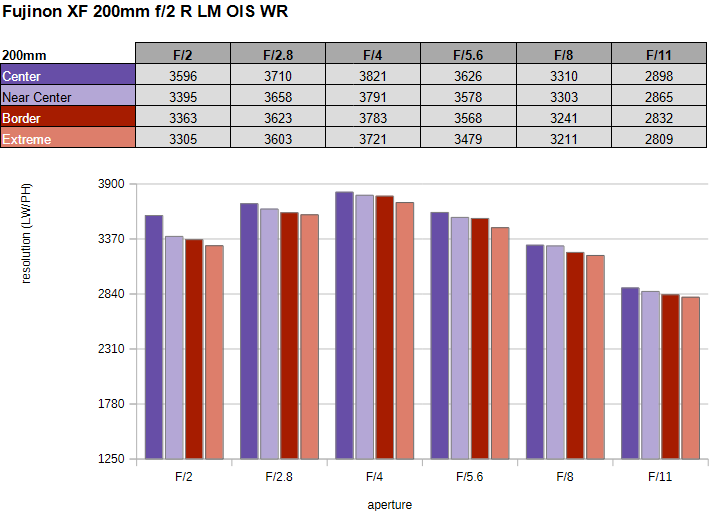

    Unsurprisingly, the Fujinon doesn’t struggle on a 26-megapixel sensor. The center quality is excellent straight from f/2 and the outer image field is also very sharp here already. Stopping down still improves the quality a little with stunning results at f/4. Diffraction is the limiting factor beyond.
    The tested sample had a slight centering issue which has probably prevented it from achieving higher results at f/2. That’s also the reason we won’t publish the MTFs with the 1.4x converter. Just as general guidance, a 1.4x usually costs “one school mark” in image quality.

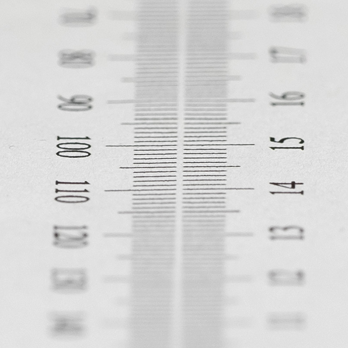

    Sheer sharpness is one thing but the quality of the bokeh is just as important with such a lens.

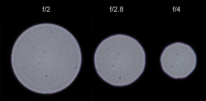

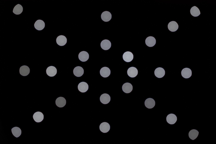

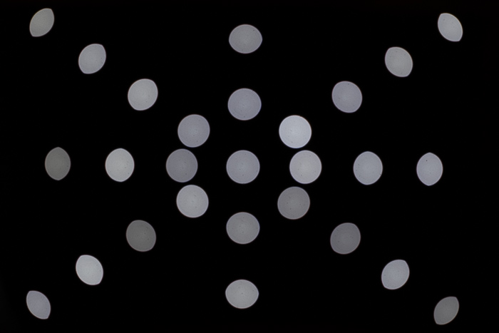

    Out-of-focus highlights aren’t perfectly rendered. You may notice that the inner zone of the discs has a slightly busy substructure (and some dust particles in our case). However, this is relatively subtle here and probably not overly relevant in real-world images. There is also a bit of an outlining effect that increases when stopping down. The circular shape of the disc is maintained at f/2.8. The more edgy aperture creeps in at f/4.

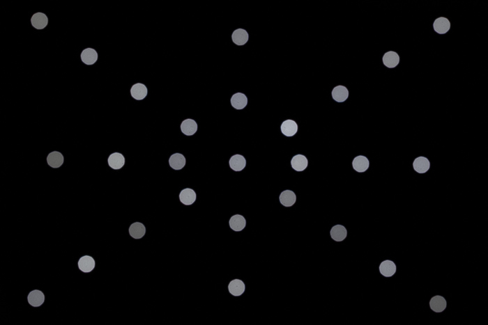

    The above applies to the broader center. However, the highlights deteriorate to “cat eyes” the more they are positioned towards the borders/corners—this is a mechanical vignetting effect. Stopping down to f/2.8 broadens the zone with circular discs and the corner discs are restored at f/4.
    f/2f/2.8f/4

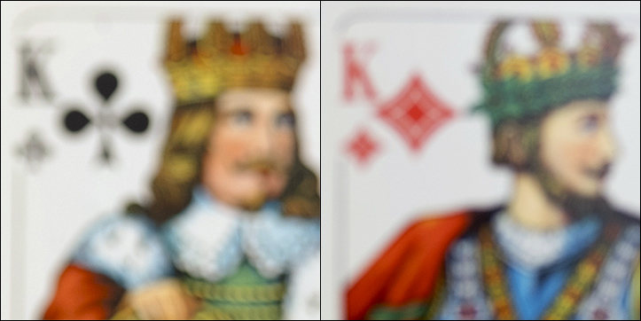

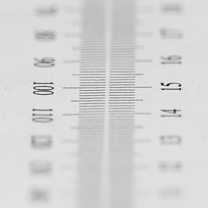

    LoCAs, or bokeh fringing, is a color fringing effect on the Z-axis. It shows up with a purplish tint in front of the focus point and a greenish tint behind, and it’s nearly impossible to fully correct in post. As you can see below, the Fujinon is impeccable in this respect.
    Side note: You may notice that the background numbers are rendered a bit rough here.
    f/2.2f/2.8f/4f/5.6
