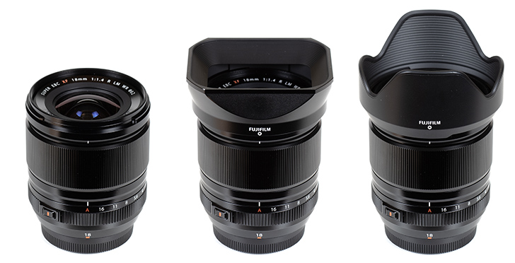

    The build quality is, once again, excellent thanks to a tightly assembled all-metal lens body with weather-sealing. It’s also freeze-proof down to -10C. The broad focus ring turns silky smooth. The Fujinon uses an internal focusing mechanism, so the physical length doesn’t change during operation. Typical for all “R” lenses there is a dedicated aperture ring. Unfortunately, it can’t be “de-clicked” for video use. A petal-shaped plastic lens hood is supplied. There is also an optional square-shaped metal LH-XF18 lens hood. However, this beauty would set you back another $90 USD.
    The XF 18mm f/1.4 R LM WR uses a linear AF motor (“LM”) providing both quick focusing as well as virtually silent operation. The AF motor isn’t held in place after powering off the camera, so you can feel a bit of a sliding sound/clunk when shaking the lens. This isn’t uncommon for Fujifilm lenses and no reason for concern.

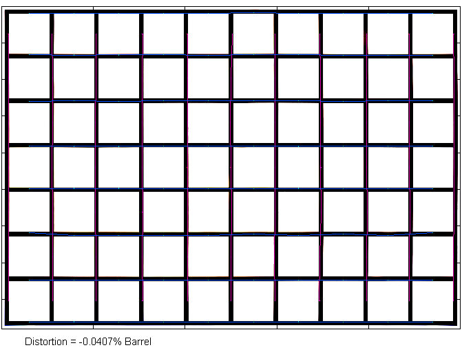

    An astounding aspect of the Fujinon XF 18mm f/1.4 R LM WR is its distortion characteristic – meaning that it has none even in RAW files. This is extremely rare.

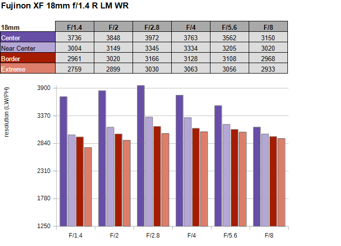

    Coming back to a more positive aspect – image resolution. The center quality is excellent straight from f/1.4 here. There is a fairly steep drop beyond the dead center with good to very good results for the rest of the image field. Stopping down improves the quality until the peak is reached at f/2.8. The center is downright superb here, and the outer image field is easily on a very good level. Diffraction effects are limiting the quality from f/4 although you’d barely notice this at f/5.6. f/8 is marginally softer. f/11 and beyond should be avoided as usual on APS-C cameras.

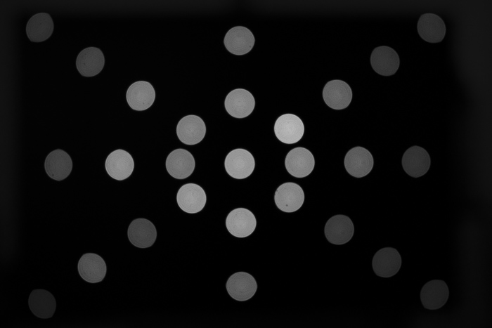

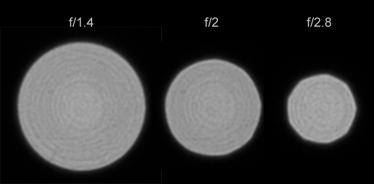

    Out-of-focus highlights show a subtle inner substructure. Our bets on the cause are on the 3 aspherical elements used in the optics. However, the discs have no outlining and they are perfectly circular at f/1.4 and f/2. The more edgy aperture shape creeps in from f/2.8 here. That’s pretty similar to what we’ve seen in the other fast XF primes.

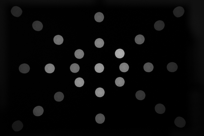

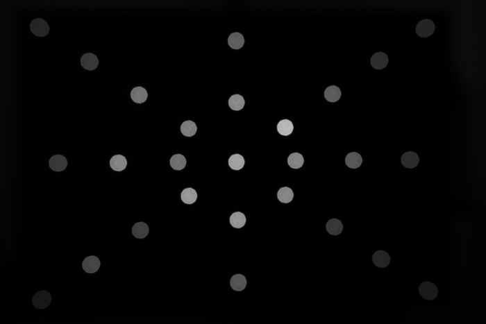

    Interestingly, the circular shape is mostly maintained across the image field as you can see below. Stopping down still improves on this a bit.
    f/1.4f/2f/2.8

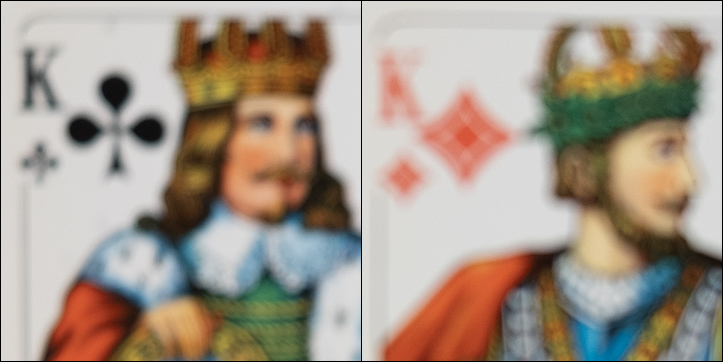

    The general bokeh rendering in the focus transition zone is smooth in the background (shown to the left below). The foreground blur (to the right) is more busy but that’s less relevant in most real-world scenes.

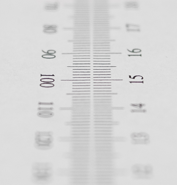

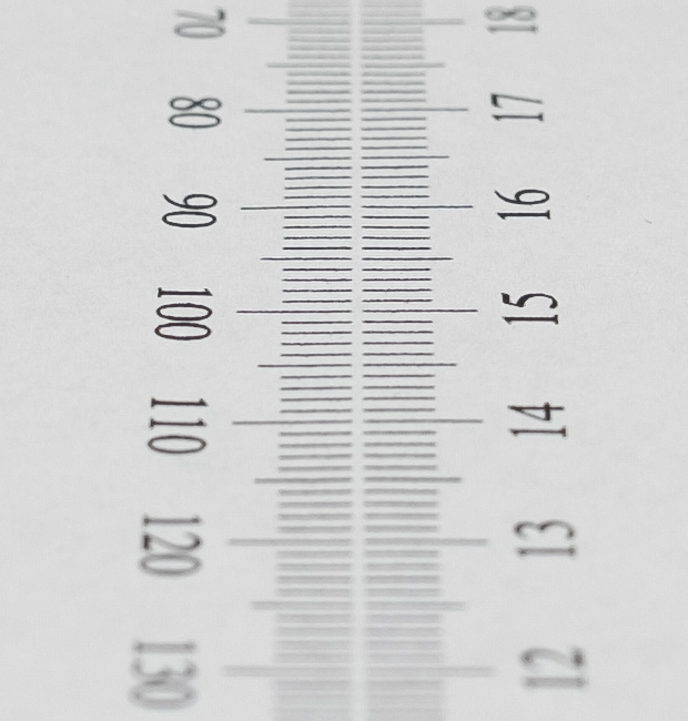

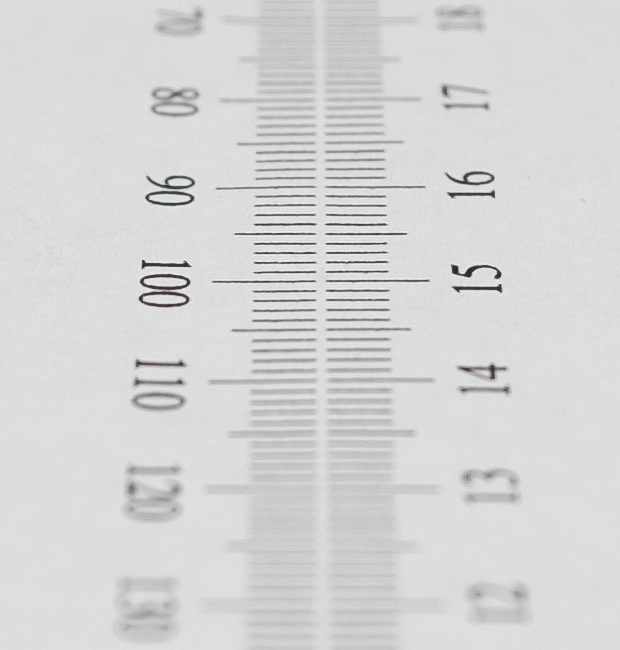

    If you look closely, the focus point only moves a tiny bit towards the rear when stopping down. However, this doesn’t have any real-world impact.
    f/1.4f/2f/2.8f/4
