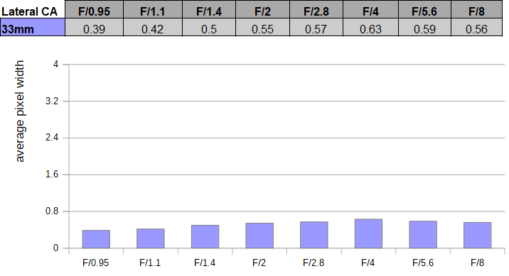

    The APO designation in the lens name promises very low color fringing. While we agree that lateral CAs are very low, they are still present with an average pixel width of around 0.5px at the image borders.
