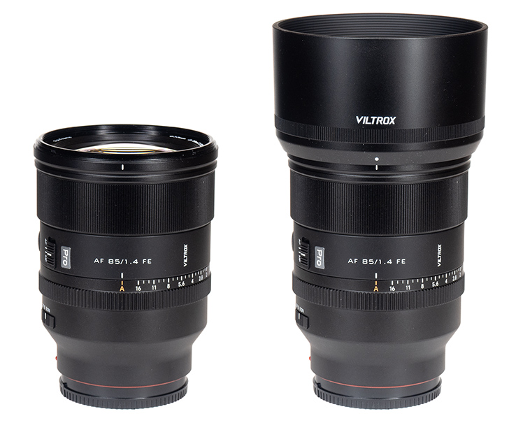

    The build quality of the Viltrox AF 85mm f/1.4 PRO FE is excellent thanks to a tightly assembled all-metal design. At 800g, it is on the heavy side, though. Weather sealing is provided and combined with the inner focusing system, it should be able to provide some protection against the elements. The focus ring turns smoothly. In terms of controls, there is also a de-clickable aperture ring. This is not an infinitely turning ring, but the aperture values are clearly marked on the barrel – yours truly certainly prefers this implementation over the one in the AF 35mm f/1.2 LAB. There is also a custom button and the usual AF/MF switch. A petal-shaped lens hood is included.

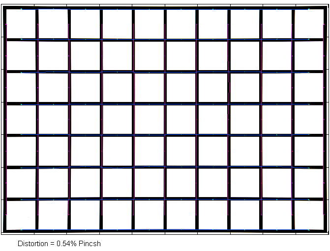

    The lens produces a native image distortion of ~0.5% pincushion-style. This is better than usual in this age of mirrorless cameras. Viltrox does not provide a correction profile (at the time of this writing). However, the level is low enough to be irrelevant in most scenes anyway.

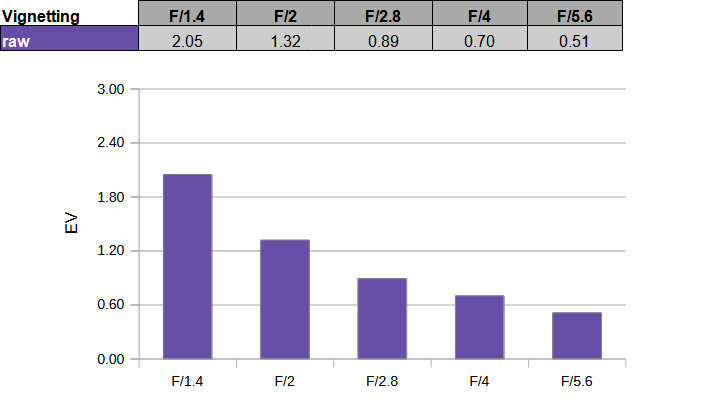

    The raw vignetting is typical for an ultra-fast medium tele lens. At f/1.4, the light falloff exceeds 2 EV (f-stops). Stopping down to f/2 cuts this down by 2/3 EV. And it’s acceptable from f/2.8.
    Strangely, there is no correction profile for vignetting either, although Viltrox does so with other lenses. We hope they’ll add one via firmware later. Having said that, vignetting can be easily corrected in post.

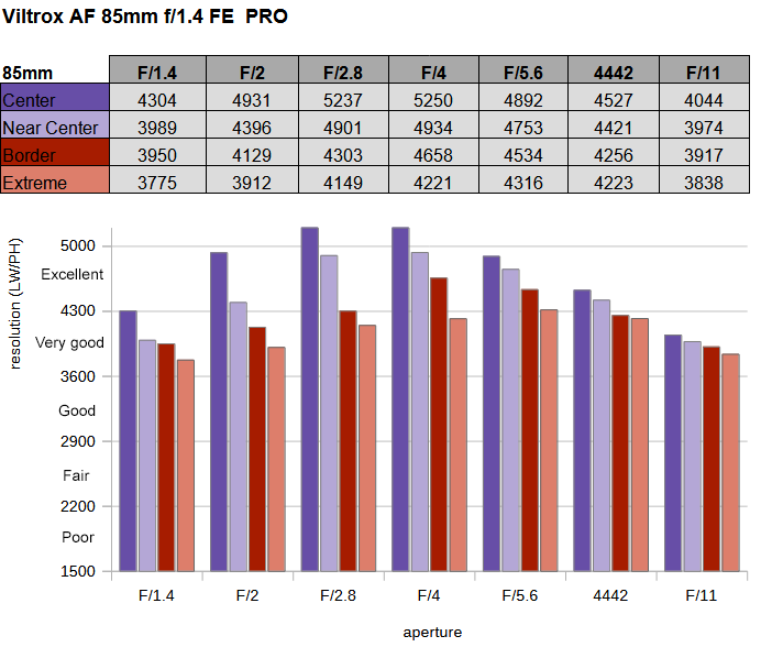

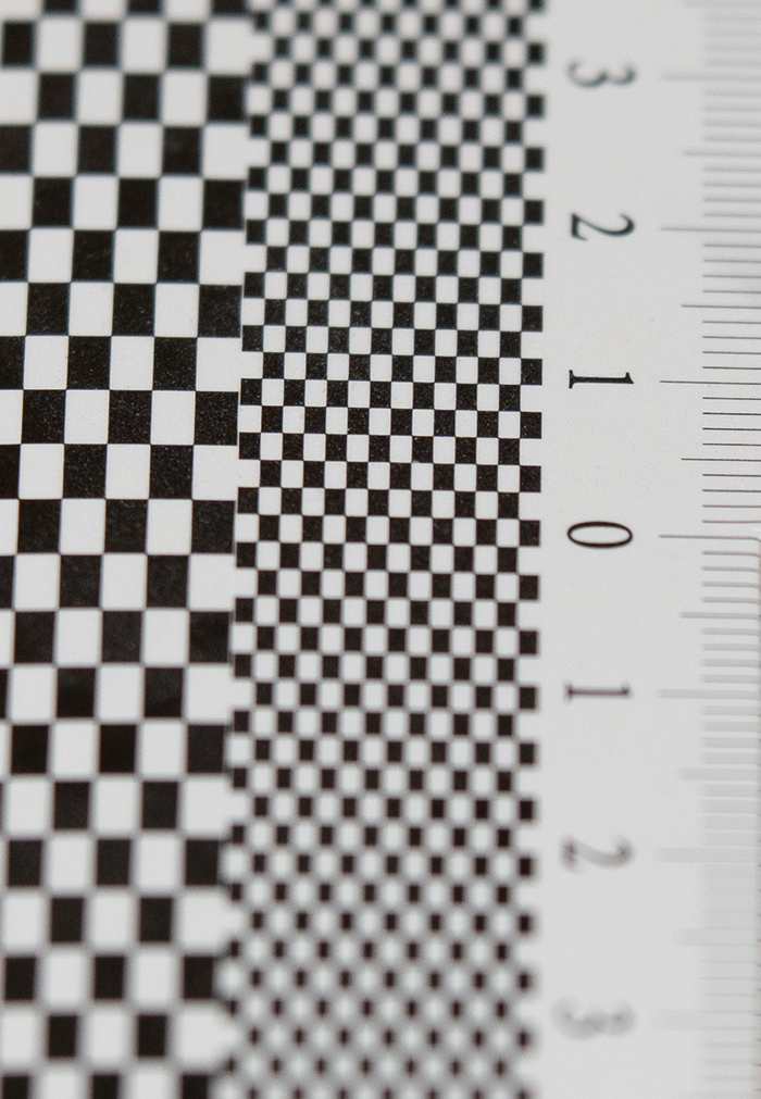

    The Viltrox AF 85mm f/1.4 PRO FE is very sharp at all mainstream aperture settings. The center quality is very good to excellent at f/1.4, and the outer image field is easily on a very good level. Stopping down to f/2 provides a boost in the broader center – and more so at f/2.8. The outstanding peak quality is reached at f/4. Diffraction is the limiting factor beyond. You won’t really notice this at f/5.6, but f/11 and beyond should be avoided unless you require the depth-of-field.

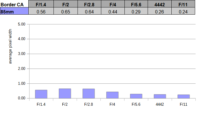

    Lateral CAs are low at large aperture settings, and even decrease somewhat from f/4 onward.

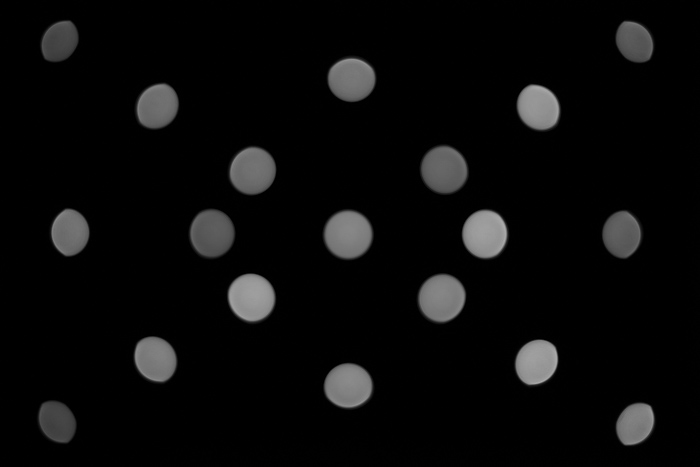

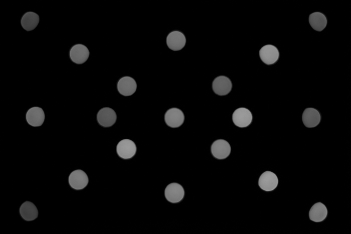

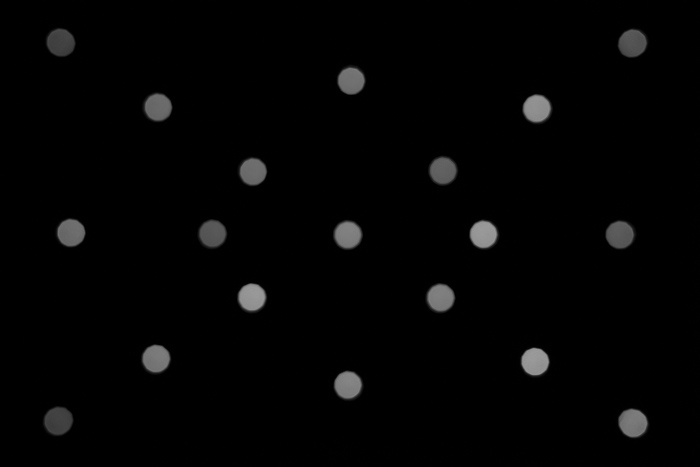

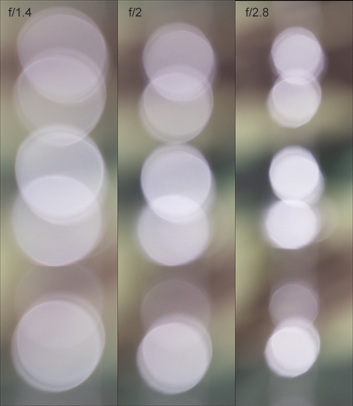

    Out-of-focus highlights are nicely rendered near the image center. The inner zone of the discs is very smooth despite two aspherical elements in the design. There is however a distinct outlining at the edges. The circular shape remains intact at f/2. A slight edginess creeps in at f/2.8.
    When looking at the highlight rendering across the image field, we can see a shape deterioration from the midfield onward at f/1.4. The corner highlights have a slight cat eye effect, but it’s comparatively subdued (e.g., compared to the Sigma 85mm f/1.4 DG DN). As usual, stopping down increases the “perfect” zone, although the corner shapes aren’t fully restored until f/2.8.

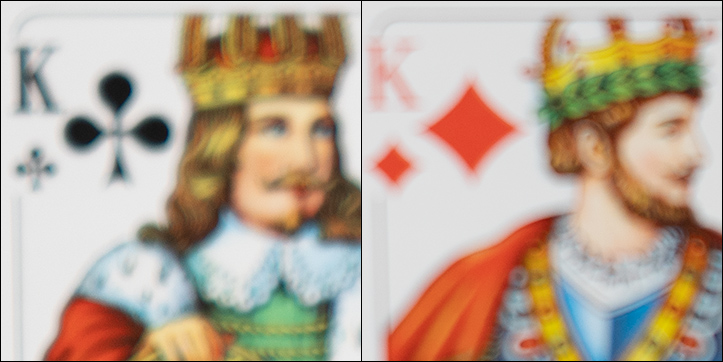

    The blur in the focus transition zone is quite smooth in the image background (shown to the left below), but a bit “shadowy” in the less important foreground (to the right).

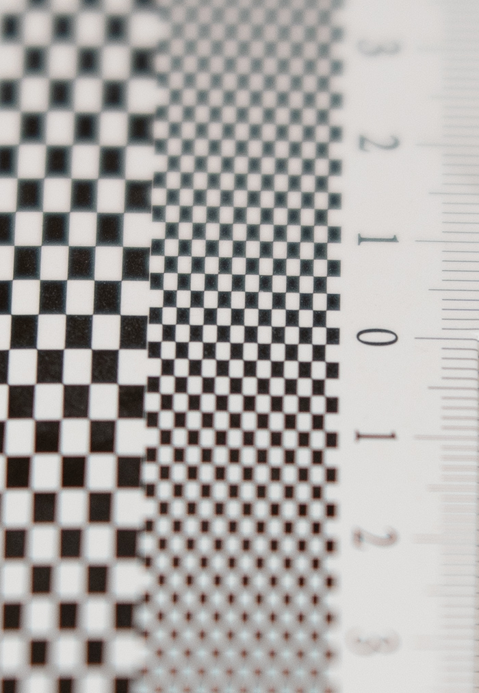

    As you can see below, the Viltrox lens shows some color fringing at f/1.4 – with the background being quite “hazy” here. Stopping down to f/2 reduces substantially, and the issue is mostly gone from f/2.8.

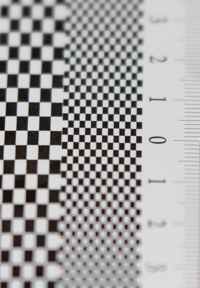

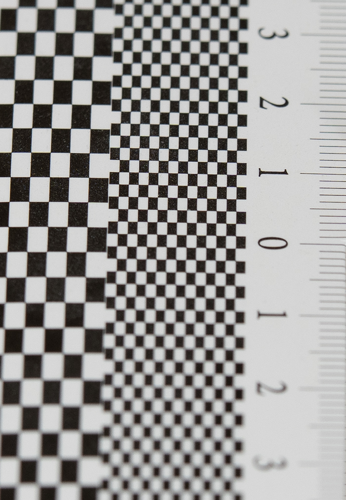

    There is, however, a noticeable focus shift (RSA – “Residual spherical aberrations”) towards the rear here. Sony cameras autofocus at the set aperture, so unless you use manual focusing, it’s not overly important.
    f/1.4f/2f/2.8f/4
