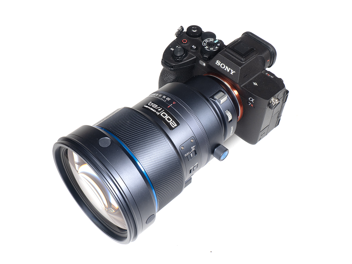

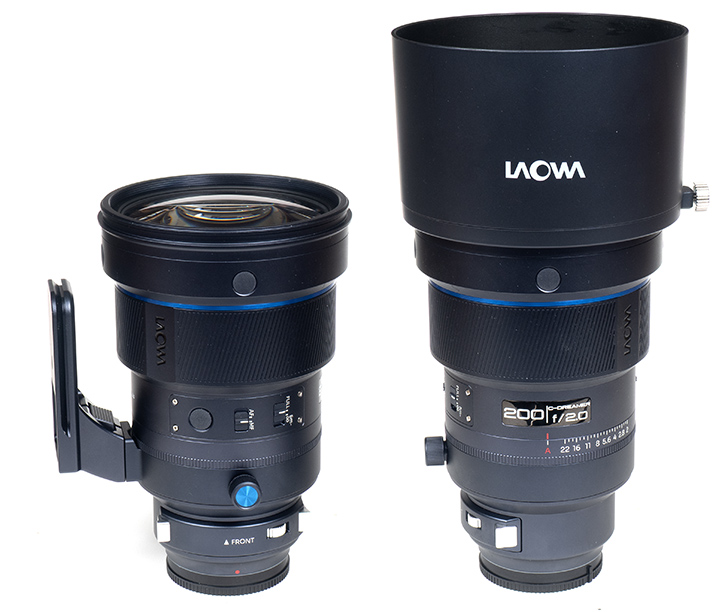

    The build quality of the Laowa AF FF 200mm f/2 C-Dreamer is outstanding and also quite posh with its gunmetal gray finish. It’s an all-metal body down to the control rings, but it’s still relatively lightweight at just under 1.8 kg. Even so, the detachable tripod collar (Arca-Swiss compatible) was a good idea here. Weather-sealing has also been implemented. There’s a dedicated aperture ring, an AF/MF switch, a focus limiter, and an Fn button. Unsurprisingly, the front element is huge, but you can still attach (expensive) 105mm filters. There’s also a 43mm filter holder at the rear of the lens. The deep barrel-shaped (plastic) lens hood can be screwed on.
    As the lens name implies, this is an AF lens with full EXIF support. The AF isn’t blazingly fast but still pretty snappy. Manual focusing works “by-wire”, as usual.

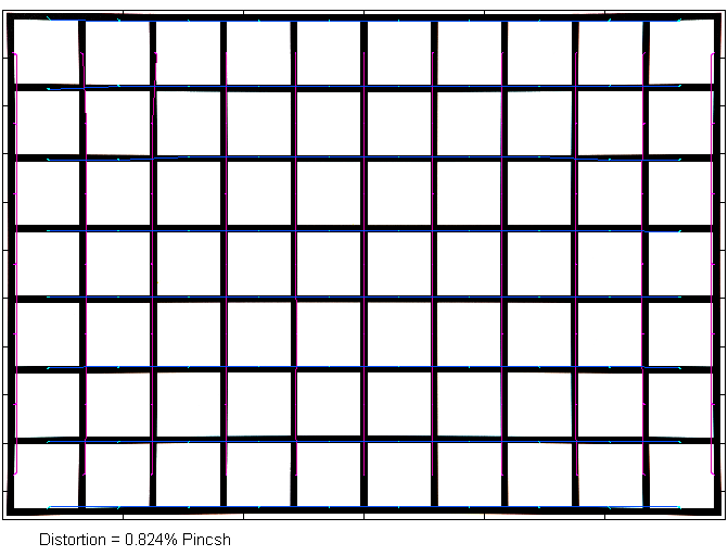

    The Laowa AF FF 200mm f/2 C-Dreamer produces slight pincushion distortions (0.8%). There is no built-in correction profile, although it’s likely that at least Photoshop will provide one eventually.

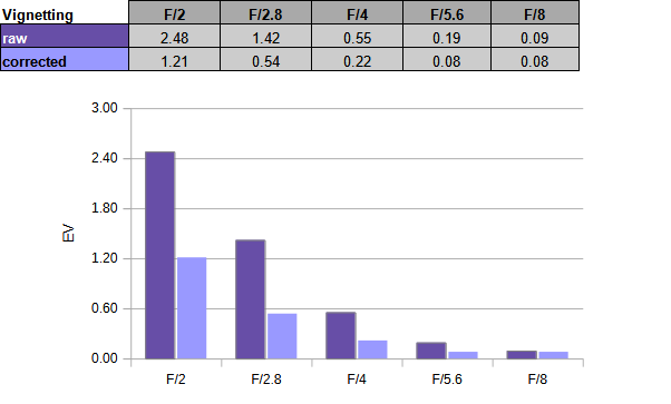

    The raw vignetting is about in line with what you can expect from such a high-speed lens. At f/2, the light falloff is quite heavy at 2.5 EV (f-stops). This is reduced by 1 EV at f/2.8, and it’s negligible beyond. There is an auto-correction profile available for vignetting compensation. Activated, it reduces the vignetting substantially at f/2 down to 1.2 EV. The vignetting is mostly gone from f/2.8 in this case.

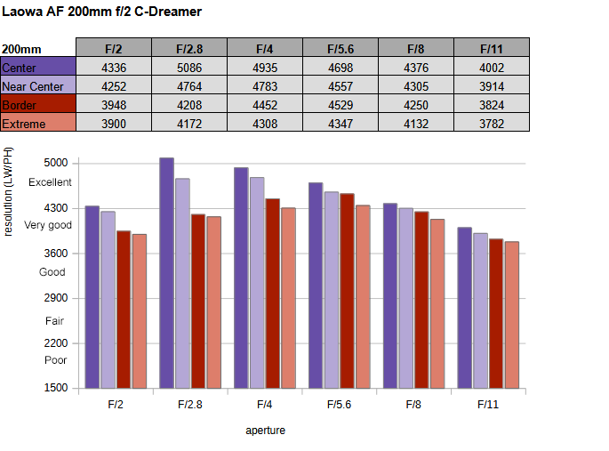

    The Laowa lens produced very high resolution figures in the lab. At f/2, the results are slightly subdued but still reach very good quality across the image frame. The peak performance is achieved between f/2.8 and f/5.6. The broader center quality is superb at these settings. The outer image field is very high at f/2.8 and excellent at f/4 to f/5.6. Diffraction has a higher impact from f/11. f/11 remains perfectly usable, though.
    The centering quality of the tested sample was Ok. The field curvature is flat.

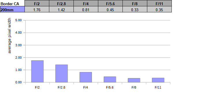

    Lateral CAs are somewhat elevated at f/2 with an average pixel width of ~1.8px at the image borders. This is gradually reduced the more you stop down, and it’s negligible from f/5.6. A good RAW converter should be able to handle lateral CAs automatically.

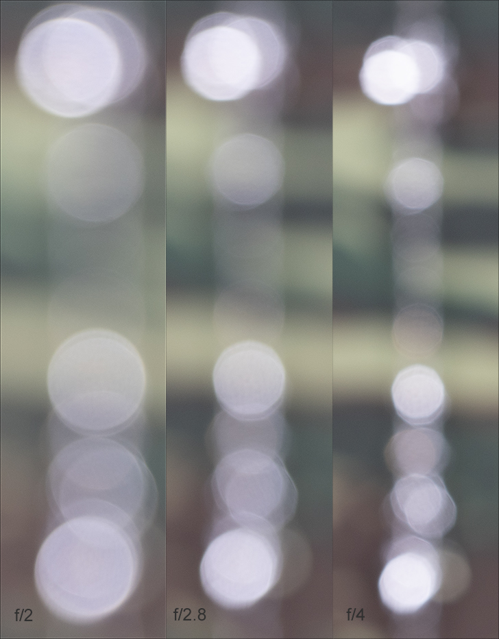

    You don’t purchase such a lens for its focal length but for its speed and, as such, its ability to produce a shallow depth-of-field. So let’s check the technical quality of the bokeh.

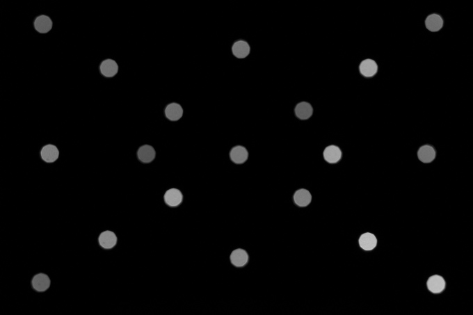

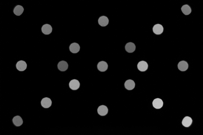

    Out-of-focus highlights are nicely rendered near the image center. The inner zone of the discs isn’t absolutely smooth – curtesy of the aspherical element in the design – but it’s smooth enough. There’s only a slight outlining at the edge of the discs. The discs are perfectly circular at f/2. Traces of edginess creep in at f/2.8 and a bit more so at f/4, but it’s not much.

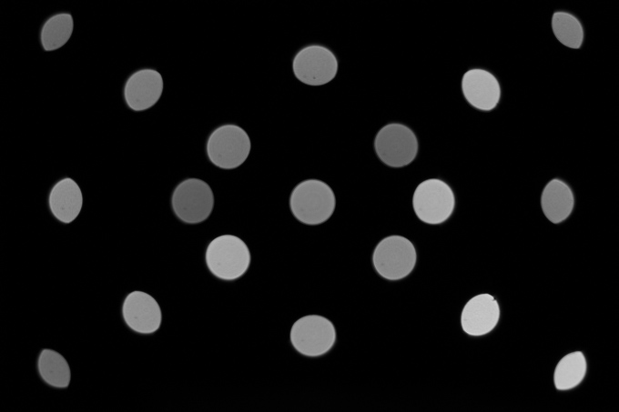

    When observing the highlight rendering across the image field, there’s a medium deterioration of the discs towards the edges of the image field. Cat eyes are obvious in the image corners. Stopping down to f/2.8 restores most of the highlights to their circular shape, and they are fully back to normal at f/4.
    f/2f/2.8f/4

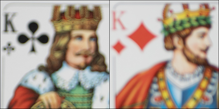

    The blur rendering in the focus transition zone is good. The background blur (to the left below) is mostly smooth with just a hint of nervousness at hard transitions. The foreground blur (to the right) is very smooth.

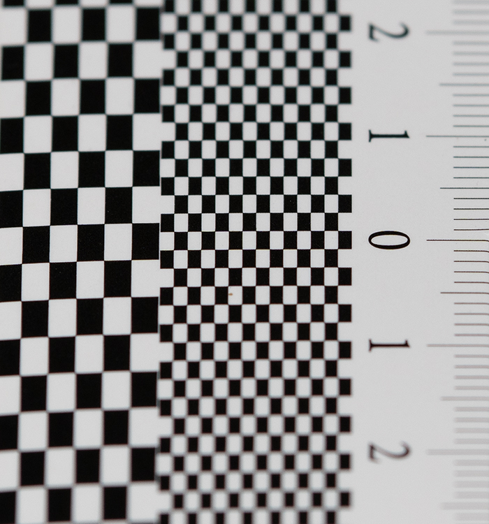

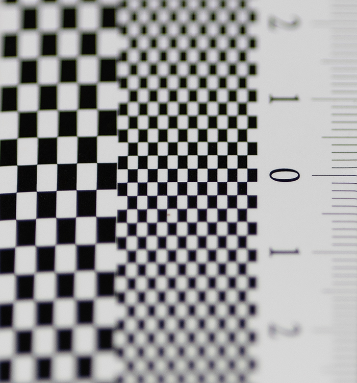

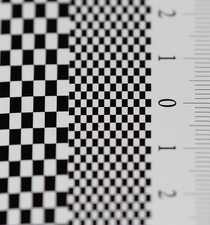

    The Laowa AF 200mm f/2 only shows a slight color fringing at f/2. Traces remain at f/2.8, and they are basically gone at f/4. A good result in this chapter for such a lens design.
    There is no detectable focus shift (RSA – “Residual spherical aberrations”) when stopping down.
    f/2f/2.8f/4f/5.6
