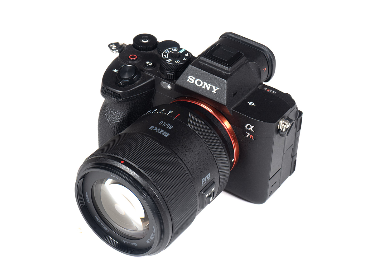

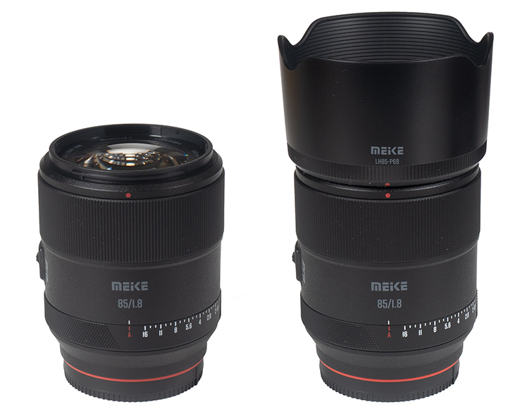

    The build quality of the Meike AF 85mm f/1.8 Pro is good and in line with what you can expect from a consumer-grade product. The lens barrel is made of a combination of metal and engineering plastics. The focus ring turns very smoothly. You can feel a bit of cost-cutting with the dedicated aperture ring. It isn’t wobbly, but it slips too easily and doesn’t really “soft-lock” in A-mode, which can be annoying if that’s your preferred shooting style. It’s also not “de-clickable”. There is a mount gasket, which should provide some protection against the elements. A petal-shaped lens hood is provided, as you can see below.
    The lens uses an STM (Stepping Motor) for autofocusing. It does the job, although it’s certainly not suitable for sports. The AF action is, however, very smooth. Manual focusing works “by-wire” as usual. Firmware updates are possible via a USB-C port on the mount.

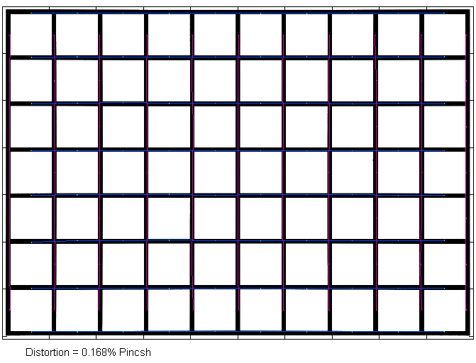

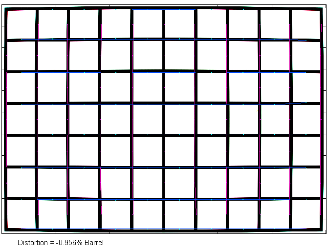

    The Meike AF 85mm f/1.8 Pro produces a native image distortion of ~1% barrel-style. This is within normal limits for such a lens. However, unlike some other Chinese players, Meike implemented a full correction profile, which reduces the issue to a negligible degree.

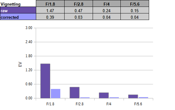

    The raw vignetting is typical for a fast medium tele prime lens. At f/1.8, the light falloff reaches ~1.5 EV (f-stops). Stopping down to f/2.8 cuts down to 0.5 EV, which is already pretty good. And there’s a little further reduction when stopping down to f/4 and f/5.6.
    Profile auto-correction produces a negligible vignetting from f/1.8 already.

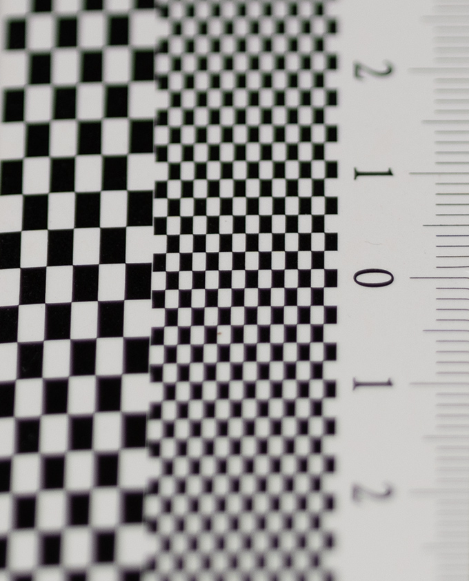

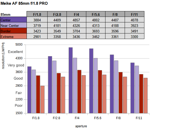

    The Meike lens produced decent resolution figures in the lab. At f/1.8, the broader center is very good, although the contrast level suffers somewhat here. The borders are good, whereas the corners are a bit soft. This changes at f/2.8 where the center gains some “bite”, and the outer image field is generally good. The peak performance is reached between f/4 and f/5.6. The center is excellent at these settings, and the border quality improves somewhat as well. Diffraction is a limiting factor beyond, as usual.
    The centering quality of the tested sample was Ok. The field curvature is flat.

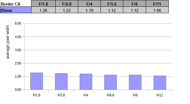

    Lateral CAs are slightly higher than with other lenses in this class. The border CAs hover around an average width of 1.2px. This can be visible in high-contrast scenes.

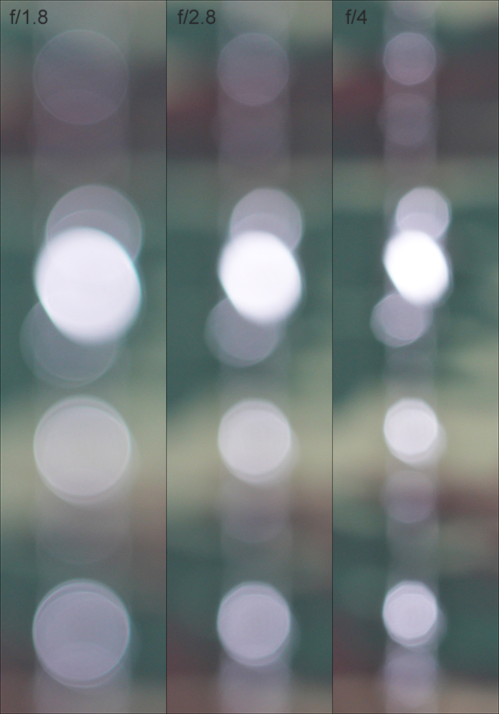

    A fast medium tele lens isn’t just about sharpness, but also about the out-of-focus rendering, aka the bokeh – so let’s take a look.

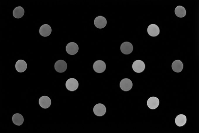

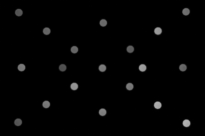

    Out-of-focus highlights are nicely rendered near the image center. The inner zone of the discs is smooth despite the aspherical element in the design. There is an outlining at the edges, which is more visible in highlights beyond the center. The circular shape remains intact up to f/2.8. A slight edginess creeps in at f/4.
    When looking at the highlight rendering across the image field, we can observe only a minor deterioration of the discs towards the edges of the image field. This is quite unusual. Most lenses tend to produce “cat eyes” at maximum aperture. Stopping down to f/2.8 fully restores the circular shape.
    f/1.8f/2.8f/4

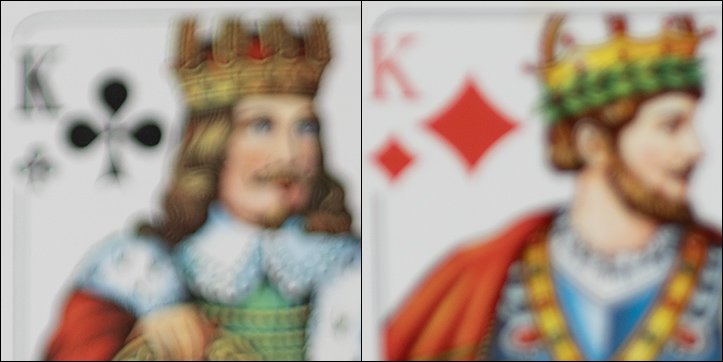

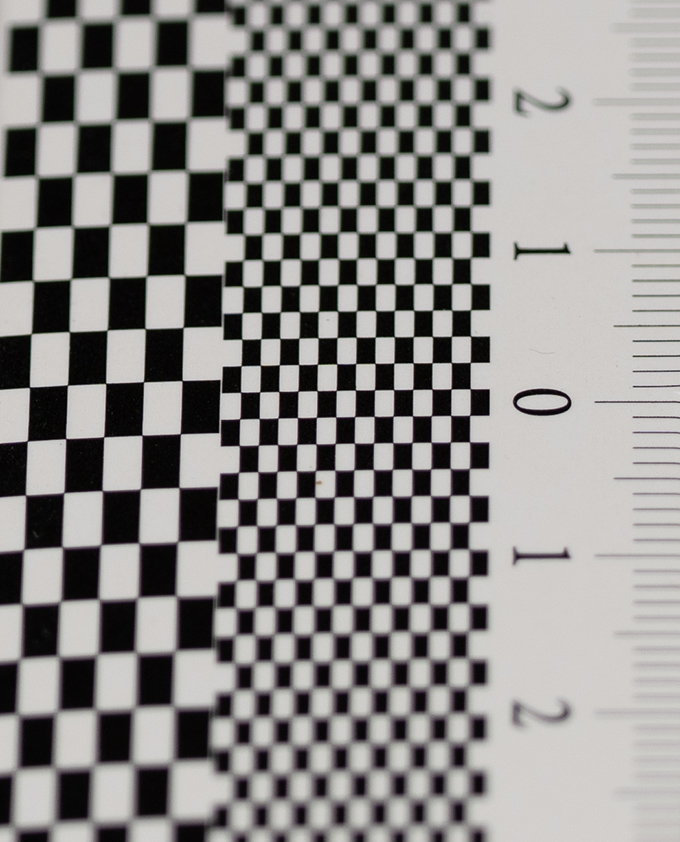

    The blur in the focus transition zone reveals an issue – the important background blur – shown the left below is quite rough with a bit of smearing. The foreground blur is smooth, though, but that’s usually of lesser concern.

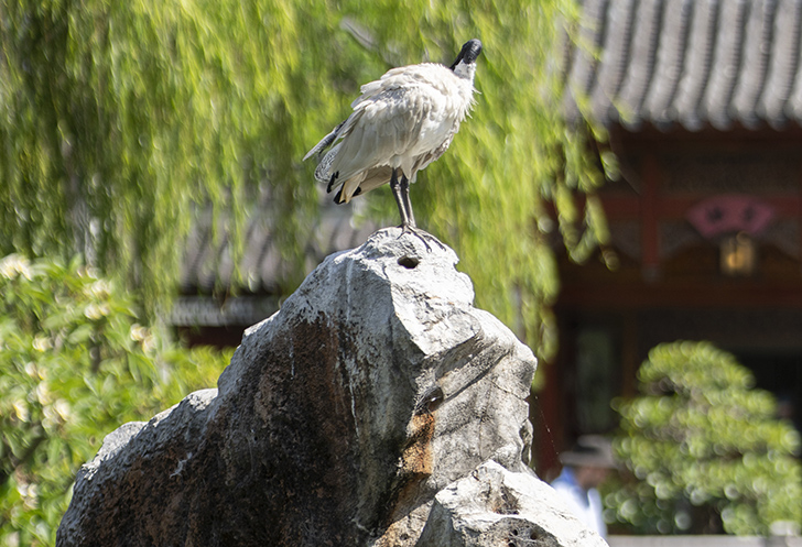

    To illustrate the background blur in a real-world scene (cropped, the sample image is also available below in full size):
