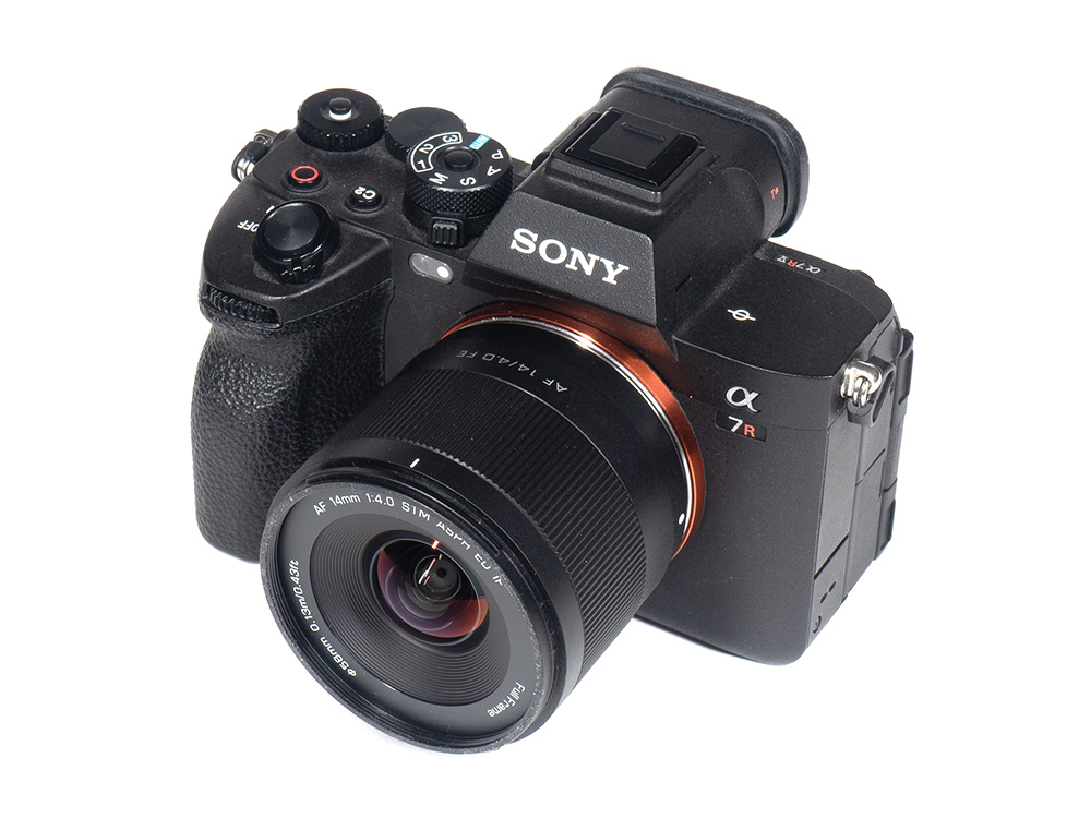

    We’ve seen many ultra-wide lenses during the last few years, but there’s probably always room for another one. So, let’s welcome the Viltrox AF 14mm f/4 FE Air. Not all of us require high-speed – and as such, big – prime lenses, so it’s refreshing to see that Viltrox took a different route here. By limiting the max aperture to f/4, the lens is compact – amazingly so, actually. Another amazing aspect is the price tag. “Air” lenses are targeting the “normal” consumer market, and at just $199 USD / 229 EUR / 190 GBP / 289 CAD / 33,000 JPY, this one is clearly at the very affordable end of the market – which is nothing short of baffling for a lens this wide.
    However, affordable doesn’t mean cheap. Yes, Air lenses are featherlight, but the plastic quality is actually quite decent, and the focus ring turns smoothly. As usual, you will find a USB-C port on the metal mount for firmware updates. Weather sealing has not been implemented, but the internal focusing should provide some protection at least.  A small petal-shaped hood is part of the package.
    The AF uses a conventional STM (stepping motor), which is well sufficient for moving the small lens elements in a fast and silent manner. Manual focusing is very precise.
    Optical construction12 elements in 9 groups, incl. 4x ED, 2x HR, 2x aspherical
    Number of aperture blades7
    min. focus distance0.13m (max. magnification 0.23x)
    Dimensions65×56.4mm
    Weight170g
    Filter size58mm
    Available MountsSony FE, Nikon Z

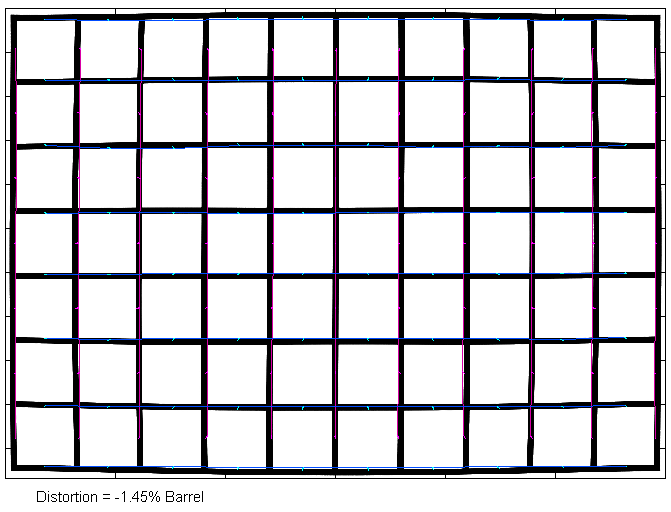

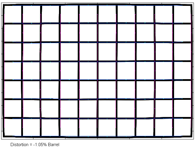

    Ultra-wide lenses tend to have heavy image distortions, but this isn’t really the case with the Viltrox AF 14mm f/4 FE Air. RAW images show just a mild degree of barrel distortion. Auto-correction improves this a bit without solving the issue completely.
    RAWAuto-Corrected

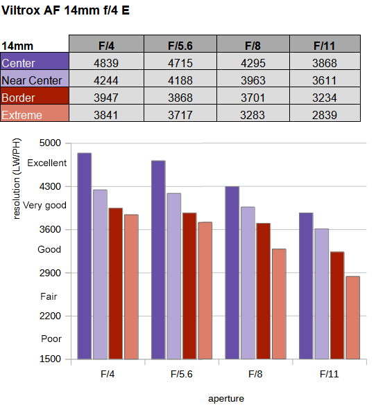

    The Viltrox lens does a surprisingly good job when it comes to sharpness. Peak performance is already reached at f/4 with an excellent center quality and a very good outer image field. Much more expensive lenses rarely achieve this. The lens is diffraction-limited, so stopping down doesn’t improve the technical quality but only the depth of field. You shouldn’t stop down much beyond f/8. At f/11, diffraction has a quite high impact already.
    The field curvature of the lens is surprisingly low. The centering of the tested sample was good.

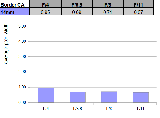

    Lateral CAs are fairly low, with a peak CA pixel width of ~0.7px or less at the image borders.

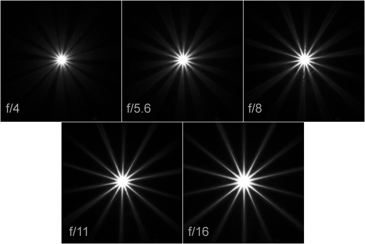

    Sun Stars
    Below is a sequence of 100% cropped images from f/4 all the way up to f/16 – illustrating the sun star behavior. Sun stars are an aperture effect that shows up if a bright light source is part of the scene (usually in night shots).
    It seems that the Viltrox AF 14mm f/4 FE Air doesn’t have a fully circular aperture at f/4, because there are already traces of rays visible at this setting – which isn’t a problem, just an observation. As usual stopping down increases the effect, and decent sun stars are already available at f/8, with really good results at f/11 and, of course, f/16.
