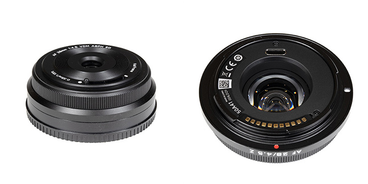

    As you may spot from the product images, we are talking about a full format pancake lens here. It offers both autofocus and electronic coupling, but it also has a fixed aperture. f/4.5 it is. No more, no less.
    The build quality of the Viltrox AF 28mm f/4.5 VCM is fine, although you can feel that it was made to a budget. It does, however, feature a metal mount, whereas the tiny lens body is made of plastic.  Another oddity besides the lack of a (changeable) aperture is the lack of a focus ring – AF is all that you’ve got here. The threaded part on the barrel is only meant to support you with the mounting/unmounting of the lens. You may also spot a USB-C port on the rear of the lens – meant for firmware updates.
    Despite the tiny size, Viltrox managed to add a sliding lens cap that you can engage via a lever. The lever doesn’t feel super sturdy, but it does the job. As you may imagine, a lens hood is not provided because it somewhat contradicts the concept of a pancake lens. There’s also no filter thread.

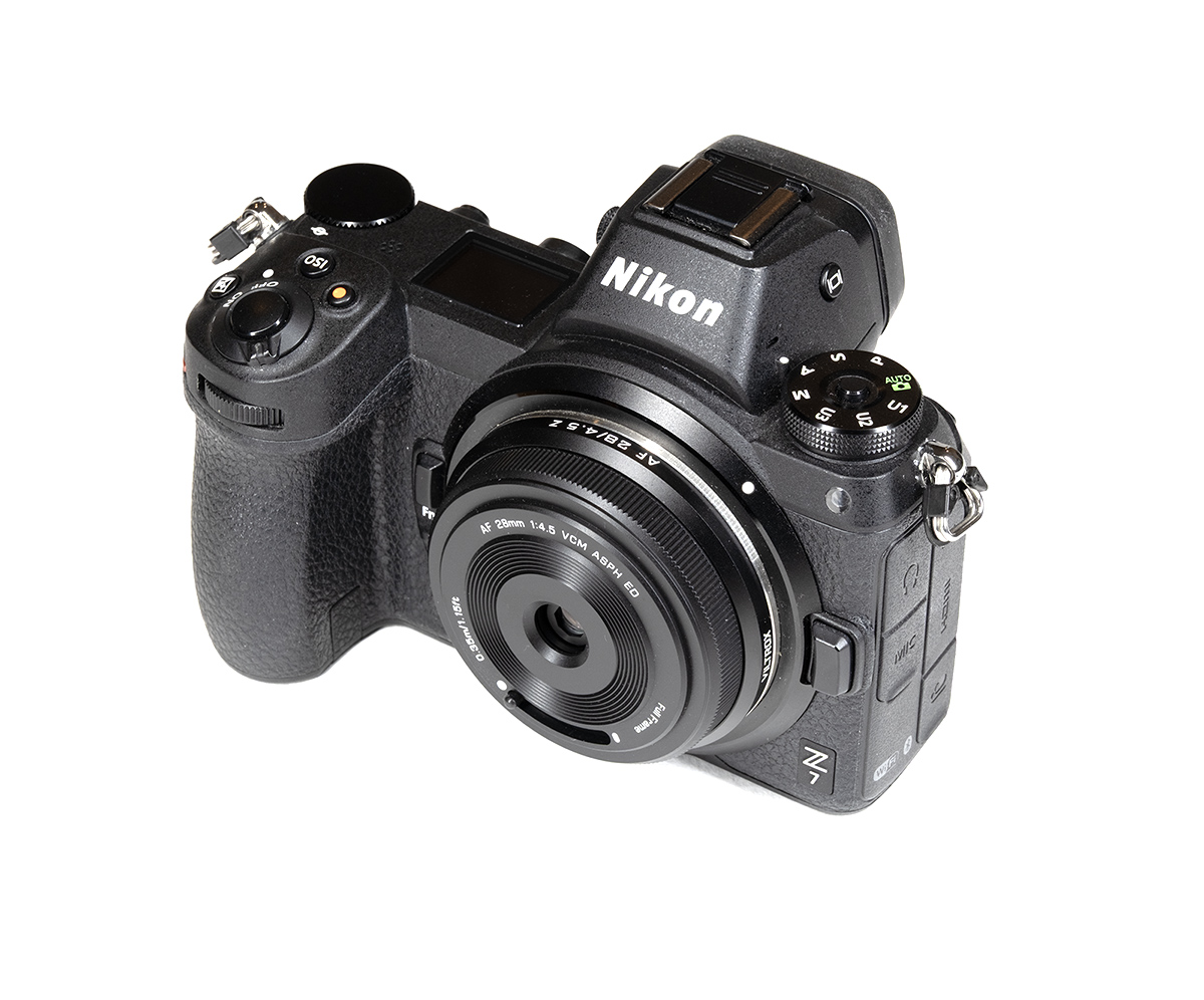

    Typical for most pancake lenses, the AF uses an extension system to shift the “whole” optics for focusing. It’s not a speed demon on our oldish Z7, but it does the job.

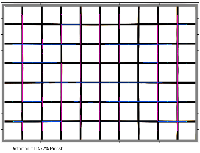

    Let’s start with something positive—image distortions. Unlike the Japanese manufacturers, Viltrox is (almost) fully correcting its lenses (to date, at least), so image auto-correction isn’t necessary. This is good because distortion correction is a lossy procedure.  The 28mm f/4.5 has a slightly wavy distortion, which Imatest identified as pincushion distortion – which you can debate or not. In any case – it’s not much.

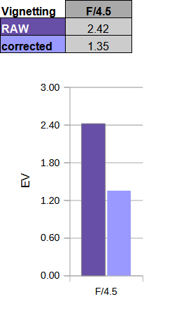

    The vignetting is quite heavy in RAW images with a light falloff of 2.4 EV (f-stops). Surprisingly, Viltrox walked the extra mile here and implemented a correction profile, which cuts this down by almost 50%. Stopping down is not supported, so that’s a short chapter here.
    Please note that the values are slight lower compared to our Sony E-mount review. This relates to the different tone curve used by Nikon.

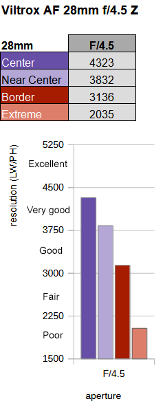

    The resolution characteristic of the VIltrox lens is mixed on a high-resolution sensor. The broader center performance is surprisingly high, with very good results in the dead center and just a little less near the center. However, there’s a sharp drop beyond. The border quality is lower – albeit still quite decent- whereas the extreme corners are soft. It’s a bit of a pity that you can’t stop down the lens here – because it would certainly be much sharper at f/8.
    The centering quality of the tested sample wasn’t great. A better sample could have produced higher results.

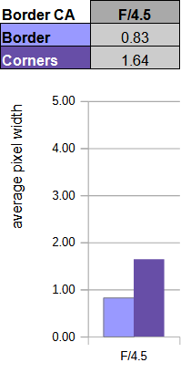

    Lateral CAs are reasonably well managed at the image borders, but they do increase in the image corners. A good RAW converter should be able to handle this, though.
    The values are somewhat different compared to our Sony E-mount review. This relates to sample variations.
