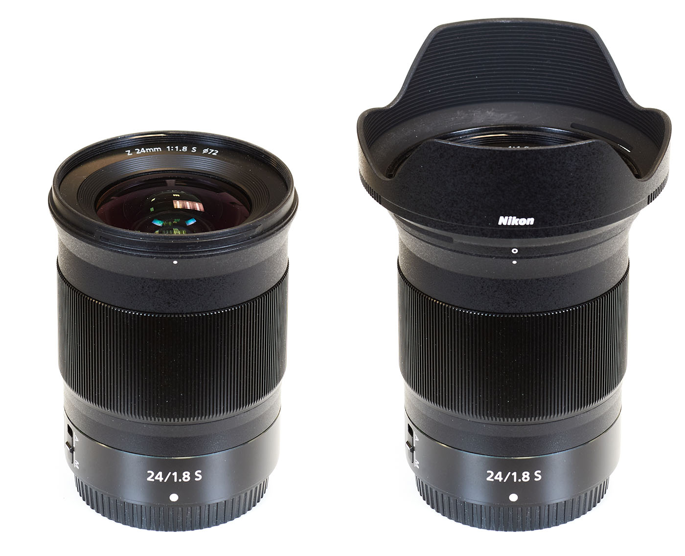

    The lens shares its minimalistic design characteristic with the other Z-mount f/1.8 prime lenses. The weather-sealed lens body consists of a mixture of tightly assembled polycarbonate and metals parts.
    As on many other Z lenses, the number of controls on the lens is reduced to a minimum: there is an AF/M switch, the focus ring… and that’s about it.

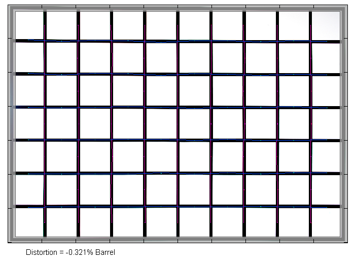

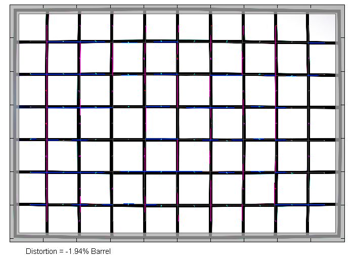

    The Nikkor Z 24mm f/1.8 S produces a medium amount of barrel distortion of close to 2%. This is a bit on the high side, but we have also seen a lot worse in this segment. Image auto-correction can reduce the issue to a negligible degree though.

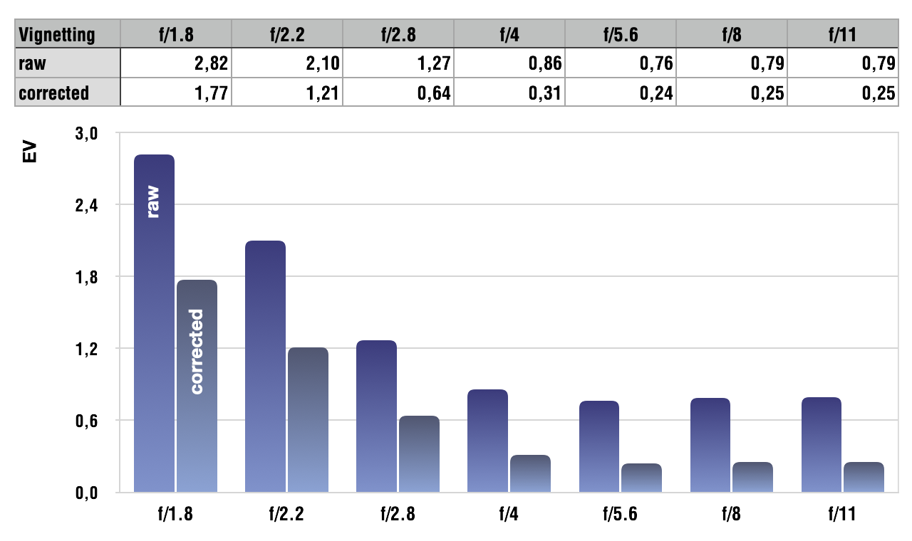

    The lens suffers from a fairly high amount of vignetting at large apertures. At f/1.8, it reaches almost 3EV (f-stops) which is very noticeable. It’s not much better at f/2.2 and acceptable figures aren’t reached before f/4 really.
    Activating software correction is, therefore, a good idea with this lens. At the default “normal” correction setting, the light falloff remains visible at f/1.8 but reaches very acceptable levels from f/2.8 onward.
    To get even better results, you can set the in-camera correction to a more aggressive setting or, preferably, use a compatible RAW converter. This converter can use the lens correction profile that is always included in the NEF files. Using those profiles, the vignetting can be brought down to zero at large aperture settings.

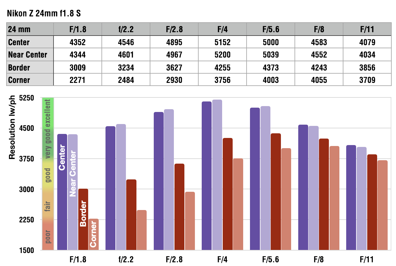

    The Nikkor Z 24mm f/1.8 S is a bit of a mixed bag regarding its resolution characteristic. At f/1.8 the broader center quality is perfectly fine but the outer image field is comparatively soft, especially in the corners.
    Stopping down to f/2.2 doesn’t improve the situation substantially. A more significant boost sets in at f/2.8. The center quality reaches excellent levels here and the borders are pretty good. The corners remain unimpressive, however. This changes from f/4 onward where the corners are lifted to very good quality (just).
    The peak performance is reached around f/5.6. Diffraction is a limiting factor beyond. f/8 is perfectly fine, but there’s already a drop at f/11 (on high megapixel sensors at least) and f/16 should be avoided.
    Below is a simplified summary of the formal findings. The chart shows line widths per picture height (LW/PH) which can be taken as a measure for sharpness. If you want to know more about the MTF50 figures you may check out the corresponding Imatest Explanations

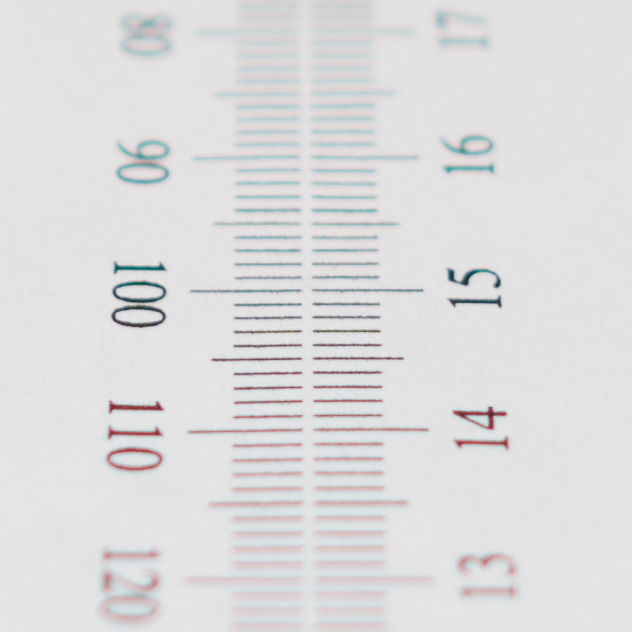

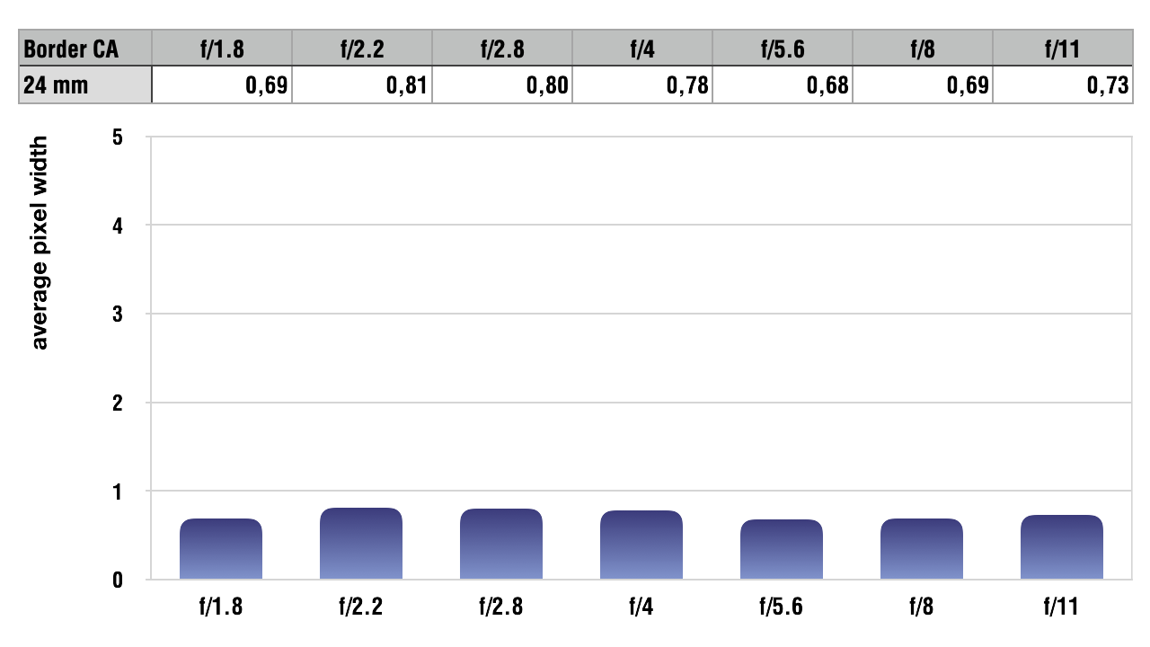

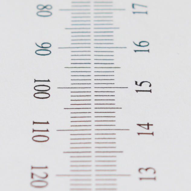

    Chromatic aberrations (color shadows at harsh contrast transitions) are well controlled, with values of around 0.5 pixels on average at the image borders wide open, slowly increasing to almost 0.8 pixels stopped down to f/11.

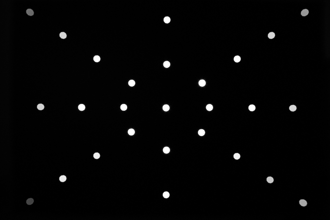

    It’s usually not the primary way to use a wide angle lens, however the Nikkor has a comparatively short minimal focus distance combined with a fairly large maximum aperture, so it allows to separate a (close) main subject from the background. In such a shot, the quality of image blur in out-of-focus areas is important.
    Typically, wide angle lenses with aspherical elements struggle in this regard. The Nikkor however delivers very pleasing results. General image blur both in front of as well as behind the focal plane is surprisingly smooth.
    Background highlights are evenly filled and show almost no outlining wide open, a little more so when stopped down, however. In addition, there are traces of bokeh fringing around highlights (see the next section).
    The shape of the highlights deteriorates a bit towards the image borders due to mechanical vignetting at large apertures. However, stopping down solves that issue.
    Thanks to the 9 rounded aperture blades, the highlights remain almost circular even at smaller apertures. Eagle-eyed readers may spot traces of the aperture blades in the highlights at medium aperture settings.

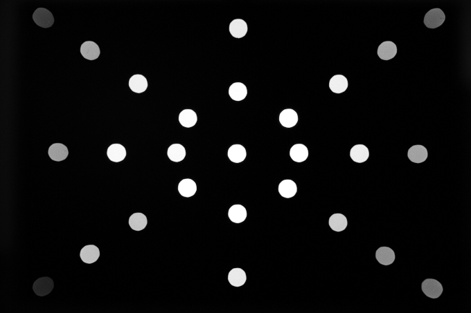

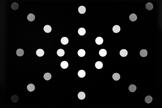

    f/1.8f/2.2f/2.8f/4f/5.6f/8
