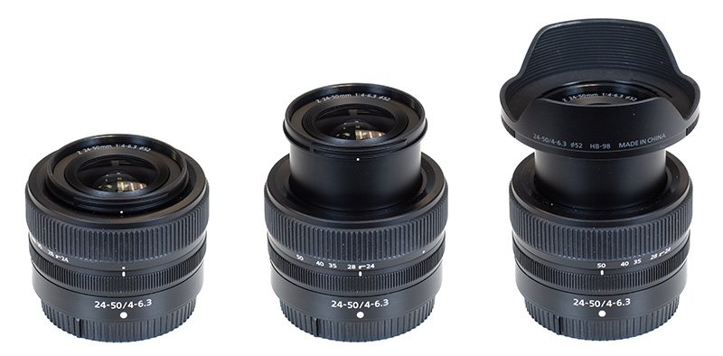

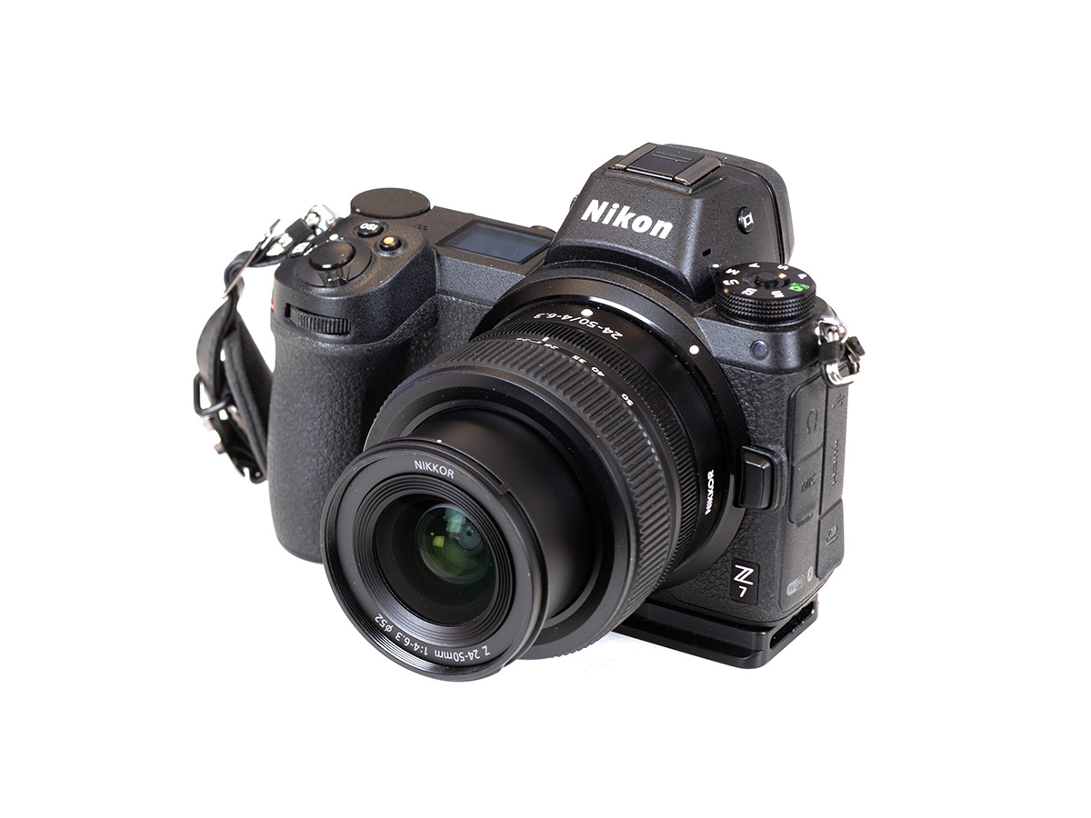

    In terms of build quality, it’s quite obvious that there’s some cost cutting going on here. The lens body is made from plastic down to the lens mount. Nikon is quite fond of retractable zoom lenses so they applied this here as well. Thus, you will have to rotate the zoom ring from its “lock” position to the 24mm mark to be able to use the lens. It may be a bit annoying but on the positive side, the length of the lens is tiny at just 51mm in its transport position. The physical controls are minimalistic. There’s the mentioned zoom ring and a customizable control ring that defaults to focus control. There is no AF/MF switch so you have to set this on the camera. This is perfectly fine considering the target user segment, of course. Surprisingly, Nikon still implemented some weather sealing. The petal-shaped lens hood is optional here.
    The Nikkor uses a STM (Stepping Motor) for autofocusing. It’s an older motor type but perfectly adequate here. The AF speed is just fine and it’s quiet during operations. Focus breathing is fairly well-controlled.

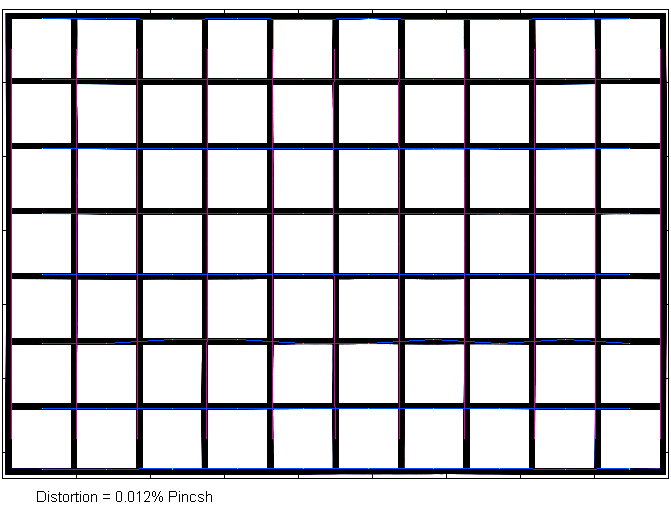

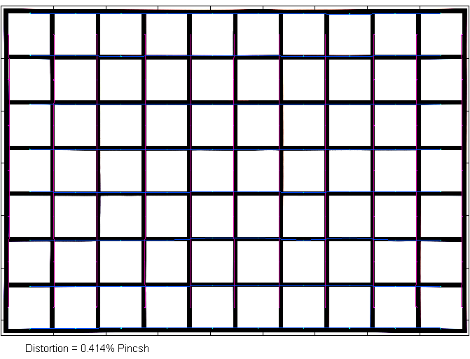

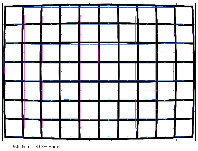

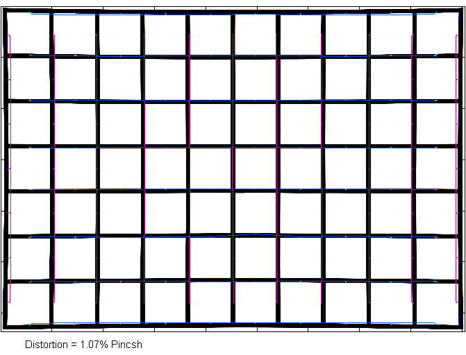

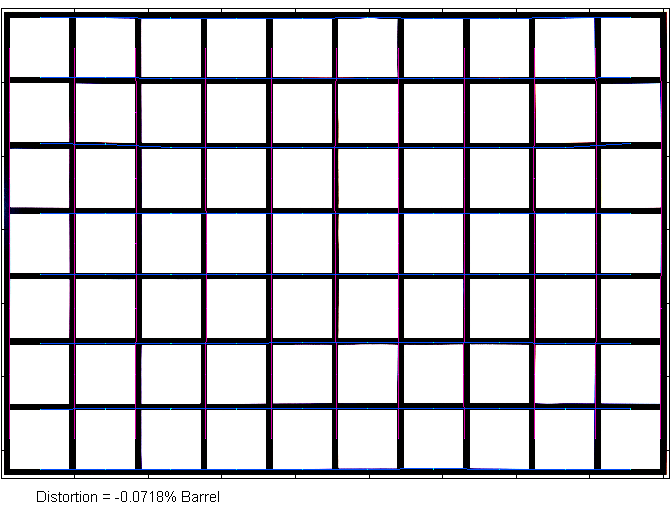

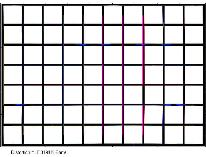

    You may think that distortion control isn’t really a strength of the little Nikkor. However, it isn’t all that bad really. RAW images show a barrel distortion of ~3.7% at 24mm. We have seen A LOT worse than this on some other lenses. At 50mm, there is a mild pincushion-style distortion. And the two distortion types even out around the 35mm mark.
    24mm35mm50mm
    Auto-correction reduces the distortions to a negligible degree as you can see below.
    24mm35mm50mm

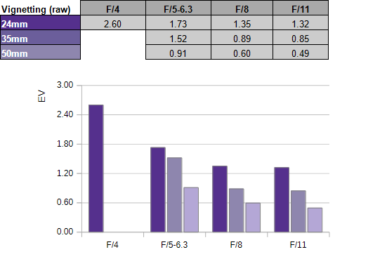

    Unsurprisingly, the lens produces a fairly heavy raw vignetting of 2.6 EV (f-stops) at 24mm f/4. This is reduced by roughly 1 EV at f/5.6 and it settles at 1.3 EV at f/8. This isn’t quite as noticeable at other focal lengths. You will still see some vignetting at maximum aperture, but once again, stopping down a bit helps.
    Most users, and certainly most beginners, will just leave autocorrection activated and this reduces the vignetting to a negligible degree even at fully open aperture settings.

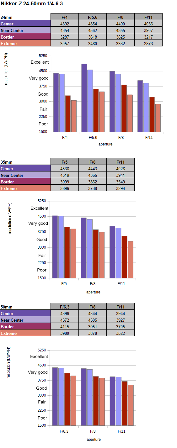

    A cheap lens can’t be good, right? Well, the Z 24-50mm f/4-6.3 is actually better than what you might expect. The broader center is actually pretty good at all relevant settings. Unsurprisingly, the weakest spot is at the wide end. The outer image field is mostly good with only some softness creeping in at the last corner pixels (outside of our test spots). The performance is more uniform at 35mm and 50mm with very good results across the image frame.
    The tested sample had a slightly uneven centering.

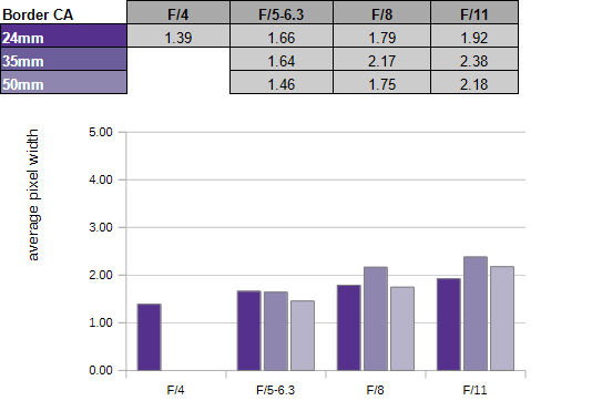

    Lateral CAs are a bit on the high side. They reach a width of roughly 2px at the image borders when stopped down to medium aperture settings. However, keep in mind that lateral CAs are losslessly autocorrected in JPEGs and most RAW converters so it’s not a big deal in real life.
