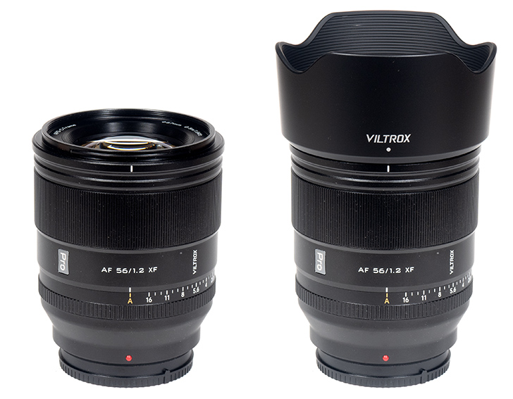

    Mechanically, the Viltrox AF 56mm f/1.2 Pro XF feels great. The lens body is made of metal, and this includes the smooth focus ring as well as the dedicated aperture ring. This does, however, also mean that the lens is comparatively heavy at 575g. The lens features sealing against dust and moisture. The X-mount version is slightly simplified compared to the E- and Z-mount versions. The latter also offer an AF/MF switch, a customizable Fn button, and a declick mode for the aperture ring. A petal-shaped lens hood is part of the package. New firmware can be uploaded via a USB-C port.
    The AF is driven by a HyperVCM (voice coil motor), which is very fast and silent. Manual focusing works “by-wire” and is very precise (which can’t be said about the Fujinon XF 56mm f/1.2 R WR…).

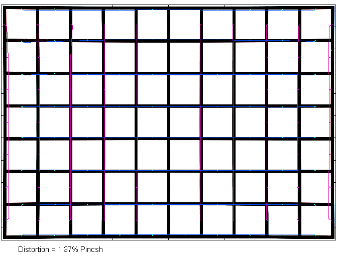

    The Viltrox AF 56mm f/1.2 Pro XF produces a slight to medium amount of pincushion distortion in RAW images. Auto-correction is not available in the X-mount version.

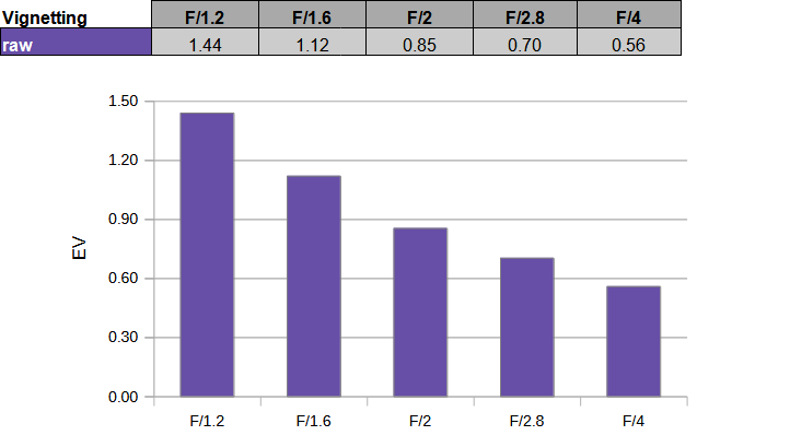

    Ultra-large aperture lenses tend to produce high vignetting at max aperture. The Viltrox lens is no exception here. At f/1.2, the vignetting is quite noticeable at just over 1.4 EV (f-stops). Stopping down reduces the issue gradually. It’s still present at f/1.6 and well managed from f/2.8 onward.
    Once again, auto-correction is not available in the X-mount version.

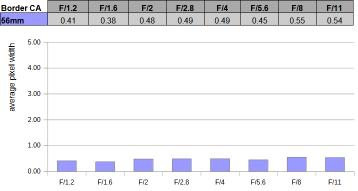

    Lateral CAs have an average width of around 0.5px at the image borders and max aperture. This is almost negligible, even without auto-correction.

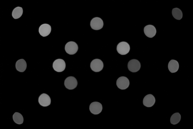

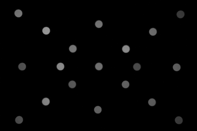

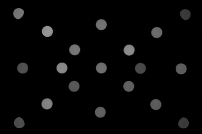

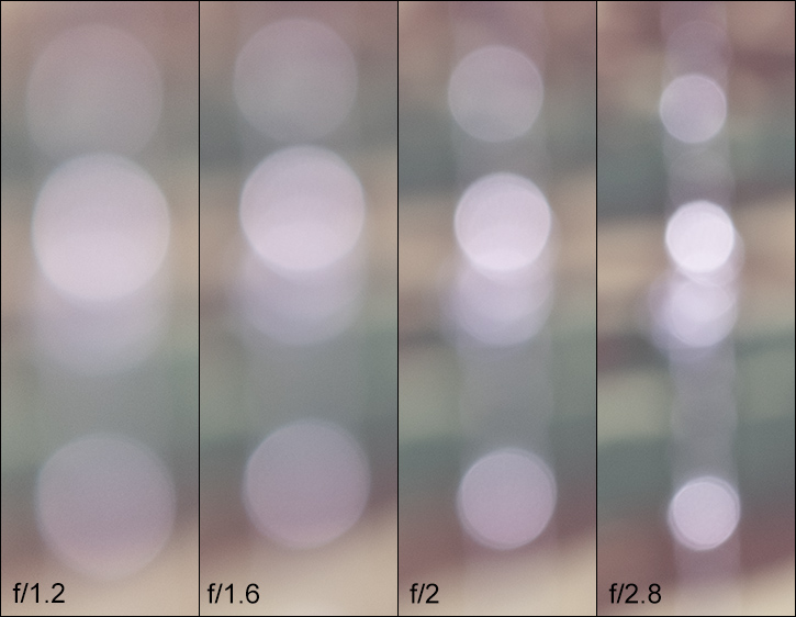

    Out-of-focus highlights are nicely rendered with a very smooth inner zone of the discs and barely any outlining effect. The circular shape of the discs remains intact even at f/2.8 – thanks to the 11 rounded aperture blades.
    When looking at the highlight rendering across the whole image field, we can spot a deterioration towards “cat-eyes” from roughly the near mid-field into the corners. As usual, stopping down will broaden the zone showing circular discs, and the corner discs are restored at f/2.8.
