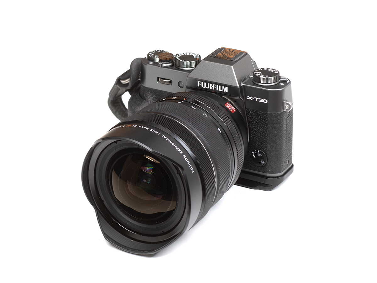

    There aren’t many Fujifilm “red-label” lenses around. They are the members of the exclusive club of high-end lenses. One of them is the Fujinon XF 8-16mm f/2.8 R LM WR. It’s the widest zoom lens available in X-mount. As you might expect, it’s far from being affordable at about $1800 USD.

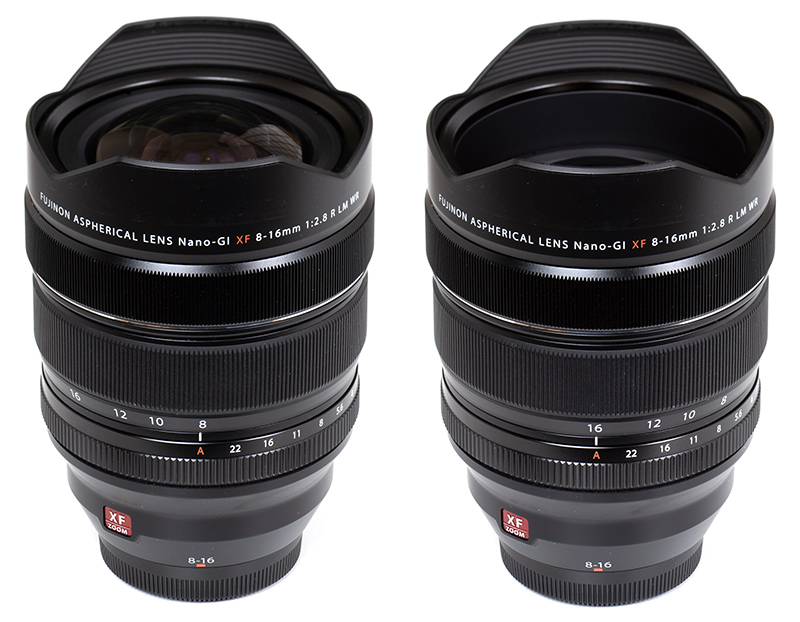

    Professional-grade lenses deserve a professional-grade build quality and the XF 8-16mm f/2.8 R LM WR does qualify here. The lens body is mostly made of metal alongside the broad rubberized zoom-ring. The rugged construction and huge glass elements come at a price – at 805g it is neither compact nor lightweight, though. Fujifilm incorporated 11 seals to prevent dust and moisture from entering the inner sanctum. It’s also freeze-proof down to -10°C. The lens maintains a constant physical length during zooming, although there is an inner lens tube that still moves within the limits of the built-in lens hood. You may notice the bulb-like front element in the product image below – thus, no front-filter support here. Third-party vendors can supply 150mm square filter holder adapters if needed.

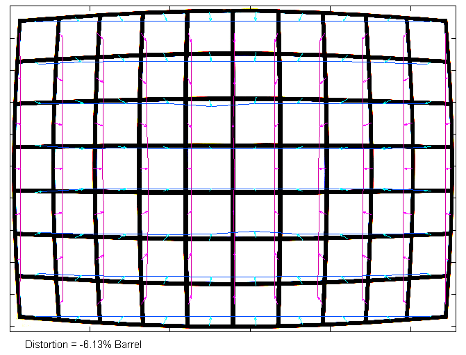

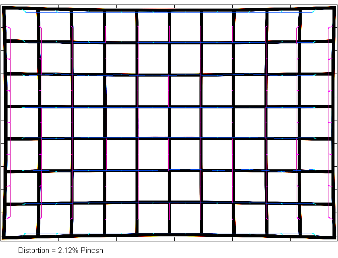

    Given the immense size and large glass elements, it’s a bit disappointing that the Fujinon isn’t distortion-corrected. Raw images reveal a barrel-distortion of over 6% at 8mm. The distortion forces equalize around the 12mm mark before switching to pincushion distortion beyond. They reach 2% at 16mm.

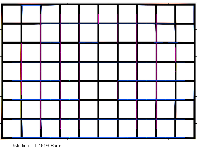

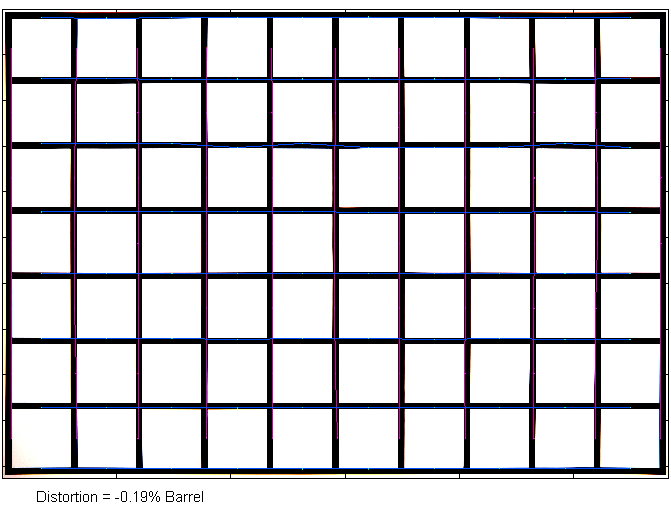

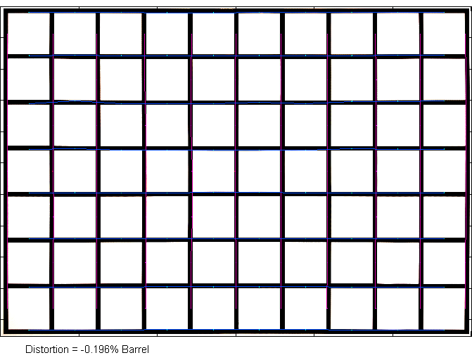

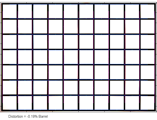

    Activated auto-correction reduces this to an almost negligible degree, although there’s a tiny bit of waviness at 8mm at least.

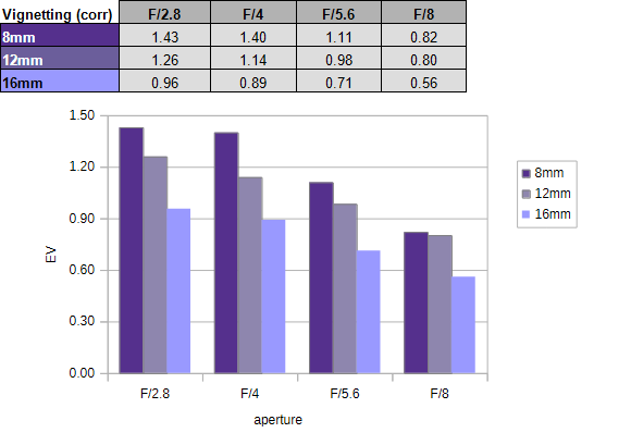

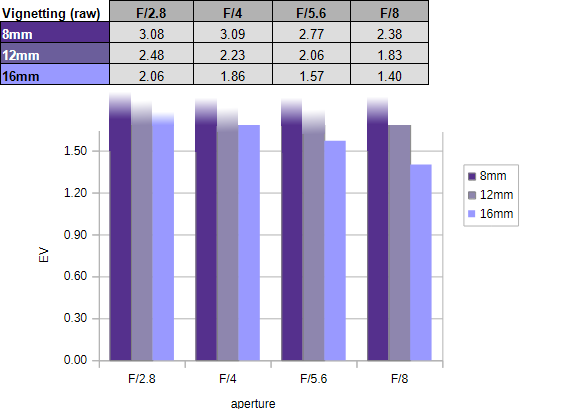

    Ultra-wide lenses always come with a very high vignetting. However, the raw vignetting is still very high for an APS-C format lens. They peak, of course, at 8mm f/2.8 exceeding 3 EV (f-stops) here. Stopping down doesn’t help all that much. The light falloff is reduced at “longer” focal lengths but the results exceed our vignetting scale at all settings except at 16mm f/8.
    So autocorrection has to work hard here to resolve the issue. The vignetting remains high at most settings, specifically at the wide end.

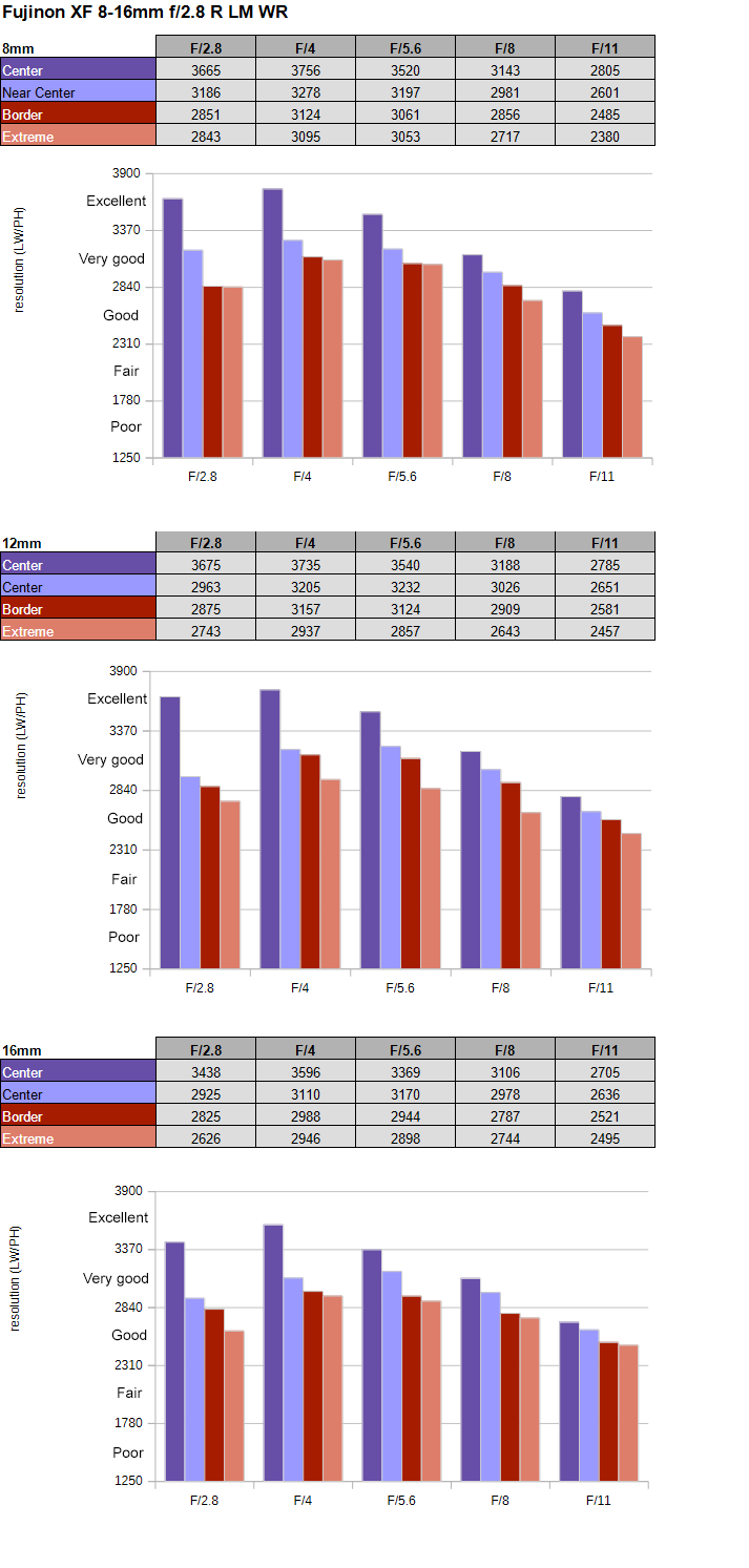

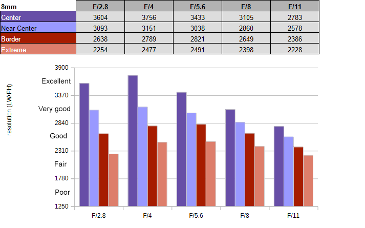

    MTF (resolution) at 26 megapixels – Uncorrected
    Note: Typically we measure the image resolution in RAW images to avoid interference from image interpolation. This is fine unless the image distortions are excessive. The XF 8-16mm f/2.8 has massive distortions at 8mm, though, so please also check the next chapter.
    The Fujinon XF 8-16mm f/2.8 R LM WR produced a very respectable result here. The dead center is extremely sharp and the near center is easily very good throughout the zoom range and up to f/8. The quality in the outer image field is also impressive with good to very good results. However, there’s a caveat: at 8mm, the far corners, thus the last pixels that lie outside our measurement spot, soften quite a bit. In part, this is also due to increasing field curvature.
    The centering quality of the tested sample was fine.

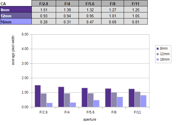

    Lateral CAs are well-controlled for such a lens. They are most pronounced at 8mm with a peak width of 1.5px at the image borders. They are a bit reduced at 12mm and fairly low at 16mm.
    Auto-correction should be able to resolve this issue without negative sideeffects, though (some RAW converters are better than others …).
