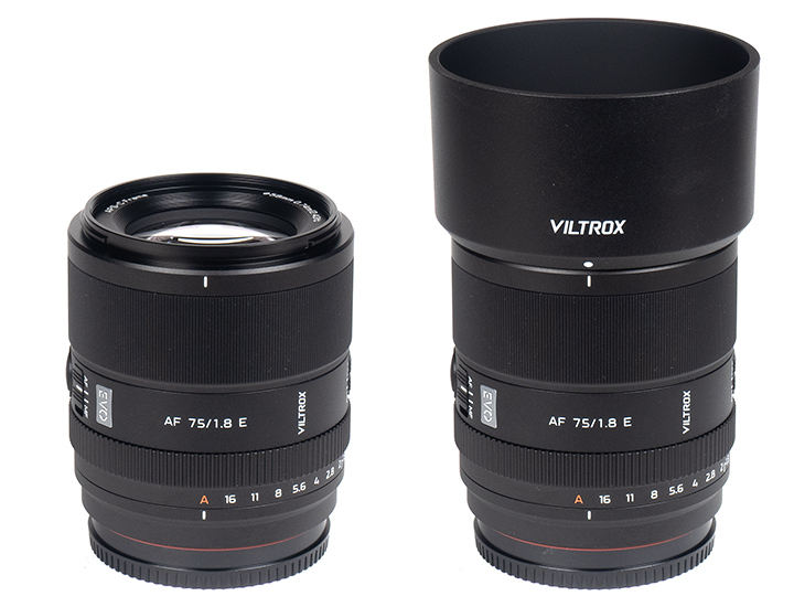

    New, dedicated APS-C format prime lenses from OEMs have become a bit of a rare sight outside the Fujifilm ecosystem. However, Viltrox has been putting some new life into this format lately. Besides the AF 90mm f/2.2 EVO, Viltrox just released the Viltrox AF 75mm f/1.8 EVO – again available in E-, Z- and X-mount. We’ve tested the E-mount version for this review. In full-format terms it’s equivalent to a 114mm f/2.7 putting it in between the classic 56mm (FF “85mm”) and 90m (FF “135mm”) focal lengths. Just like the other EVO lenses, it is very competitively priced at just 329USD (389EUR, 319GBP, 479CAD, 60,800JPY).

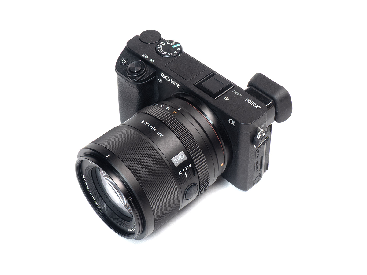

    The build quality is, once again, impressively high. The lens body is made of metal including the control rings. The focus ring is very smooth and the de-clickable (E-mount) aperture ring has a decent click action to it. We’d wish, however, that the A-mode has a more distinctive click because it can slip easily. It also features a customizable Fn-button. There’s also an AF/MF switch on the lens. The weather sealing is quite basic with just a gasket at the rear. A barrel-shaped lens hood is part of the package.
    The 75mm f/1.8 has an STM (stepping) motor for focusing that Viltrox uses for their more consumer-oriented lenses. There are faster AF motors out there, but it does the job and it does so silently.
    Optical construction11 elements in 9 groups (2x ED, 2x HR)
    min. focus distance0.74m (max magnification: 0.12x)
    Dimensionsφ 69×78mm
    Weight335g
    Filter sizeφ 58mm
    Other featuresAperture ring (de-clickable in E-mount, likely not in X-mount)
    Fn custom button (in E-mount, likely not in X-mount)
    Mount gasket

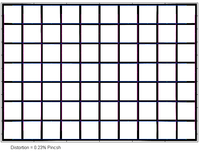

    The lens produces a native image distortion of just ~0.2% pincushion-style. This is negligible. A correction profile isn’t provided nor is it needed here.

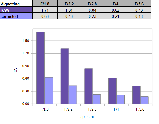

    The native vignetting characteristic is on the high side. At f/1.8 it produces a light falloff of 1.7 EV (f-stops). That’s beyond the 0 to 1.5 EV range that we expect from APS-C lenses. The vignetting is much reduced at f/2.8 and well controlled from f/4.
    The E-mount version of the AF 75mm f/1.8 EVO does have a correction profile for this, and the issue is well managed from f/1.8. It’s almost negligible from f/2.2 already.

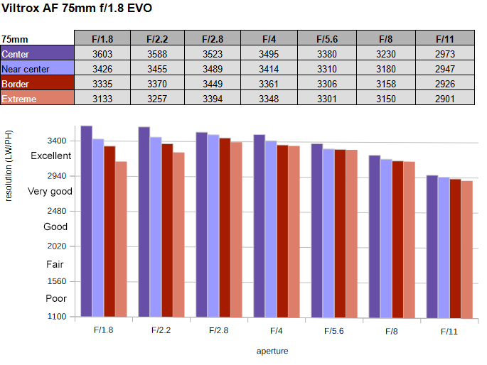

    MTF (resolution) at 24 megapixels
    The Viltrox AF 75mm f/1.8 EVO produced outstanding results in this chapter. In fact, it has the best MTFs that we’ve ever seen among the APS-C lenses in Sony E-mount. The sharpness is almost perfect at f/1.8 and stellar at f/2.8. It stays great up to f/8. Diffranction has a higher impact from f/11.
    The centering quality of the tested sample was excellent. The field curvature is flat.
    There are marginal deviations compared to our E-mount review, but the sensor is different, and we are also using slightly different conversion parameters in Z-mount, and there’s always a little sample-to-sample variation even in the best of cases.

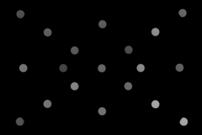

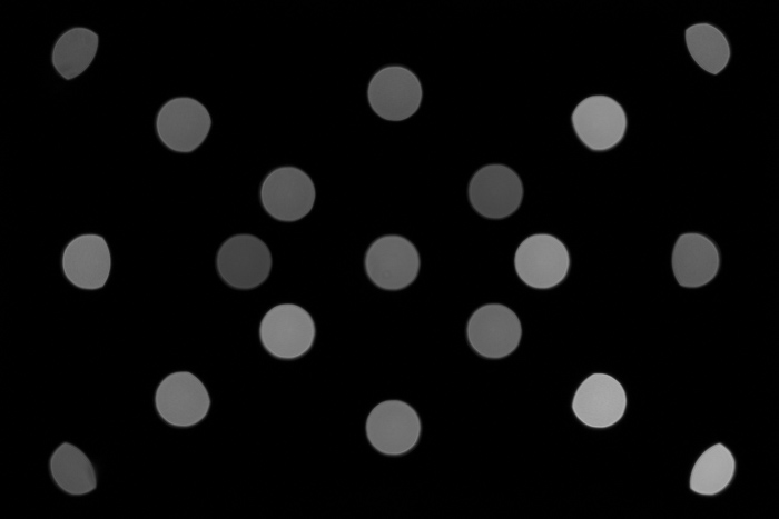

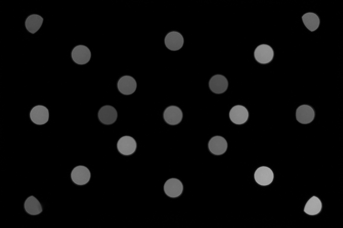

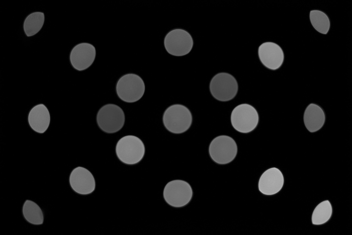

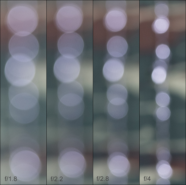

    The Viltrox EVO tele lenses don’t incorporate aspherical elements so out-of-focus highlights have a very clean inner disc structure. There’s a little outlining effect at the disc edges. The circular shape of the discs (in the center) remains intact until f/2.8 with a hint of edginess visible at f/4.
    The highlights deteriorate to “cat eyes” the more they are positioned towards the borders / corners – this is a mechanical effect related to the size of the front opening of a lens. Stopping down restores the shape but the corner discs aren’t fully circular even at f/4.
    f/1/8f/2.2f/2.8f/4

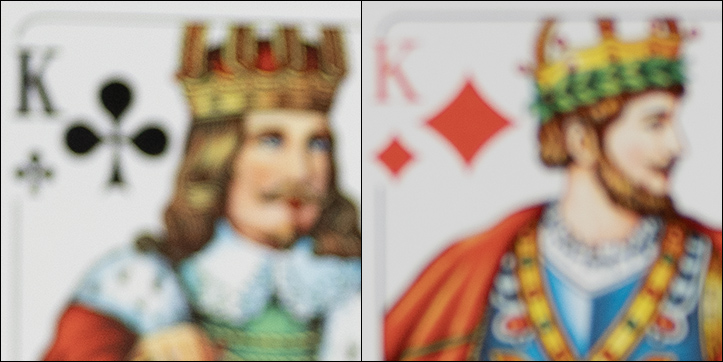

    The blur in the focus transition zone is quite smooth but a bit too contrasty in the image background (shown to the left below). The foreground blur (to the right) is slightly “shadowy”.

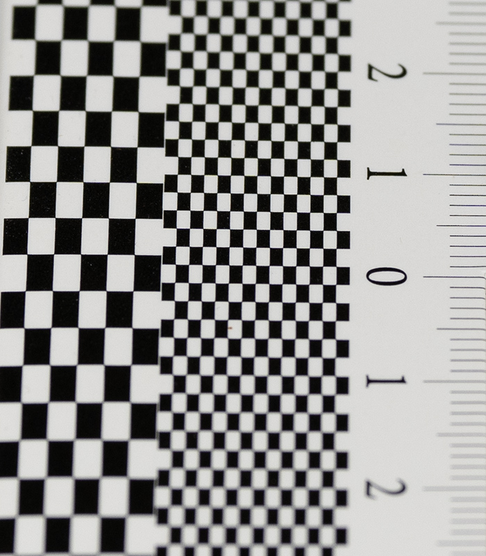

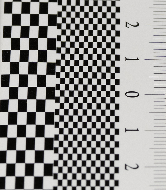

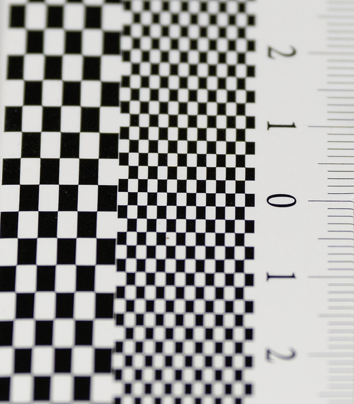

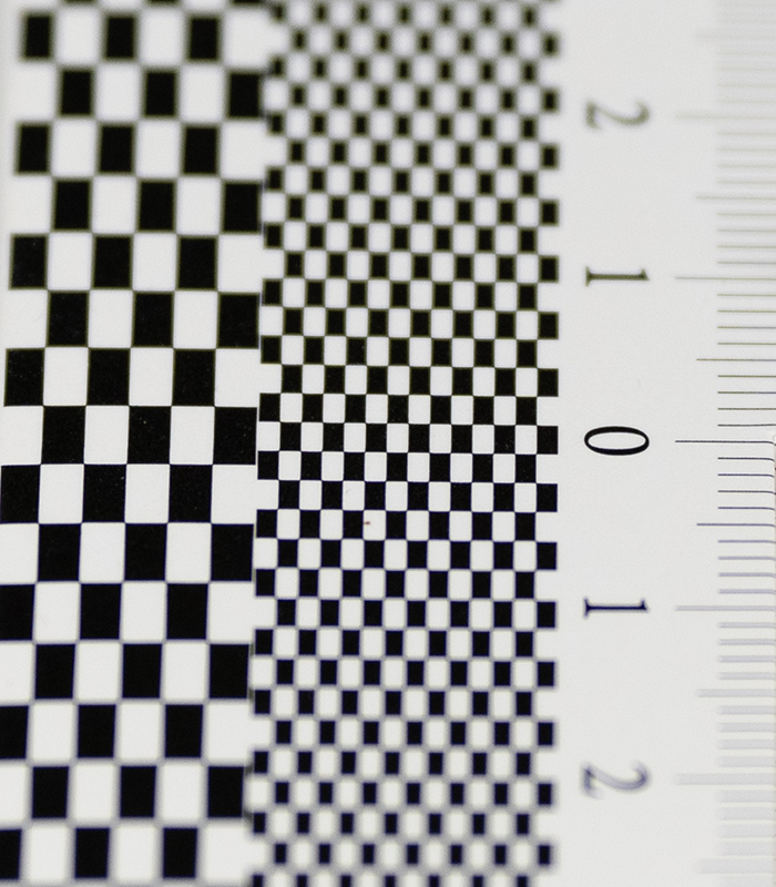

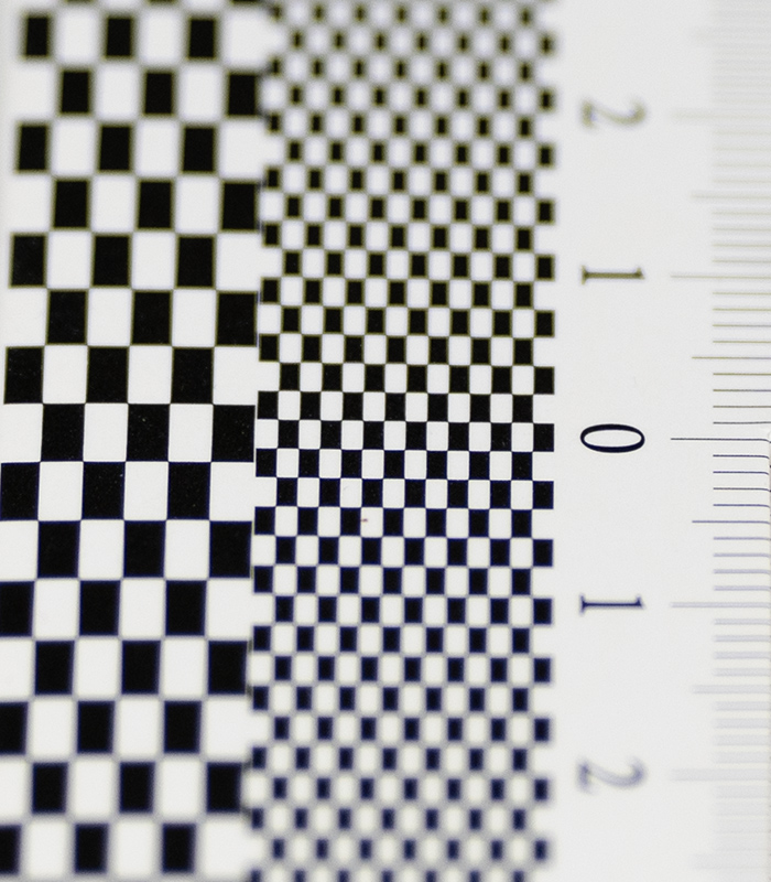

    As you can see below, the Viltrox lens shows some color fringing at f/1.8 with a bit of a greenish tint beyond the focus point. There’s barely any tint in front of the focus point, though. Stopping down to f/2.8 reduces the fringing, and it’s mostly gone from f/4.
    You may also notice that the focus point shifts very slightly to the rear when stopping down. However, this has no practical relevance in this case.
    f/1.8f/2.2f/2.8f/4f/5.6
