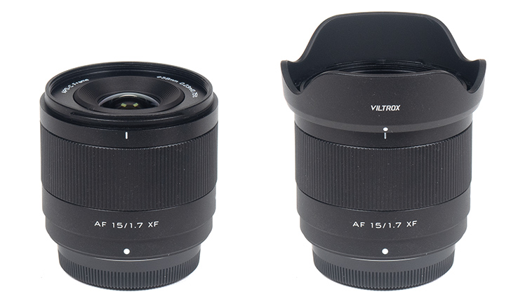

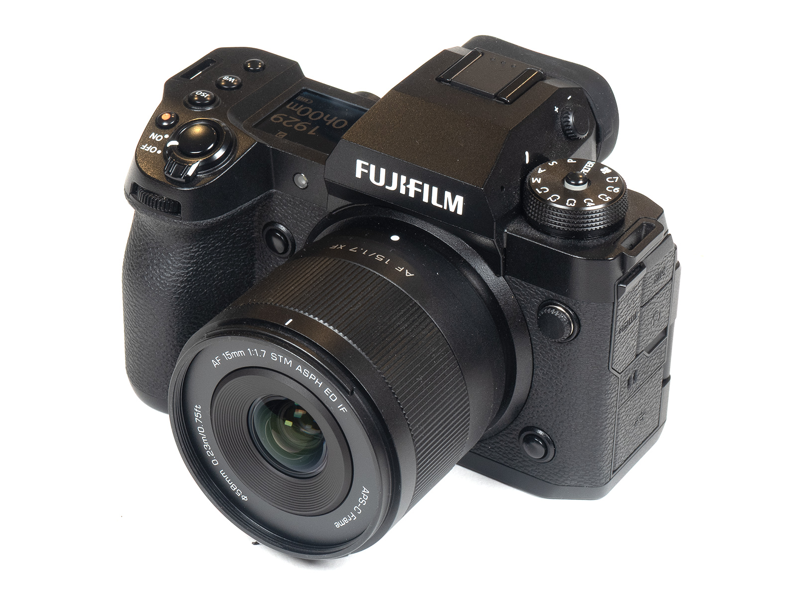

    The newest kid in Viltrox’s ever-growing list of prime lenses is the AF 15mm f/1.7 Air XF – an APS-C format wide-angle lens equivalent to roughly “23mm f/2.6” (full format). It’s a quite attractive focal length with applications such as landscape, architecture, or street photography. It is available in E-, Z-, and X-mount for 239 USD / 269 EUR / 229 GBP / 335 CAD / 39,000 JPY, which is very affordable compared to OEM standards. We’ll discuss the X-mount version in this review.
    The 15mm f/1.7 is a member of the “Air” lineup which is about delivering affordable lenses with a small form factor. Despite the lightweight, the build quality is pretty decent, with the lens body made of good-quality engineering plastics based on a metal mount. The broad (plastic) focus ring turns smoothly. A petal-shaped lens hood is supplied. There are no buttons on the lens. Thus, you have to switch the AF on/off via the camera menu. Weather-sealing is not provided which is not overly surprising given the price point.
    You won’t really need lightspeed AF on such a wide lens, but the STM (stepping motor) is both pretty snappy as well as silent. Firmware updates are possible via a USB-C port on the mount.
    Optical construction12 elements in 10 groups, incl. 2x aspherical, 3x ED, 3x HR
    min. focus distance0.23m (max. magnification 0.1x)
    DimensionsØ 65 x 56.7m
    Weight180g
    Filter sizeØ 58mm
    Available MountsSony FE, Fujifilm X, Nikon Z
    Other featuresUSB-C port for firmware updates

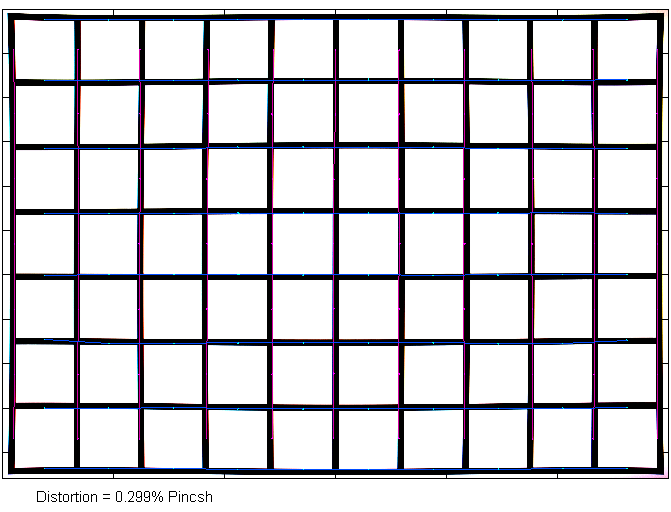

    So far, Viltrox doesn’t provide an auto-correction profile for image distortions in their “Air” lenses, so you will have to live with the original optical correction. Technically, the image distortions are very low at just 0.3%. However, the distortion characteristic is wavy, which may be noticeable in critical scenes at least.

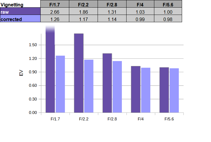

    The Viltrox lens is very compact given its maximum aperture settings, and it shows in the vignetting results. At f/1.7, the raw vignetting is very high for an APS-C lens. The light falloff is still higher than our usual APS-C scale at f/2.2 and doesn’t drop below the 1 EV mark even at f/5.6.
    Auto-correction does tame the vignetting at large aperture settings, less so at medium apertures.

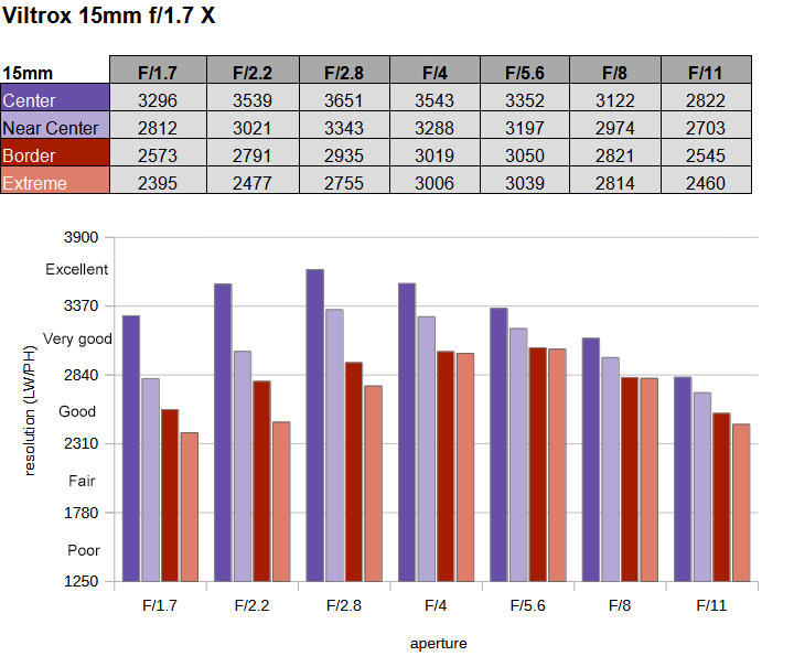

    The Viltrox AF 15mm f/1.7 Air XF produced pretty good results for such a wide and fast prime lens. At f/1.7, the center quality is already up there, although there is a fairly steep drop in quality towards the corners. Even so, the corners are only slightly soft, though. Stopping down to f/2.8 boosts the border center as well as the corners. The technically best results are achieved around the f/4 mark where the outer image field reaches very good levels. Diffraction effects set in beyond, and you shouldn’t use f/11 unless you really need the depth-of-field.
    The centering quality of the tested sample wasn’t great with a tilted focus plane making it tough to come up with a statement about the field curvature.

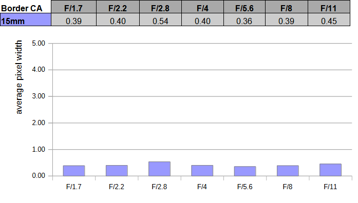

    Lateral CAs are low, with a peak CA pixel width of around ~0.4px at the image borders.

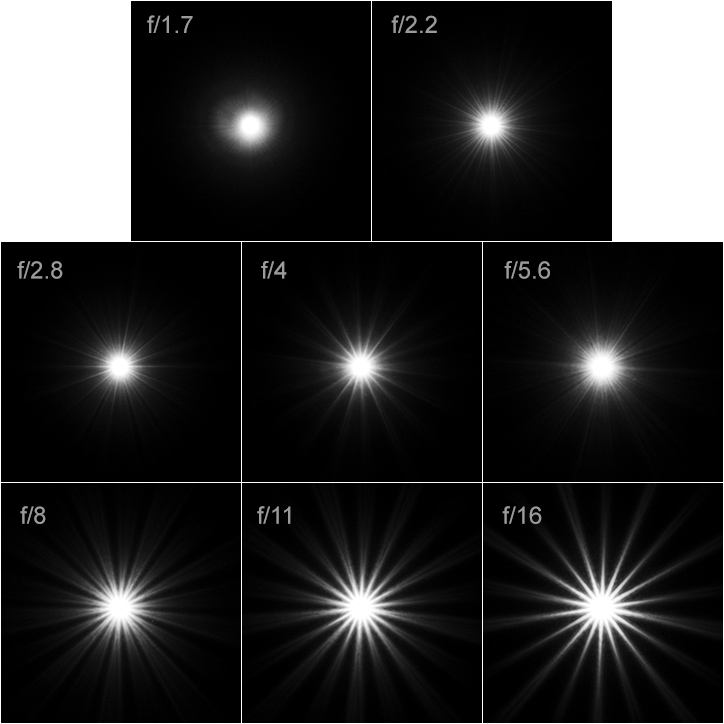

    Sun Stars
    Below is a sequence of 100% cropped images from f/1.7 all the way up to f/16, illustrating the sun star behavior. Sun stars are an aperture effect that shows up if a bright light source is part of the scene (usually in night shots). Due to the circular aperture shape, the sun stars are non-existent at f/1.7. Beyond, they slowly fade in (with a strange “drop” at f/5.6) and they are getting more obvious at f/8. At f/8 and f/11, the rays are “fan-like” which most won’t consider as overly attractive. The rays are becoming pointy at f/16, though.

    The build quality follows the tradition of the other Viltrox Air lenses. The engineering plastics are of good quality, and everything is tightly assembled. While it doesn't have any kind of weather sealing, the internal focusing mechanism should provide at least a bit of protection against dust. The AF uses an older-style STM motor. However, it's still pretty fast and essentially silent.
