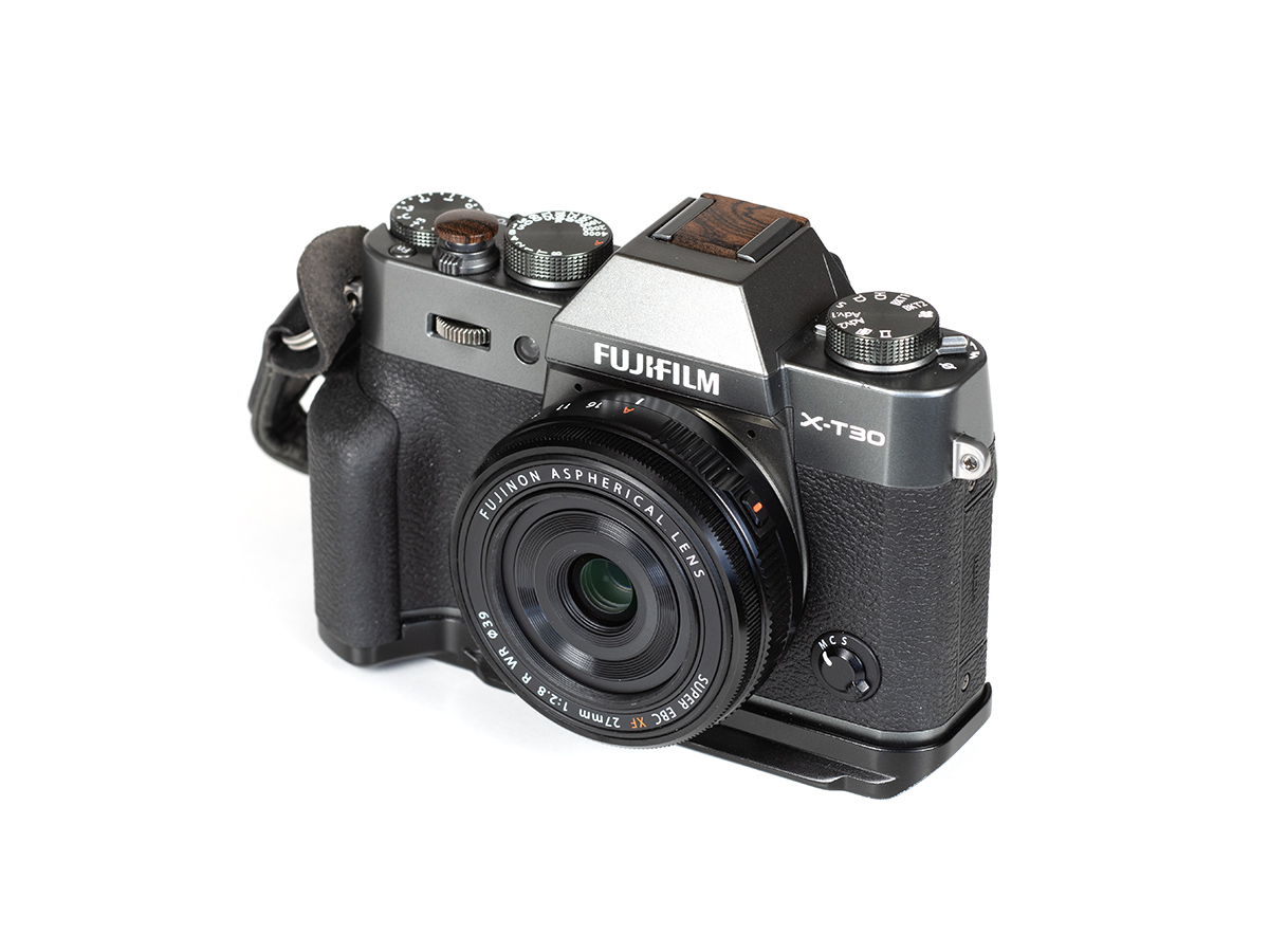

    The Fujinon XF 27mm f/2.8 R WR is an older design “recently” enhanced with weather-resistance (hence the WR) to keep the lens relevant. This is certainly a smart move because such pancake lenses are often used for street photography where weather can play a role. The field-of-view is equivalent to 41mm on full-format cameras, so it’s basically a standard prime lens. It retails for $449 USD, so while not cheap, it doesn’t cost a fortune.

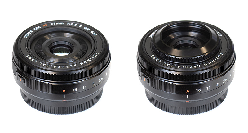

    Fujifilm knows how to produce lenses with a pleasant build quality, and that’s also the case here. While obviously small and extremely lightweight at just 84g, the 27mm f/2.8 R WR feels solid. Fujifilm even managed to incorporate a small aperture and focus ring. The inner lens tube extends a little during focusing operations. A tiny, dome-shaped lens hood is included.
    The aspect that hasn’t been updated is the old DC AF motor. The motor is certainly not overly stressed by the tiny optical system. However, the linear extension system doesn’t make autofocusing particularly fast, and the DC motor is a bit noisy. There’s also some focus breathing, which is not ideal for videos.

    Hooddome-shaped, included

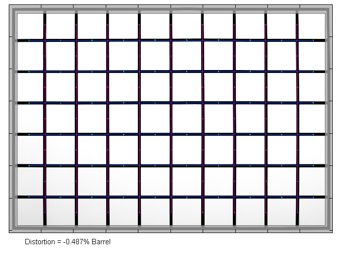

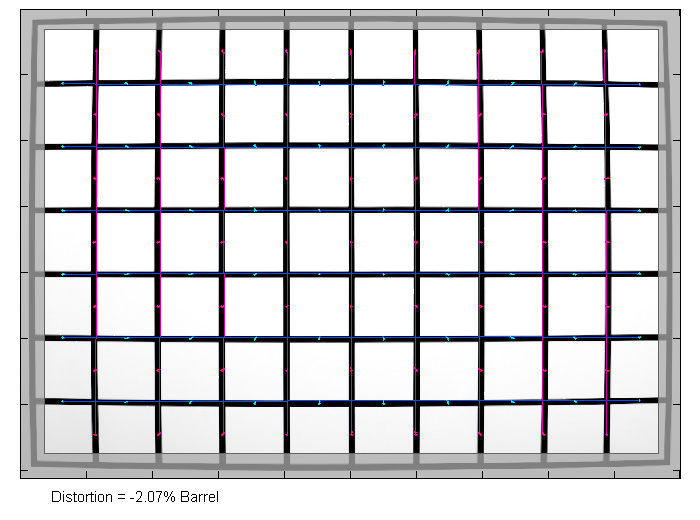

    You may think that minimizing the optical system for a pancake lens results in crazy image distortions, but this is actually not the case. RAW images show a medium barrel distortion of just 2% which is almost unusually low these days. Autocorrection reduces this to a slight 0.5%. This isn’t really noticeable anymore.
    CorrectedRAW

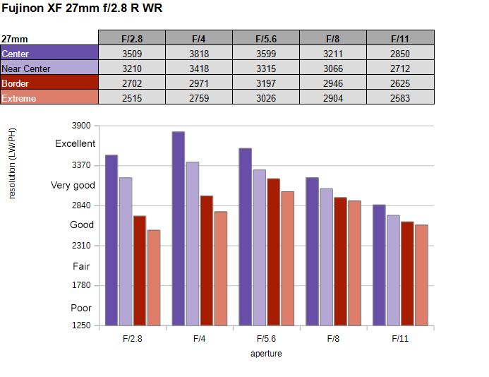

    The broader center is very sharp at f/2.8. There is a drop towards the borders/corners which still manage good quality here. However, in the real-world field curvature can soften the corners. The center quality peaks at f/4 although the best overall resolution is achieved at f/5.6 where the outer image field is very good. Diffraction impacts the results from f/8. f/11 sees some more visible softness.
