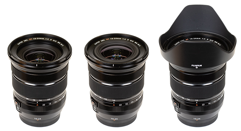

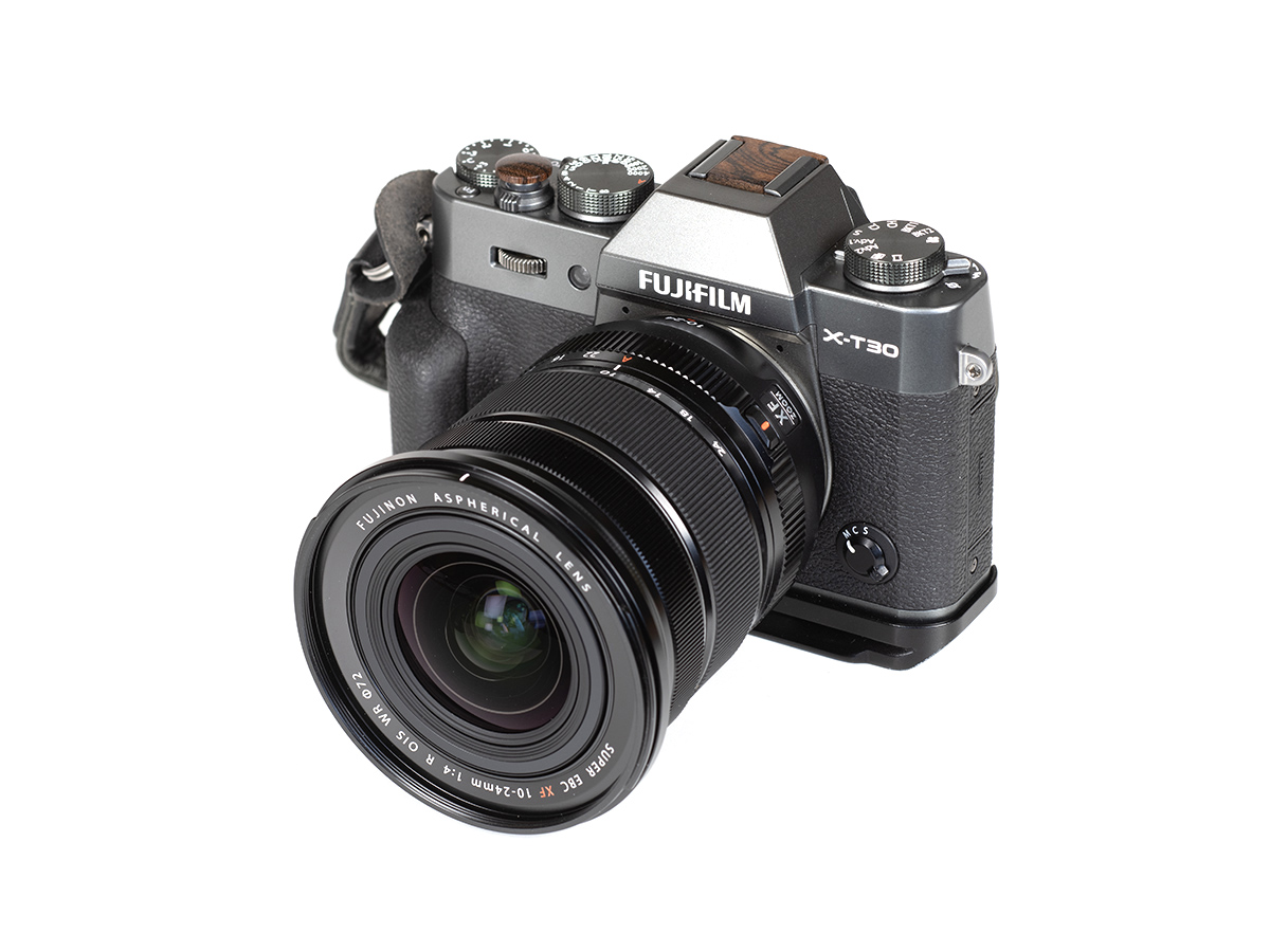

    The lens body is mostly made of metal. The broad zoom and focus control rings are rubberized and turn smoothly. The physical length remains constant regardless of the zoom or focus action although the inner zoom barrel moves a little bit – see the product images below. Typical for all Fujinon lenses, there’s a dedicated aperture ring with distinctive clicks. The aperture steps are now marked compared to the initial version of the lens. There’s also a new aperture lock switch now. The optical image stabilizer can be activated on the lens as well Unlike the XF 8-16mm f/2.8 it also accepts front filters. A large plastic lens hood is also part of the package.
    The lens features an older-style AF motor. It’s still pretty fast because ultra-wide lenses don’t really require a lot of shifting of the focus group for focusing. It’s also fairly quiet.
    The image stabilizer (OIS) is only rated at just 3.5 f-stops which isn’t all that much by today’s standards. However, most Fujifilm cameras have an IBIS these days and with sync IS (combining the two IS systems), Fujifilm claims a gain of up to 6.5 f-stops. This is actually quite impressive, although you should handle such statements with a grain of salt in the real world if you are coffee-addicted.

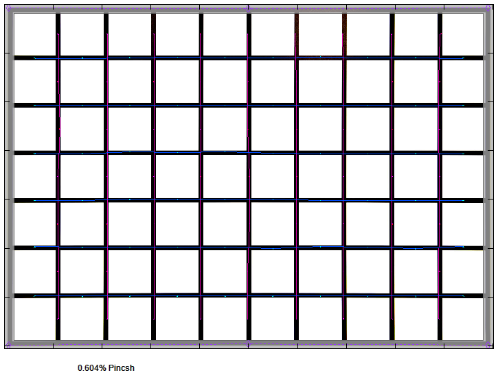

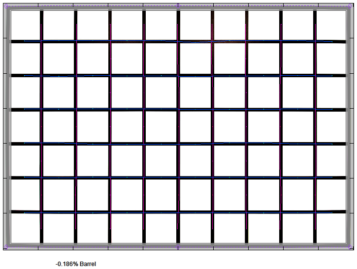

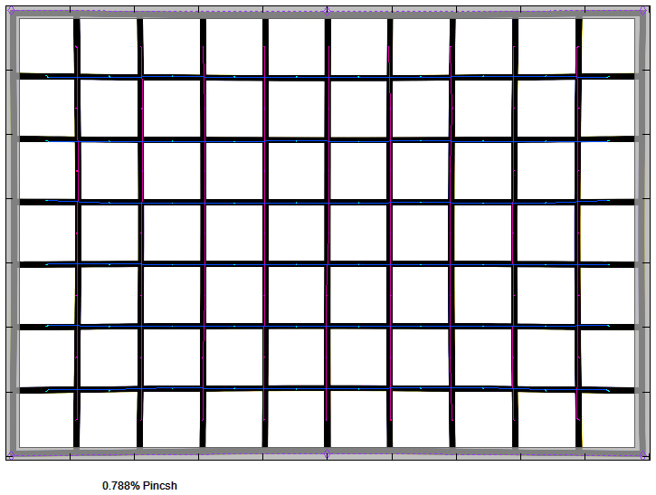

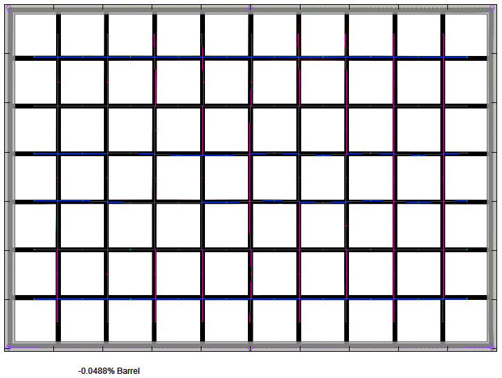

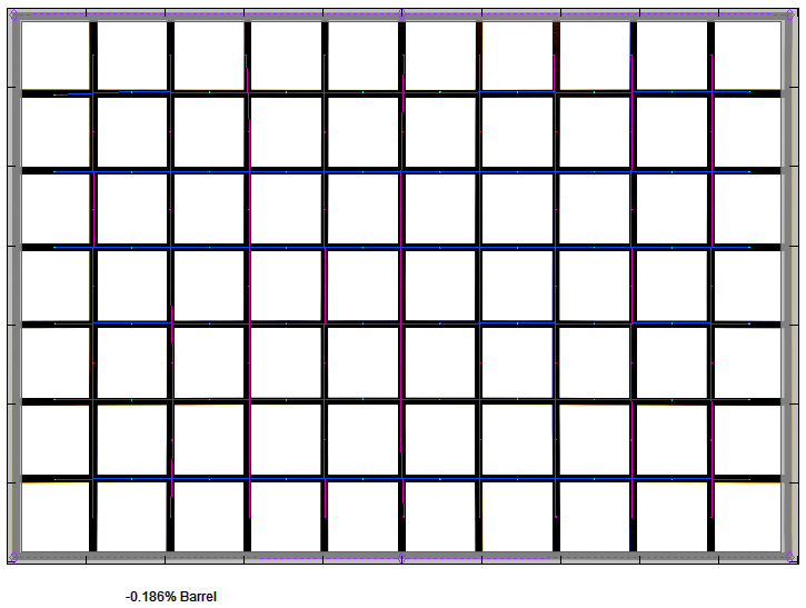

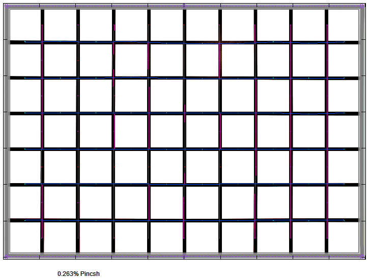

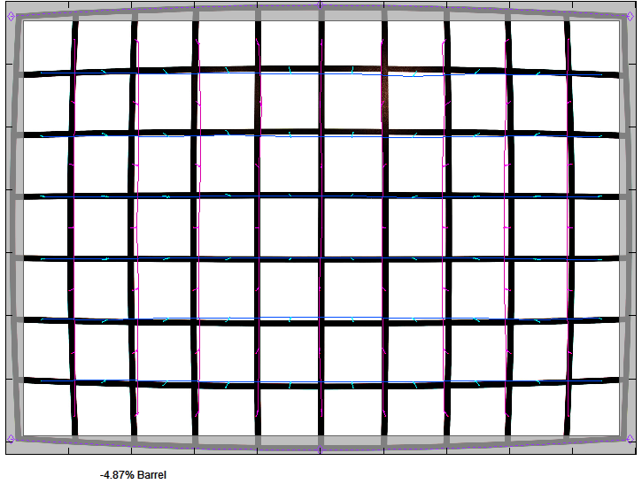

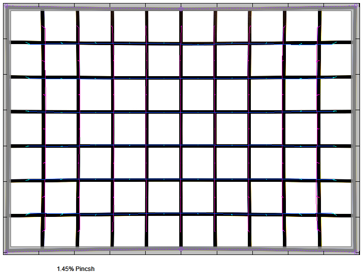

    Fujifilm relies on heavy autocorrection in most of their lenses and that’s also visible in the RAW files of the Fujinon XF 10-24mm f/4 R OIS WR. At 10mm, we can clearly spot a very heavy barrel distortion of almost 5%. However, this eases rapidly with a negligible distortion at 14mm. Beyond, there are increasing pincushion distortions that reach a medium level at the long end.
    10mm14mm18mm24mm
    Of course, this is different with activated autocorrection which helps to reduce the issue to a mostly negligible degree.
    10mm14mm18mm24mm

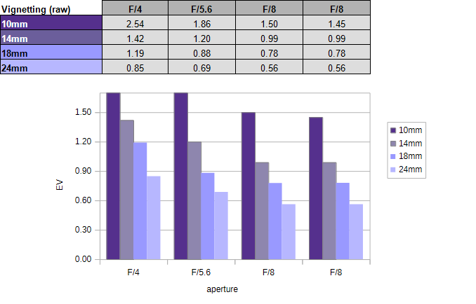

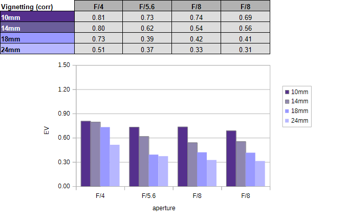

    As with most ultra-wide lenses vignetting is an issue in RAW files and it’s worst at the wide end of the zoom range. At 10mm f/4 the light falloff reaches a whopping 2.5 EV (f-stops) which is way beyond our scale for APS-C lenses (although this is rather normal for full-format lenses). Stopping down helps a bit but there’s still some noticeable vignetting even at f/8. As usual, this eases the more you zoom out. The vignetting is still high at 14mm and at 18mm @ f/4 but it’s well controlled at the 24mm setting.
    Autocorrection has to come to the rescue, of course. It fixes most of the issue with only some moderate vignetting between 10mm and 14mm. Keep in mind that this isn’t lossless. Vignetting correction increases the corner noise and decreases the dynamic range in the image corners due to the signal amplification.

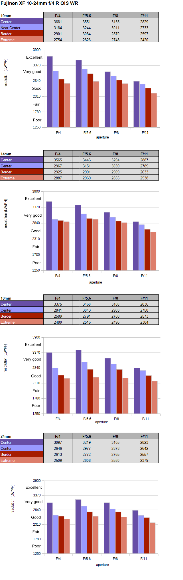

    The resolution characteristic of the Fujinon XF 10-24mm f/4 R OIS WR remains solid although it doesn’t stand out. At 10mm, the dead center quality is great. The near-center quality is very good followed by good to very good borders/corners. However, there is some more softness creeping in at the last pixels beyond our corner test spot. Stopping down to f/5.6 increases the overall quality a bit. Diffraction effects set in beyond already. The sweet spot is around the 14mm. The quality is reduced at 18mm and 24mm with the center quality falling to very good results. The corners still reach good quality.
    The centering quality of the XF 10-24mm f/4 was mediocre – unfortunately that’s a not-so-seldom issue with Fujifilm lenses. As such it’s also difficult to judge the field curvature.

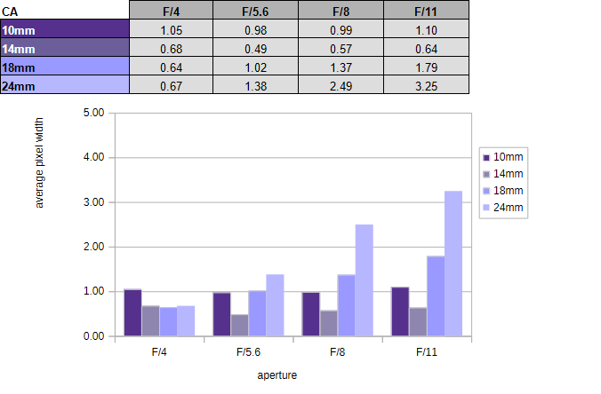

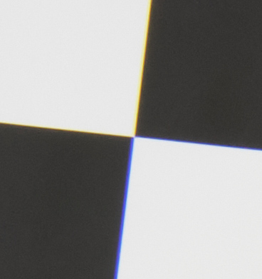

    Lateral CAs are an interesting topic with this lens. They are fairly moderate at the wide end. However, at 18mm and more so 24mm, they rapidly increase the more you stop down. At 24mm f/11 we measured a whopping CA pixel width of more than 3px at the image borders. However, keep in mind that you shouldn’t really stop down this much due to diffraction and autocorrection will reduce this issue anyway.
    The corner CAs look like this here at 24mm f/11:

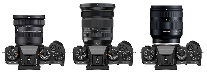

    Compared to the old days, the Fujinons aren’t competing alone for your bucks anymore. There is, for instance, the Sigma 10-18mm f/2.8 DC DN Contemporary (to the left below) – and it beats the XF 10-24mm f/4 (center) in most aspects while also being smaller, faster and cheaper. The same goes for the Tamron 11-20mm f/2.8 Di III-A RXD (to the right).
