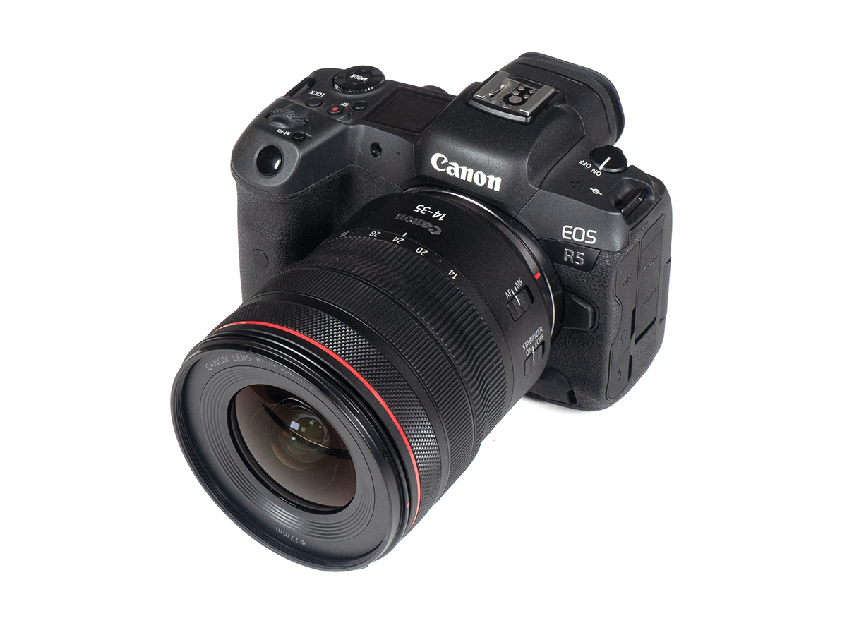

    The Canon RF 14-35mm f/4 L IS USM is one of four (!) Canon ultra-wide zoom offerings in the RF mount lens lineup, positioned as a more compact and affordable alternative to the flagship RF 15-35mm f/2.8 L IS USM. With a retail price of approximately $1500/ €1500, it’s a premium mid-tier offering in Canon’s L-series range.

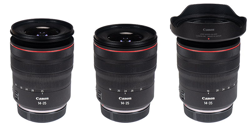

    Mechanically, it follows the tradition of most other Canon RF lenses. The lens body is made of high-quality engineering plastics based on a metal mount. The zoom and focus rings are rubberized and turn smoothly. It is also weather-sealed for more demanding outdoor shooting situations. Canon has also included a customizable control ring that allows photographers to adjust settings like ISO or aperture directly from the lens. The RF 14-35mm f/4 L uses an internal (rear-)focusing mechanism, but no internal zooming. It extends slightly by about a centimeter towards the extreme ends of the zoom range, and it is shortest around the 23mm focal length mark. Where the RF 14-35mm f/4 L distinguishes itself is in its physical footprint. Thanks to its moderate max. aperture of f/4, it is notably more compact than the Canon RF 15-35 f/2.8 L. A small, petal-shaped lens hood is part of the package.
    Unlike Canon’s consumer-grade lenses, the RF 14-35mm L uses a Nano USM (Ultrasonic Motor) autofocusing system. While fast focusing is usually not needed in this lens class, it’s certainly a welcome choice here.
    Manual focusing works, as usual, “by-wire”. It’s also worth noting the minimum focus distance of just 0.2m (max object magnification 1:2.63) is unusually close.
    Officially, the optical image stabilizer has an efficiency of up to 5.5 f-stops and up to 7 f-stops when combined with the camera’s in-body stabilization system. As usual, you shouldn’t expect this to be achievable in the real world, but it comes close.

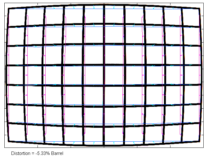

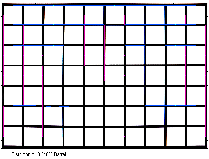

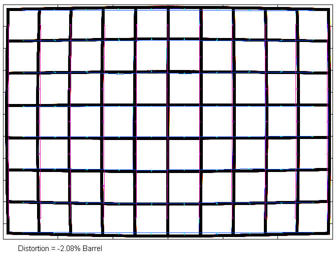

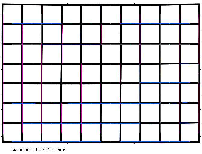

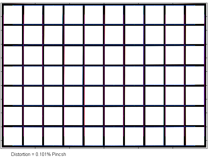

    Most modern ultra-wide zoom lenses rely heavily on digital autocorrection, and the RF 14-35mm f/4 L USM IS is no different. RAW images reveal a very heavy barrel distortion of ~5.3%. The barrel distortion decreases the more you zoom in. It’s actually already acceptable at 18mm (2%) and it’s negligible from the mid-range up to 35mm.
    14mm18mm24mm35mm

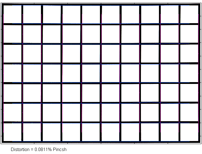

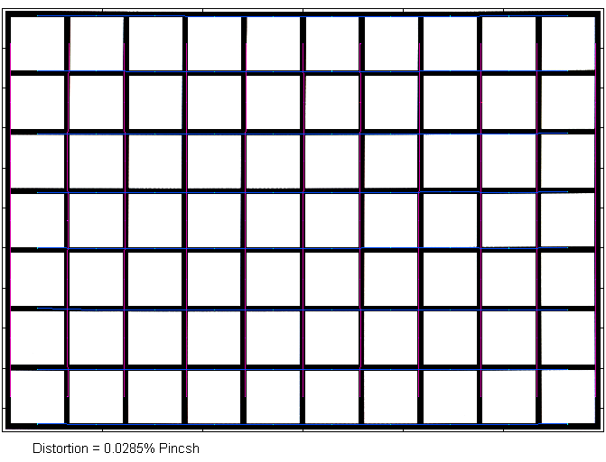

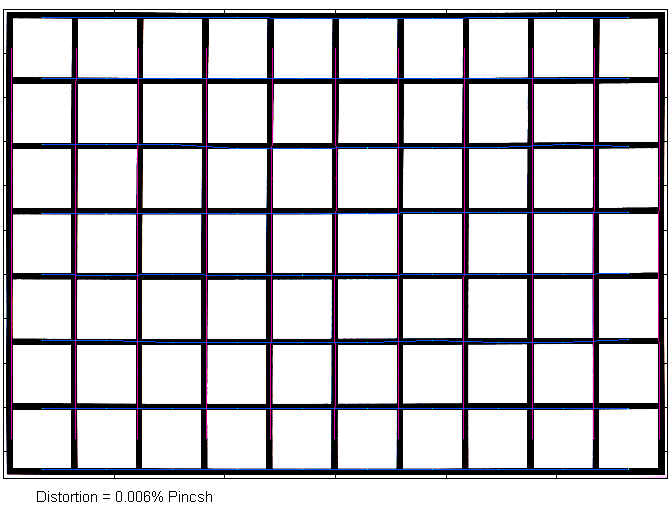

    With activated autocorrection, the image distortions are perfectly eliminated:
    14mm18mm24mm35mm

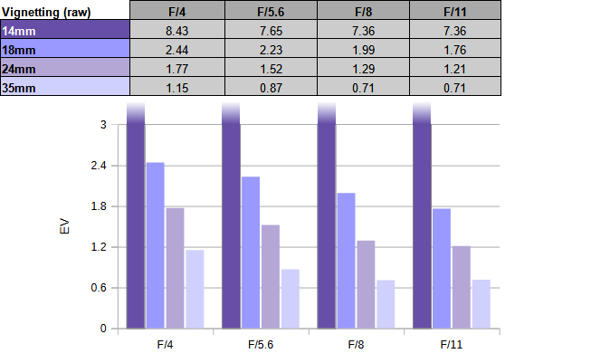

    The vignetting figures also indicate that the RF 14-35mm f/4 L isn’t meant to be used without distortion correction. In RAW images, the vignetting is excessive at 14mm, and stopping down to f/11 doesn’t make a difference. The light falloff is high at 18mm, but not out of the ordinary for an ultra-wide-angle lens. The vignetting is still visible at 24mm, and it’s well controlled at 35mm.
    With both vignetting AND distortion autocorrection active, the situation eases significantly. There’s still a visible vignetting at 14mm at f/4, but it’s not disturbingly high. Other than at this setting, the vignetting isn’t really an issue anymore.

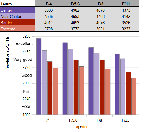

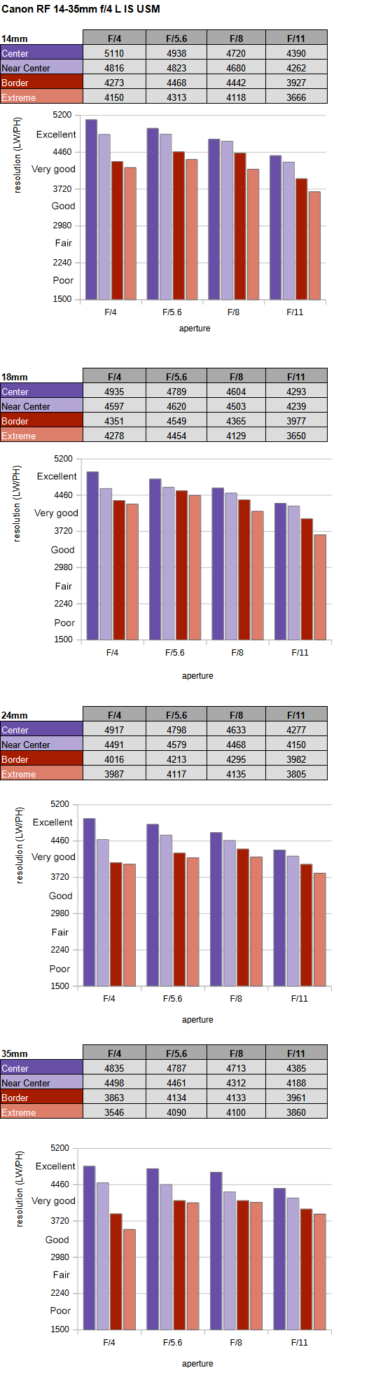

    The Canon RF 14-35mm f/4 L USM IS delivered highly impressive resolution figures in the lab. The broader image center is generally excellent. The outer image field is very good, except at 35mm where the corner resolution drops to good levels at f/4. Stopping down to f/5.6 recovers the resolution here as well. As usual, diffraction effects set in at f/11, and f/16 should be avoided unless really needed.
    The centering quality of the tested sample was good. The field curvature is low for such a lens.

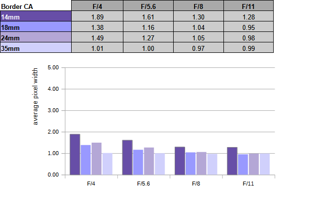

    Lateral CAs are moderately high with an expected peak at 14 mm, where they reach an average CA pixel width of up to 1.9px at f/4 at the image borders. The CAs decrease the more you zoom out and stop down.
    A good RAW converter should handle CAs with ease, though.

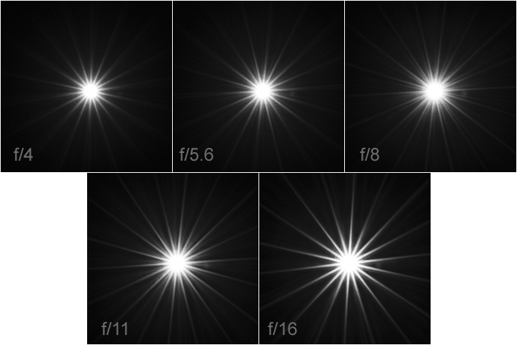

    Sun-Stars
    Sun stars (diffraction spikes) are an aperture effect that occurs at strong light sources – such as streetlamps in nighttime city scenes.
    The Canon RF 14-35mm f/4 L USM IS has an unusual characteristic in that sunstars are already present at f/4. The aperture is typically perfectly circular at max aperture, but this doesn’t seem to be the case here. Furthermore, the spikes are already surprisingly defined at f/4. However, the effect is still best at f/11 and f/16.
    It’s worth noting that Canon doesn’t list rounded aperture blades with this lens, so the “early” sunstars may have been a design choice (and there’s nothing wrong with this).

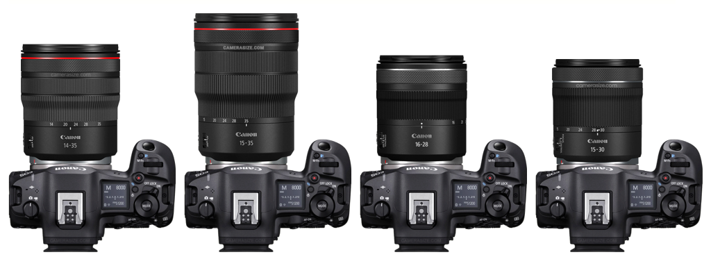

    Full-format Canon users are confined to native Canon RF. However, there are still no less than 4 zoom lenses to choose from. Besides the RF 14-35mm f/4 L USM IS (far-left below), there’s the already mentioned RF 15-35mm f/2.8 L USM IS (2nd left), the RF 16-28mm f/2.8 STM IS (2nd from the right), and the RF 15-30mm f/4.5-6.3 STM IS. The latter is certainly the outlier in this group because it’s made to a budget and sold for around $500. We haven’t tested it, but it doesn’t seem overly impressive based on other reports. This is different with the RF 16-28mm. If it HAS to be an f/2.8 lens, it’s certainly an interesting choice. However, its retractable zoom design may not be to everybody’s taste. We haven’t tested this lens yet. Based on the more serious sources out there, it appears to be pretty good, so if you don’t insist on the L badge, it could be worth a look, although it costs basically as much as the RF 14-35mm /f4 L. The RF 15-35mm f/2.8 L USM IS is faster, but based on our testing, it’s not really better.
