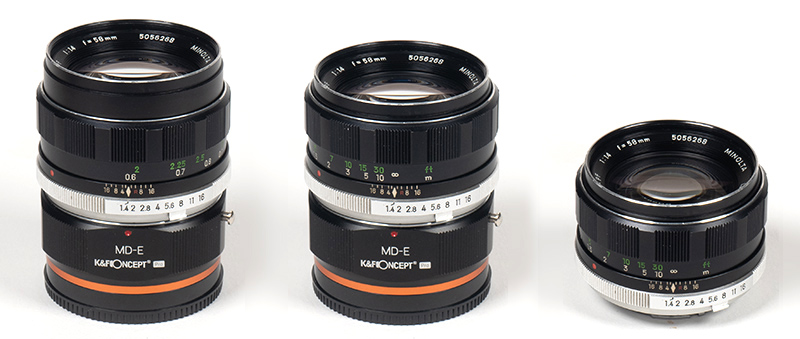

    There are two versions of the MC 58mm f/1.4. The tested sample is an “MC I” first released in 1966 with a flatter, more traditional metal knurled focus grip. This was followed by the MC II, released in 1969, which has a “hills and valleys” focus grip. Just like most other vintage lenses that we tested to date, you should be able to find used samples anywhere between $80 and $150 USD. Minolta MD adapters to mirrorless camera mount can be easily found on eBay.

    Optical construction6 elements in 5 groups
    Number of aperture blades6
    min. focus distance0.6m (max. object magnification ?)
    Dimensions65 x 42mm
    Weight275g
    Filter size55mm

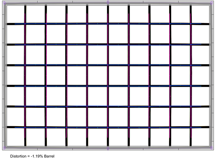

    Back in the day, there was, of course, no image auto-correction; thus, designers had to optimize the real thing. The 58mm f/1.4 shows just a bit of barrel distortion. At just 1.2%, it can usually be ignored, though.

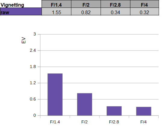

    The vignetting is moderate for a fast prime lens. The light falloff peaks at ~1.5EV (f-stops) at f/1.4. Stopping down to f/2 cuts this almost by half, and it’s negligible from f/2.8 onward.

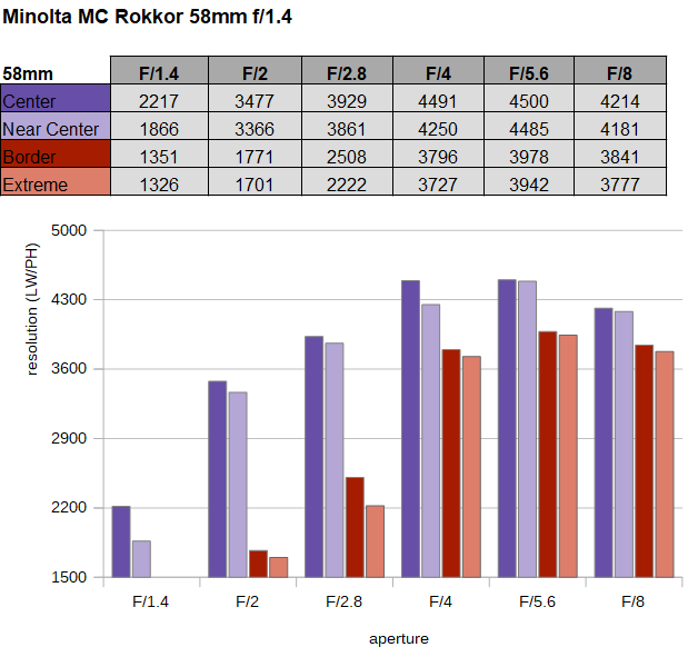

    MTF (@ 42mp on Sony Full Format)
    Released 60 years ago at the time of this review, it was an era before UD elements and aspherical elements just started to emerge but only in high-end lenses. Thus, if you are after a sharp, cheap vintage lens, this isn’t one of them. At f/1.4, it is about as “dreamy” (aka blurry) as it gets. If that’s the effect that you are after, this isn’t a bad thing, though. Stopping down to f/2 results in a dramatic image quality improvement already. The broader center is almost very good, although there isn’t much in it in the outer image field. f/2.8 improves this further, but the real deal starts from f/4, where this old lady is almost comparable to modern lenses across the image field.

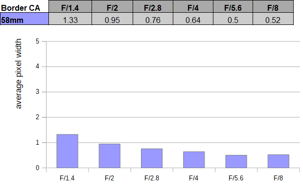

    Lateral CAs aren’t too bad. They are somewhat noticeable at f/1.4 with an average pixel width of 1.3px at the image borders. The CAs decrease the more you stop down, and they are irrelevant from f/4-ish.

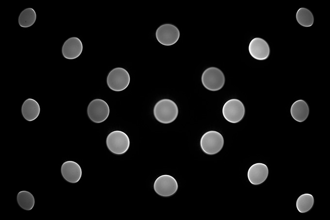

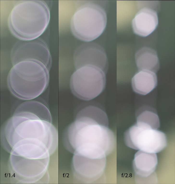

    You can already see below that the highlight rendering at f/1.4 is “special” – to be precise, it’s very bubbly with a rather extreme outlining of the highlight discs. The outlining is gone at f/2, although the edgy aperture is creeping in here already. And it’s more so at f/2.8.
    The bubble bokeh at f/1.4 is also very obvious beyond the image center as you can see below. The highlight discs deteriorate towards the corners without getting too edgy, though. As usual, stopping down restores some of the circular shape, but the bubbly magic is gone then.
    f/1.4f/2f/2.8

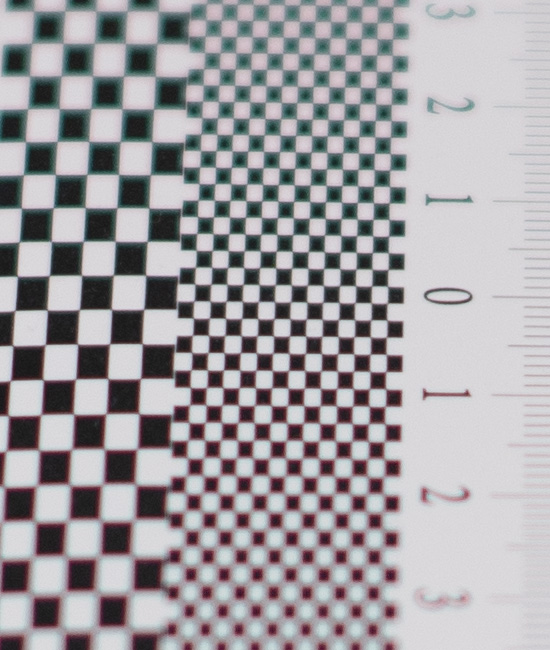

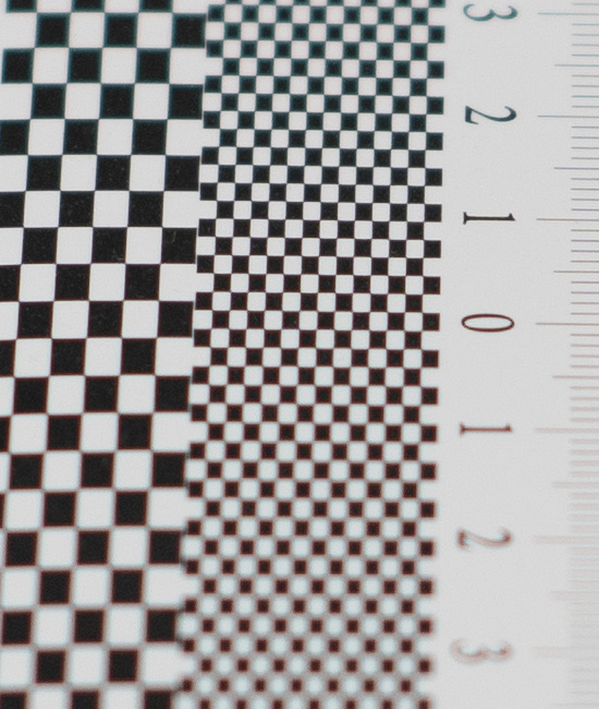

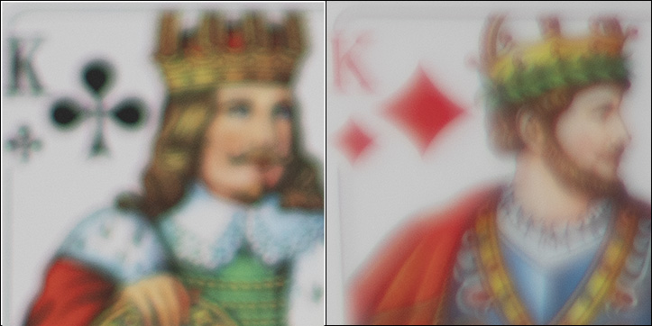

    The quality of the general blur in the focus transition zone is a bit of a mixed bag at maximum aperture. As you will immediately notice, the rendering is very washed out and hazy – especially in the foreground (the right crop below). The background blur (to the left) is very smooth, though.
    Boheh fringing/LoCA is an axial color fringing effect with purplish halos in front of the focus point and greenish beyond.

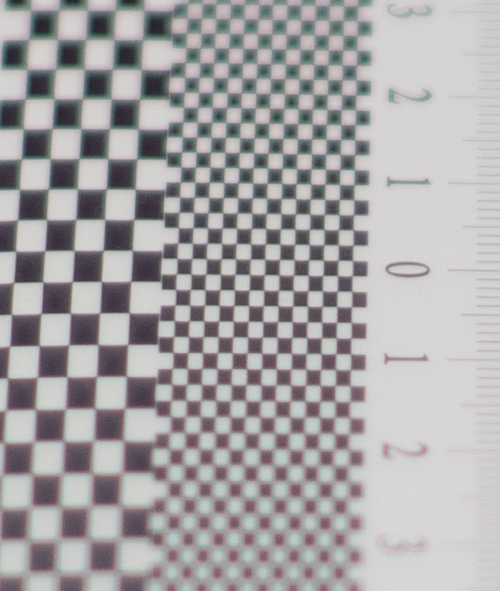

    Given the simple designs of this era, it’s hardly surprising that there’s LOTS of color fringing happening at f/1.4. You may also notice the very low contrast. The contrast dramatically improves at f/2 and f/2.8 but the fringing is still very pronounced.
    You may also notice that the focus shifts towards the rear (“Residual spherical abberations”) but it’s not too bad. We can still see this flaw in many modern fast 50s today.
    f/1.4f/2f/2.8
