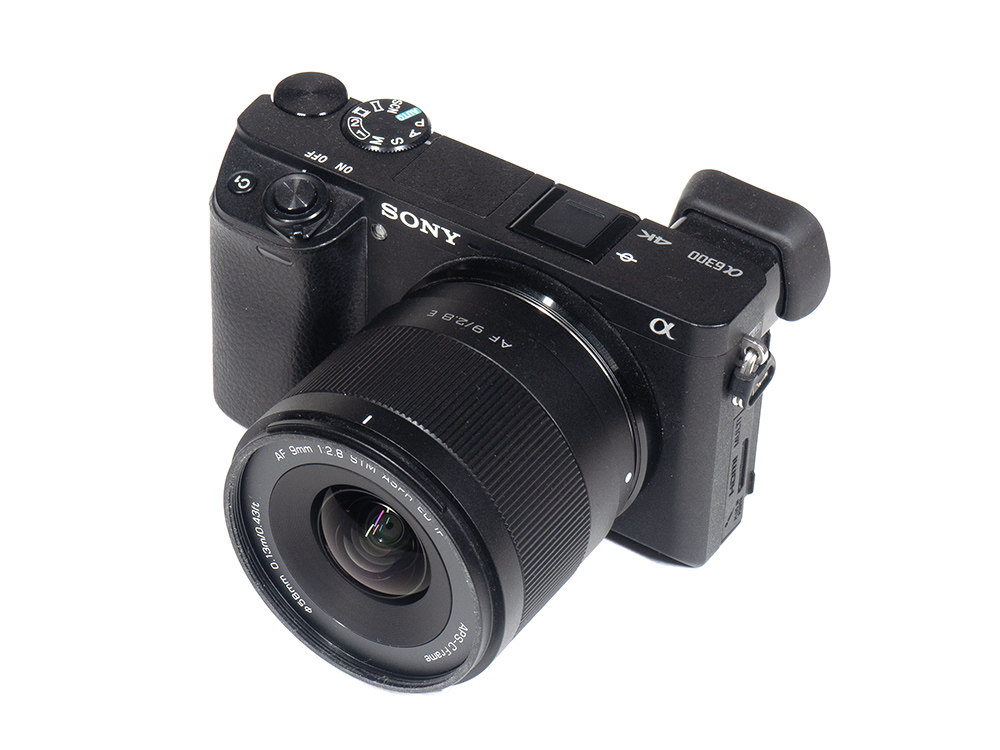

    It almost feels as if we are an exclusive Viltrox testing lab, given all the lenses that we have tested lately. And we aren’t even done yet for this year. This time it’s about the Viltrox AF 9mm f/2.8 E Air – an APC-format ultra-wide prime lens. That’s equivalent to about 14mm on full-format. The lens stays, of course, true to the cause of their “Air” lineup. Thus, it’s both very compact and very affordable at just $199 USD / 229 EUR / 190 GBP. The lens is available in E- (as reviewed here), Z-, and X-mount (at some point). So far, the low price tag didn’t have an impact on image quality, but ultra-wide lenses are difficult beasts, so let’s check whether their impressive run remains intact.

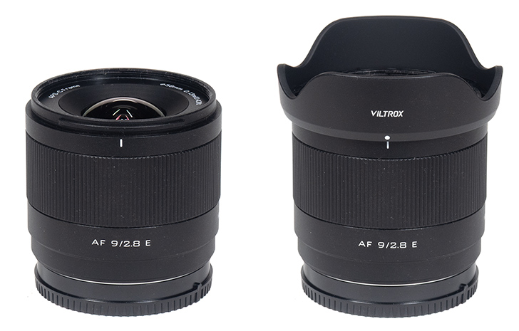

    The build quality remains in line with what we’ve seen of the “Air” lineup. Thus, it’s using good-quality, consumer-grade engineered plastics based on a metal mount. The focus ring turns smoothly. And a small petal-shaped lens hood is supplied. A USB-C port on the lens mount can be used for firmware updates.
    The AF uses a conventional STM (stepping motor), which is well sufficient for moving the small lens elements in a fast and silent manner. Manual focusing is very precise.
    Optical construction13 elements in 11 groups, incl. 3x ED, 3x HR, 2x aspherical
    Number of aperture blades7
    min. focus distance0.13m (max. magnification 0.15x)
    Dimensionsφ65 x 56.4 mm
    Weight175g
    Filter size58mm
    Available MountsSony E, Nikon Z, (X-mount)

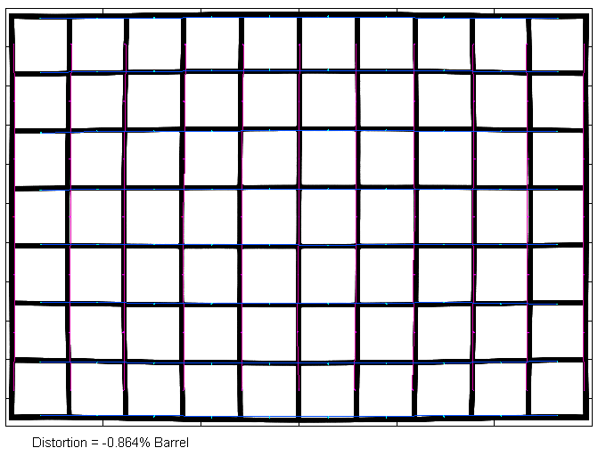

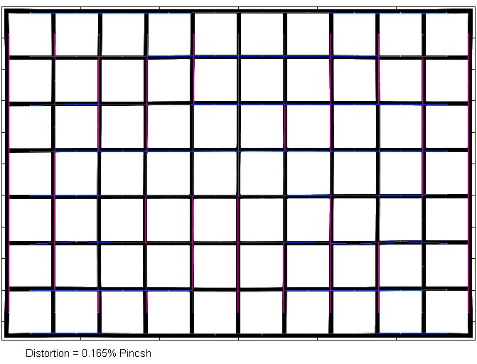

    Despite the petite size and the rather extreme focal length, Viltrox managed to keep image distortions well under control – which makes you wonder why the OEMs can’t do it. In RAW images, there’s only a mild barrel distortion of less than 1%. Auto-correction reduces this further, although it overshoots a little to pincushion distortions.
    RAWAuto-Corrected

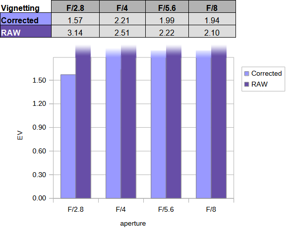

    The Viltrox AF 9mm f/2.8 E Air has one clear weakness – vignetting. A light falloff of 3 EV (f-stops) wouldn’t be unusual for similar lenses on full-format cameras. However, it’s a bit much in the APS-C scope, where the figures are exceeding our usual scale substantially here.
    Auto-correction doesn’t help too much, unfortunately. It cuts off 1.6 EV at f/2.8, but, strangely, we didn’t really see much of an effect from f/4. There’s certainly some room for improvement here for a firmware update.

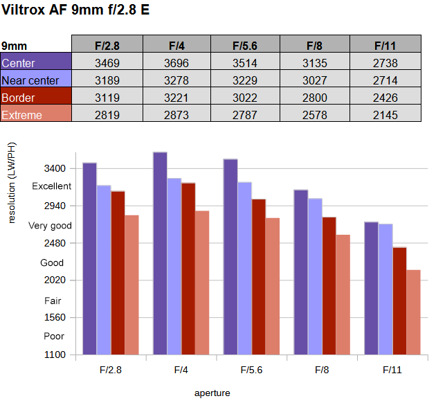

    The resolution characteristic of the Viltrox left us quite baffled. We can only describe it as tack sharp straight from f/2.8. Even the corners are easily very good. Stopping down to f/4 lifts the quality marginally, but the lens is pretty much diffraction limited. Don’t stop down beyond f/8 unless needed.
    The centering quality of the tested sample was good. The field curvature is fairly low.

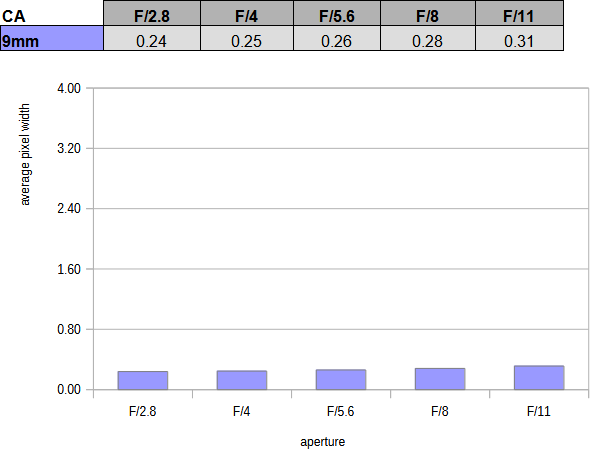

    Lateral CAs are low, with a peak CA pixel width of ~0.3px at the image borders, which is, once again, very impressive.

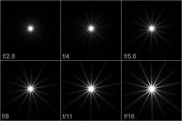

    Sun Stars
    Below is a sequence of 100% cropped images from f/2.8 all the way up to f/16 – illustrating the sun star behavior. Sun stars are an aperture effect that shows up if a bright light source is part of the scene (usually in night shots).
    The aperture shape is near circular at f/2.8, so there isn’t any sun star effect to speak of here. They start to appear at f/4 already, although you should stop down to f/8 if you are really after the effect. The rays are nicely pointy (rather than fan-like). The best results are, as usual, available at f/11 and, more so, at f/16 – although image softness will be an issue due to diffraction if you stop down this much.
