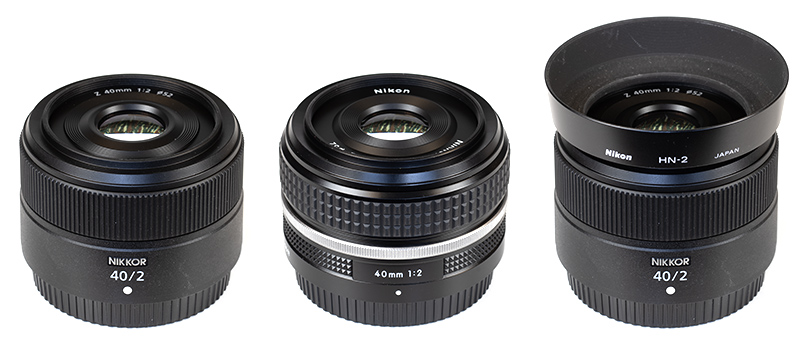

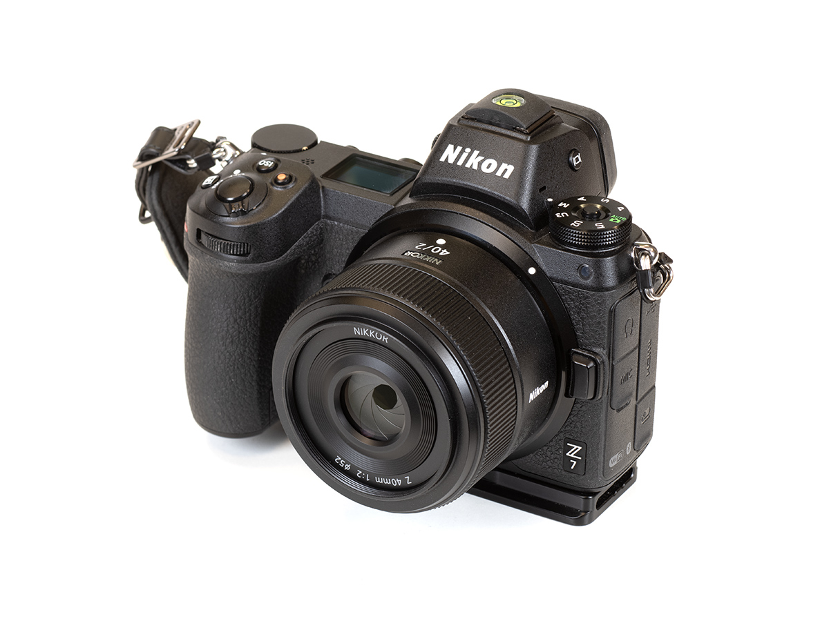

    The Nikkor Z 40mm f/2 is one of the budget prime lenses in Nikon’s lens lineup. It is actually available in two different flavors: with a modern-style look as shown below or as SE (“Special Edition”) which mimics the design philosophy of the “classic” Nikon era. The SE variant (shown in the center below) costs a little more at $260 USD compared to the standard version at $230 USD, but the difference is purely cosmetic. The optical system is the same. It’s a full-format lens and thus, a standard prime lens.
    The Nikkor has an all-plastic construction including the mount. It doesn’t feel overly premium but this cannot be expected at this price point. However, Nikon still managed to incorporate some degree of weather sealing. The Z 40mm f/2 is a simple thing. In terms of controls there’s just the control/focus ring. It lacks an AF/MF button. A lens hood is not included. The product image below shows the screw-in type HN-2, but Nikon doesn’t specify a dedicated lens hood.
    The lens uses a stepping motor (STM) for autofocusing. It works fairly quickly and quietly.

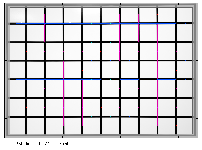

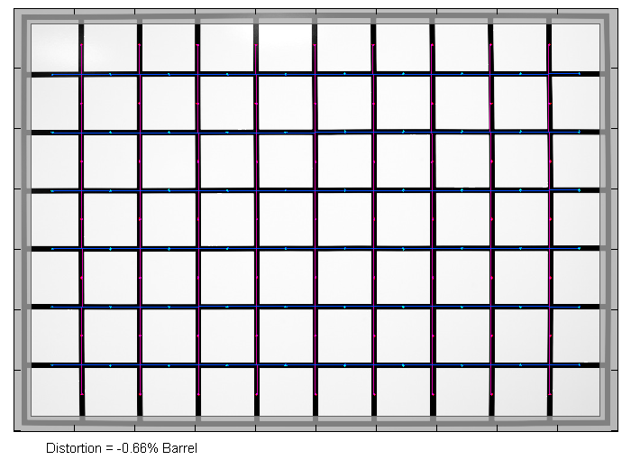

    The Nikkor Z 40mm f/2 produces only a marginal degree of barrel distortion in RAW images. Autocorrection can eliminate this completely.

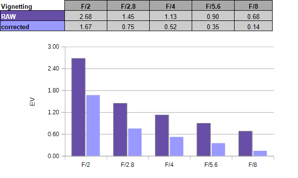

    The RAW vignetting is on the high side, reaching 2.7 EV (f-stops) at f/2. Stopping down to f/2.8 reduces this substantially by more than 1 EV (f-stop). The light falloff can still be visible at f/4 and f/5.6. Slight vignetting remains even at f/5.6. Activated autocorrection reduces the vignetting by 1 EV (f-stop) at maximum aperture and the issue is practically gone from f/4 onward.

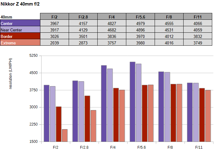

    The Nikkor Z 40mm f/2 disappoints a bit. At f/2, the broader center quality is very good (just) but the borders are only good and the corners are falling off the cliff. The contrast level is also reduced. Stopping down to f/2.8 improves this a bit, but for the best results you should stop down to f/4 or f/5.6. The center quality is excellent here and the outer image field reaches good to very good results. Diffraction limits the center quality at f/8 although the borders/corners are actually best here.

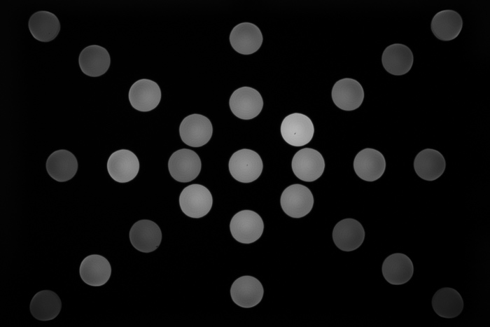

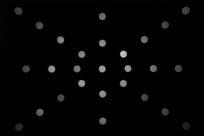

    A 40mm f/2 is quite fast and allows you to achieve a decently shallow depth-of-field in many situations. So let’s check the bokeh.

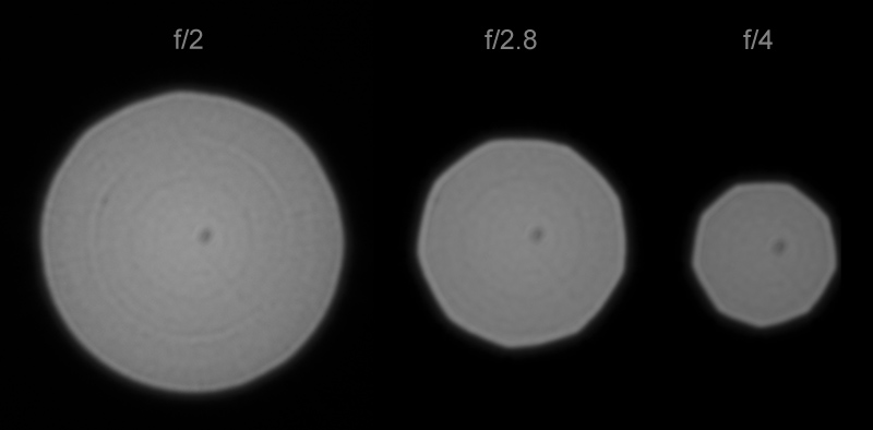

    Out-of-focus highlights show a slight onion-like substructure, probably thanks to the 2 aspherical elements in the design. The disc is mostly circular at f/2 but becomes very edgy at f/2.8 already … which contradicts Nikon’s statement that the 9 aperture blades are rounded. If so, they are only marginally rounded.
    Note: The dot is a dust spot.
    When looking at the whole image, the circular highlight shape is maintained across the image field at f/2 already. This is quite unusual and a welcome aspect here. However, the discs show some outling from the midfield. The outlining is gone from f/2.8.
    f/2f/2.8f/4

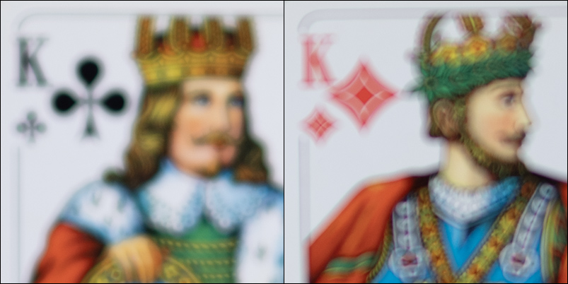

    The general blur in the focus transition zone is very smooth in the image background (shown to the left below). The less important foreground blur (to the right) is nervous with double-edged halos.

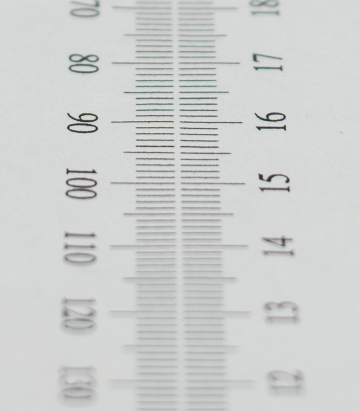

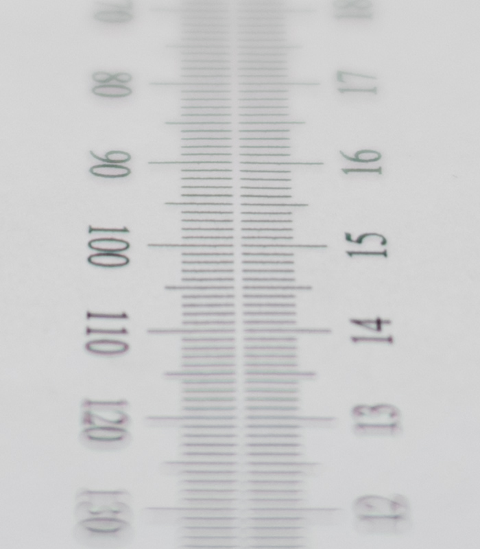

    Bokeh Fringing (LoCA)
    LoCAs (axial CAs) are a color-fringing effect on the Z-axis.  They show up as purplish/yellowish halos in front of the in-focus zone and greenish/bluish beyond.
    The Nikkor Z 40mm f/2 shows some fringing at f/2 (and it’s rather soft at the rather close focus setting we used below). As usual, this is reduced when stopping down with only traces remaining at f/4.
    When scrolling through the aperture range below, you may also notice some focus shift towards the rear (=RSA or Residual Spherical Aberration).
