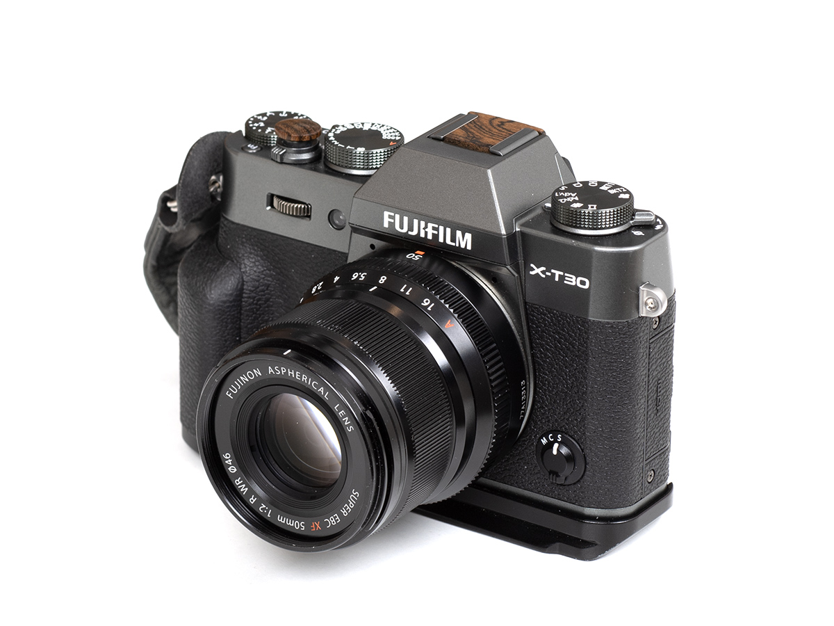

    The XF 50mm f/2 R WR is the third addition to the range of lenses sometimes referred to as “Fujicrons”: small and lightweight yet sturdy primes with a maximum aperture of f/2. The Fujinon offers a field of view that is roughly equivalent to a 75 mm lens on a full-frame camera, a focal length that is quite popular on traditional rangefinder cameras (read: Leica), so one group of potential customers Fuji is aiming for with the X-Pro series cameras.

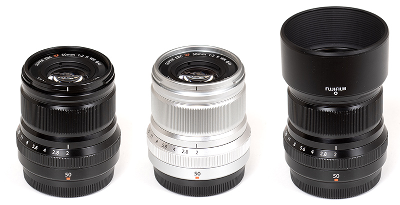

    Like its siblings, the 50mm lens shows a very high level of build quality. There’s a tightly assembled outer barrel made from metal, based on a metal mount. The very broad focus ring operates very smoothly. The lens has a dedicated aperture ring with very distinctive 1/3EV steps. It features a weather- and dust-resistant structure with seals and can also work in temperatures as low as -10°C. A quite long barrel-shaped hood is part of the package, but unfortunately (again) it’s made from fairly cheap-looking (and feeling) plastic and doesn’t quite match the otherwise high build-quality level of the lens. Just like the other “Fujicrons”, the lens is available in black or silver color options.
    The (inner) AF operates fast and essentially noiselessly. As usual for Fujinons, manual focusing works “by wire” thus by triggering the AF motor.

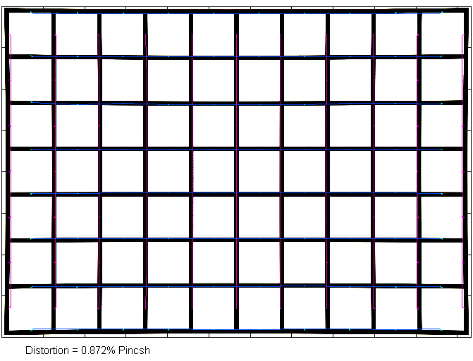

    For some of the Fujinon XF lenses (the XF 50 being one of them), Fuji automatically corrects distortion in JPGs. Most RAW converters do the same, but some (e.g. CaptureOne) allow switching iff this correction, thus showing the native distortion characteristic of the lens.
    Corrected, the lens shows around half a percent of pincushion distortion, which is basically insignificant in real-life. The native, uncorrected distortion is slightly more pronounced at around 1%, which is still an acceptable amount.

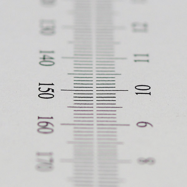

    The lens produced very high sharpness in the lab. It delivers excellent resolution in the image center straight from the maximum aperture. The borders and extreme corners are good to very good. Stopping down to f/4 increases the bite in the broader center and there’s a mild improvement in the outer image field as well. The latter reaches its peak at f/4. Diffraction limits the quality beyond f/5.6 although f/8 remains perfectly fine and f/11 is usable.
    The field curvature is low. The centering quality varies heavily. Markus tested several copies with slightly different results. The described results are the best of the bunch.

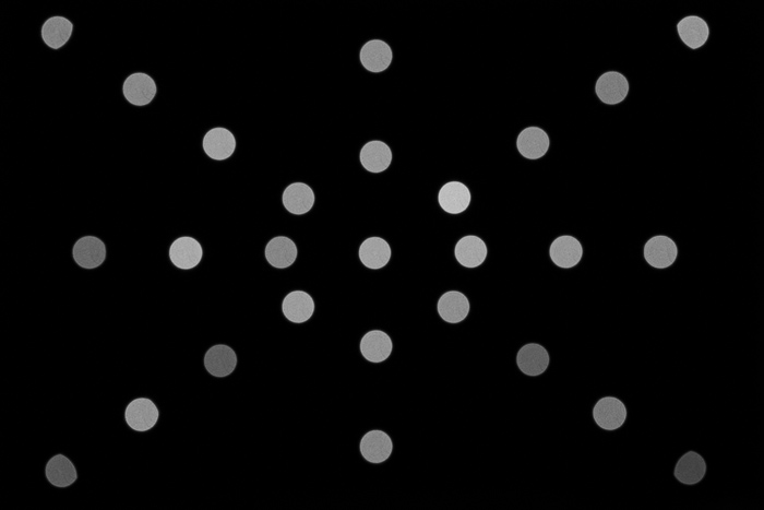

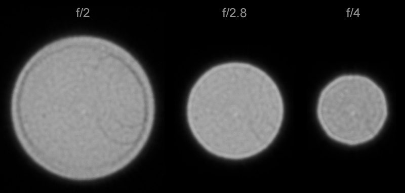

    Out-of-focus highlights are a bit of a mixed bag. The center discs are perfectly circular at f/2 and f/2.8 before a slight edginess creeps in at f/4. The inner zone of the discs is moderately grainy but it shows a fairly obvious sub-ring at f/2 (plus some dust here). This inner ring is gone at f/2.8. There’s a slight outlining of the discs here as well as at f4.
    As so often, the circular shape is only maintained at and near the center of the image frame. The borders and especially the corners show the usual “cat eyes” at f/2. The border discs are restored at f/2.8 whereas the corner discs require f/4 for a near-circular shape.
