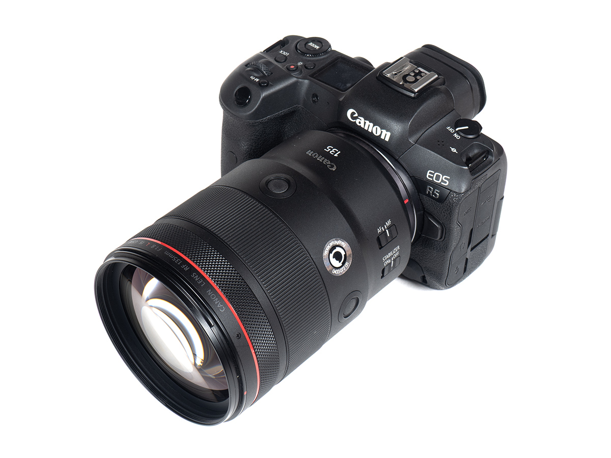

    So while we are at reviewing 135mm lenses, let’s not forget about this one – the Canon RF 135mm f/1.8 L IS USM. It is also interesting because it’s the only lens in its class featuring an image stabilizer. As such, it deserves to be a little more expensive than other lenses. In the US, it’s still “comparatively affordable” at around $2100 USD (probably not tariff-adjusted yet), whereas in other markets it’s bizarrely expensive. In Australia, it is almost 50% more expensive than the Sony FE 135mm f/1.8 GM. Anyway …

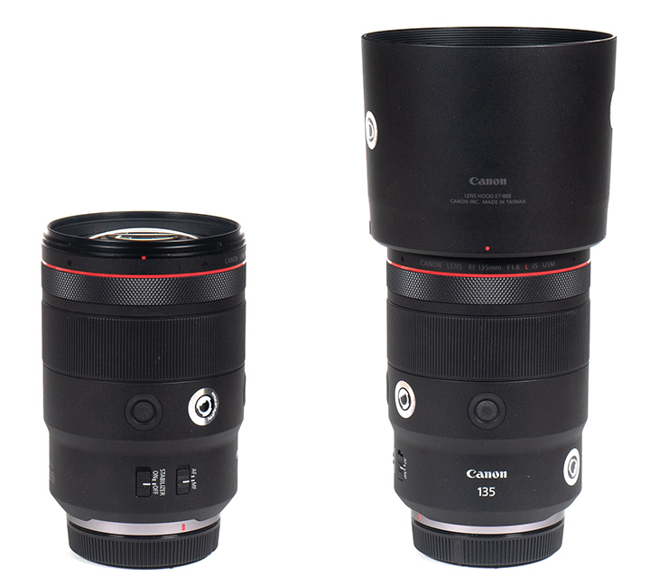

    Coming back to the lens itself, the build quality is in line with what we have seen with other (black-colored) professional-grade RF lenses. The lens body is made of Canon’s engineered plastics, which you may or may not like – the finish is a bit too slippery in our book. However, it’s certainly sturdy and, of course, sealed against the elements. The focus ring turns smoothly, and there’s the usual customizable control ring at the front of the lens. A barrel-shaped lens hood is provided.
    The AF is based on Canon’s Nano USM, which is both very snappy and silent. The image stabilizer is good for a gain of 5 to 8 f-stops (claimed), depending on whether your camera features an IBIS. As usual, take the statement with a grain of salt during real-life shooting, but it’s close depending on your coffee intake.

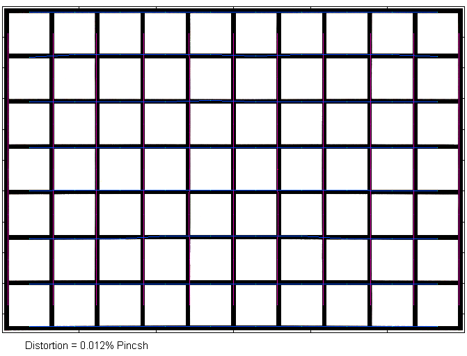

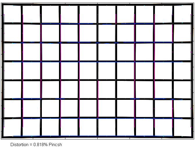

    The Canon RF 135mm f/1.8 L IS produces a slight amount of pincushion distortion in RAW images, and the remaining traces are removed via auto-correction if activated.
    CorrectedRAW

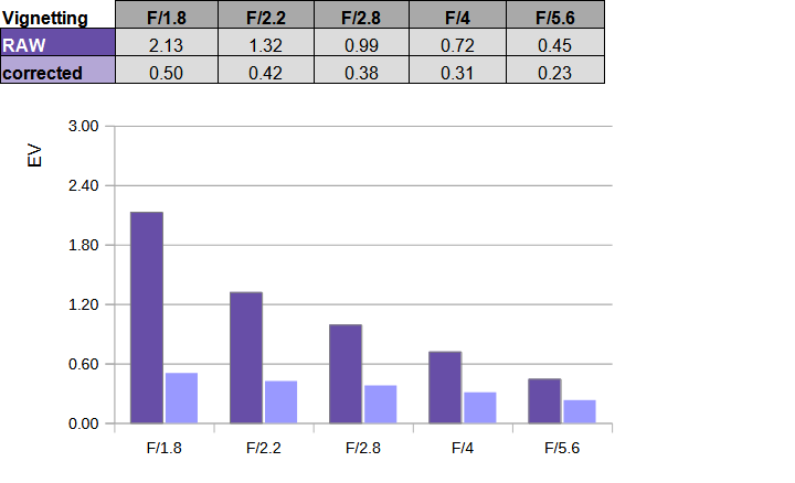

    Ultra-large aperture lenses tend to produce very high vignetting at max aperture. This also applies to the Canon lens with a light falloff of more than 2 EV (f-stops) in RAW images – somewhat higher than average in this class. The original vignetting is almost gone from f/5.6.
    The profile correction reduces this to a negligible degree even straight from the maximum aperture.

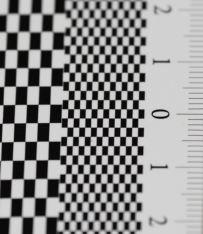

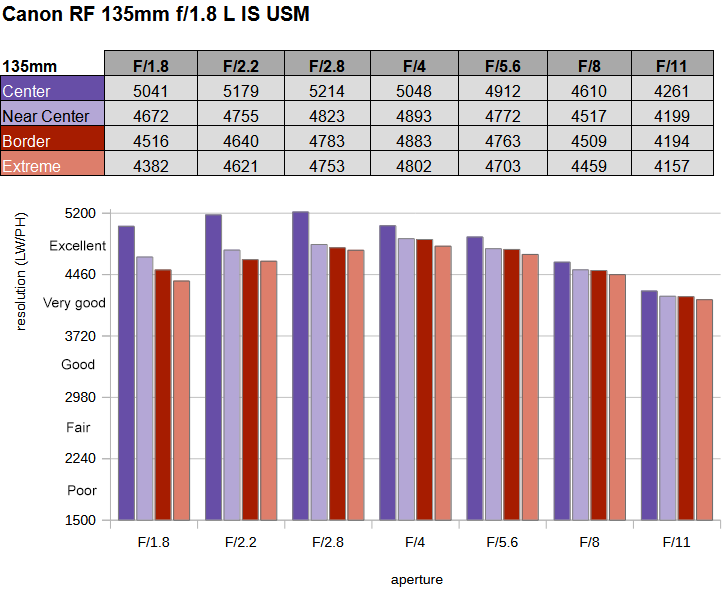

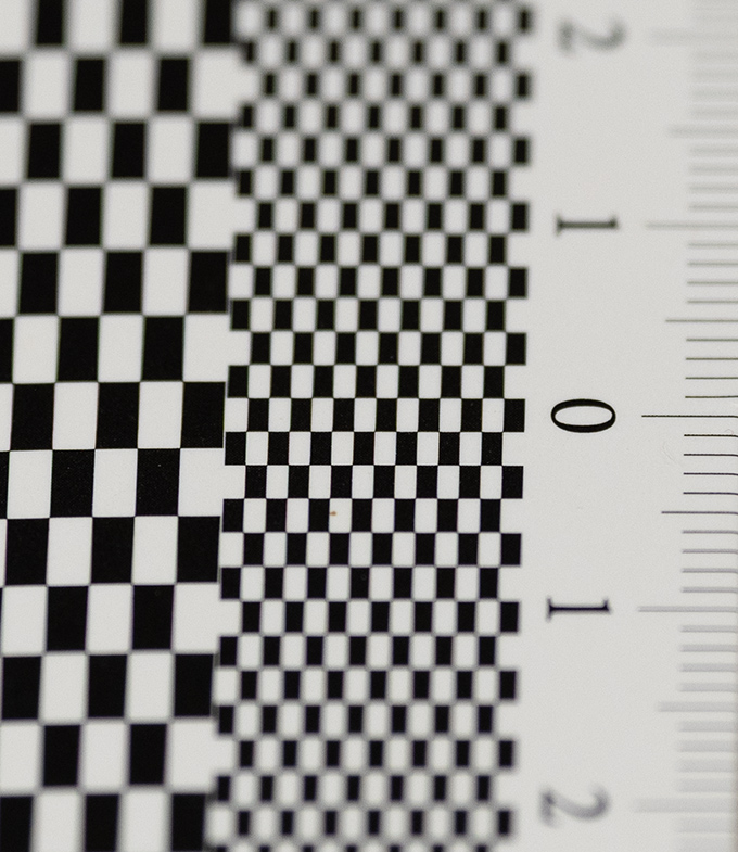

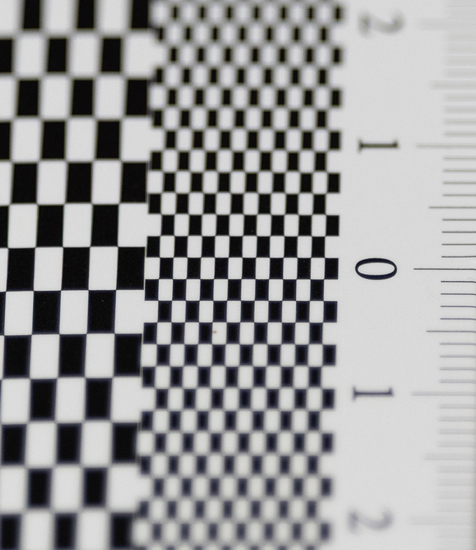

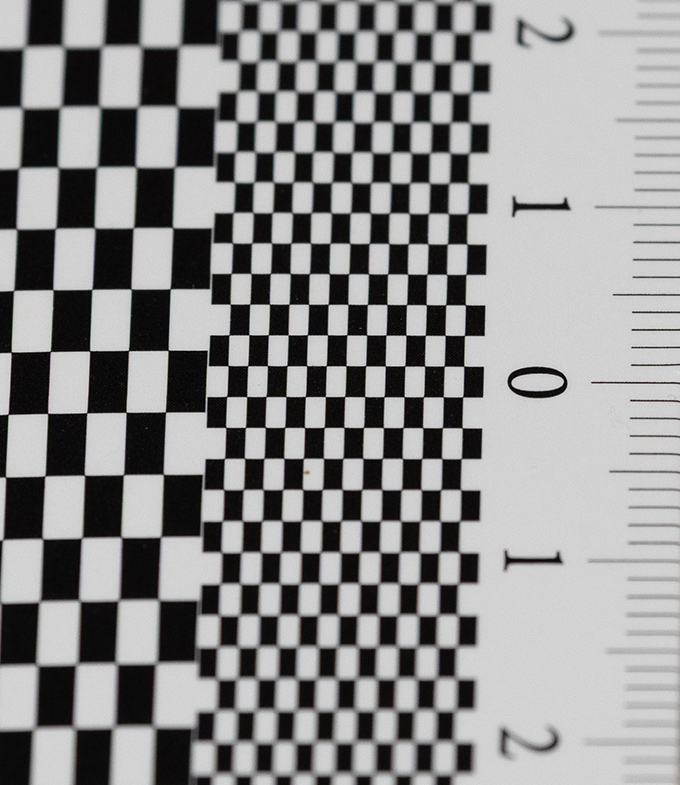

    The Canon lens delivered an outstanding resolution performance in the lab across all relevant aperture settings and across the image field. Stopping down improves the quality only marginally. This is probably the best result that we have seen from any tested lens so far.
    The field curvature is negligible. The centering quality of the tested sample was very good.

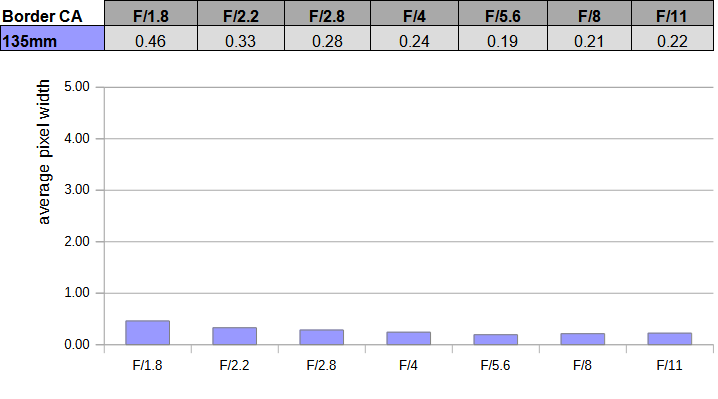

    Lateral CAs have an average width of less than 0.5px at the image borders. This is negligible, even without auto-correction.

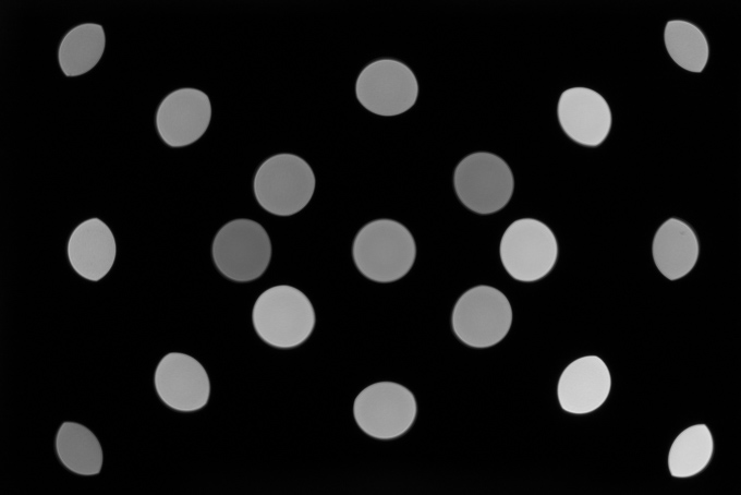

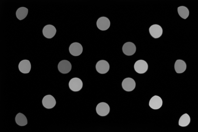

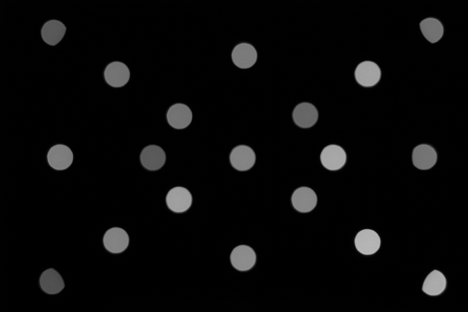

    A 135mm f/1.8 lens is primarily about shallow depth-of-field photography, so let’s take a look at the quality of the bokeh.
    Out-of-focus highlights are nicely rendered with a very smooth inner zone of the discs and barely any outlining effect. The circular shape of the discs remains intact even at f/4.
    When looking at the highlight rendering across the whole image field, we can spot the usual “cat-eye” deterioration from roughly the mid-field into the corners. As usual, stopping down will broaden the zone showing circular discs, and the corner discs are restored at f/4.
    f/1.8f/2.2f/2.8f/4

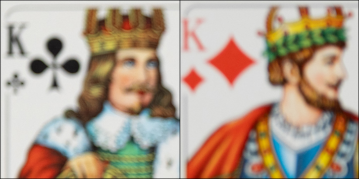

    The rendering quality in the focus transition zone is a bit surprising. The background blur – shown to the left below – looks rather nervous. We have seen smoother results from other 135mm f/1.8 lenses here. The usually less important foreground blur is pretty smooth, though.
    Just to illustrate this in a real-life scene (the image is also available from the download section), check the background blur in the scene below – this doesn’t look ideal with some strangely hard edges in the background blur. And this isn’t an overly difficult scene.
