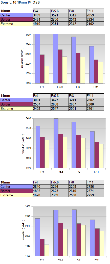

Given the previous test history on the NEX 7, we expected significant problems with respect to the resolution characteristic. However, we were actually positively surprised - technically at least. At 10mm, the center performance is nothing short of breathtaking. The border performance is good to very good in the relevant aperture range. The corners are sort of soft at f/4 but improve to decent quality at f/5.6 and f/8. The sweet spot of the lens is at 14mm with a very even quality between f/4 and f/8. Even the image corners are good to very good here. The weakest spot of the lens is at 18mm f/4. The center is still very good but the outer image region is soft. However, stopping down to f/5.6 resolves most of the issue though. Diffraction has a limiting effect on image quality starting at f/11 at all focal lengths.
As mentioned, we tested two samples and both showed significant centering problems. The charts shows the results from the 2nd sample (center & best image side).

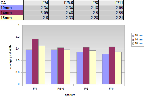

Ultra-wide zoom lenses tend to struggle a bit with respect to lateral chromatic aberrations (color shadows at hard contrast transitions) - this is also true for the Sony lens. The CA reach an average pixel width of 2-3px at the image borders. This is not extreme (on a 24mp sensor) but certainly visible in many situations.
