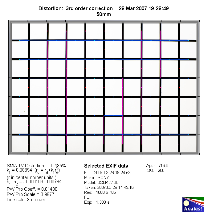

The AF 50mm f/1.7 shows very slight barrel distortion (0.4%) which isn't really relevant in field conditions.

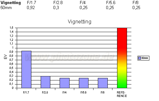

The AF 50mm f/1.7 is a full-frame lens so it can take advantage of a sweet spot effect
on the Alpha 100. However, at wide-open aperture the vignetting is still quite pronounced
at ~0.9EV but it is negligible from f/2.8 onwards.

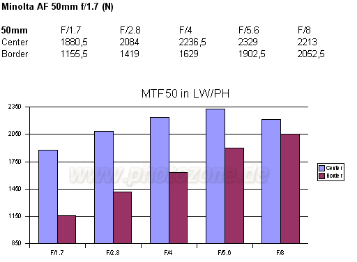

Usually there's very little room for improvement left here but the Minolta AF 50mm f/1.7 is
not among the best normal lenses tested to date. The center performance is already
very good at wide-open aperture and stopping down lifts the quality to levels at
or possibly even beyond the sensor resolution of the Sony Alpha 100. However, the
borders are a different story - at f/1.7 they're downright soft and not much better
by f/2.8. It takes f/5.6 to reach very good territories and the peak performance
is not reach prior of f/8 here. The Canon or Nikon counterparts show a much better
border characteristic.

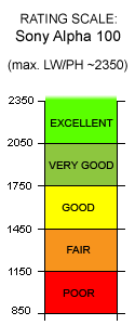

Below is a simplified summary of the formal findings. The chart shows line widths per picture height (LW/PH) which can be taken as a measure for sharpness.
If you want to know more about the MTF50 figures you may check out the corresponding Imatest Explanations

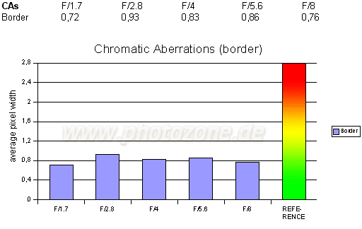

Lateral chromatic aberrations (color shadows at harsh contrast transitions) are relatively
well controlled but not something to rave about for such a lens. With a peak width
approaching 1px on the average at the image borders you may see CA traces at times.
