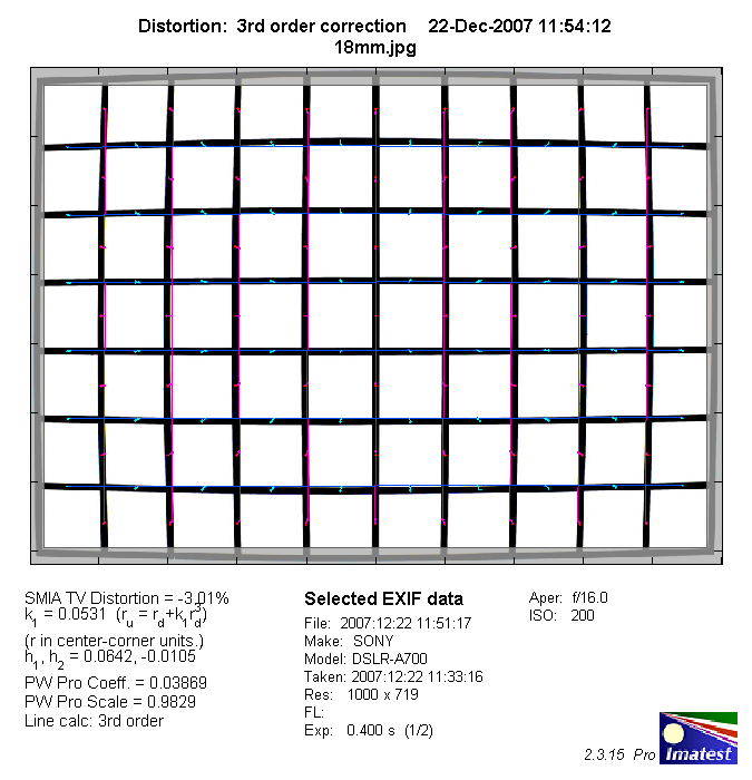

Typical for many standard zoom lenses the Sony produces quite hefty barrel distortion at 18mm (~3%) which decrease continuously towards the long end of the zoom range where the lens is basically free of distortion.
18mm 24mm 40mm 70mm

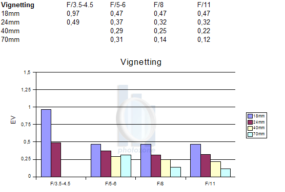

Due to its APS-C image circle the Sony 18-70mm produces some vignetting at 18mm and wide-open aperture but generally the issue is surprisingly well controlled for such a lens. At 18mm @ f/3.5 the situation is worst with a vignetting of about 1EV whereas at all other tested settings it is not really a problem anymore.

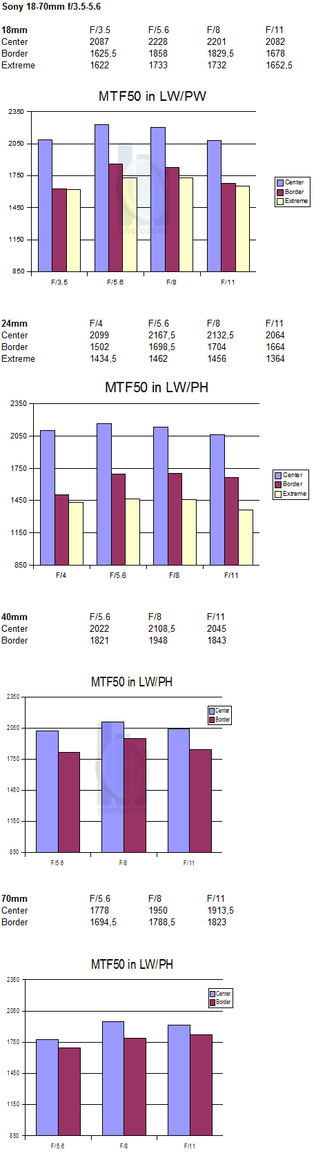

The Sony 18-70mm f/3.5-5.6 DT produced rather mixed resolution results in the MTF lab. At 18mm the lens is able to provide comparatively decent results with a very high center resolution and good to very good borders. At 24mm the center performance remains very high but the borders quality drops significantly especially when looking at the extreme corners and stopping down doesn't really change the situation. In the medium range (40mm) the performance is decent throughout the tested aperture range. At 70mm there's quite a downtrend again specifically at f/5.6. Stopping down lifts the quality to very good results though. At f/5.6 the contrast level is also just so so here.
The Imatest toolkit had quite some problems to provide reliable resolution results for this lens. Normally CAs are compensated but this Sony lens has rather extreme problems here (see the next chapter). Uncorrected CA can produce a visually softer image so if you prefer to shoot JPEGs straight from the camera the images will certainly look worse than suggested by the charts below.

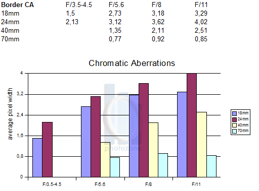

Lateral chromatic aberrations (color shadows at harsh contrast transitions) are a drastic problem. At 18mm and 24mm the amount of the CAs did not fit into the usually chosen scale thanks to a peak width of up to 4px on the average at the image borders. This is extremely poor. CAs are relatively moderate at 70mm. Please note than lateral CAs can be largely reduced via imaging tools - certainly a good idea here.

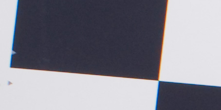

For your enjoyment ... here's a 100% border crop of the test chart illustrating the problem:
