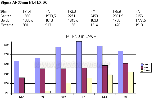

The Sigma shows a rather unusual resolution characteristic - it has a very pronounced
priority on center performance but it doesn't really care about the border and especially
the extreme corner quality. The center resolution is already on a very good level at
f/1.4 and f/2 and reaches excellent and even absolutely outstanding levels beyond.
The borders are only fair at wide-open aperture but in the extreme corners there isn't
much resolution left. The borders improve to good levels by f/2 whereas the corner quality
remains poor and it doesn't get much better at f/2.8. At f/4 the border/corner quality
starts to lift a little but it takes f/8 till the extreme corners reach good levels.
This is again in line to what we've seen in the corresponding test of the Canon variant.
Below is a simplified summary of the formal findings. The chart shows line widths per picture height (LW/PH) which can be taken as a measure for sharpness.
If you want to know more about the MTF50 figures you may check out the corresponding Imatest Explanations

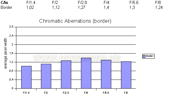

The degree of lateral chromatic aberrations (color shadows at harsh contrast transitions) is
acceptable for a 30mm lens but nothing to rave about either. CAs with an average width
around ~1.2px at the image borders can be visible at times.
