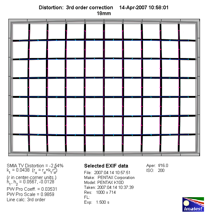

Typical for many kit zooms the Pentax lens produces a pronounced degree of barrel distortion at 18mm (2.5%) changing to slight pincushion distortion when zooming at 55mm (0.5%). At 35mm the lens is basically distortion-free.

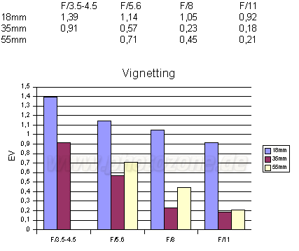

Lenses with a reduced image circle tend to vignette quite a bit specifically when it comes to wide-angles. This is also true for the Pentax DA 18-55mm AL. At 18mm the vignetting is very hefty with 1.4EV at f/3.5. Stopping down reduces the problem slightly but not to a really desirable degree leading to the conclusion that the lens is slightly under-designed here (front element too small). At 35mm the vignetting is still strong at wide-open aperture but from f/5.6 it is no real problem anymore. Same goes for the 55mm setting.
