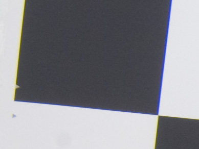

So far it looked good but the 16-45mm f/4 has also a dark soul - lateral chromatic aberrations (color shadows at harsh contrast transitions). At 16mm and 24mm CAs can be quite extreme with an average pixel width around 2.5px at the image borders. This is plain bad although the issue can be corrected via imaging tools thanks to its very symmetrical characteristic (see the 100% sample crop below). To be fair the CAs are of the less hostile blue-yellow type (rather than red-cyan). In sharp contrast to the wide end CAs are almost negligible at the 45mm setting.
Here's a illustration of the problem (@ 24mm f/8, upper left border, 100% crop):
Move your mouse pointer in/out of the image
for the uncorrected and corrected portion
